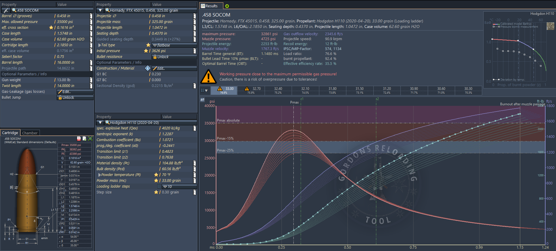

Found a little data on this load but way to far to apart on grain load to feal comfortable
Read from 29.8 H110 to 33.0 H110
None on LiL Gun but know it's a popular powder for it .
Saturday going to grab me some RL7 so have plenty of options but have a crap ton of H110 so was hoping for the 325 data ,Appreciate any and all the help in advance and thank you..
I have loaded 30.0 - 31.0 - 31.5
31.8 and 32.0 of H110.. If anyone finds the loads seem to hot please speak up and let me know what you think,going to try them this weekend..

I did load 30.0, 31.0, 31.5, 31.8
And 32.0 today if there were any pressure signs I didn't see them but nervous still about no data with either H110 or LiL Gun for them ..I'm using Nickle brass if that makes a difference...
Your load data is within the same range I have tested with in h110. And I have tested higher for h110 also. Thing is, you won't find pressure signs for this cartridge because it's low pressure. Unless you are looking for better accuracy or higher velocity, you can stick with your current loads for plinking.

FWIW, I set COAL to 2.185" and 16" bbl length.

Thank you I forget you have to throw away knowledge of reloading other rounds with the 458 socom..I appreciate the help .
I liked the feal of the 32.0 and was very accurate out of the rifle, so as you said, I'll stick with it..do a Lil crono testing this week and she what she is pushing too. But again thanks ,always no matter how much you think you know someone has some knowledge you don't or just might not have..
