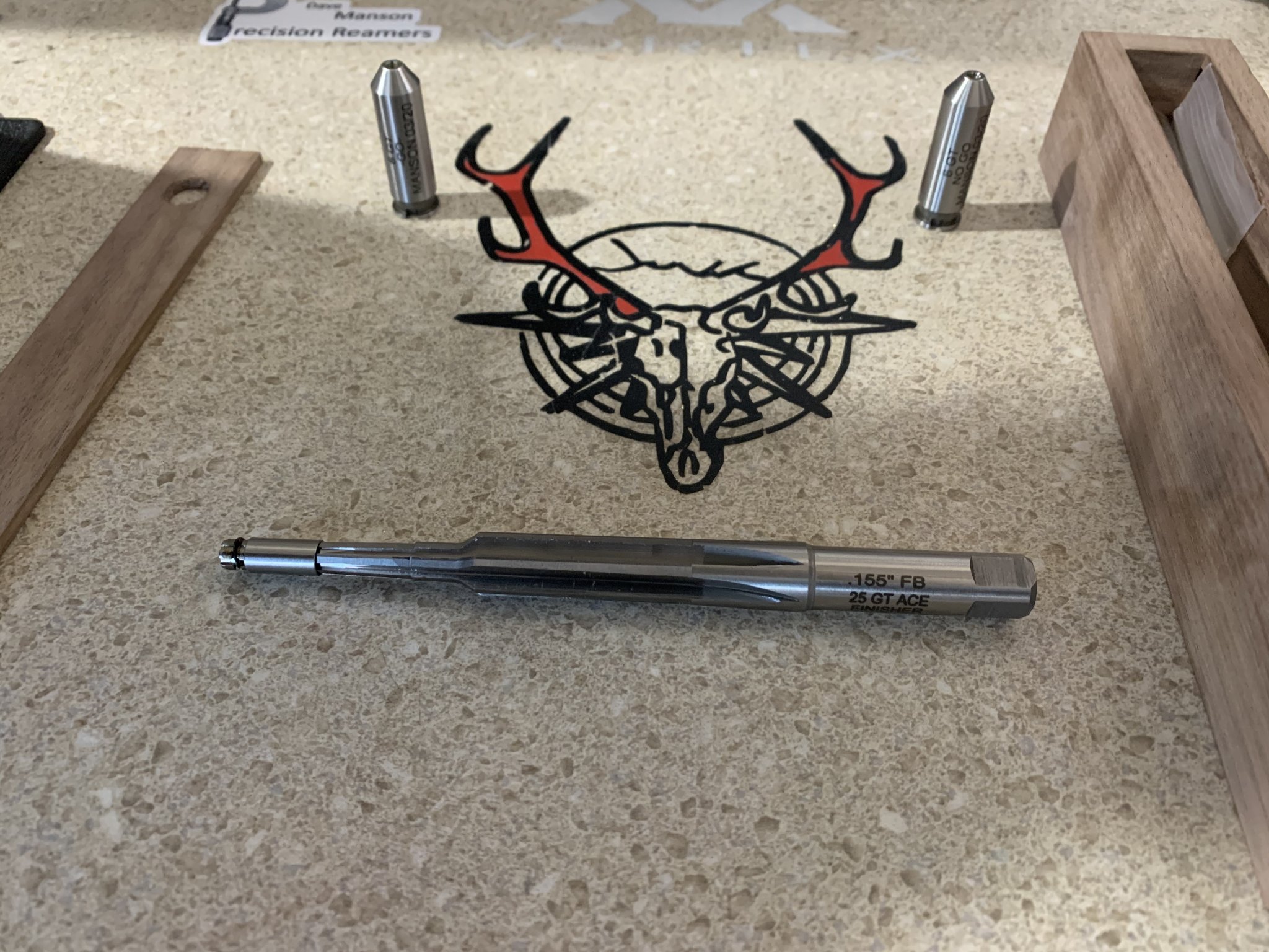

I mocked up a case and ordered a reamer from Dave Manson Precision Reamers. They were very helpful and took great care of me in making the reamer and then working with me when I needed to regrind it to shorten the free bore.

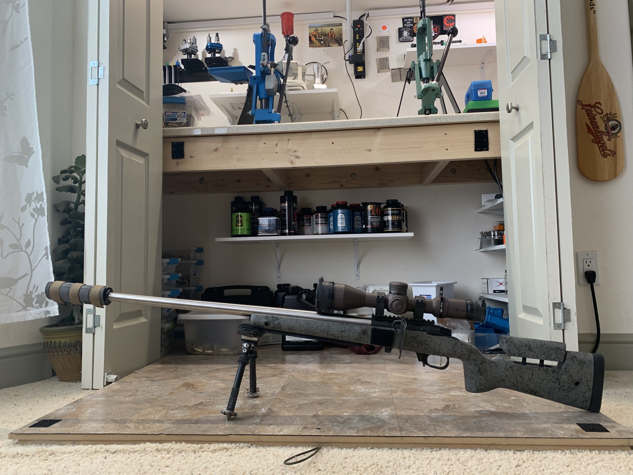

To start the rifle specs are:
Impact Precision 737r
28” Bartlien heavy varmint 5R 1:7
Silencer Tech 30 cal suppressor
Trigger tech special
Skim bedded Bell & Carlson M5 stock
edited to add barrel twist

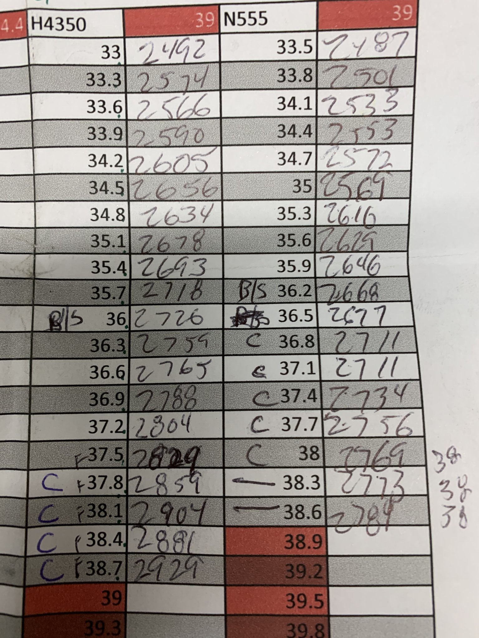

I am using H4350 but will run a ladder on N555, and IMR4166. Maybe varget But I don’t have much of that.

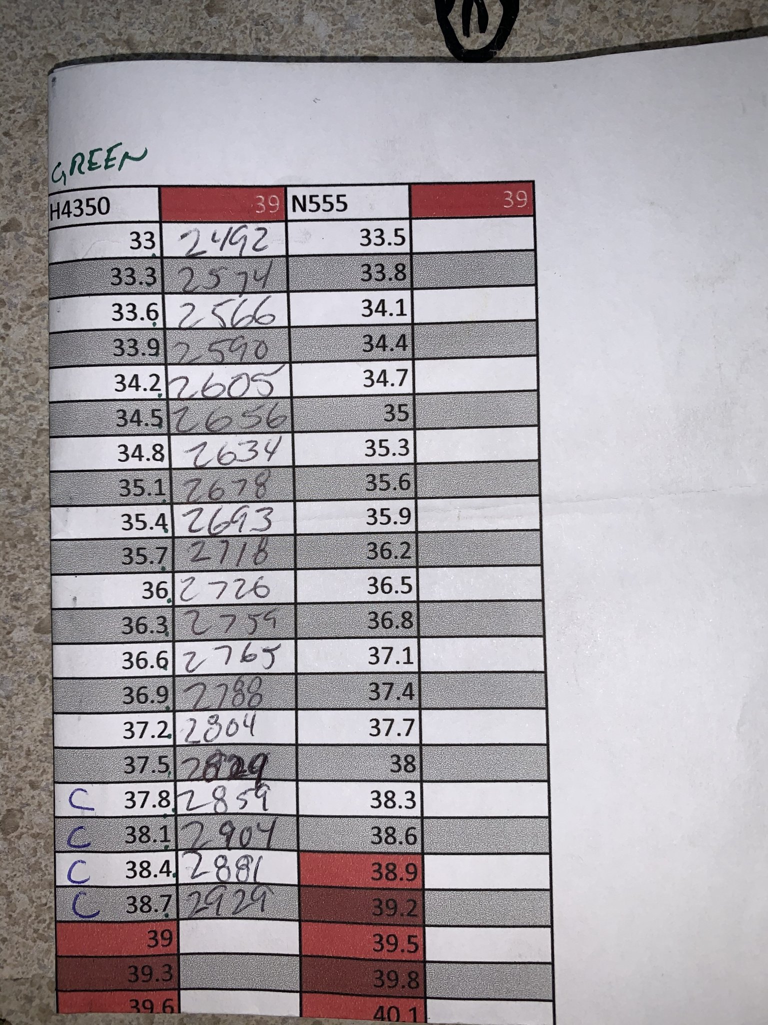

These are the first 20 shots out of the barrel.
At 36.3 to 36.6 the powder was at the body shoulder junction.
The last 4 loads were compressed.
the last two loads seemed to loosen the primer pockets up a little. And showed a really faint ejector swipe.
the 2nd to last load the bolt was very slightly stiffer.
The recoil was sharper after 37.5
I know it’s a very long ladder but I had no data to go on.

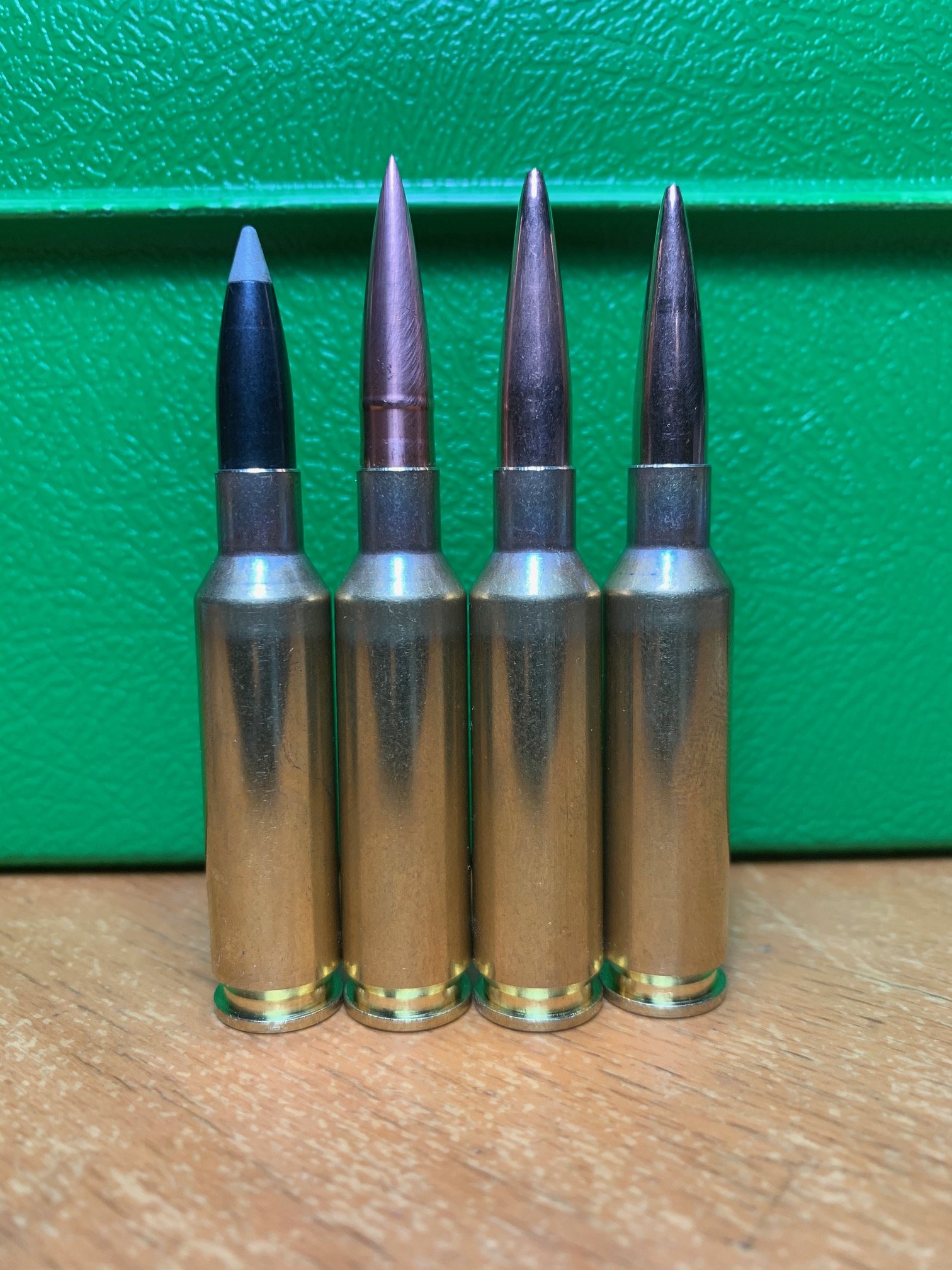

Lets see the cartridge! (preferably next to it's family for comparison)
What kind of OAL and freebore did you decide on?
I ended up at a free bore of .155. This puts the top of the boat tail about .020 above the neck shoulder junction and the bottom of boat tail about .075 into the body. I wanted to mimic the neck to bearing surface of the BR cases to the extent I could.

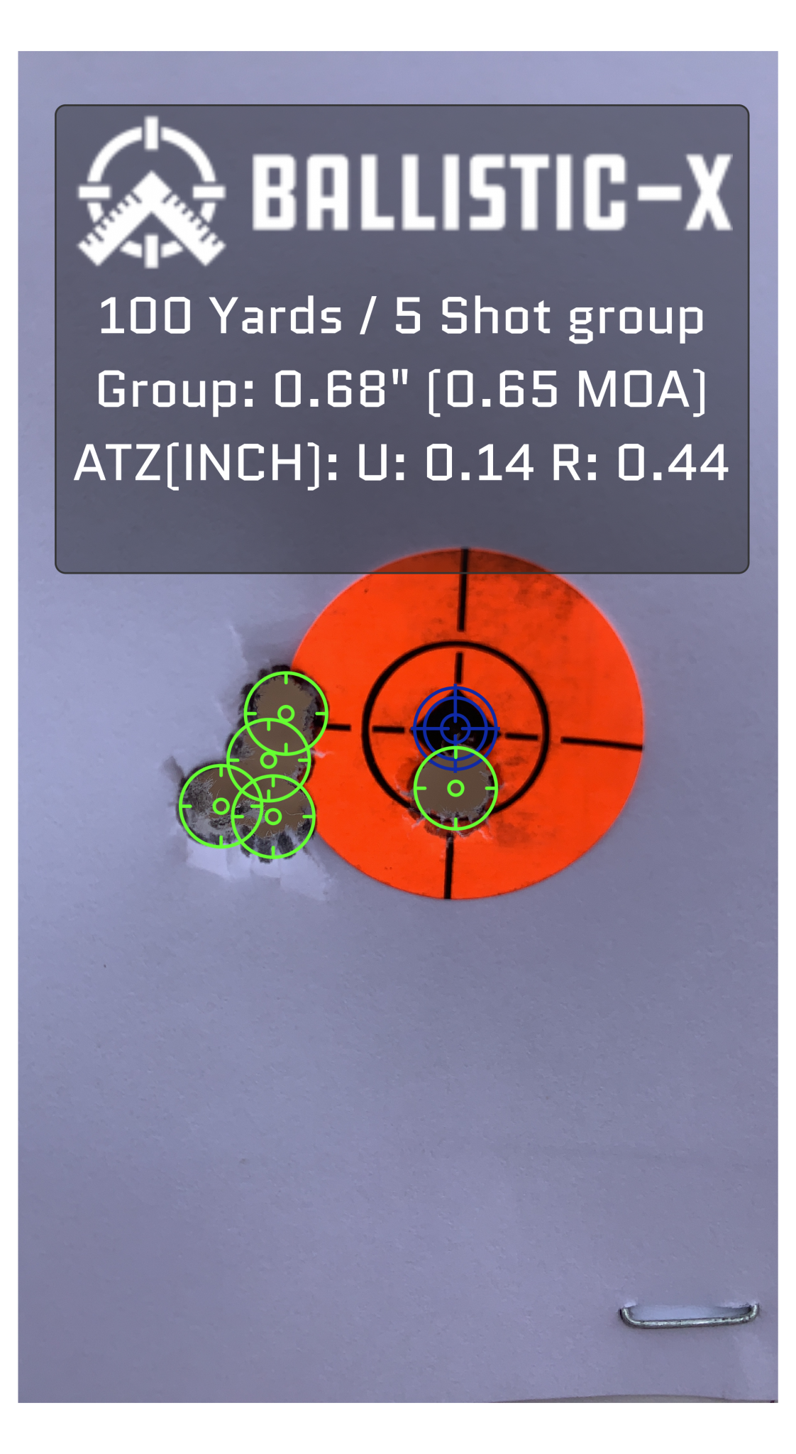

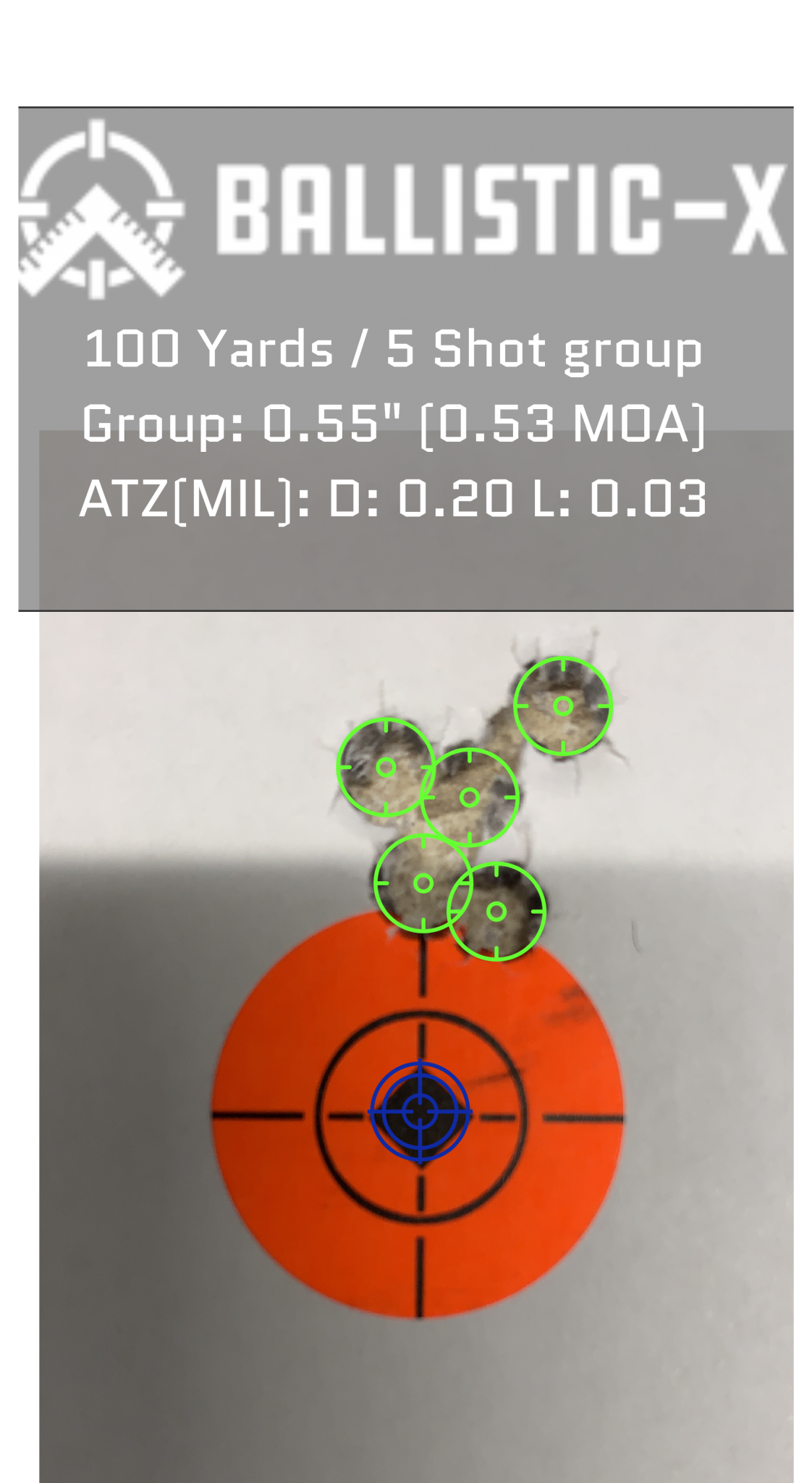

my first 5 round group(shots 25-30)

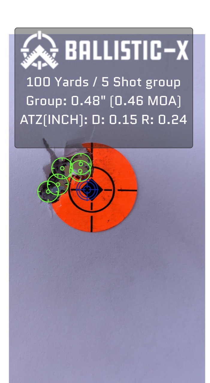

My buddy’s group (shots 31-35)

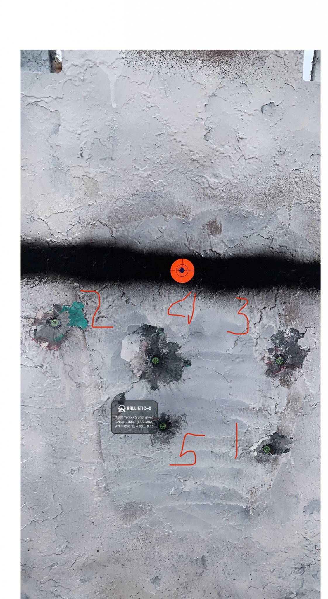

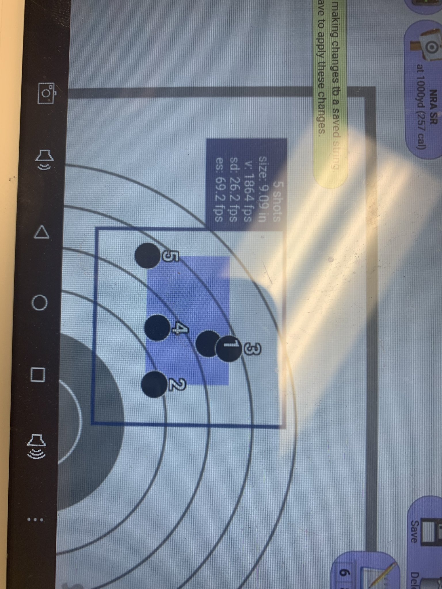

And a group at 1000 winds were gusty 10-12 but drop was pretty consistent. (Shots 38-43) 1 MOA group.

Here is the magnetospeed data for the final load and final group. Please remember I don’t like shooting groups. I am normally a .5 +\- .1 shooter. The flyer was my cold bore. Without the flyer it is a .42 group.
MIN 2800
MAX 2805
AVG 2802
SD 2 ES 5
Shot 1-2805
Shot 2-2800
Shot 3-2802
Shot 4-2802
Shot 5-2804

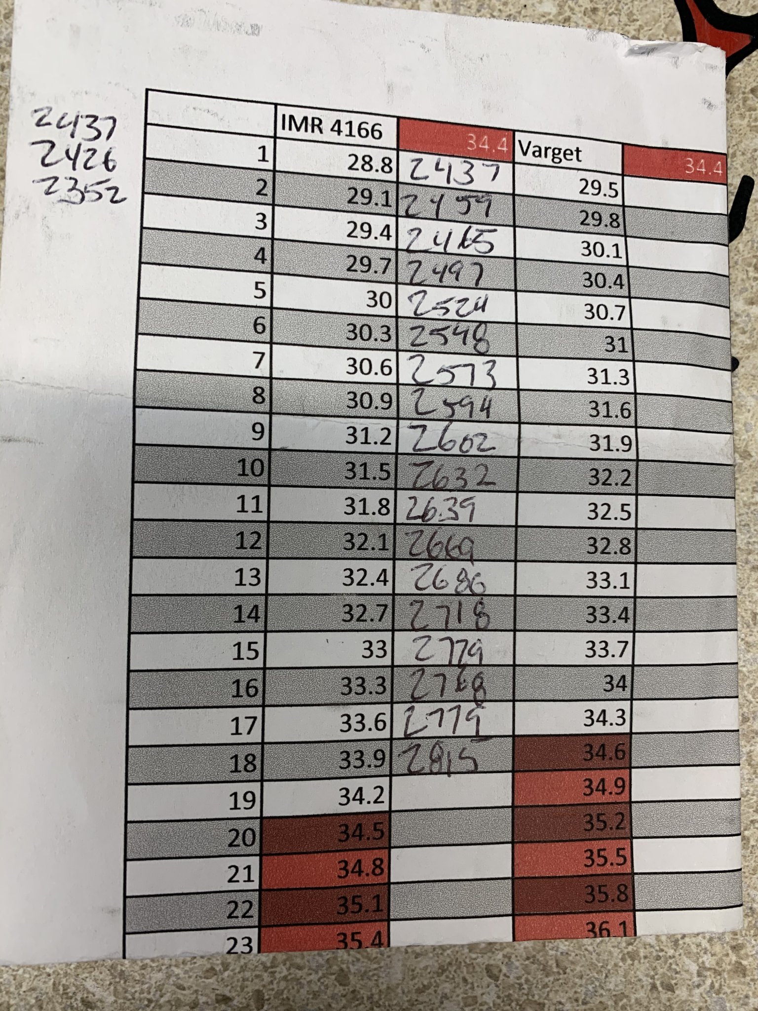

With the powder crunch I decided to run a ladder on what’s available. Tried Vihta
vuori N540. Starting from scratch on a wild cat I apparently started way to low. I normally try and run 10-12 shots with about 1% steps on a ladder. This was done in two separate runs. Other than 2 very slow nodes it is about 20fps per .3 grains. Recoil was equal to the H4350 and N540 metered exceptionally well. I’ll probably load up five at 33.6 and see how they do.
N540
28.5-2365
28.8-2365
29.1-2384
29.4-2419
29.7-2419
30.0-2443
30.3-2476
30.6-2474
30.9-2508
31.2-2521
31.5-2541
31.8-2558
31.2-2587
31.5-2610
31.8-2625
32.1-2647
32.4-2699
32.7-2712
33.0-2737
33.3-2757
33.6-2779
33.9-2798
34.2-2815
34.5-2841 ejector mark heavy lift

Put the 25 GT barrel back on the the Impact last week. The 6 CM finally gave up. I’ve been looking forward to trying the new bergers out.

H4350
36.12738
36.32761
36.52776
36.72778
36.92797
37.12820
37.32821 stiff bolt
After that i ran 2, 5 round test groups, to check where it wanted to be seated. I tried .005 off, and .020 off. Much deeper than that it starts to impact case capacity. It seemed to like the .020 depth more. Ran a drop test on it and the BC came out to .340 G7. Gun is shooting right around .5 MOA with me on it. In nasty cold conditions.
Shot groups at 36.8
.8 MOA at .005 jump
.6 MOA at .020 jump (4 touching 1 flyer)
16 shots
Avg speed 2781
SD 6.5 ES 21
Bullet differences. 131 v 135
weight. 131 / 135
OAL. 1.442 / 1.415
OTB. .695 / .687
Boat tail length. .228 / .238 (approximately)
