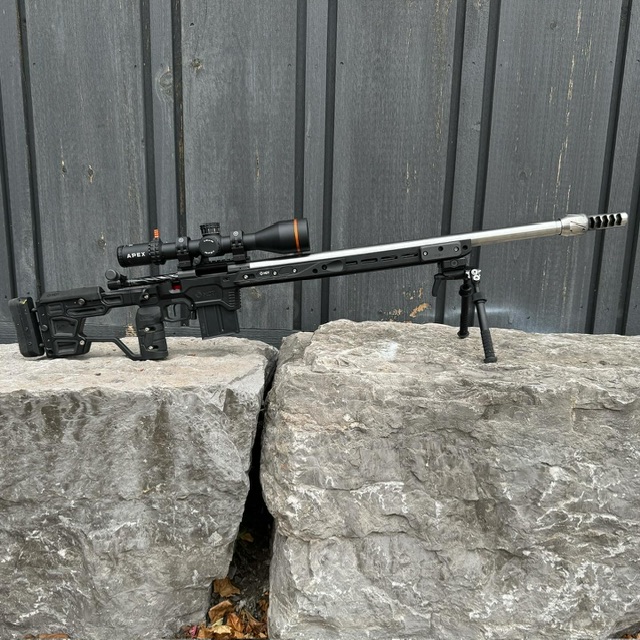

I have really been enjoying this cartridge so I thought I would share my findings.
26" Benchmark 1-7"
lapua brass
CCI 450
40.25 gr. H4350
Berger 133
2890 Ave. Velocity.

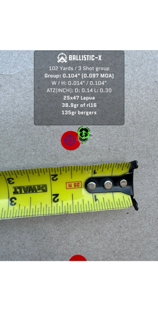

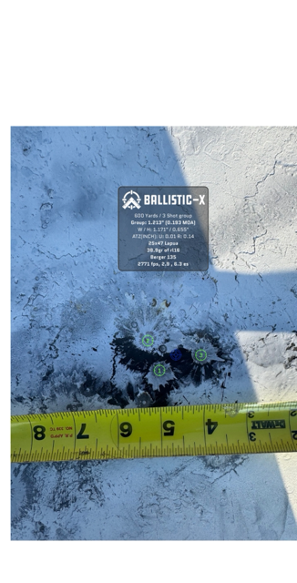

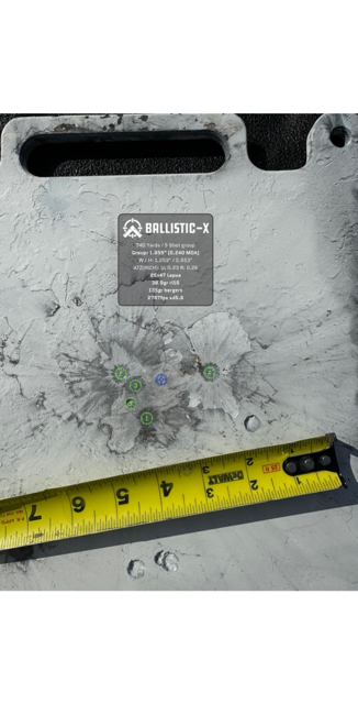

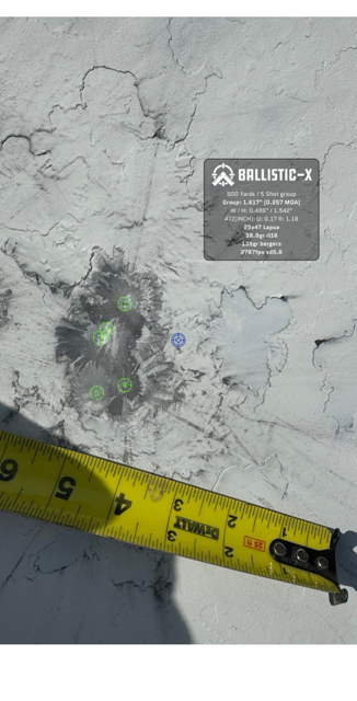

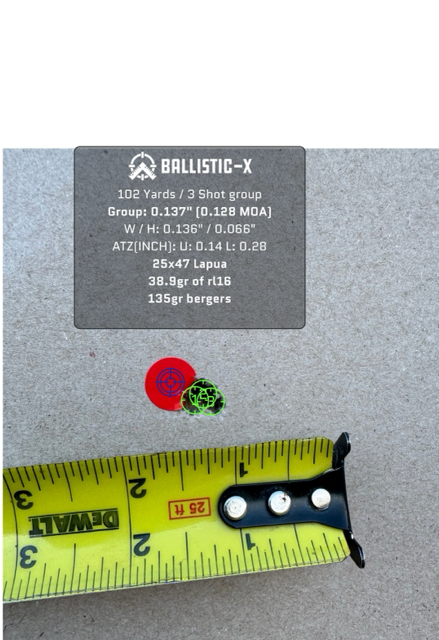

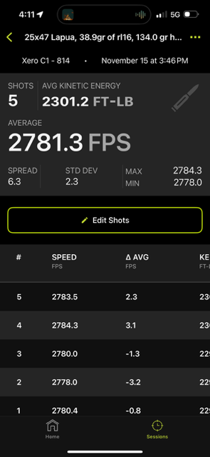

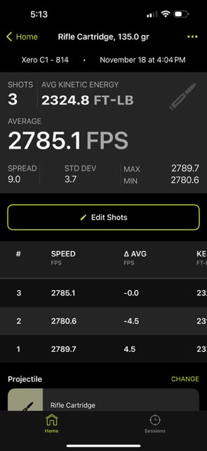

I’ve also been really enjoying this cartridge.
Terminus Zeus
27” crb 1:7.5 twist
Lapua brass
Br4’s
38.9gr rl16 at 2780fps,
35.9gr of varget at 2775fps
I’ve tested 3 diffeeent powders, 2 different bullets and my buddy tested a 4th powder and everything seemed to show a node between 2760-2790. There was area’s lower and higher but every combo shown something here.
Run it up to 2940fps and as low as 2650fps
