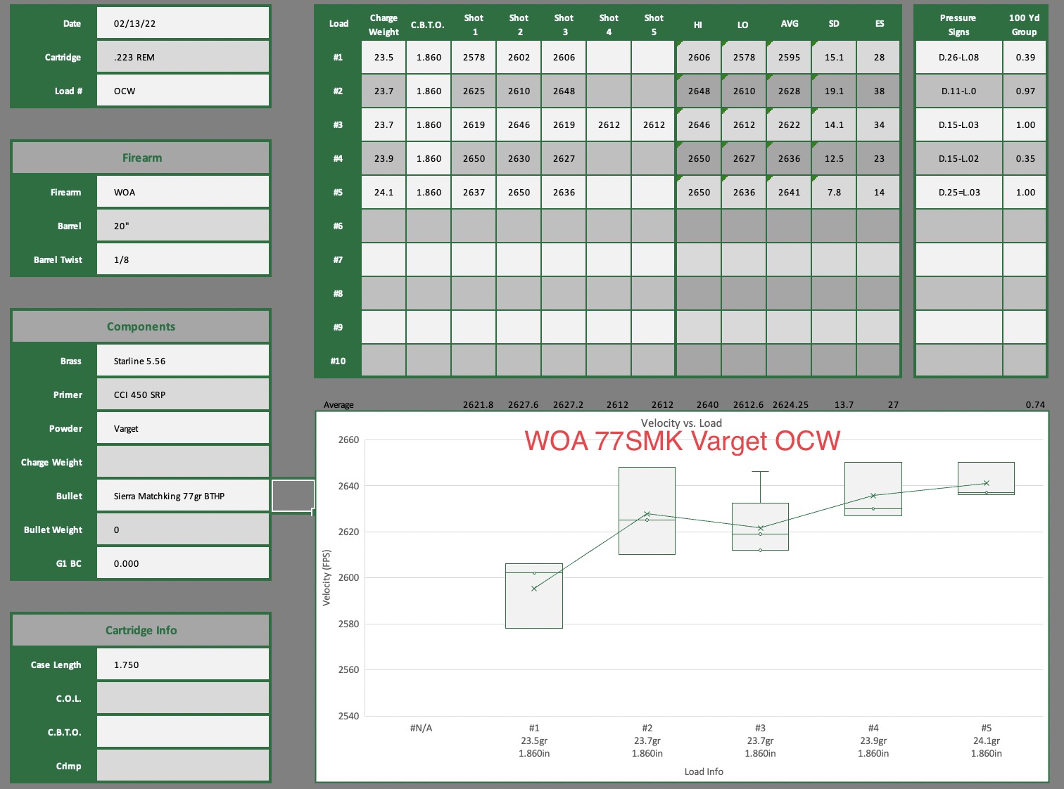

My Wilson seating die is enroute from MidwayUSA and looks like my action should arrive at my LGS on Thursday so I can pick up on Friday and then get barrel put on that afternoon. I am HOPING I can get out to the range on Sunday (Saturday is out as my wife has Valentines Day plans).
yep, 20" AR 1/8 twist. I have run this test in straight 223 bolt guns as well, seems the be the range that works well with this combo. I have also found seating depths within .020 of lands, and as short as 2.245 that work well. Here is the complete work up for that AR and combo.
Ballistic-X-Export-2022-01-01 17:59:25.777799.jpeg
Reactions: simonp and capreppy
