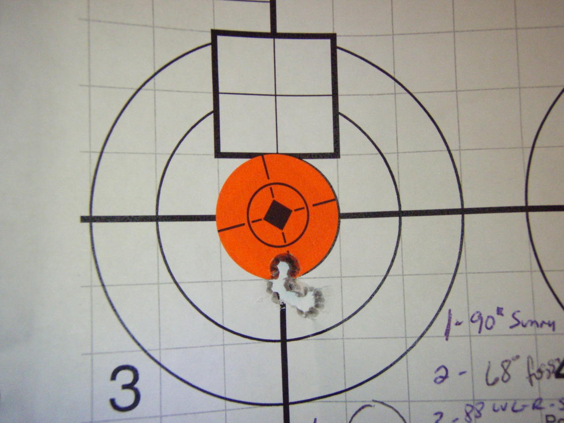

Did some cold bore testing. These are at 200 yards, first shot was last night after work, 90 degrees. Second shot was this morning, 68 degrees.
Third shot was this afternoon, 88 degrees with 5 mph left to right wind.
This was my 40.2 varget load with a 130 hunting vld seated at .025 jump. After the third shot I moved
the scope 1/4 moa up so should be good to go. The dot is 1 inch and the squares are 1/2 inch
I will test again when it's cooler.

yes, same load. This is a hunting rifle with a #3 barrel so it heats up quick in the summer. It starts going sideways after 3 shots but should be great for hunting.
I will be shooting the 39.3/123 amax load for fun but will be using this load for hunting season. Very happy with the cold bore reliability.

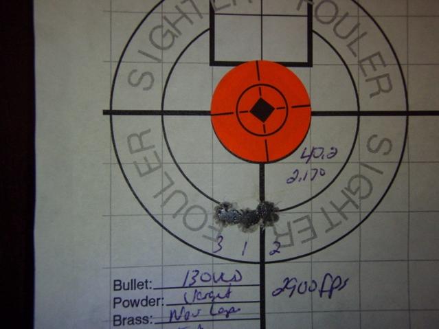

It is averaging 2920 fps, I loaded the same in new unfired brass and got 2900 fps average. This picture is on the first three shots with a clean barrel and new brass.
Middle shot first then waited about 10 minutes and right shot second then waited 2 minutes and 3rd shot left, all at 200 yards.

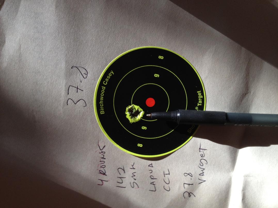

Ok, finally got the 260 out today. I have to say Mark at Spartan Rifles makes some laser accurate hammers. So here is just an example of some of the groups I was getting today with Varget.
This load was out of a 24 inch barrel.
142 SMK
37.8 grains of Varget
Lapua Brass
CCI Large Rifle
2.840 OAL
MV 2721
Standard deviation 7FPS
Ogive???? waiting on my thingy to measure that.
There is no arguing with the results. I didn't measure the group but it's 4 rounds in a hole about the size of a single 30cal bullet hole. Have a few groups that are similar or close.
