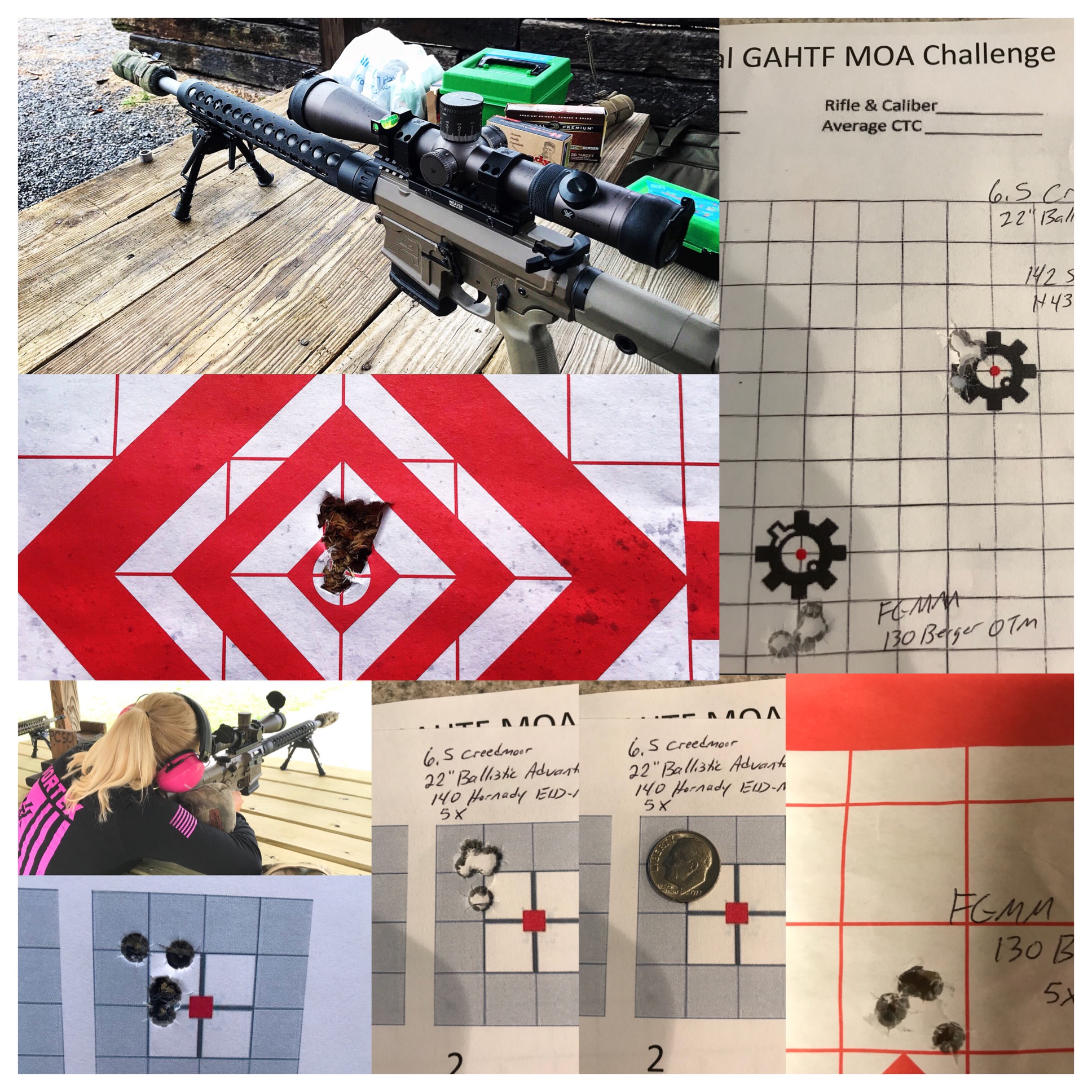

Versatile cartridge for the platform. Does well with the factory Hornady 140, 147’s and FGMM 130’s, although the FGMM is hot. Also does well with the 142SMK.
Results from the range over the past few months.
