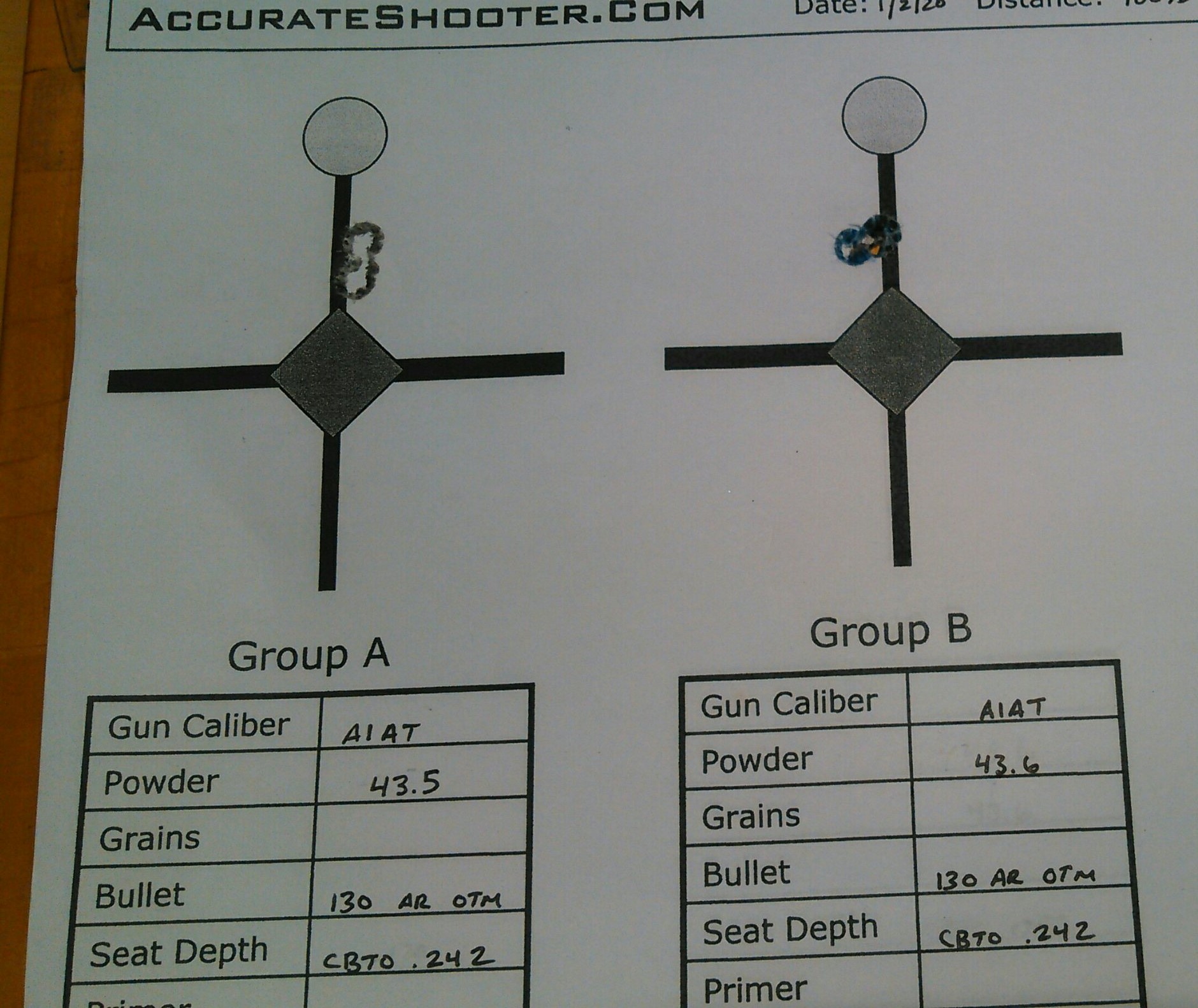

Another load for the "260 Master Race"
24 inch barrel 1:8
Lapua Brass
Federal Primer
43.5 grains of H4350
2.242 CBTO
130gr Berger AR OTM
2859 fps
prints 1/4" 3 shot groups
