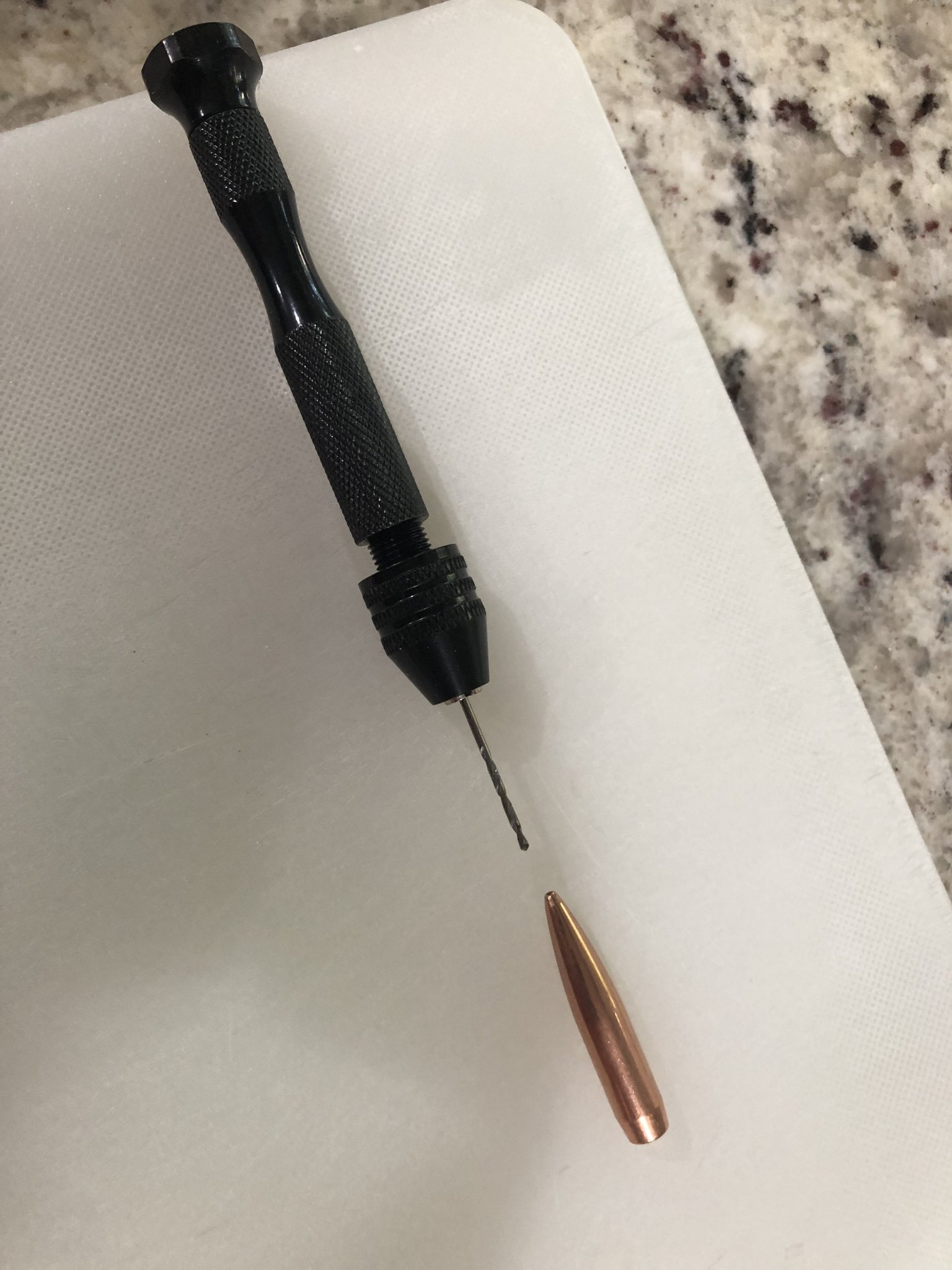

Hunting is a low on his list but it is still on it. The 140 BTHP is a terrible hunting bullet from my real world experience. It pencils through at any distance. The 140 and 147 eldm work great. I’ve killed dozens with those bullets with excellent performance on game.
That would be good advice, as the 140 ELD-M would make a much better hunting bullet.
Reactions: wade2big
With a small drill bit you increase the diameter of the hole in the tip. Then, instead of just being a paper punching target round the bullet expands as a hollow point should.

I would also suggest the Hornady 140 grain bthp. I open the hollow point a bit larger so it behaves better for expansion. This also has the effect of trying the tip which some folks complain about inconsistent tips.

I would also suggest the Hornady 140 grain bthp. I open the hollow point a bit larger so it behaves better for expansion. This also has the effect of trueing the tip which some folks complain about inconsistent tips
