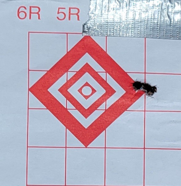

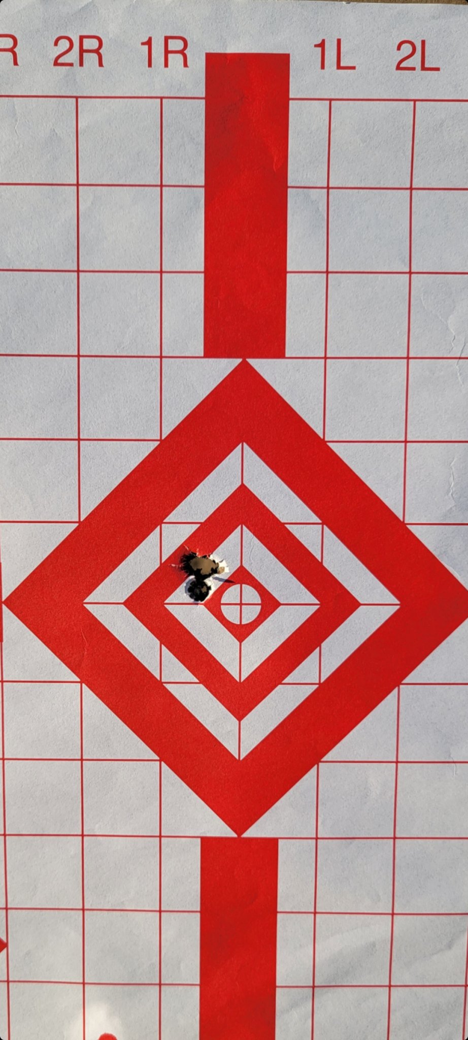

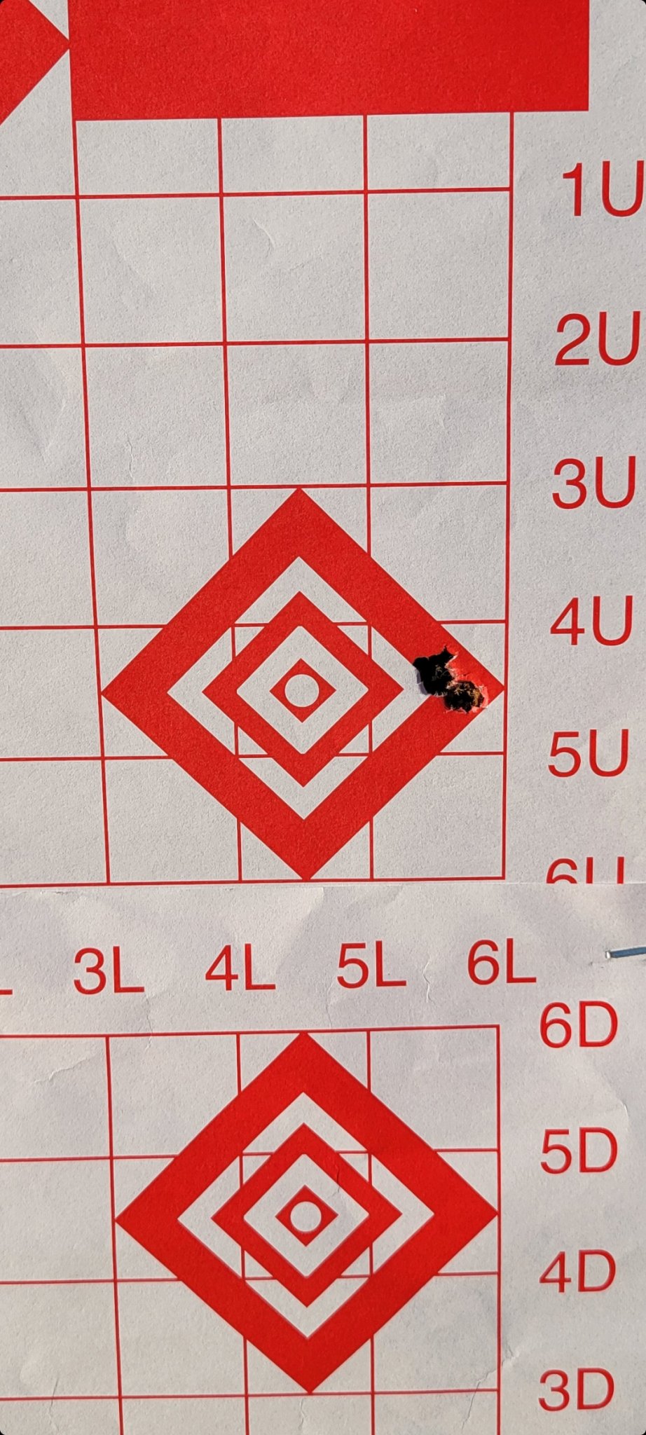

ADG brass, 80gr IMR8133, 215M. 195 Berger. 3.675 COAL (12 thou from lands). 24in Proof Carbon Sendero 8.4 twist. TBAC Ultra 5. 2964 fps. SD of 5.0. This is a hunting rifle.
Couple different 3 round groups. Seems to hold under .3 inches consistently.
