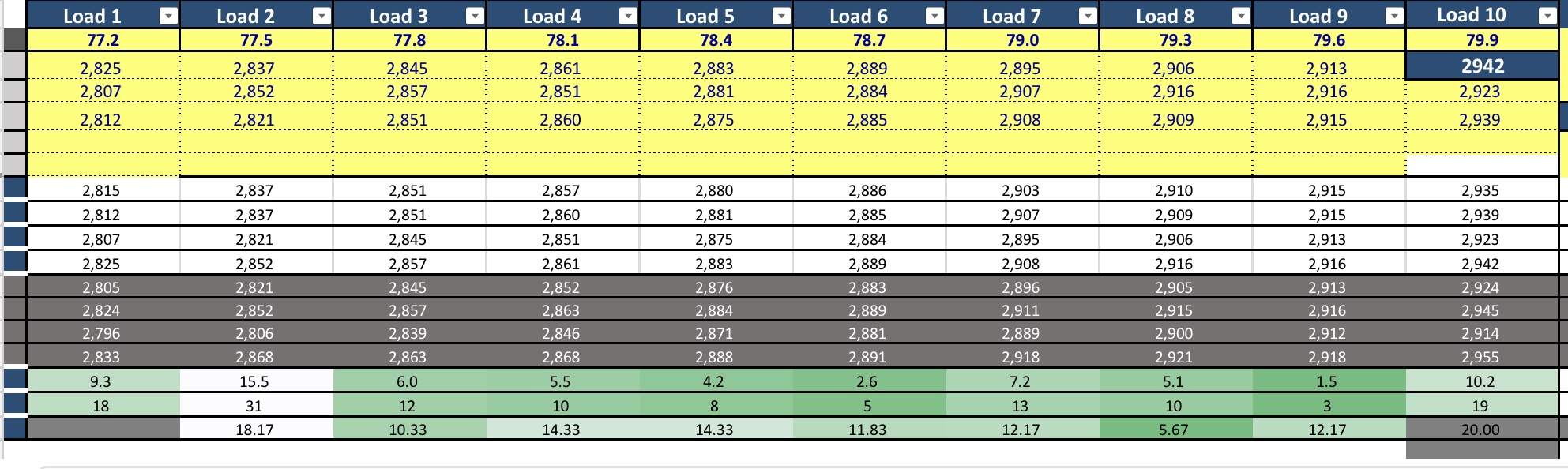

What I see is that the obt node in QL is 1.430ms which was giving me consistent POI from 77.8 to 78.1 in 3 different range days around 2850fps

77.2 2815fps
77.5 2837fps
77.8 2851fps
78.1 2857fps
78.4 2880fps
78.7 2886fps
79.0 2903fps
79.3 2910fps
79.6. 2915fps
79.9 2931fps
80.2 2947fps
80.5 2963fps
80.8 2969fps
