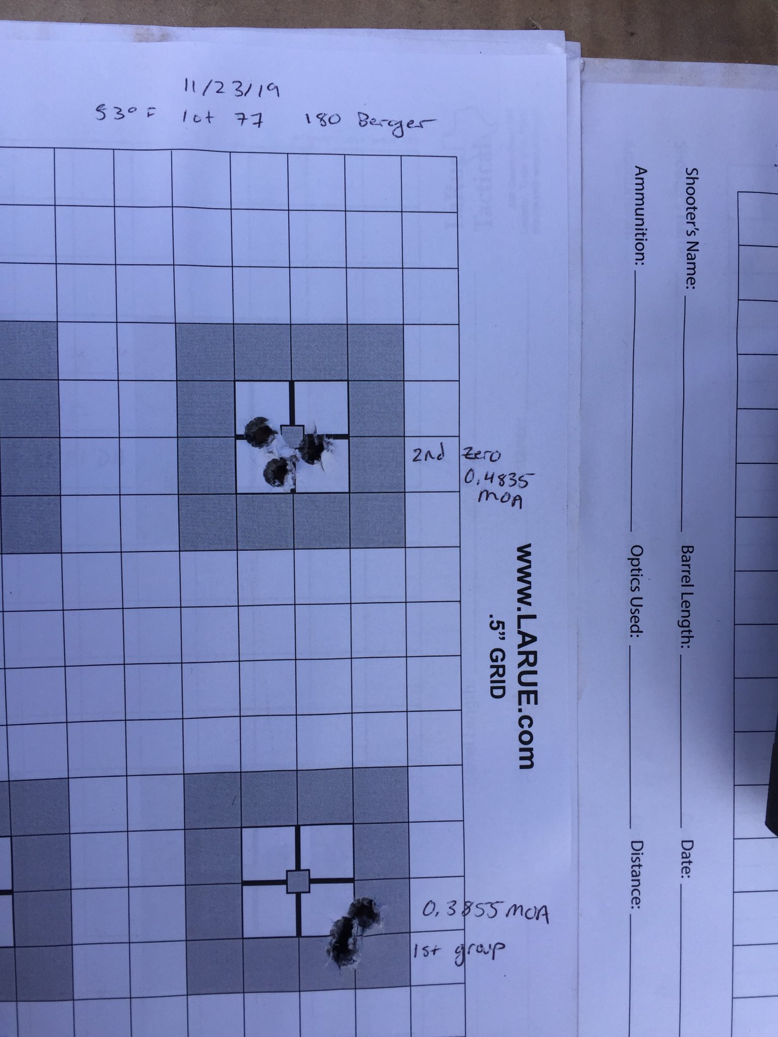

I’m on my 3rd barrel in 28 Nosler only used H1000
180 Berger Hybrids 0.02 off the lands
FED GM215M and H1000 factory Nosler brass. Following is 49F and ~5000’ DA
77.5 gn 3084fps 0.33-.5 MOA
77.0 gn velocity NA .5 MOA
76.5 gn 3058fps .30-.5 MOA
MY gun is a 26” proof TL3 chambered by PVA. Be advised 77.5 is hot and I get ejector marks every time.
I have found and reloaded for other guns M48 Nosler 26” proof and 77.5 has produced 0.16 MOA - 0.22 MOA still get ejector marks

How many rounds have you been averaging per barrel
Edited with new data. Typo I have a 26” pipe not 28” and I’m getting 3058 now not 2999. Anyways I’m getting 450~ if I shoot them fast which I’ve shot 15 round strings before and the barrel was stupid hot to the touch. Also shot it entirely suppressed. When I mean toast, it gave up 1 MOA.
Two Bartlein HV barrels later I have my proof carbon at ~450 and it’s still drilling sub 1/2 tho it used to be sub 1/3 until 350 Ish. However I’m shooting much slower ie 1 RPM to 3-5 min between shots. It’s worthy to note I’m in AZ and shoot in the summer when it’s 100*
This is 450 ish rounds and still hammering along
