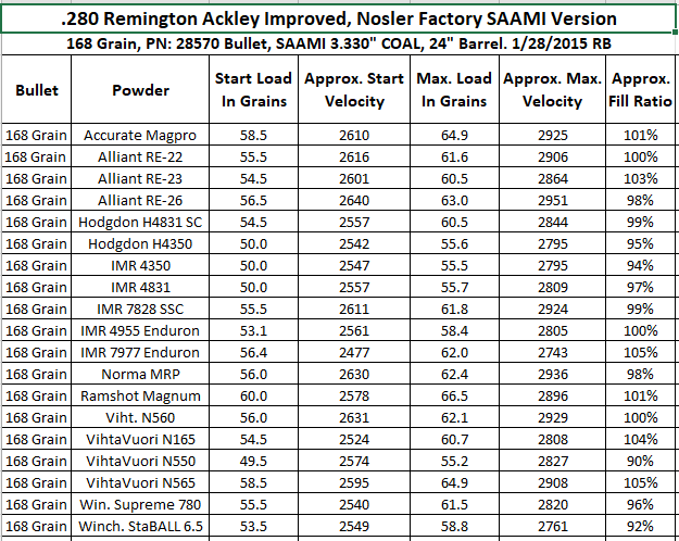

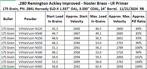

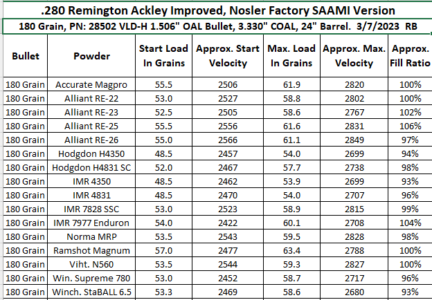

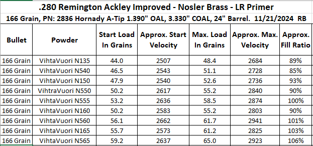

So far still working on load development, so no results to post yet. I did notice that Christensen really cuts the chamber throats short on these. As a handloader, I’m not a fan. They are seated pretty deep into the case neck, even with Berger 168 VLDs. There’s plenty of room left in the magazine well, so I wish they would cut them a little bit longer (more normal). At almost 2 grains less than book load max, I’m already seeing pressure signs and ejector swipes.
I hope it shoots good. But that kind of pissed me off seeing as to how much this rifle costs. I might have to have a gunsmith cut (extend) the throat some, so I can seat the bullets farther out, and they won’t be taking up much needed case capacity to help relieve some chamber pressure.
