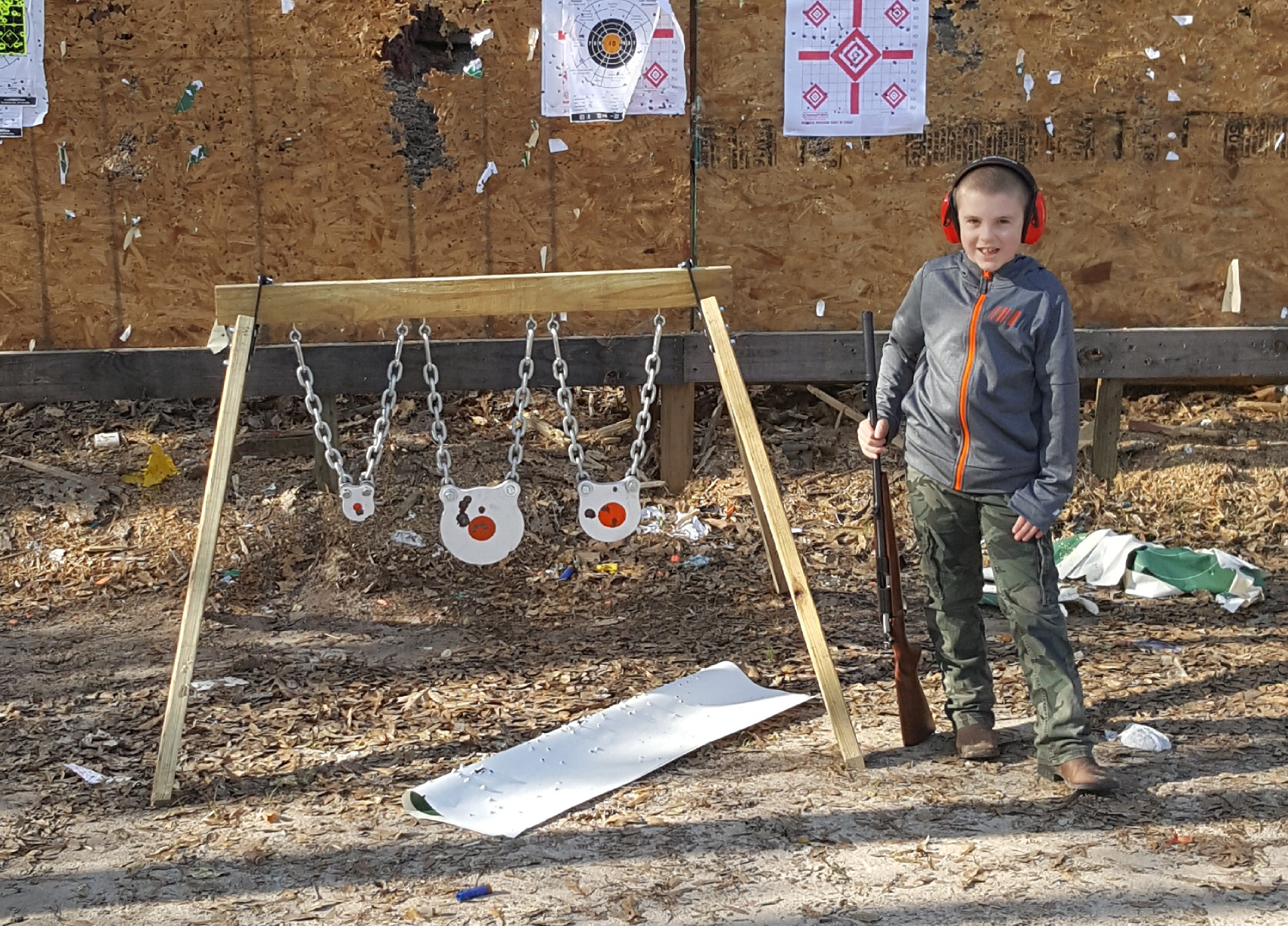

Went with the 2x4 brackets. I ordered an assortment of 1/2" AR500 gongs. I think I'm going to build one with 2"/4"/6" gongs for rifle and one with 3"/5"/8" for pistol. I want to take my 7yo shooting, but with his limited attention span shooting paper targets will get boring quickly. This should be easy enough to store in the shed and toss in the truck for range days.

I am using 2x4’s and cheap prefab folding sawhorse brackets. It works, but the 2x4’s do indeed get shredded so a regular replacement schedule is a given, frequency dictated by how often you’re using it. It’s no big cost either way, might as well just go steel from the start. I think rebar and the bracket/rubber hanger kit from JC is what I’ll get next.

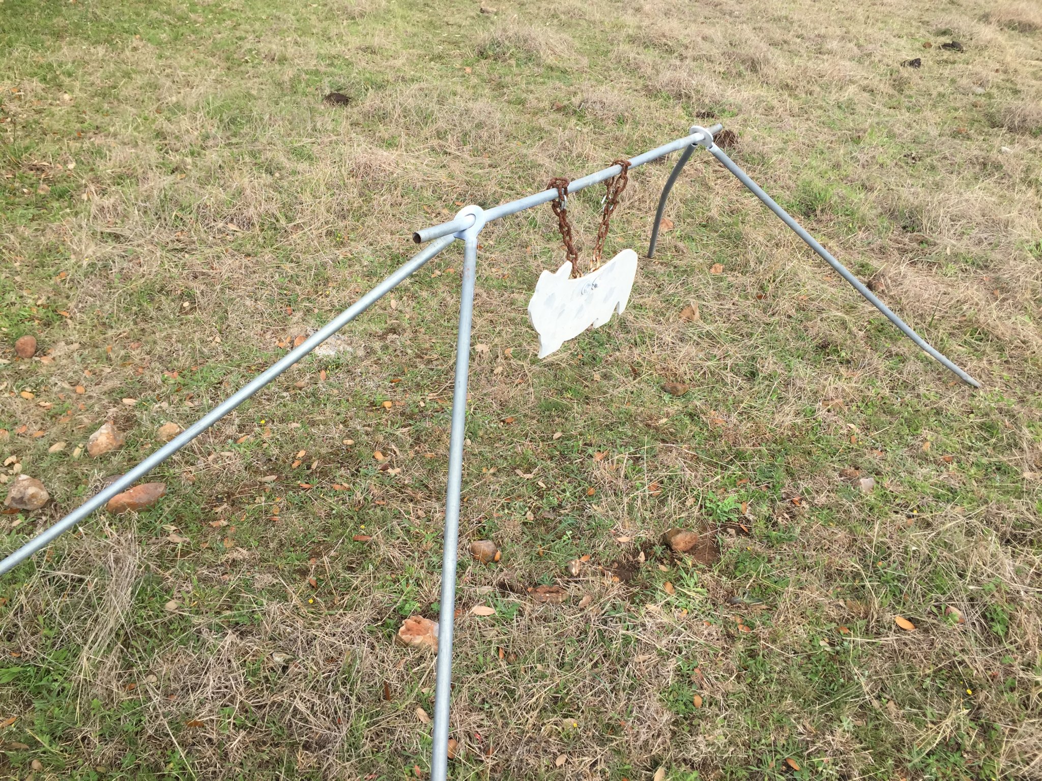

I’ve got one of these rebar setups & it works really well. I’ve not had any issues w/ it falling over, tipping, etc. I hang a 25% IPSC from mine. I don’t pound the legs into the dirt. I just set it up & forget about it.
It is way easier to haul and set up a bunch of targets with rebar or pipe, 2 or 4x4"s get to be a PIA. Plus, buying tubing to hold either accounts for a good share of the stand material.

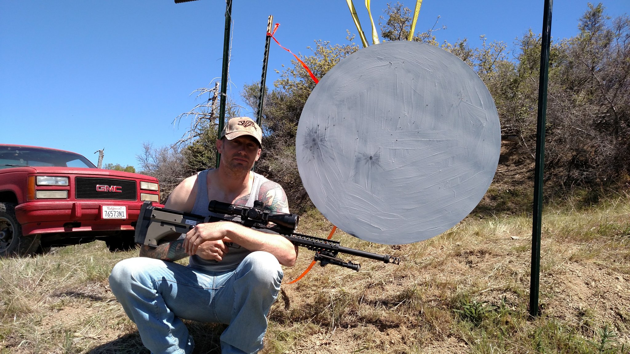

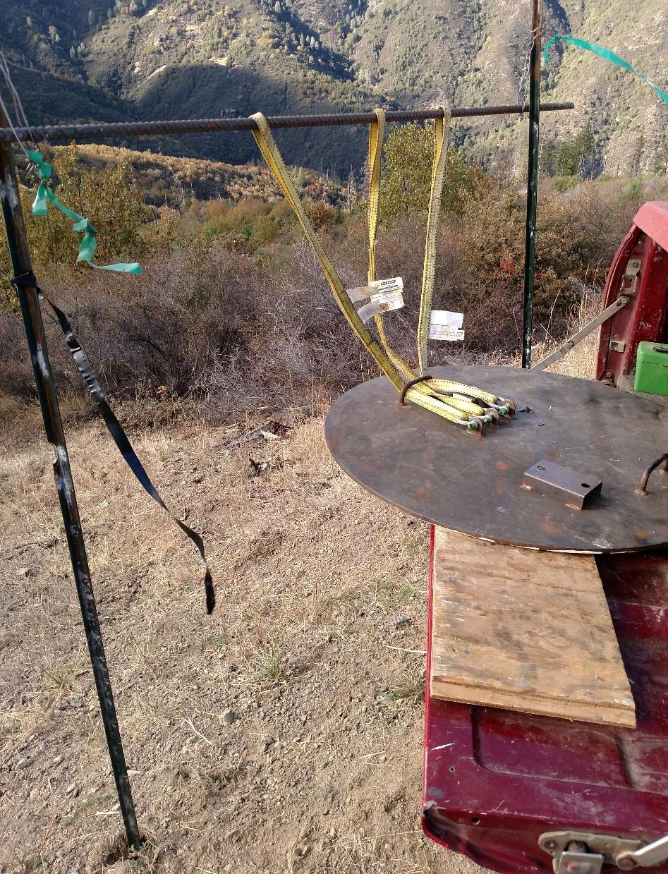

I use steel fenceposts or T posts driven into the ground as my uprights and rebar as my crossbar. I use good wire as a loop for holding the crossbar.
It is actually kind of tough to drill a T post so do it ahead of time.

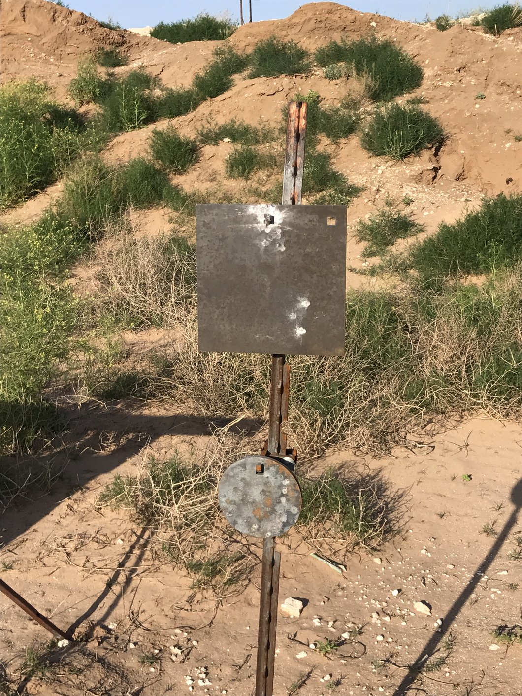

I use several different set ups, I’m not really partial to one over the other. One thing is for sure though, whatever you use keep extra parts with you when you go to the range as mentioned above. I also keep a bag of extra nuts and bolts for hanging the actual target, most of that stuff can endure lots of splashes but not very many direct hits if at all

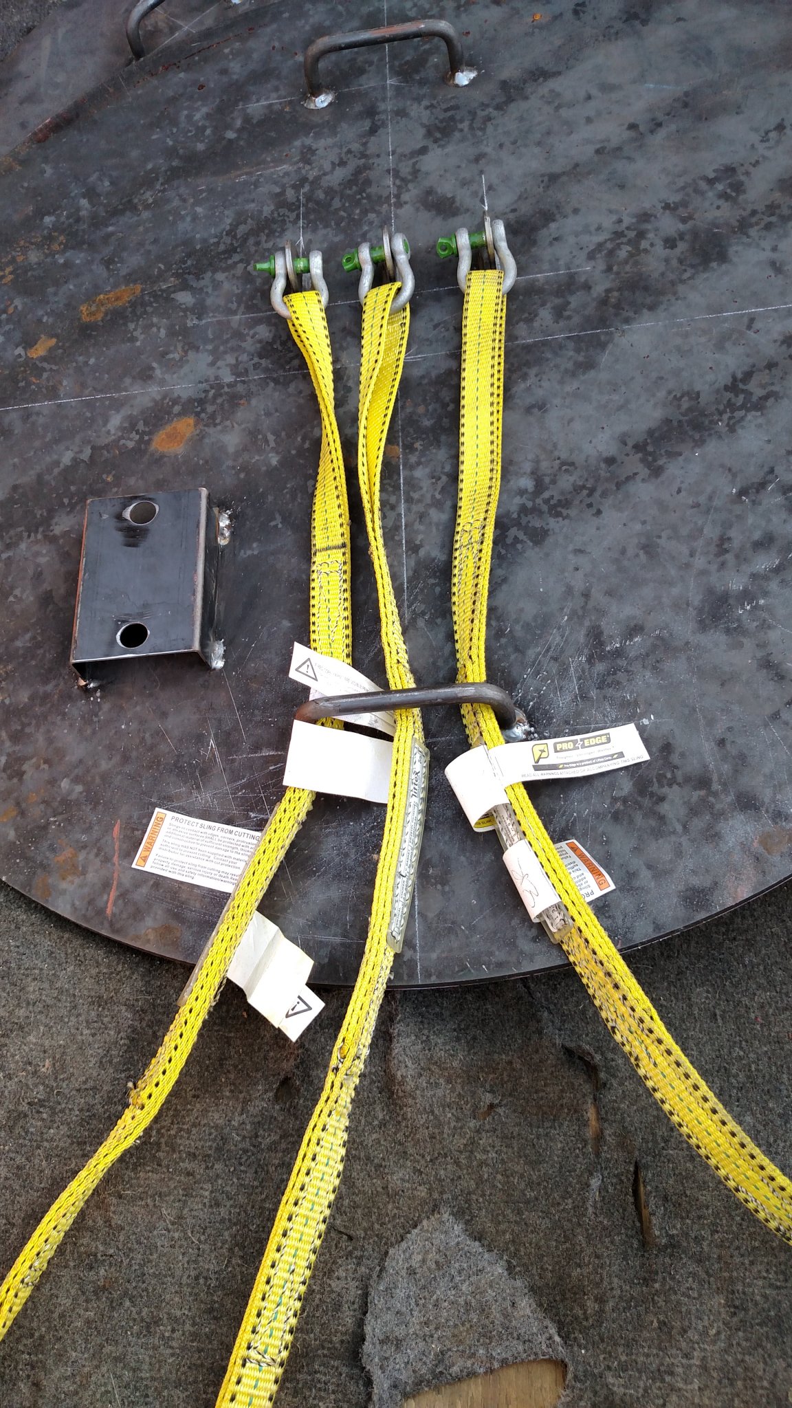

Here is a picture of the back of one of our long-range gongs.
It has two welded on handles because it weighs 118 pounds.
We use Roberts Tactical lights so a stand was welded on to hold the motion detector. We put a foam strip between the motion detector and the steel mount because the vibration will rattle the detector apart.
If you use the velcro light detector T1000 it is a good idea to weld a retaining strap on as well.
The vibration will shake the velcro and dislodge the light after multiple hits.
If you can weld all your hardware to the back of the gong that is a huge plus in my opinion
Bolt heads on the front of the gong will get shot or the bullet splash will cut them off eventually.
So far none of the gong straps has ever been hit but everything else has.

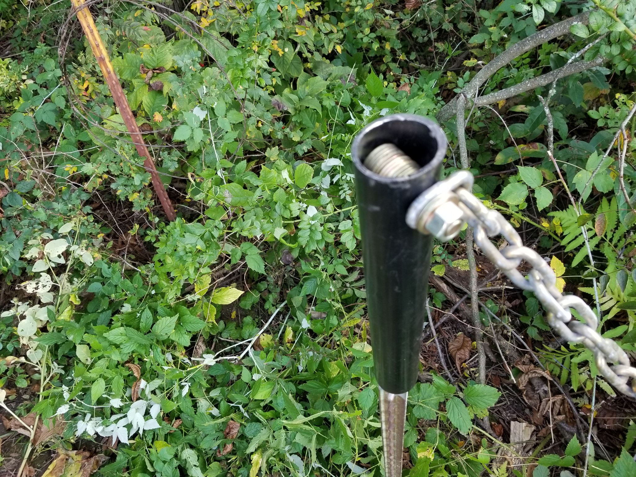

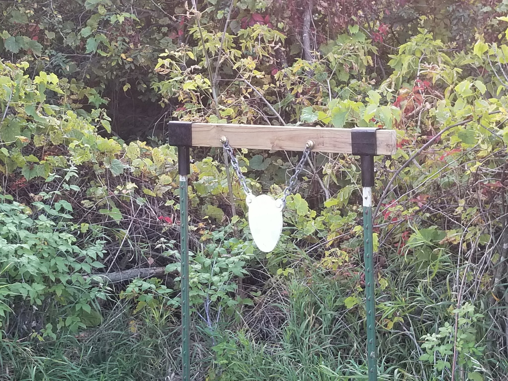

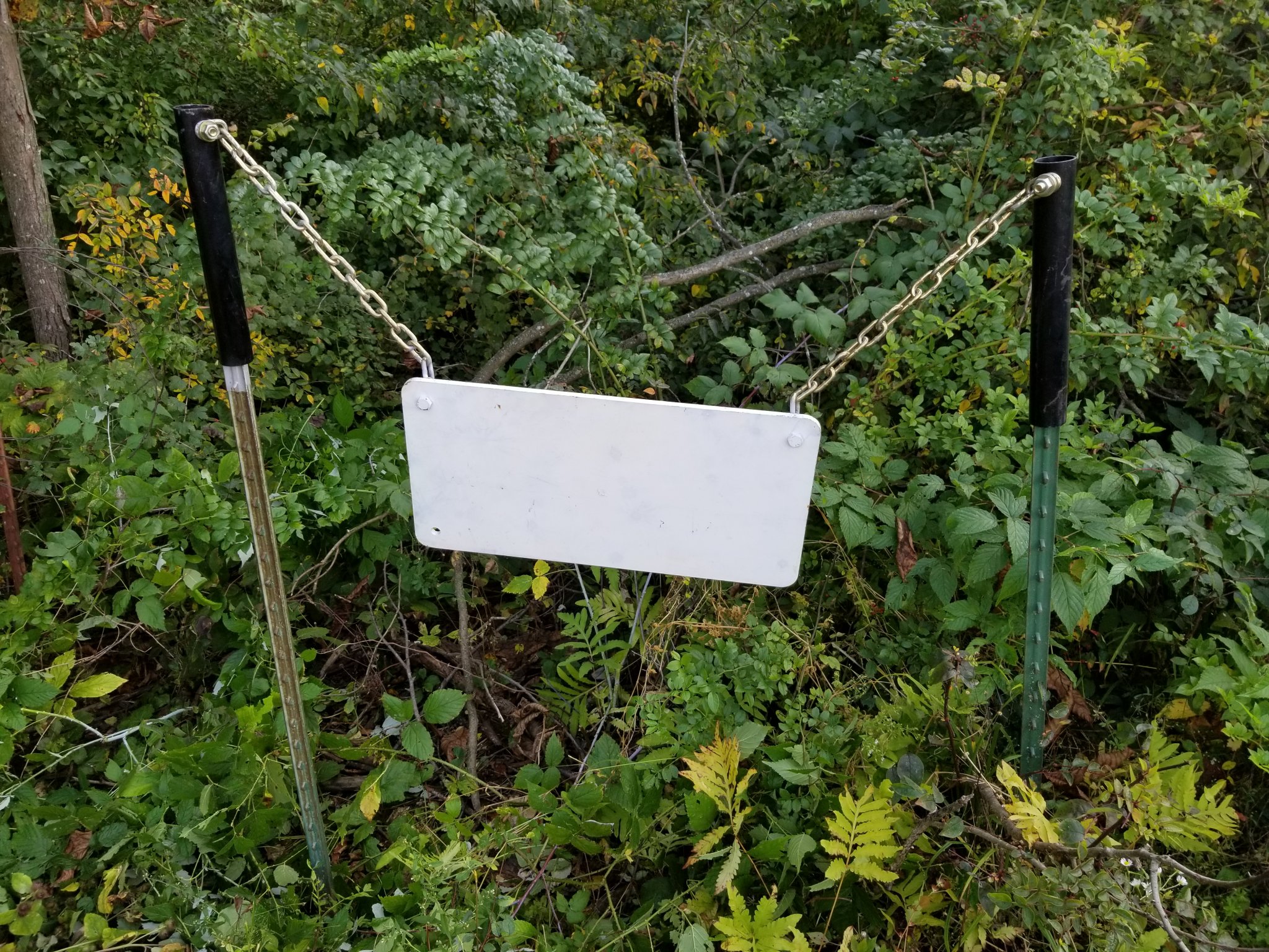

I made this hangers up for my edge of field/ bordering the woods permanent
target spots.
Stopped by a metal shop, bought some pipe with an internal ID that was
just large enough to slip over a T post
Note.. ( not all T posts are thr same size .. verify before selecting your pipe)
I also purchased some 2x4" square tubing.. 1/4" wall ( inside D of 1.5x3.5")
As pictured, i used small sections of the 2x4 tube, welded to the pipe, with
a pine 2x4 as replaceable cross board.. my intent was to use a longer board
to hold multiple sets of chain hung steel.. the target pictured is a solo target
because the ground is steep at that location.. not conducive to long span (unlevel)
The other target is simply pipe with a bolt through to hold the chain and provide
T post stop.. the washers are there to prevent pipe crush
I used 12" section of pipe, but even 4" pieces would be sufficient to easily
hold.. as the plate weight itself would keep the pipe on the T post.
They work great, and are inexpensive to set up

#5 rebar in a sawhorse design and 1.5 MOA plates (4" - 12" plates depending on the ranges I want to set) hung on 3" conveyor belt strap or 3.5" fire hose. 1/2" on the 6" and under, 3/8 on all the rest.
3 targets is abut the max I want to schlep out to 800 - the max range I can get.

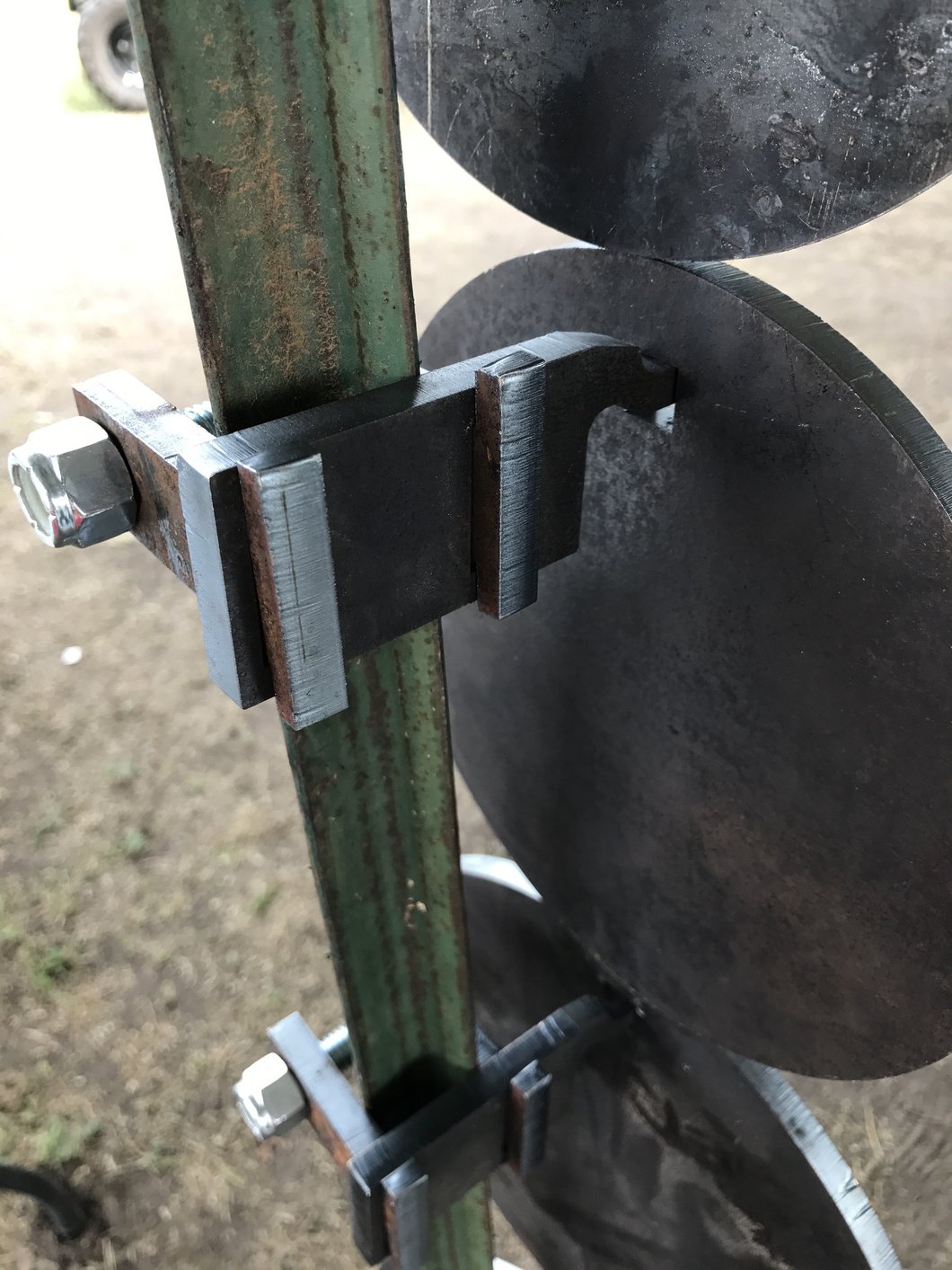

T posts 2”x2” angle and conveyor belt
The t post stay where I shoot their only about $3 bucks each...a 20’ stick of 2x2 angle about $30 bucks...conveyor belt cost me a 12 pak for 40pcs...nuts and bolts $20 bucks or so...I have at least 20 of these so they end up about $20ish each set minus the steel

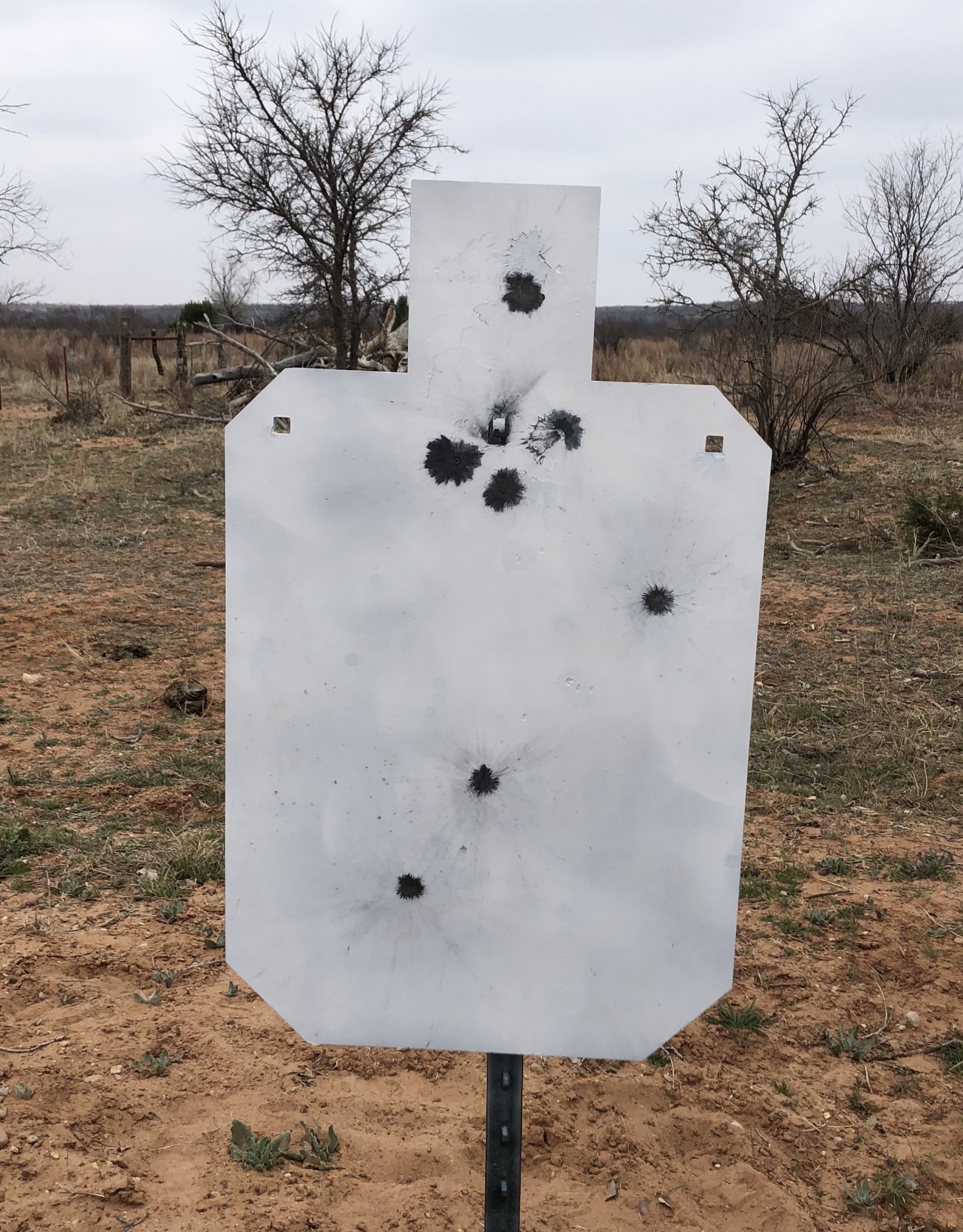

I haven’t ran into that issue yet. Most of my shooting is beyond 1000, and usually with a 6 CM. I’m guessing I just don’t have enough velocity left to damage the t post.

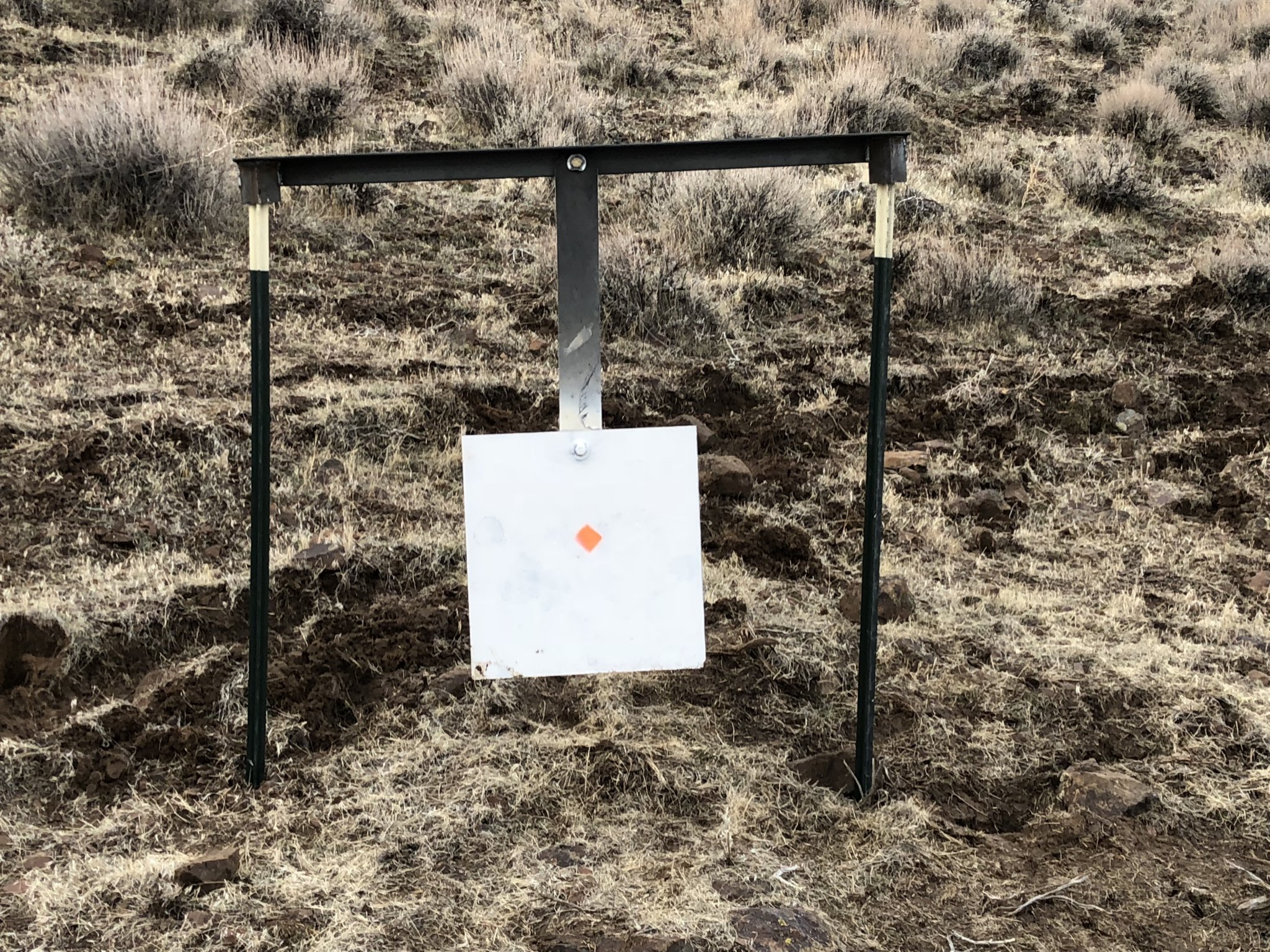

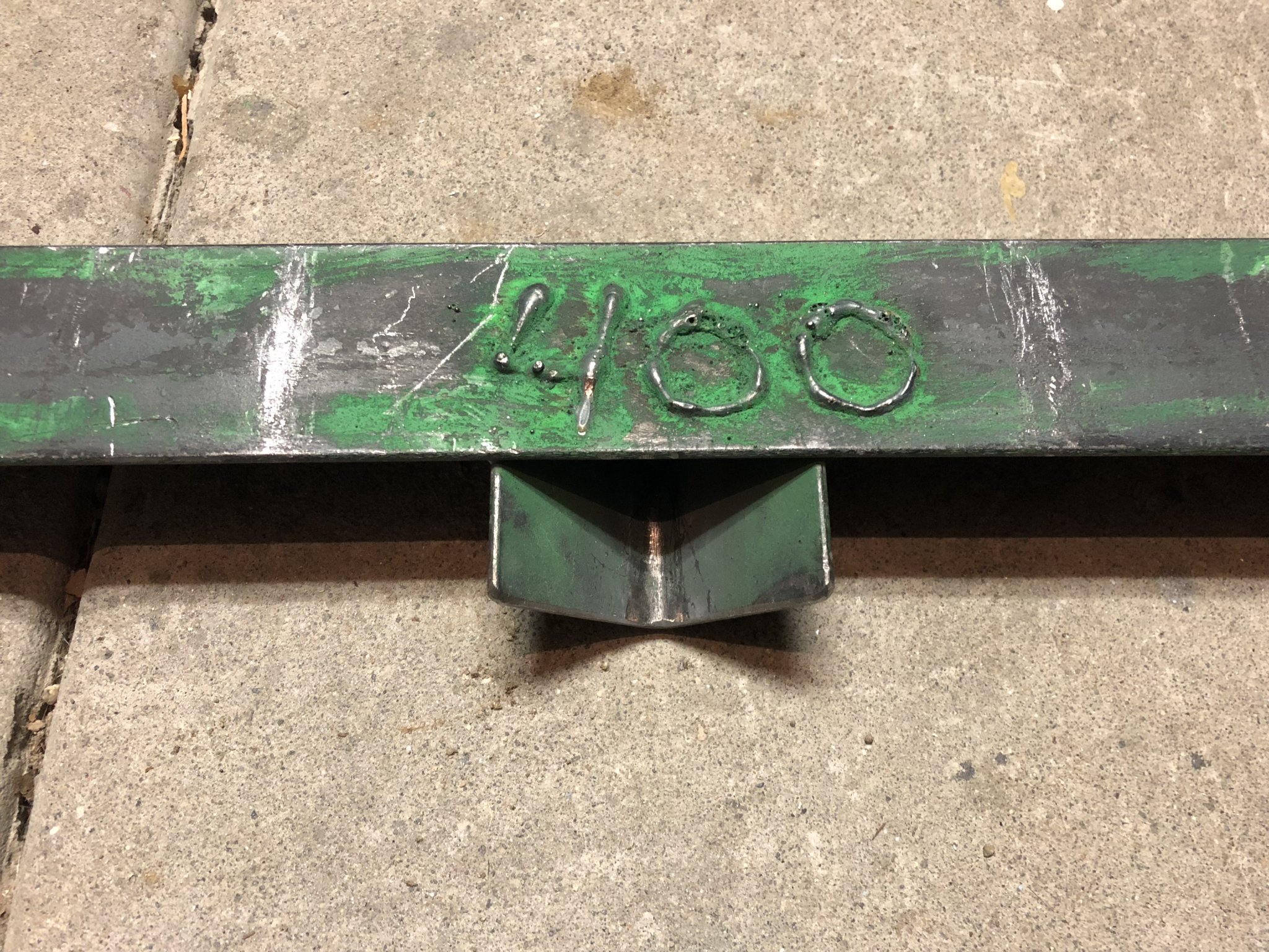

T-post are my favorite for speed of setup in most locations -not all. They only cost a couple bucks more than a 4x4. But anytime you drive them in to deep they can become almost permanent. In hard rock areas you need “stands”.

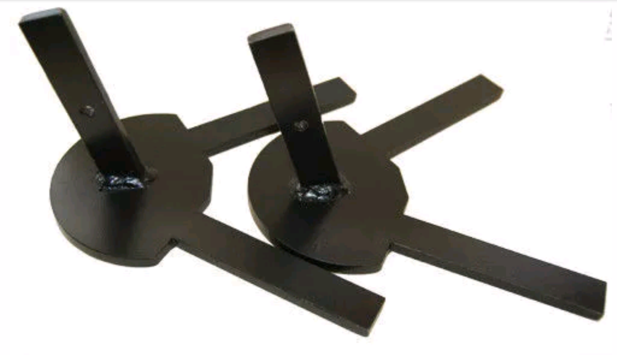

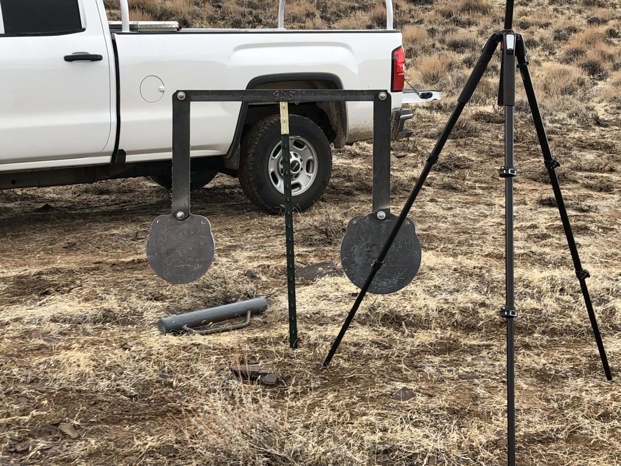

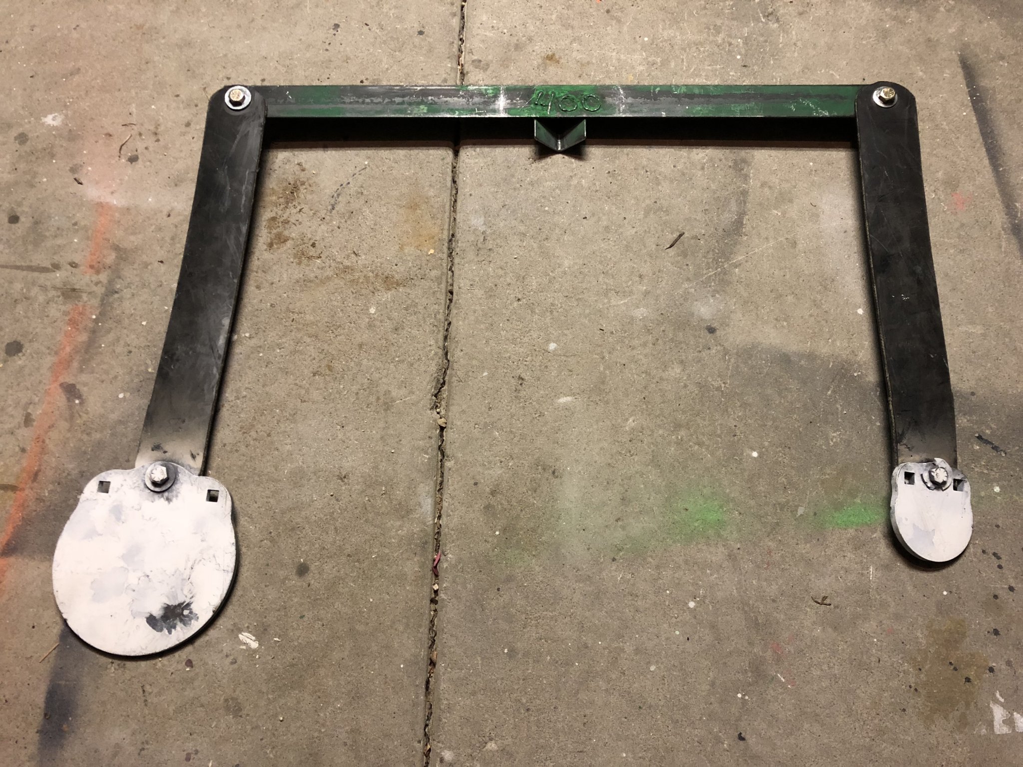

With single T-posts you have two basic off the shelf attachment types; semi-ridge and reactive. Both have their place. With reactive targets, you “need” semi-rigid, but for the most part I prefer reactive mounts.
1- Non-reactive, the standard attachments like Jake’s V at JC Steel, are fast and do not use a chain. See the first few min of the video below with the reactive 45%, I think the flapper is 6" but the target must remain relatively level for it to work.
7041521
bracket link: http://www.jcsteeltargets.com
2- Reactive Hangers like Hangfast. These allow the targets to move when hit and will ring much loader, the angle makes for better frag signature as well as let’s the plates take a much higher caliber hit, closer without damage and lastly the plates move more, so it is easier to see when far away.. These easily hold my 24” AR500 1/4” plate. Scrub, thru the video below to see how much a full sized plate moves compared to a rigid mount even when closer and much smaller. The left image, right target is a 24" plate easily controlled by the hangfast setup

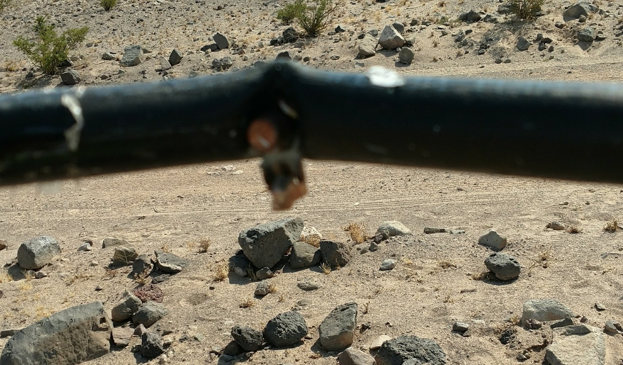

Thats the idea. Chain can get broke off with one perfectly bad shot, the rubber can absorb many more before getting cut off.
At most matches use fire hose, conveyor belting etc.. for just the reason you mentioned or but most targets are close enough and small enough like a 6" diamond at 400 or ipsc silhouette at 1000+; so they tend to be light enough to react.
I use chain protected behind the target with the Hangfast or hardened chain for ELR without incidence. Again, because they help the targets really ring and move freely. ELR for instance, a High BC bullet like a Warner FL 338 has only a hair < 1/6th it's energy left by 2k, so the hardened chains hold up well even if exposed.
Got about 50 ft of used conveyor belt (3 ft wide) a few years ago and have everything from full size IPSC down to 2 inch (challenge) target hanging on the rubber belt. Works great!
Yes, you can wear it out (2 inch at 500 yd proves it) but safest hanger I’ve found.
