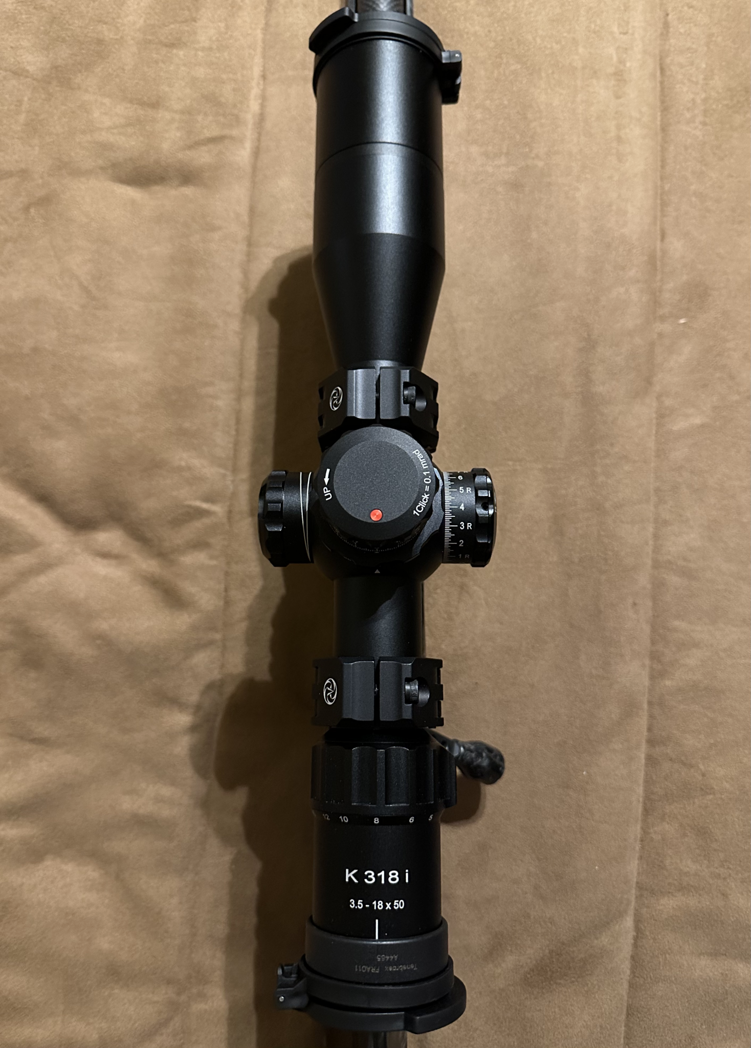

I have a k16i on a different build and absolutely love it, that’s why I started off looking at the 318i
The K318i is a solid hunting scope. They offer other reticles. Just go to EuroOptic and check them out. Personally, I prefer CCW & RSW scopes (American style), but they also have some CW & LSW scopes on their site, too. Give them a call and talk to Clay Hawkins, tell him Troy sent you.

@Dan65 I wouldn't overlook the K318i, it really is a great hunting scope with a good FOV and image. You own Kahles, so you know what i'm taking about. But I also have an LRP S3, and like Rob said, it's a lot of scope for the money. I think if I had to choose between the 2, I would go K318i if I wasn't opposed to spending the top of my budget, but if I wanted to spend less, the LRP S3 4.5-25x50 would make for an excellent scope, as well. They're both great.
