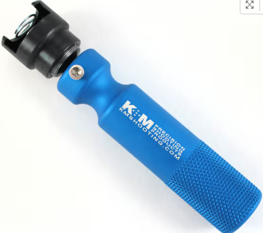

    This will safe your hands.
    Yes. I bought one of those for my friend with the arthritis. He tried it and ended up he prefers using my Henderson.
    I thank God I don't have arthritis when I see what his life is like.....
    I still use it for the rare occasion of working with very short cases or 300 BO, but I have the handle on it.
    If you have the Giraud and play with cases that are painful to hand hold, I would give this a try.
