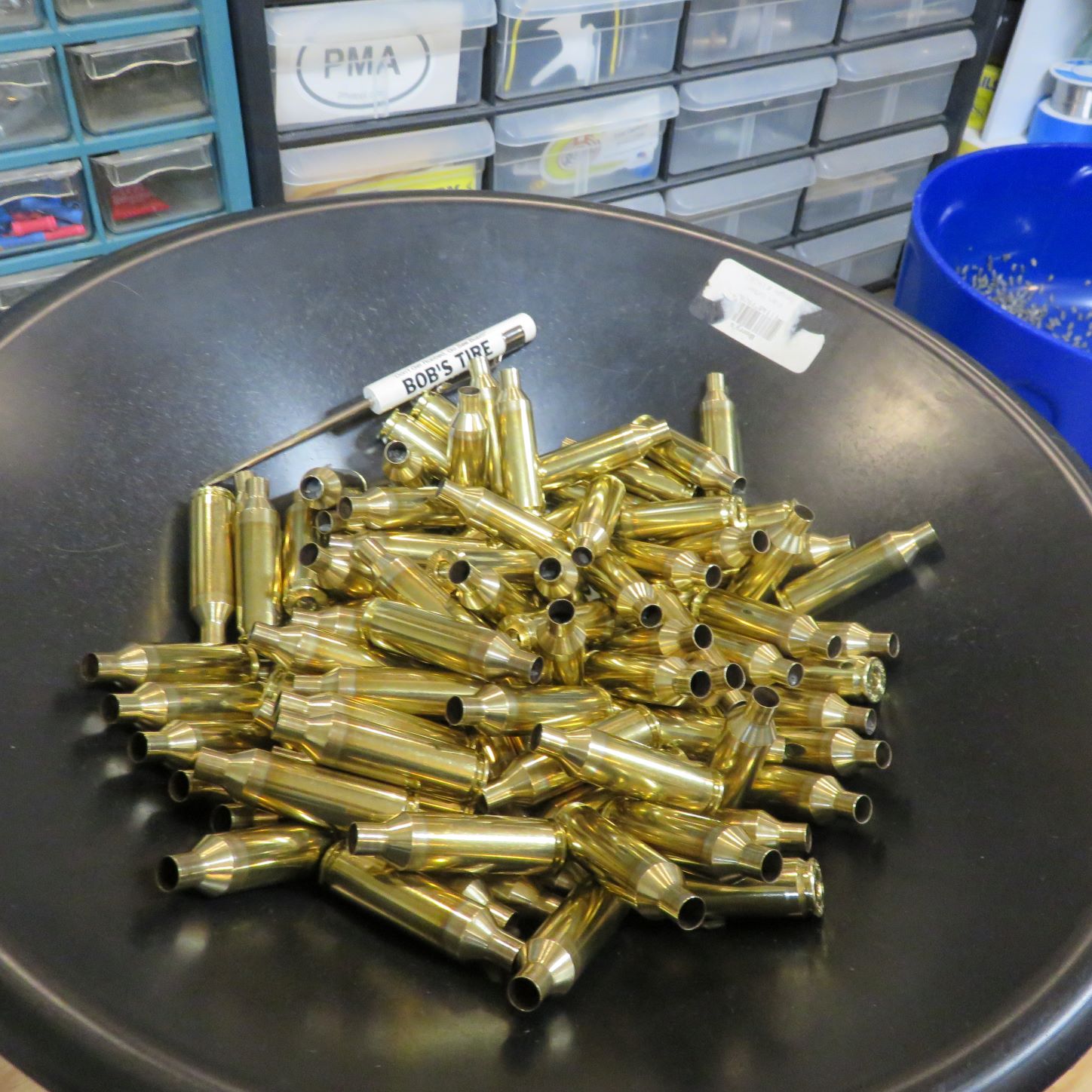

I hope someone will make a device that will wipe the cases with alcohol. that's my longest, most boring phase right now.
that's a good idea. what material is best to remove the Imperial Sizing Wax?
I highly recommend rice . . . medium grain rice, not long grain rice. It does a great job for me in removing Imperial Sizing Die Wax and I never have an issue with dust that other media often presents as an issue.

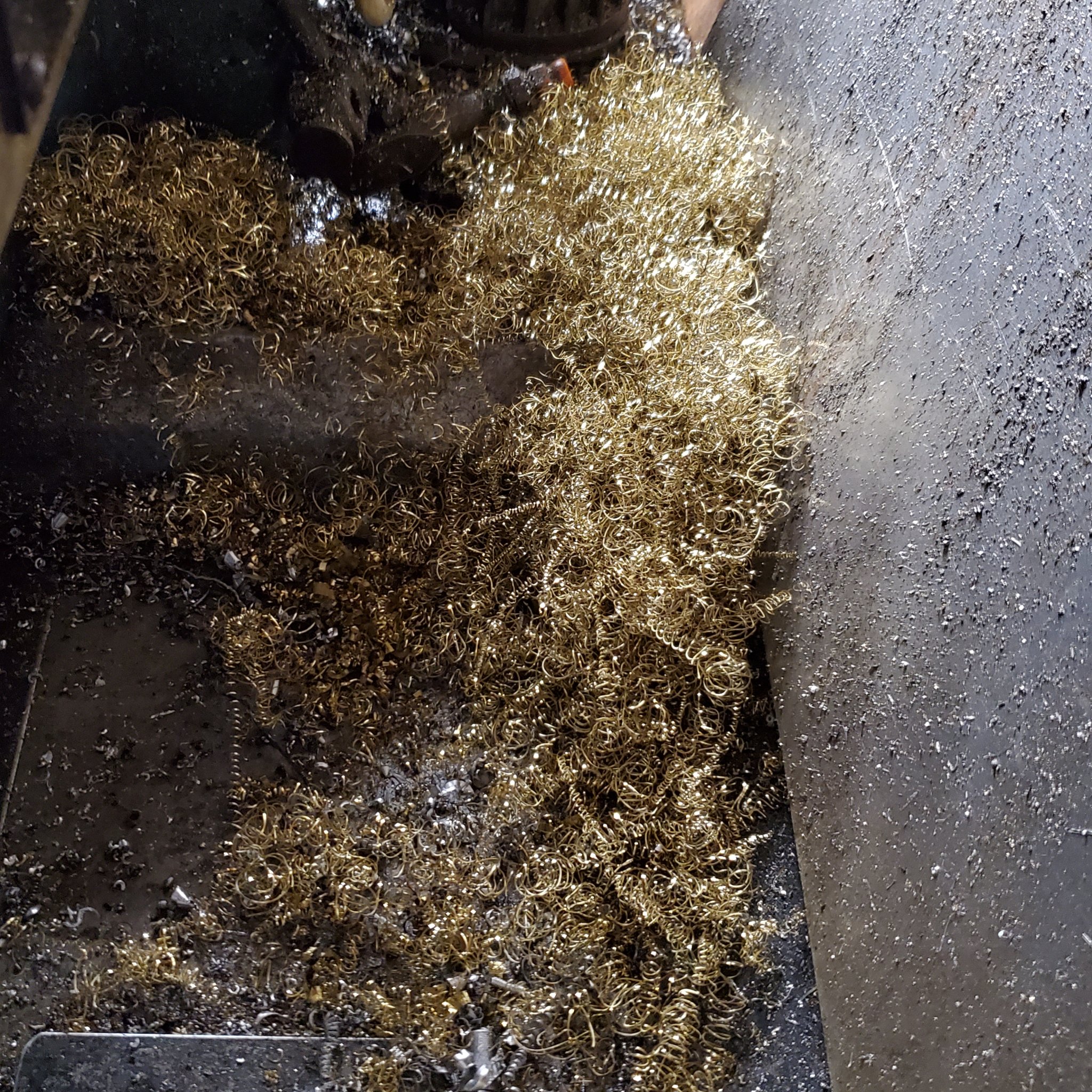

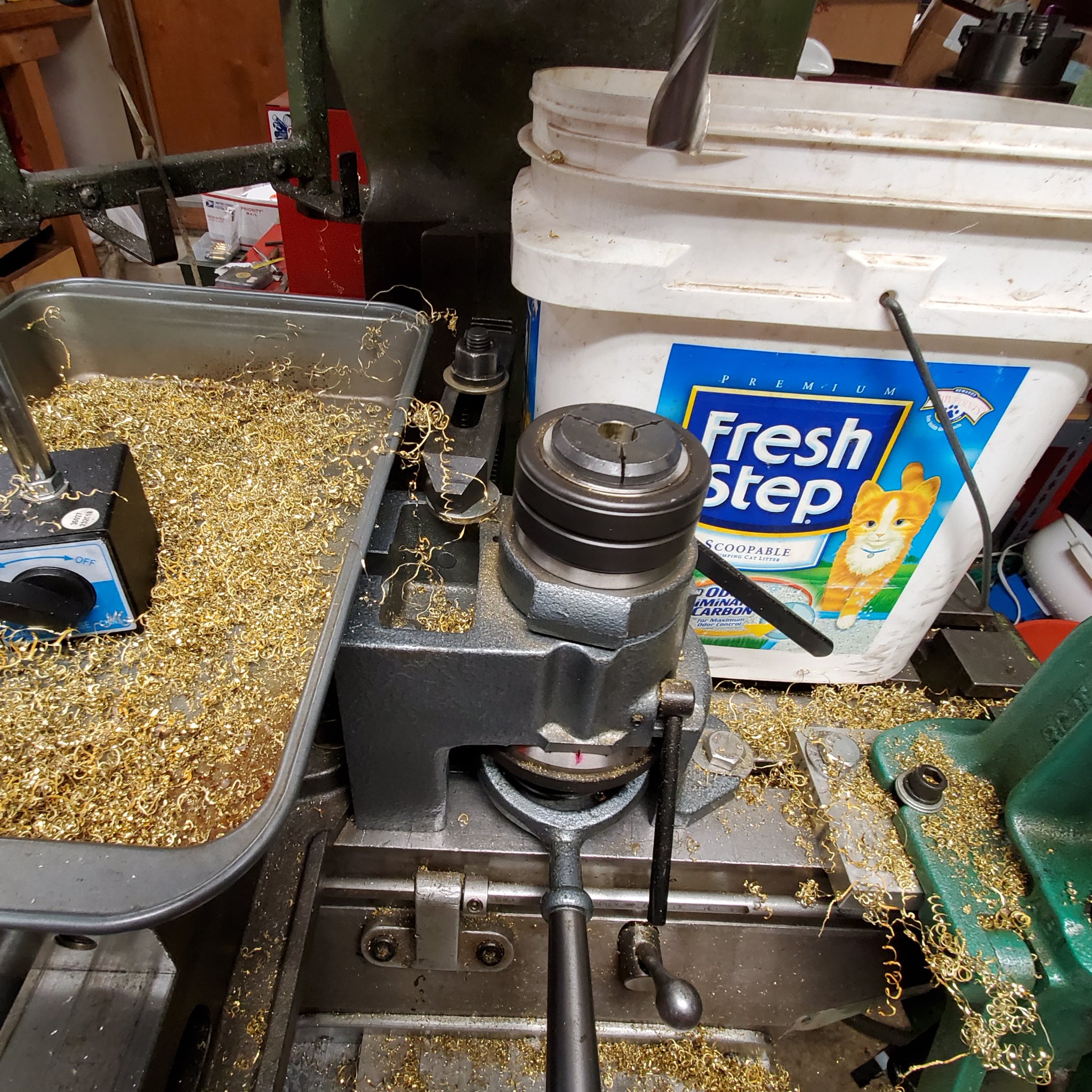

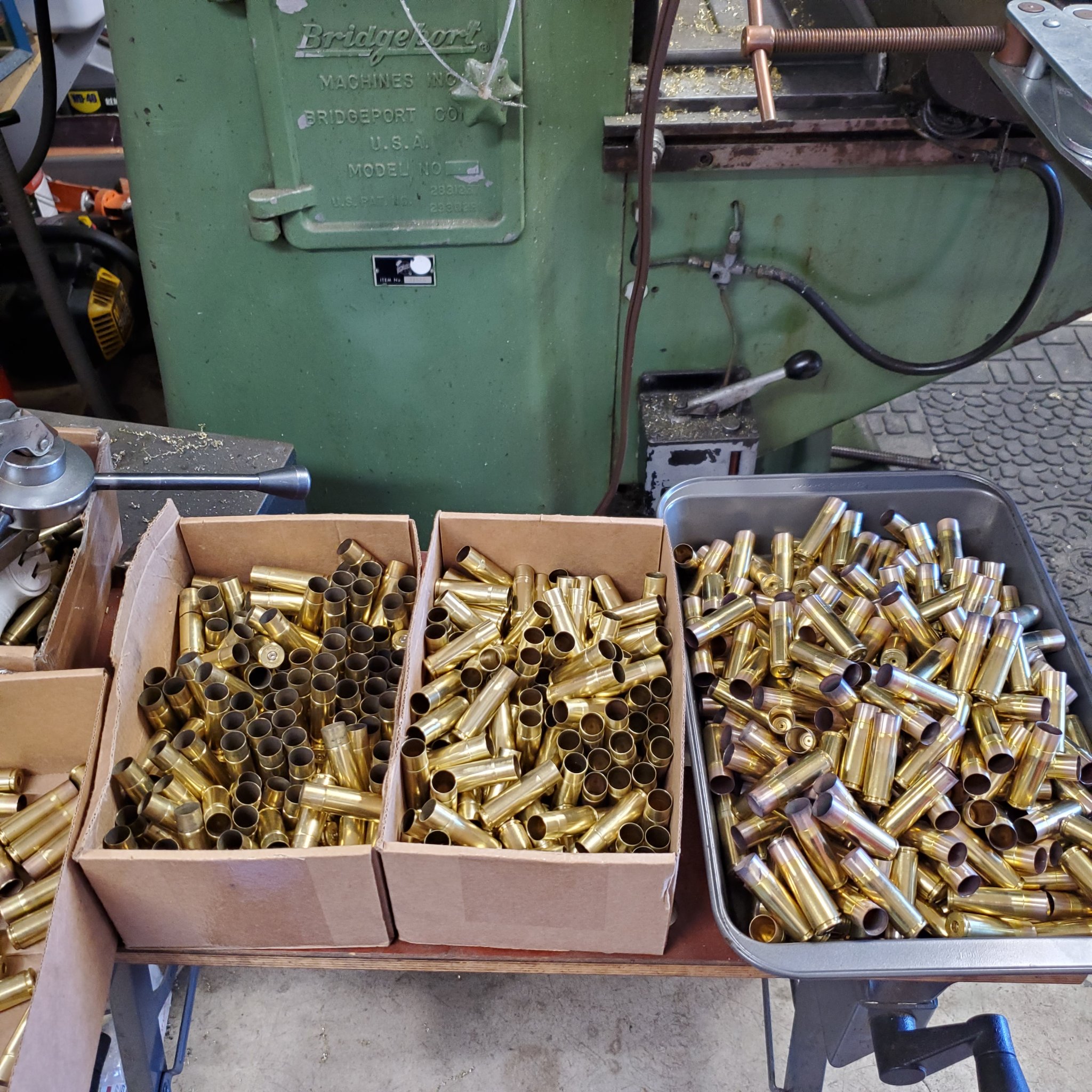

I use machine tools for jobs that require 1/4" to 1/2" or more of case trimming, in a Bridgeport mill, for serious trimming jobs.
Plunge cut that 1/2" in about a second.
Along with some serious neck turning, and annealing, here is 800 pcs of the 900 completed .510 Whisper.
Power tools for large quantities just makes sense...plus the quick and accuracy aspect many provide.
The Bridgeport set up works great for 50BMG shooters and wildcatting as well.

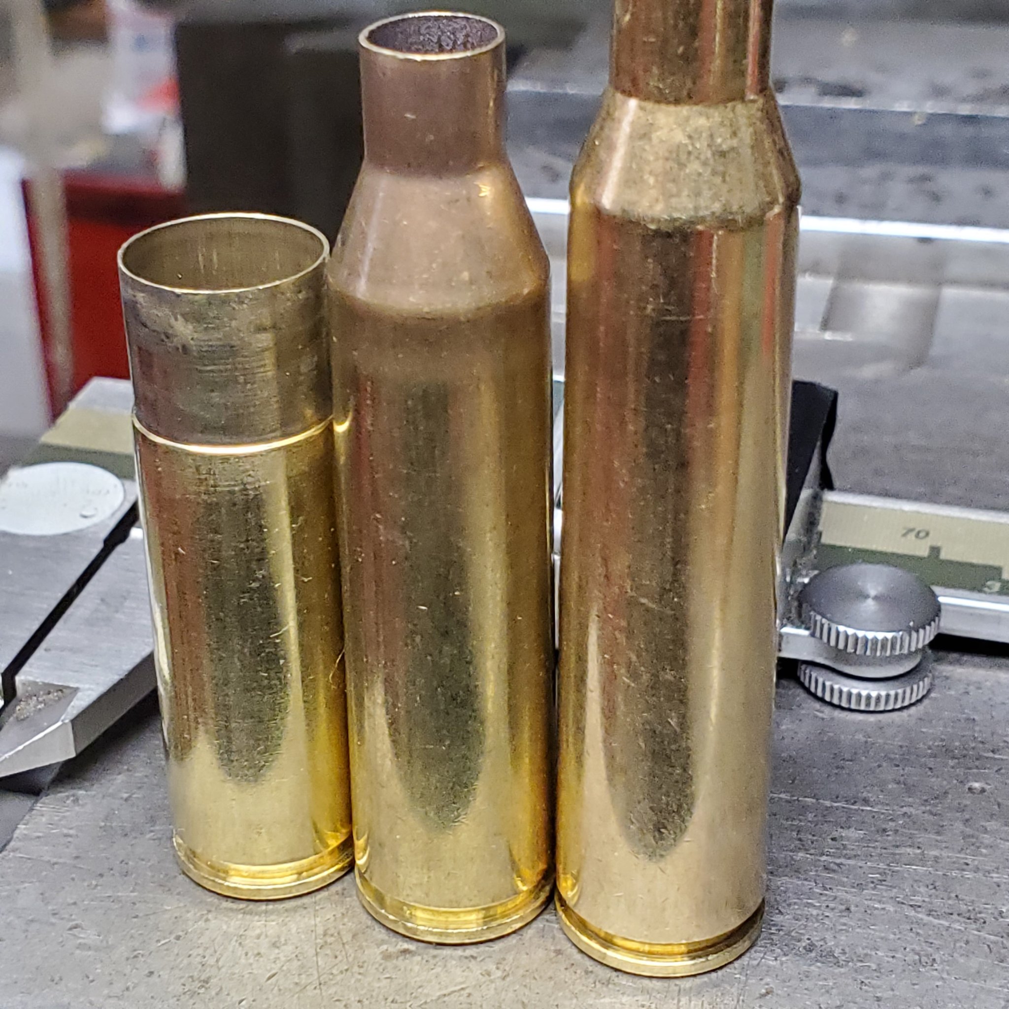

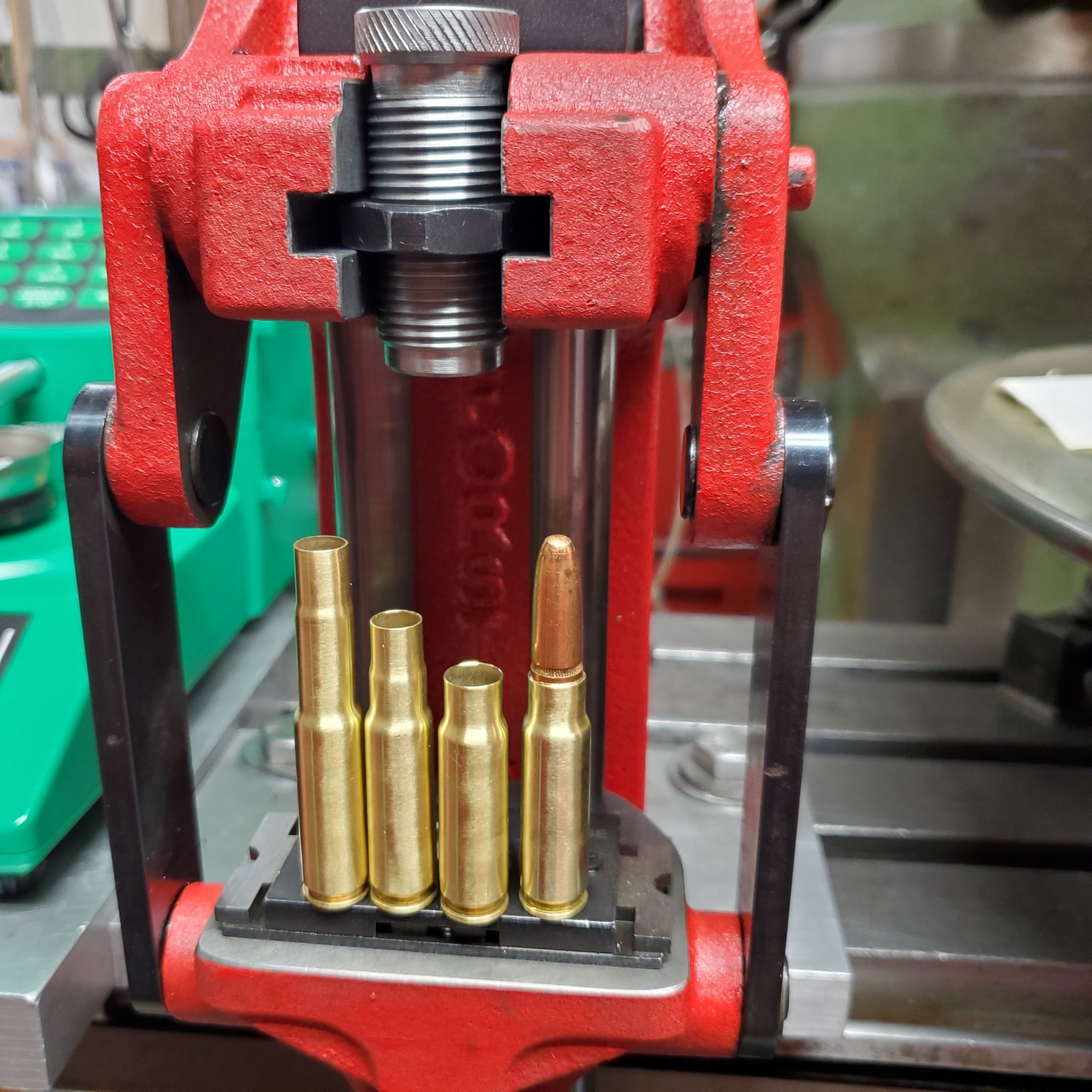

Jesus you have to trim 1/2 an inch off your brass? After how many firings or is this part of the forming process?
It's forming, depending on the parent case as to how much must be timmed off.
Example the parent case is 2.5" to 1.675".

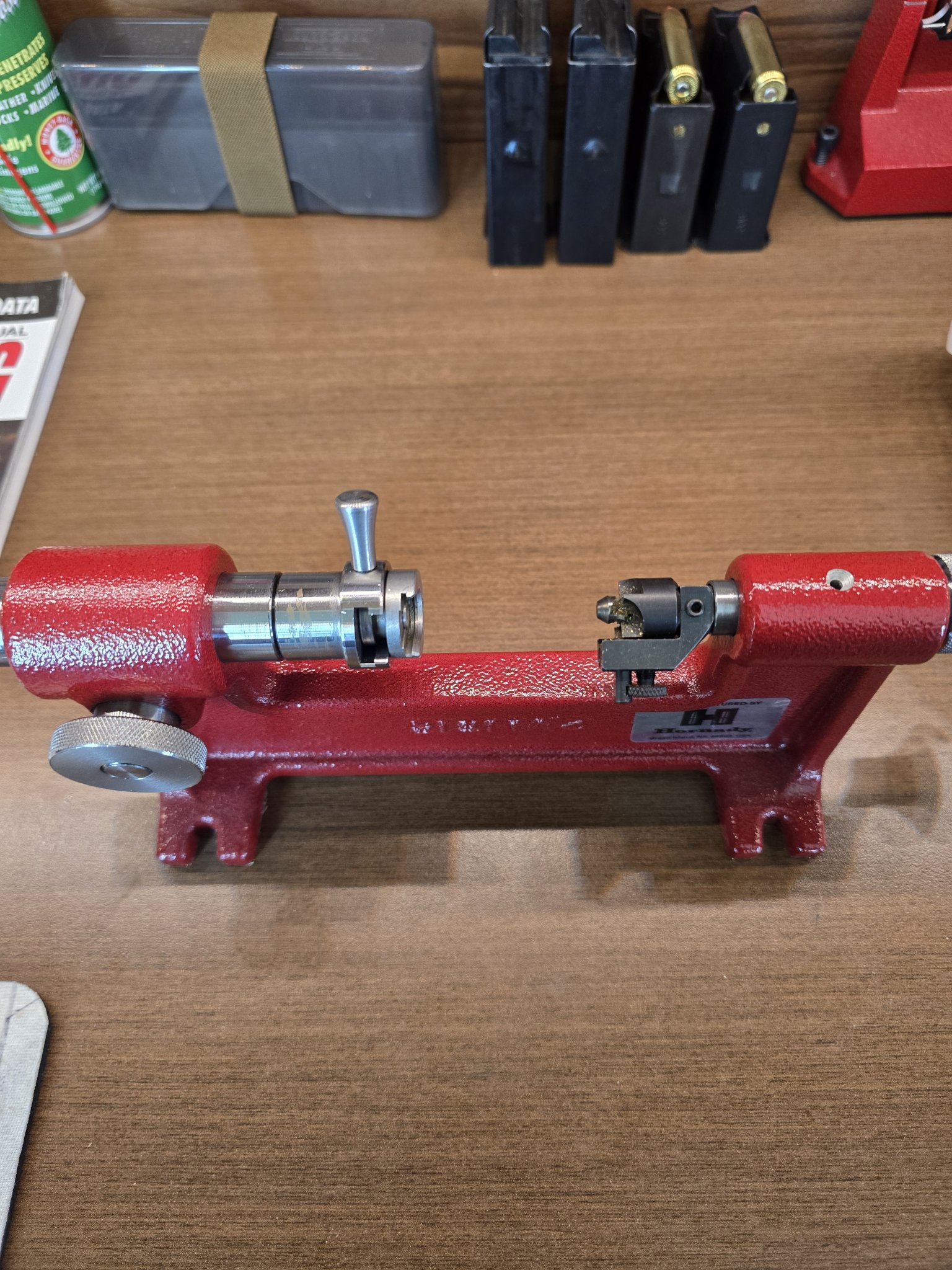

For the Hornady 3-1 trimmer, does anyone know if you have to adjust the chamfer and debur on each cutter body everytime you change calibers? If not, then does it come set up and you just need to adjust the case trim length only? Manual mentions trim length but does not mention cutter set up to change the chamfer and debur angles etc. for the record, I don’t want to have to mess with those angles at all. I went through a lot of brass on the Giraud when I messed with it to much last time.
