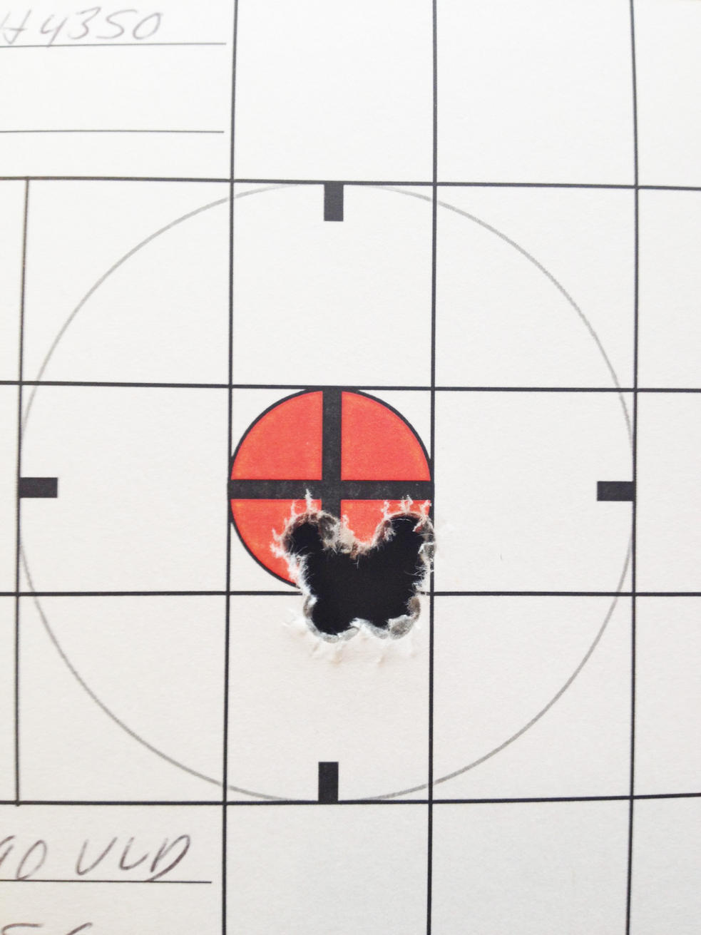

Here is just a sample recipe of one of my 30-06 loads and by no means would this load produce the same results it does for me in all rifles. I am simply posting it to show you the difference between a precision recipe and a non precision one:
1x fire-formed Lapua Brass trimed to 2.48 and weight sorted to 194 to 194.5 grains
Neck turn the case to .009" of wall thickness and then neck size .002 under (.306 inside neck diameter)
Primer pocket squared and flash hole opened up .002 and deburred both sides
190 Grain Berger VLD with the meplat uniformed
57.2 grains of H4350
Federal 210 Match primer
COAL .005 off the lands
That load produced this 10 shot group at 100 yards. I proof all my final work ups with 10 consecutive rounds to see the effects heat will have as the barrel warms up. Temp sensitive powders like RL22 will show an increase in the vertical when the chamber is hot. H4350, not so much.
Measured from center of round to center of round, this group was .38" and shot from that rifle I shared a pic of at the top of this page.
