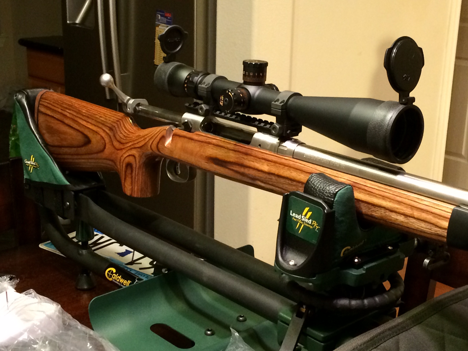

[MENTION=49404]Tx_Flyboy[/MENTION]: love pics of rifles, do you have any of yours you can share?
Thanks for the clarification. Did not realize you intended to hunt suppressed.
I also have an AAC Cyclone that i;m waiting for the Form4 to be approved...it may also accompany me on my hunts.
You asked for pictures, so see below.

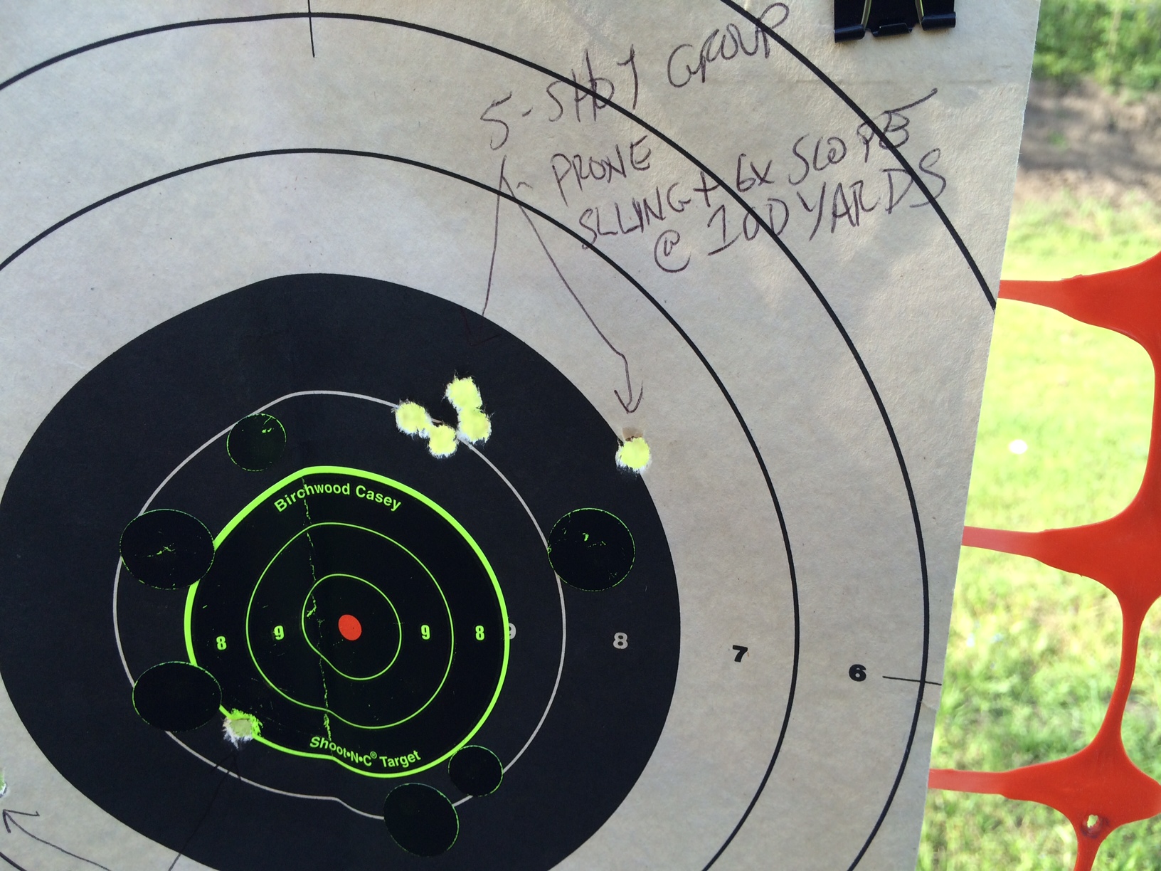

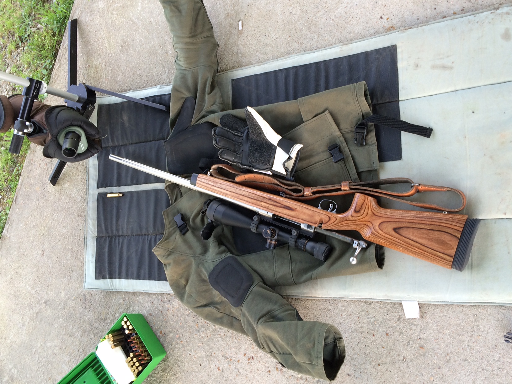

One more try. I also shoot competitively. My area of shooting is Highpower rifle shooting,prone (F-class style) shooting and NRA Long range. All my shooting though is done with iron sights, at bullseye targets from 200yards to 1,000yards. While I'm no nationally recognized shooter, or high master, I've shot enough matches and fired many thousands of rounds in these comps to know a little bit about the barrel length issue.
I've also witnessed many new shooters that spent too much time on Internet forums come out to our matches with their "16-20in sub-MOA all day, if I do my part rifles" and realize that their set-ups leads them to drop points that would not have been lost if they had the proper tools (longer barrel) for the job.
Those r my "data points".

My savage factory barrel is amazing!

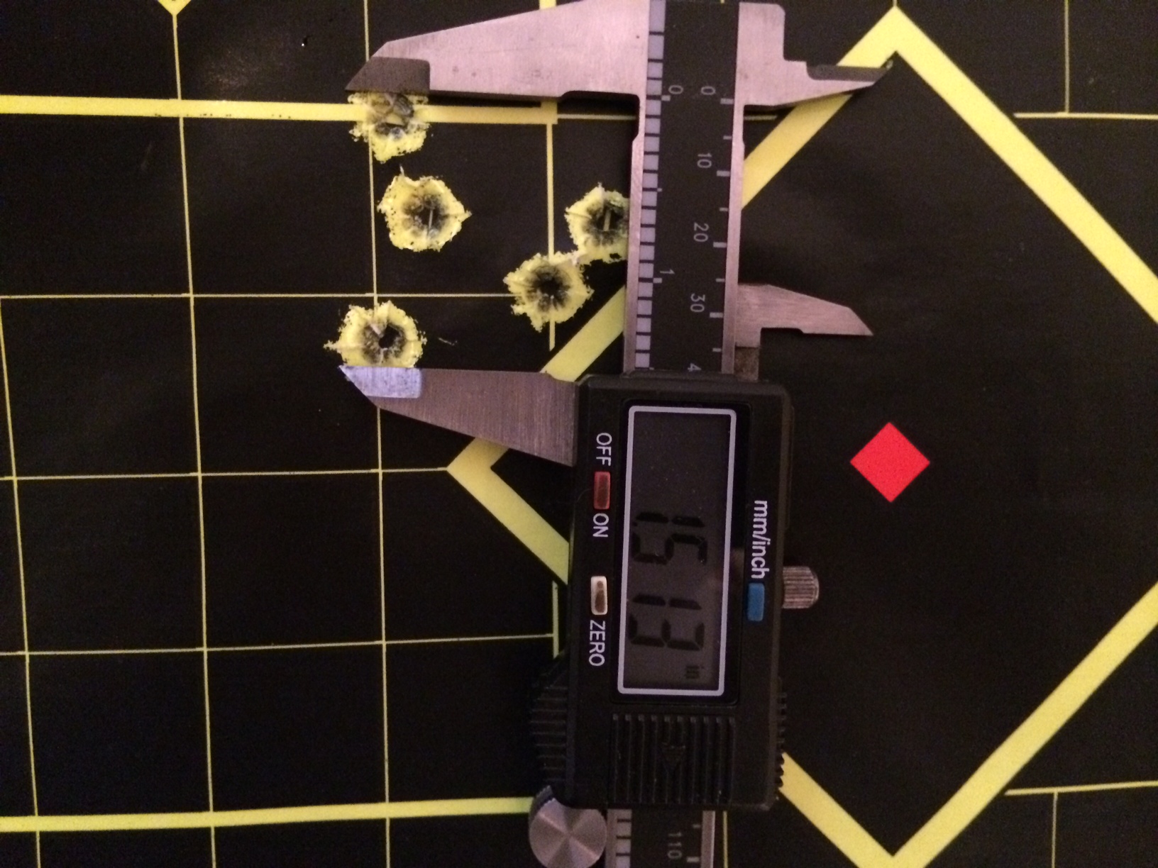

Yep, will be a pre fit manufactured by criterion, they will be reaming the chamber. I'll ask them about the Serengeti reamer. What do you mean "175 & 185's be unable to reach the lands"?
Placed the order for the Criterion barrel today...feels good to finally put that past me! 24", varmint contour, 1:10, recessed crown, stainless bead blast, 5/8x24 threaded. Now I have 4 months to wait :(.
Criterion only offered one choice for a reamer. They said they use a "hunting freebore", I'm guessing that this is a short freebore and will limit the maximum bullet weight I can use. Does anyone see any issues with using bullets up to 200 grain with this type of freebore? Unfortunately I can't tell you the exact freebore distance, I've requested the print for the reamer they're using but haven't received it yet. I can tell you the following:
Neck diameter = 0.3404"
Throat = 0.3106
Thanks for your order! I attempted to forward the requested reamer print earlier this afternoon. Please let me know if it didn't make it into your inbox. Hopefully that helps answer your question, but if it doesn't do the trick please let me know. In the meantime we'll get to work on that order. It just crossed my desk and will be added to the next batch scheduled to begin production.
-Josh
.....24", varmint contour, 1:10, recessed crown, stainless bead blast, 5/8x24 threaded......
Great choice in my opinion.
