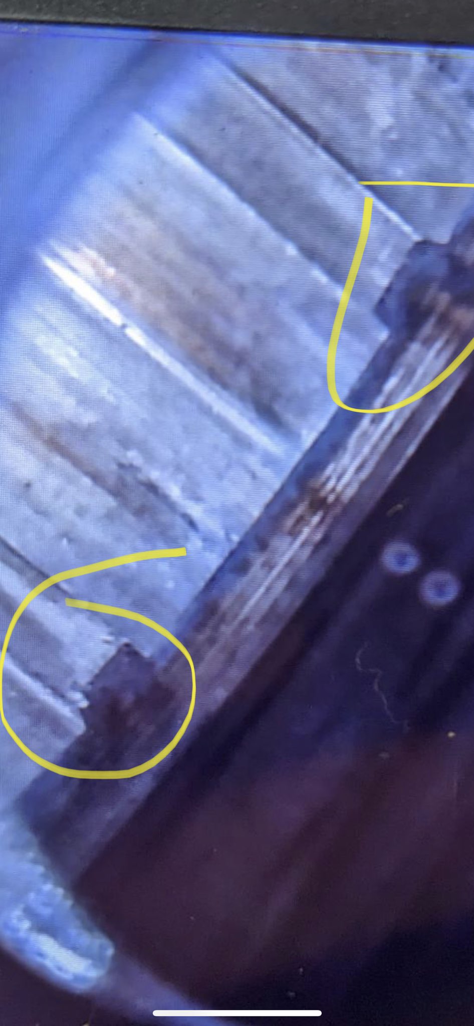

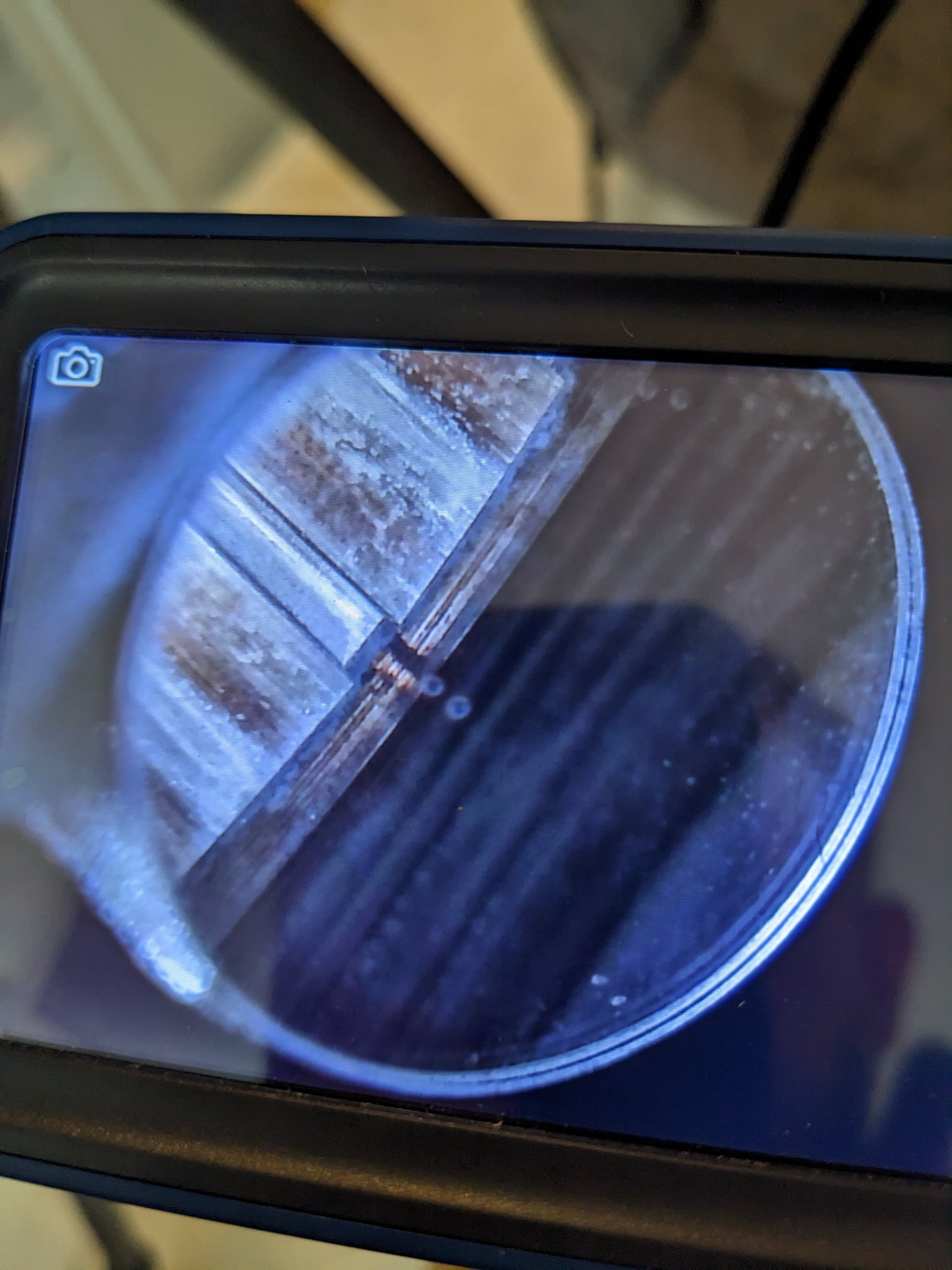

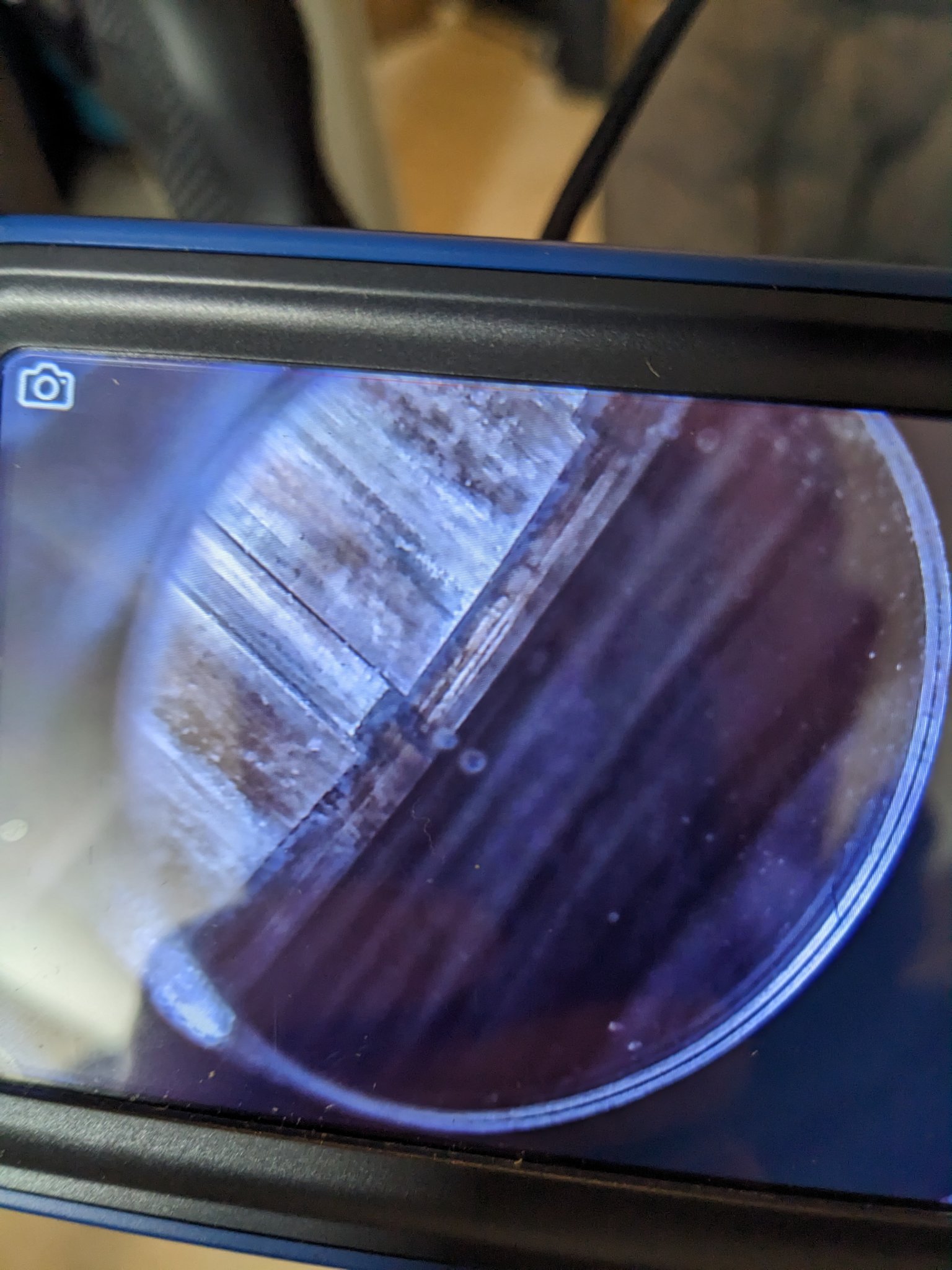

    Not sure this helps accuracy. Back to the local Smith who cut it.
