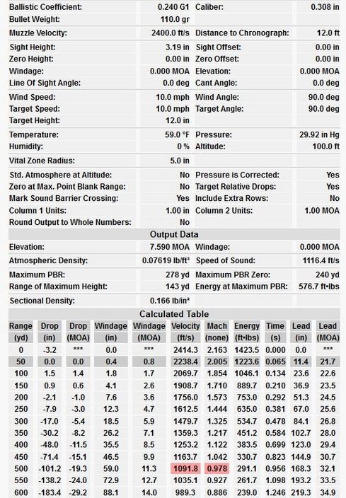

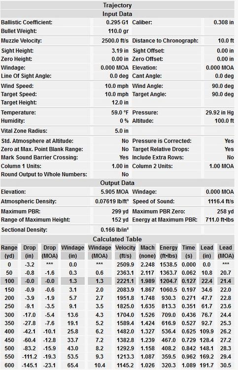

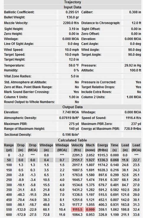

We may as well cover the full spectrum of bullet weights:
110 V-Max from a 16 inch 308 is 2857 fps.
Hornadyle.com - 110 gr. TAP URBAN®
300 Whisper is 2375 fps. In 300 BLK it can do over 2400 fps at 55,000 psi, but we can go with 2375 to be conservative.
Hornady Manufacturing Company :: Ammunition :: Rifle :: Choose by Caliber :: 300 Whisper® :: 300 Whisper® 110 gr V-MAX®
Using a BC of 0.295, the 308 will drop to the 300 BLK velocity at 125 yards or 114 meters.
So there you go - depending on the load, 300 BLK loses between 114 and 238 meters in range compared to whatever you consider the range of 308 to be.
