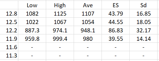

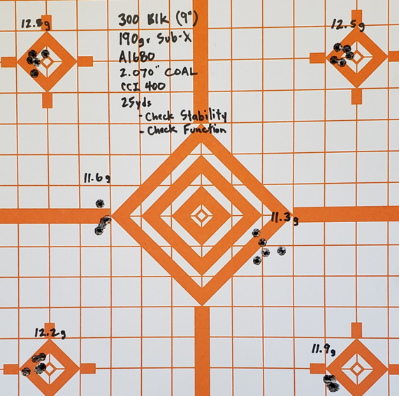

300 AAC Blk, 9" Ballistics Advantage Barrel
Hornady 190 grain Sub-X
FC12 cases
CCI 400
A1680
2.070" COAL
Five cartridges of each charge weight were fired. I believe the 12.2g charge numbers are whacked due to an extra shot in the string when checking the chronograph results after shooting; like there was an extra shot from some previous data stored in the string or something. All loads functioned properly with ejected brass landing in a 2' diameter circle at ~4:00, with last round bolt hold open.
