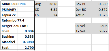

I use the Berger 220 Hybrid Targets in my 300-PRC ... with solid results using both Retumbo and H1000. Here's my favorite recipe:
Reactions: Jscb1b
