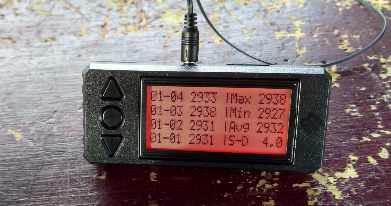

Walked out the door and forgot the 250gr A-Tips loaded with Retumbo/N565/RL-33.. DOH!!!
However, I did manage to take the big box of ammo that I wanted to do temp stability of the N565 loaded with 225gr ELD-M's. I was pleasantly surprised to see not much reduction in velocity in much colder conditions. I dropped about 1fps per degree F. Today was slightly cold....35F when I shot....some would call that 'mild'...but I couldn't shoot less than a 1/2" 100yd group to save my life because this southern boy was shivering a little....micro shivers. Vertically was great....side to side was bleh.... so 78.5gr of Vihtavuori N565 pushing a 225 ELD-M equals:
6th firing on Hornady brass....SD 4.0...ES of 11...time to anneal ;)

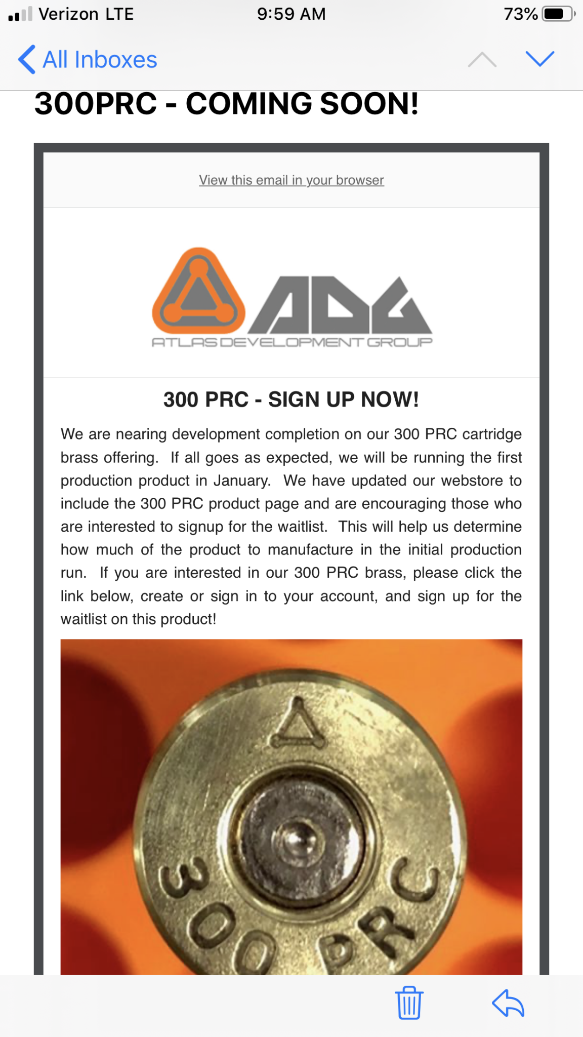

I've spoke to RCC and AMP and they both are working together to see if it's possible. RCC mentioned to me that their brass needs higher temperature to anneal.
AMP has told me that they are working on a AZTEC pilot code for the 300 PRC RCC brass.
