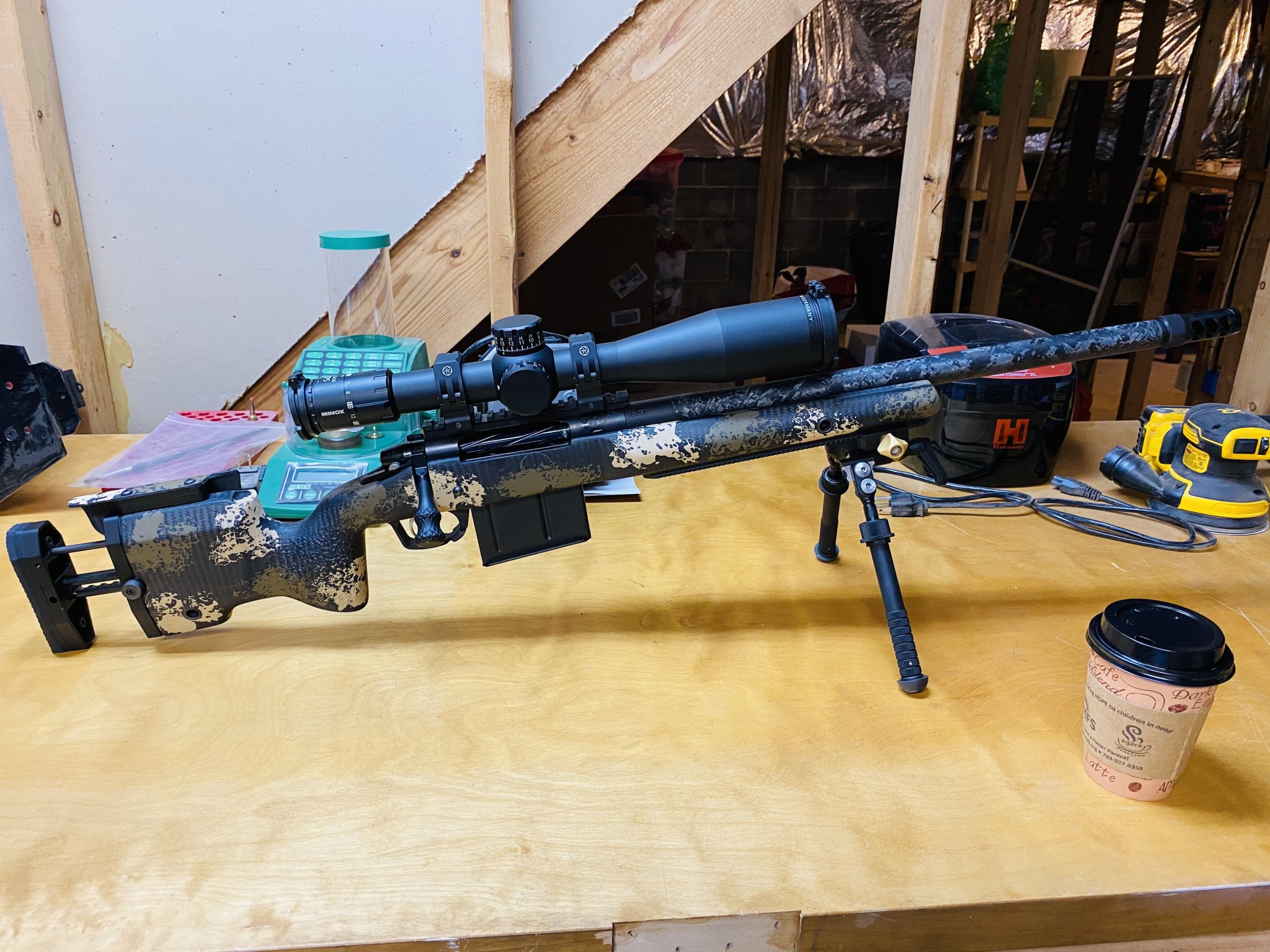

Well my 300 PRC is done... just as all of the ranges around me closed.
Bighorn Origin LA Action
26inch Bartlein 1-8 Barrel
MDT ACC Chassis
Trigger Tech Diamond
APA Fat Bastard Gen 3
When I can going to break in the barrel with some 225 ELDM Hornady factory ammo, got some ADG brass and 230 atips after that, got a couple lbs of retumbo to start off with.
Like the wrap. What camo pattern is that?
