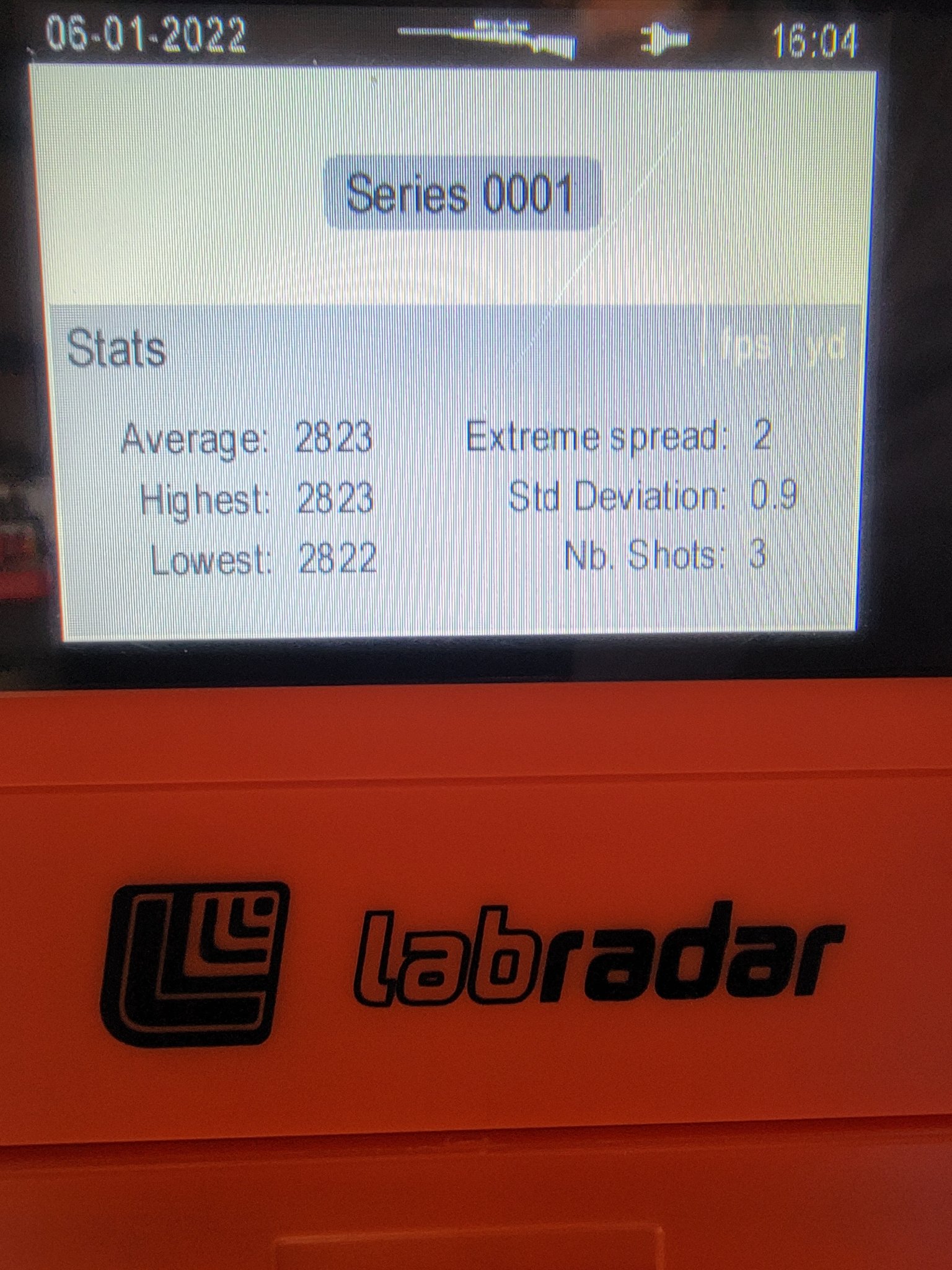

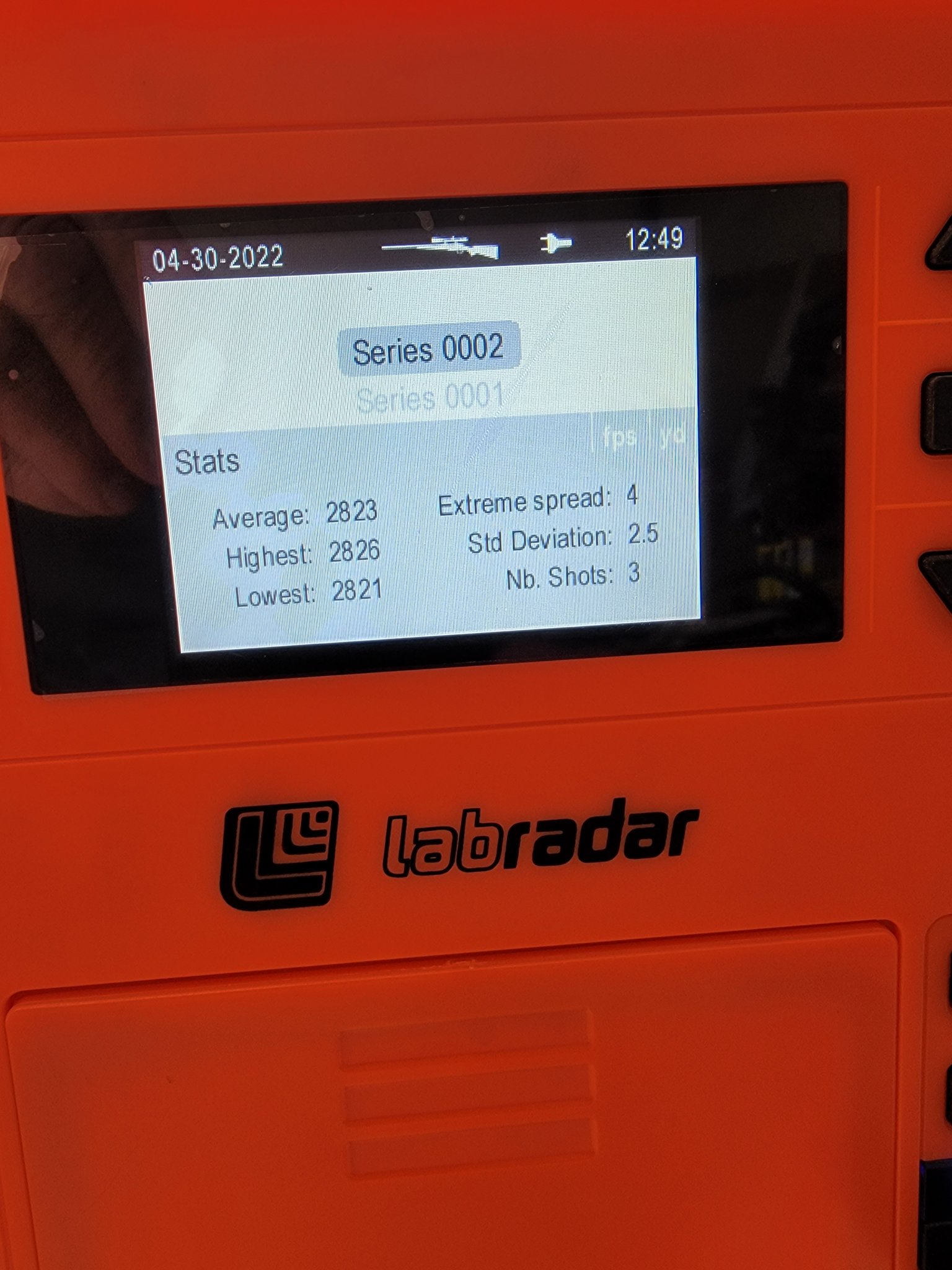

Just a small report for load development. Shot the NF ELR Match this weekend with my 300 PRC. From the beginning I had to work with non ideal powders but landed something that worked out quite well.
71.5gr of 7828ssc with 230 atips gave me 2850fps from a 1:8 28" Bartlein with the light ejector swipe, no flat primers or heavy bolt lift in Lapua brass using Fed 210M Primers. 6/14 SD/ES averaging .4-.5 at 100.
Landed fair number of shots on the clock at most stages including two 1 mile target stages and a couple others in the 1500-1700 range. Hammered really well in the 1400s and in but had to work harder further.
Landed shots on the clock at multiple stages including two 1 mile target stages and a couple others in the 1500-1700 range. Hammered really well in the 1400s and in but had to work harder further.
78.5 gr of Ramshot Mag is showing some promise in the 2925 range need to do some seating depth testing or just finally buy a tuner as well as LRT in 86 range is giving me 3k with go spreads but freaking can't get it to group worth a damn so more seating depth there when I run out of 7828scc but for now I'm content with that and it's a dream to shoot. Recoil doesn't feel much off from braked 308.
