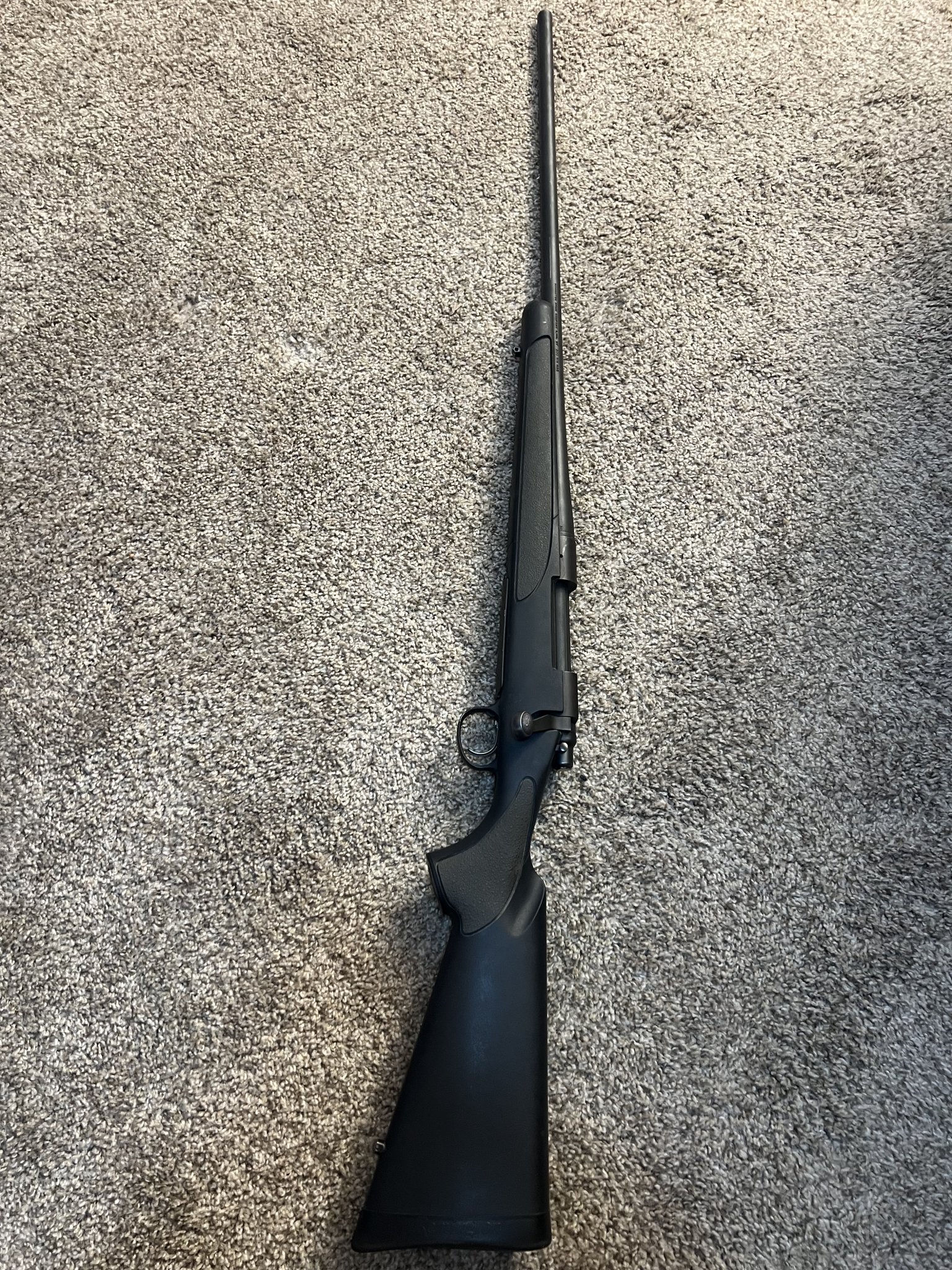

A buddy of mine got in a tight spot and decided to sell some of his rifles. He said he had a Rem 700 in 300 Win Mag. Asked what he wanted figuring he’d say $800-$1000. He said $500. Couldn’t dig my wallet out fast enough, I figure it hard to go wrong at that price. He used it for one hunting season and jumped to some other rifle in 28 Nosler and this has been in his safe since.
I’ll end up throwing away or selling everything except the action. Gonna get it a new barrel, probably heavy varmint or M24 profile, get the action worked over a bit, drop it in KRG Bravo or maybe a McMillin stock, toss a Leupold on top and search for a suppressor.

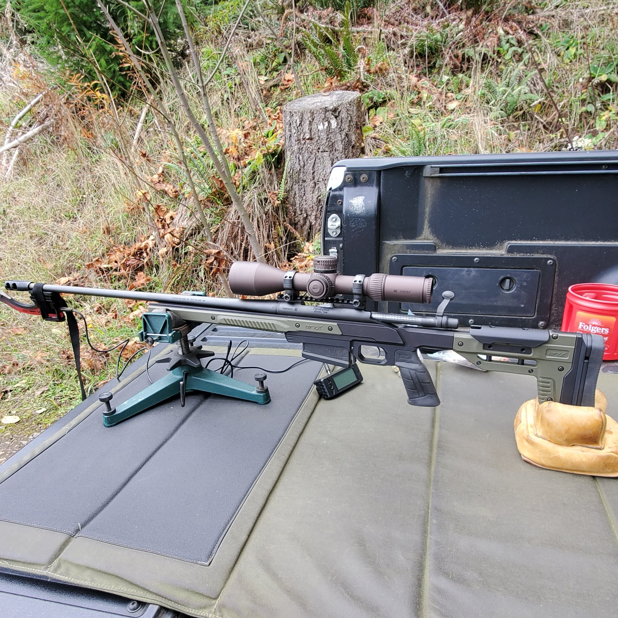

I bought a new on sale, Rem 700 300 WM ADL $540 out the door...just for the magnum action, decided to shoot it first...it shot really well...especially for a cheap factory rifle. Shoot it first to see if it's good enough for your purposes.

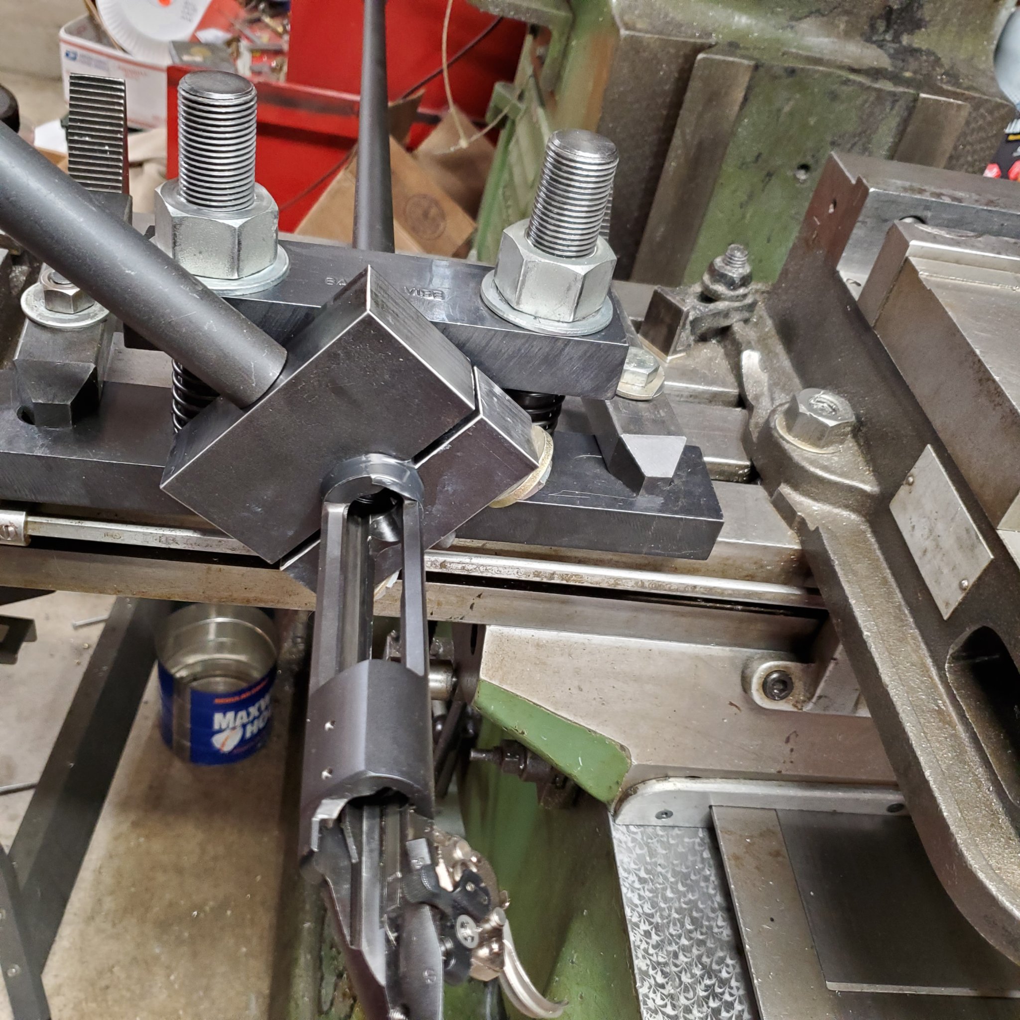

I just put it in an aluminum chassis, and machined the barrel for a muzzle brake...everything else was Remington factory..as in the photo.
But....the 300WM is now a .510 Whisper.
I like the 300WM components easily available.

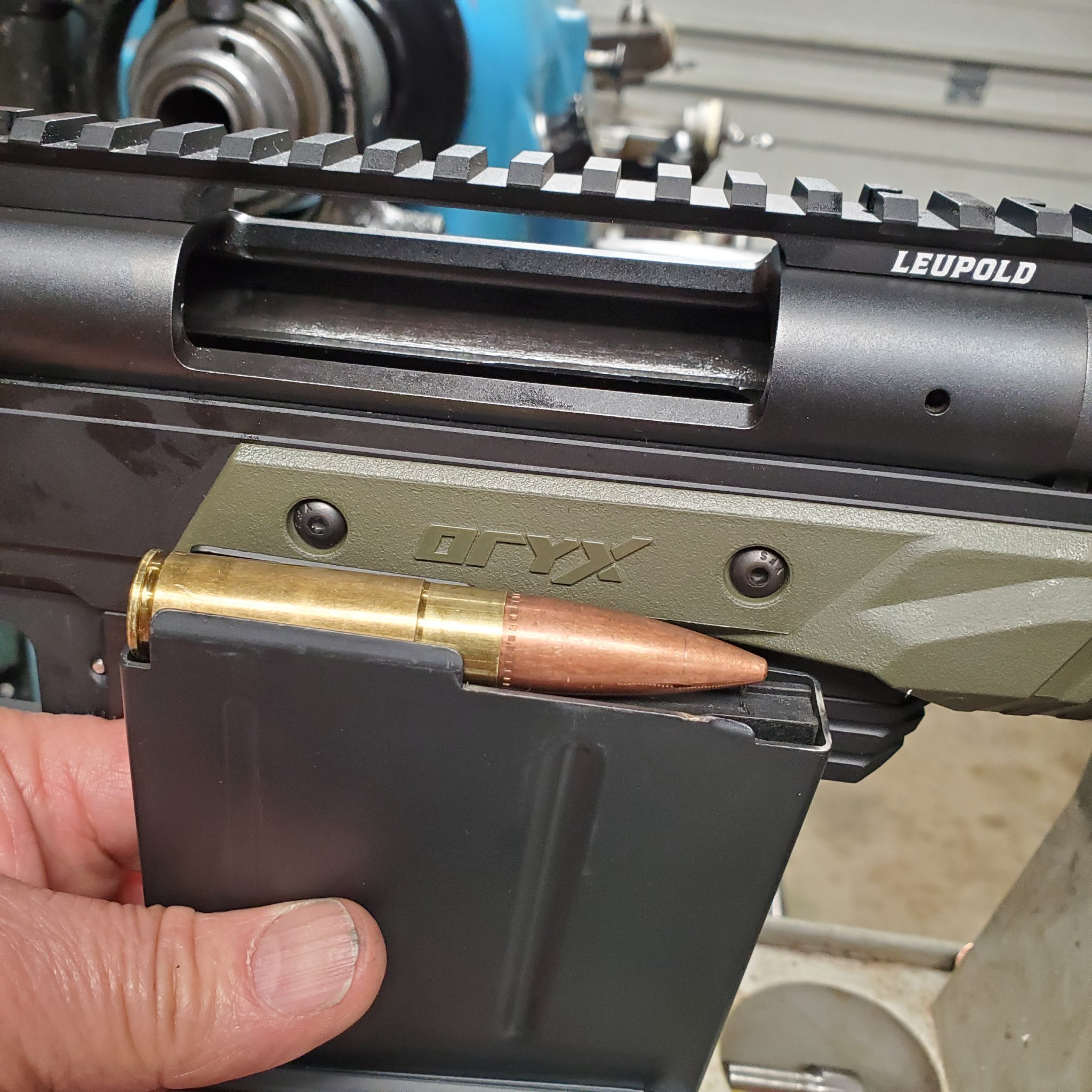

I ran 3.715" cartridges out the the chassis mag, but 3.85" mags are available some chassis,... so the 300 WM will compete with all the new 300 mags in this configuration, and do so accurately and with less cost.
Max loads, 200 SMK 3280 fps, 230 gr 2964 fps out of this factory barrel.
But an excellent quality new barrel is likely to perform even better.
