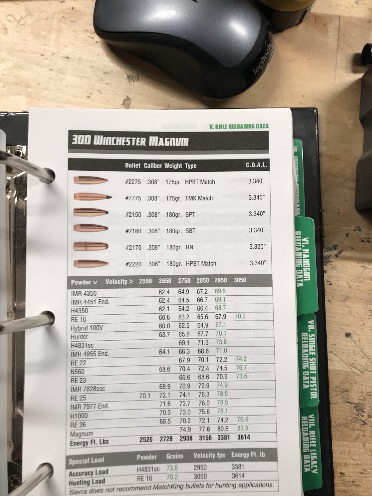

I'm looking for some "light" 300 Win Mag loads. Not reduced, but not full power, closer to 30-06 +P is what I'm thinking. Everything I've looked at so far seems to have poor load density which I've always found to lead to large ES.
Haven’t done so myself yet, but this is where I’m heading.
175 grain TMKs.
Does this fit the bill?
If you're after a little less recoil, I'd look at lighter (~150 - 165gr) bullets. Your slower burning powders (RL-22/23, H1000, Retumbo etc...) should still get you close enough to the 90% case fill you're after.
I agree with this way of thinking. 150's loaded a few grains below max will be about like a full power '06 heavy load.
