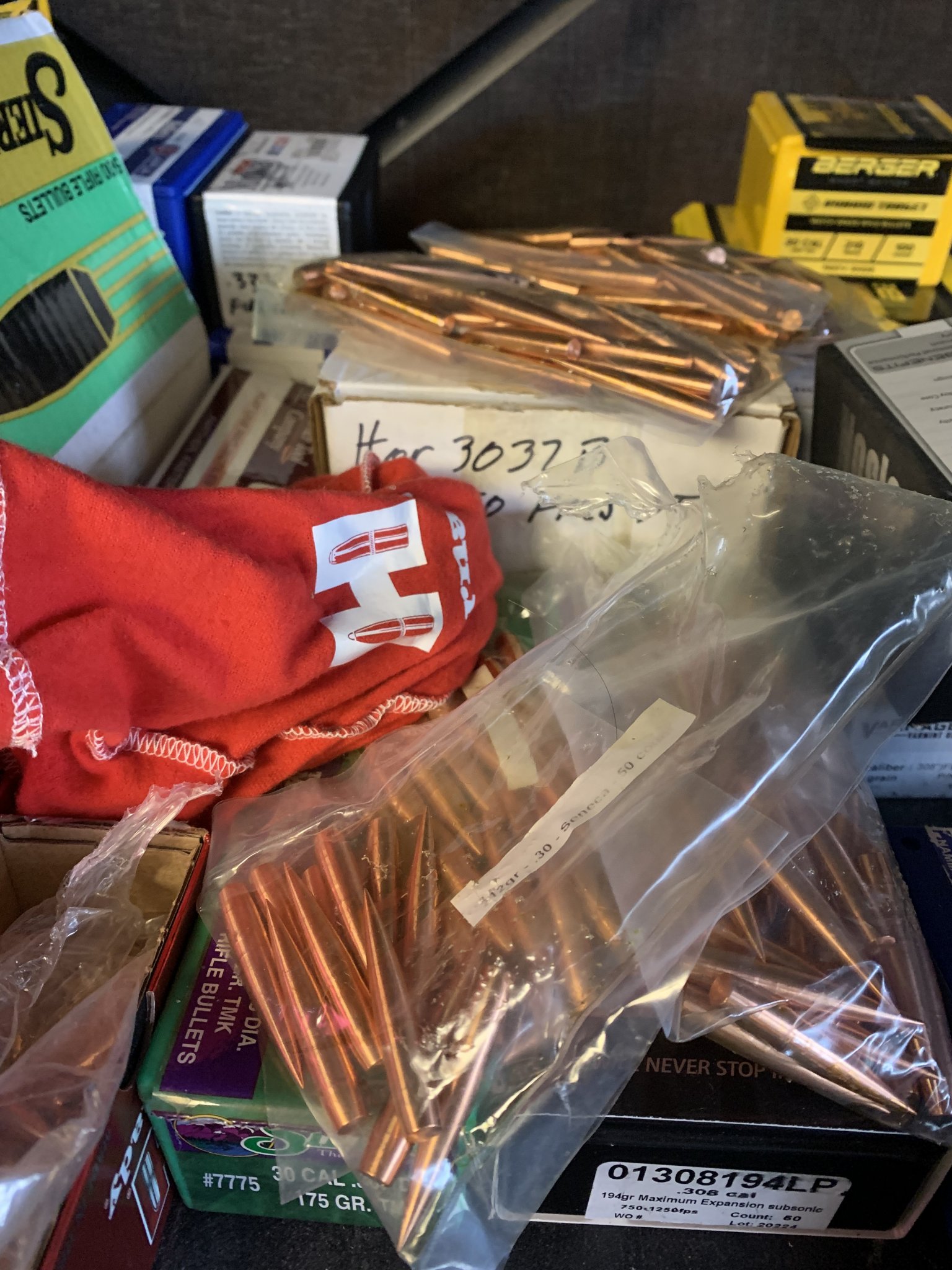

I've got a normal 0.250" freebore on my current .300NM barrel, so I'm jumping them 0.1", which seems nuts, but they're grouping very nicely as long as I load them with tight necks.
Getting ready to test some in my 300NM, but in my AXMC w/AI barrel it's closer to .160 jump. They are so pointy I need to make a special adapter to measure to the ogive. Hopefully they shoot well, will be amazing around 3200 fps.
They’re consistent enough that you can just measure COAL instead of base to ogive. They’re so slender and pointy that they can handle shorter freebore than jacketed bullets.
This would be true if they were shipped in better packing. The ones I’ve used ranged .005” because the tips get beat up so bad. Shipping in a plastic bag that gets tossed around by usps like a hacky sack.
They are very pointy and those tips are fragile. Mail your self a bag and see for your self.

I’m still working through my stash of 212s and have the 241s if my 7-twist barrel ever shows up. I haven’t seen the the length variation you’re seeing, but I do find the tips more consistent than jacketed OTMs when measuring COAL. But yeah, Warner’s packaging does a better job protecting the tips.
Ended up jumping about .200 to fit in my mag. They didn't like that at all, about an moa was best group with N570 from 2960-3175fps. Don't really like to single feed but might try them @ .020 for local 1000yd f class like comp just to use them up. Got about 80 left.
