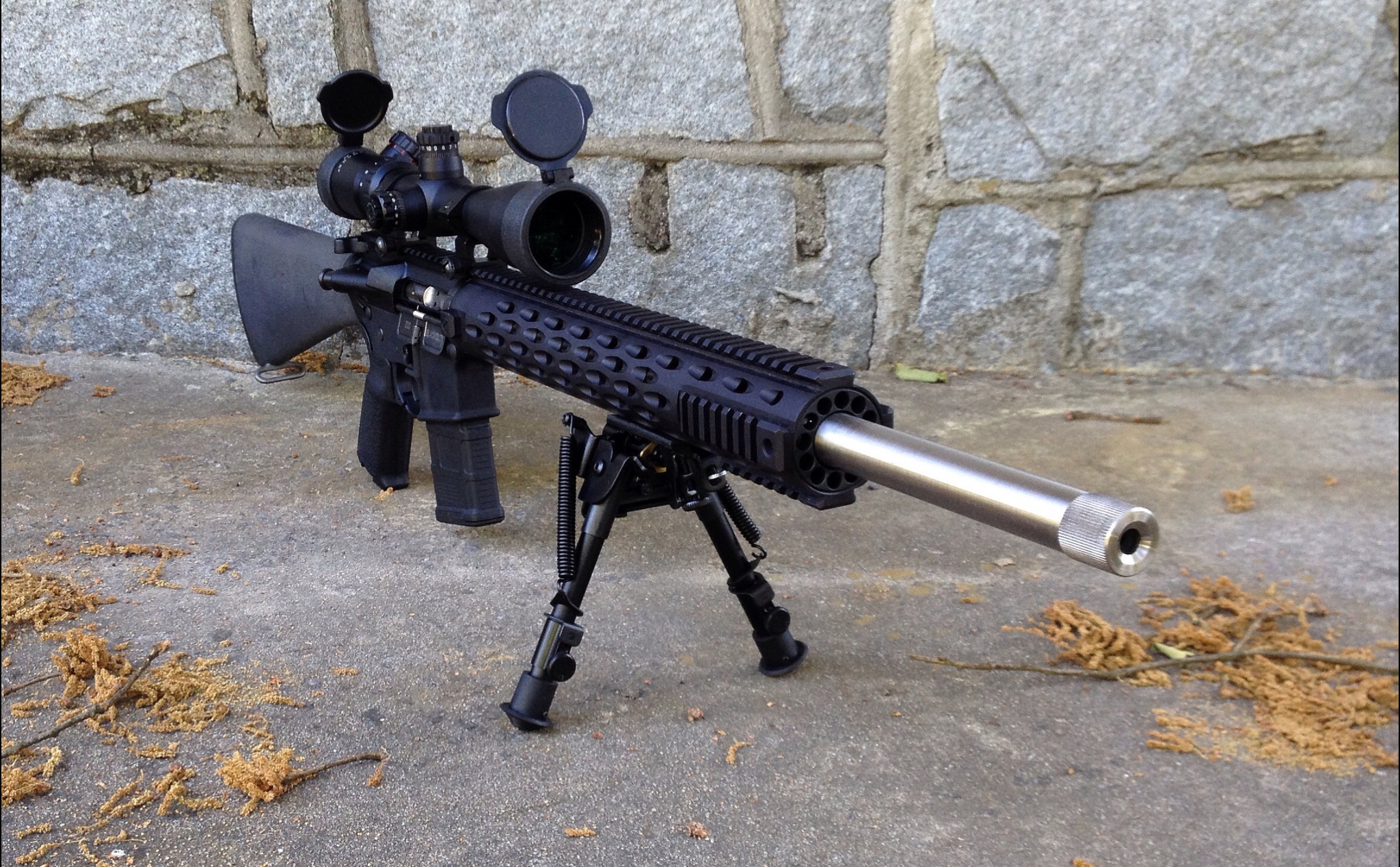

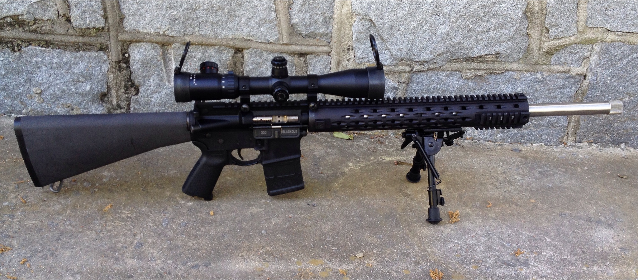

    This is a 300BLK 24” custom green mountain barrel blank made sexiness that just because we wanted to... A2 stock, PSA lower, YHM Todd Jarrett, lots of spare other add ones... haven’t had much of a chance yet but tests are soon to come.
    Well, is should be quiet suppressed anyway. It actually looks pretty good, except for one thing that doesn't fit the rest of the gun - that insert at the front of your handguard.
    Presumably with that rifle configuration you're going for accuracy, so why add that non-functional piece that makes the forend not free floating? Inconsistent & partial contact between that piece and the barrel is one of the worst things you can do for accuracy.
    It's a YHM free float end cap. It is VERY functional. Can't quite tell if it's even making contact with the barrel. Nice stick. Load up some 110s and 125s and you should see some good velocity with the right powders.
    Functional in what way? What useful purpose does it serve?
    The "can't quite tell if it's making contact with the barrel" bit is the problem - if it's that close, you get contact sometimes and not others. That's bad for accuracy.

    The poster that said s\he can’t tell about the fit is not the op, and is relying on the picture.
    Not designed to make contact with the barrel. Follow the link and you will see that they make one specifically for heavy barrels. And, you can see a more revealing picture on fit. Benefits besides appearance? Probably none. Affect on accuracy? Assuming no barrel contact, probably none...

    For those who carry a firearm beyond the car to bench routine are well served by that end cap. You would be amazed to see what things in nature will make contact with the barrel and travel up into that hand guard if it was not blocked. Shooting range warriors won't run into this problem but if you're out on a hunt it could be a no-go and lead to you name a situation that complicates your day. Too bad more people don't "get out" in the field with their weapons and learn these lessons. If it's making contact with the barrel....that's a problem. No disagreement there!

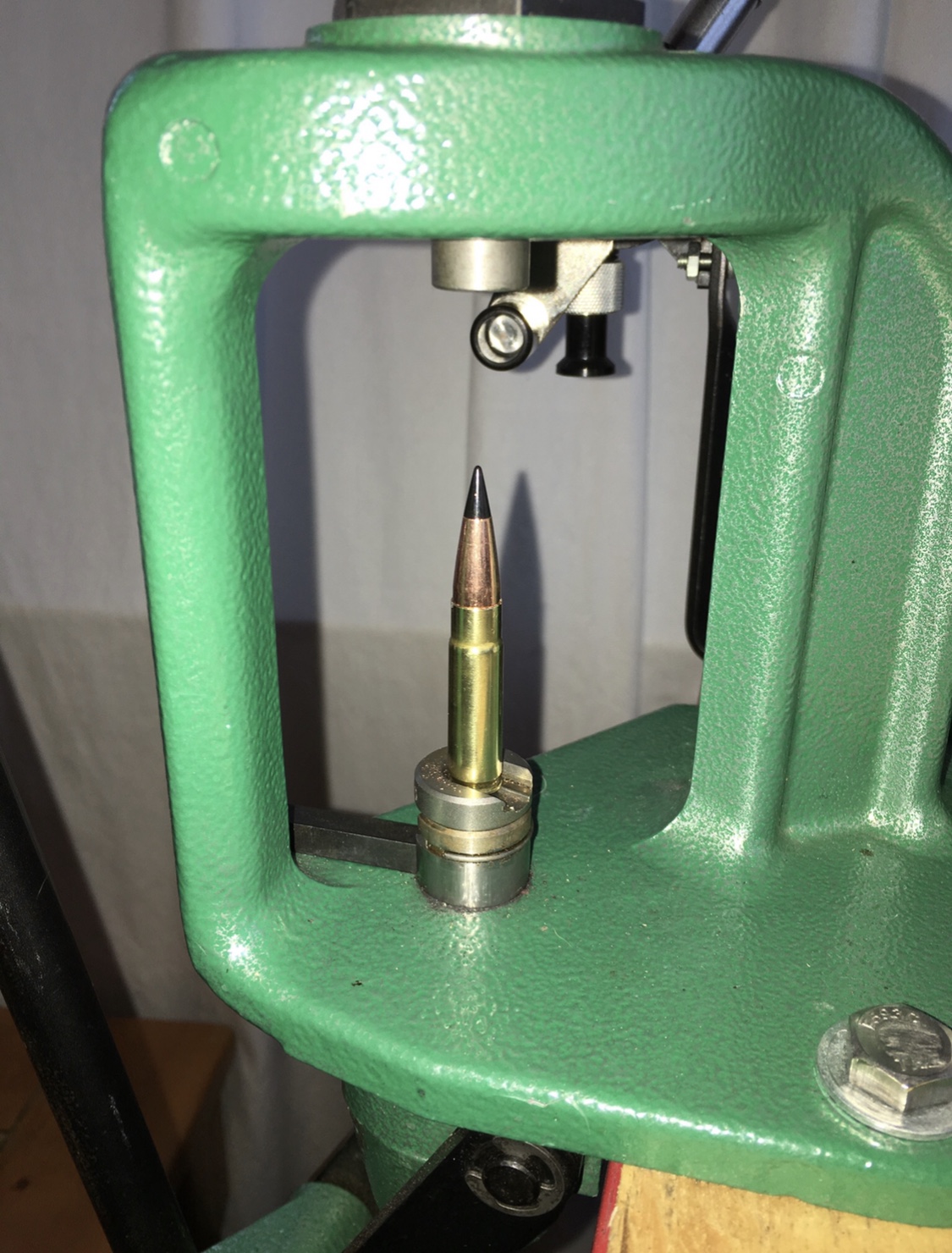

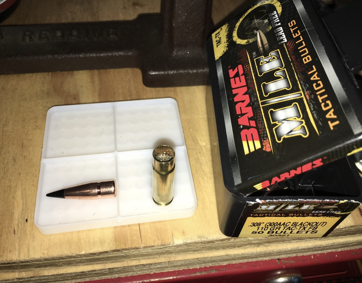

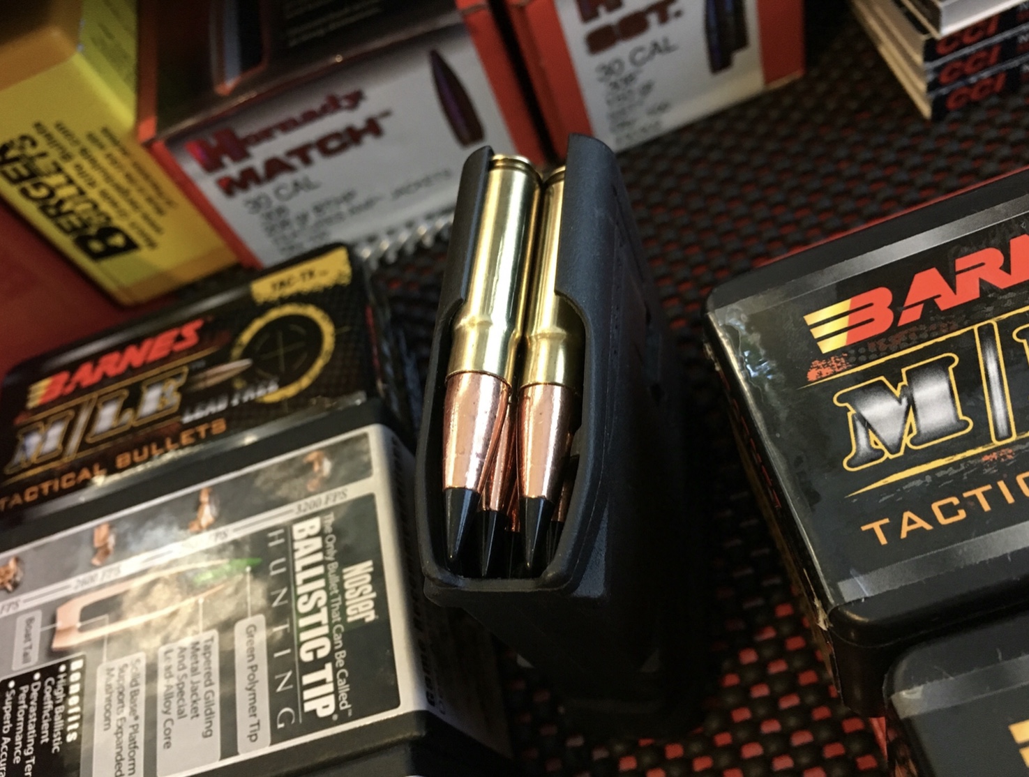

    It’s just for fun, and in no way to compare calibers. I’m definitely custom loading and starting with Barnes 110...
    Best of all if it doesn’t work it’s no problem cutting down to 9” and throwing a upper together and moving on to the next goofy project.

    Definitely going to have to experiment with some slower burning powders than would be traditionally used on this round to utilize all that extra barrel. I've exclusively used the 110gr Barnes black tips for hunting. They definitely perform well above their weight class.

    Keep telling yourself that. I hunt with mine, as I think a lot of other guys here do as well, and have yet to encounter this imaginary problem of stuff being stuck inside the handguard. But if pretending those who don't use them must not hunt makes you feel good about a gimmick that's really just for looks - have at it.
    And yes, I have seen them in person and know what they are and are supposedly for. They serve no actual purpose except someone thought they look cool at one point, and made up an excuse for them.

    Yes I know what they are; I wasn't asking what the item is, just pointing out it doesn't fit with an otherwise well thought out rifle build.
    You'd make that assumption after seeing the pic in the OP? Do you realize how much a barrel can flex relative to the handguard?
    No, I’d make the assumption that pictures of items at odd angles are notorious for skewing perspective and making accurate judgement of spacing difficult. I can’t tell the spacing, but if the thickness of a dollar bill is sufficient to call a barrel freefloated, I’ll give the builder the benefit of the doubt that he can see that in RL where it may not be obvious in a pic.

    I have some YHM uppers with the close out rings.
    They do not touch the barrel even with presure applied.
    They are dual purpose of keeping things from snagging and asteticly pleasing.
    Can't see anyone having issues with one, mine have never presented a problem.
    Mine have been in the mud dragged into brush and for me mostly on a square range
    Without fail or degrading accuracy.
    For the people that think the barrel deflects into the hand guard.
    Which do you think bends first a steel barrel or an aluminum hand guard.
    Stick them in a vice and try I have, barrel wins every darn time.
    For the op.
    What twist are you running?
    Do you think you can run sub?
    If the clearance on the ring is in question run a reamer through it and put it back on.

    A dollar bill is really not sufficient to call a barrel free floated unless it's a very heavy barrel and a very stiff forend. It technically is free floated at rest but that doesn't mean it won't touch sometimes, which you want to avoid for accuracy. I've seen contact marks between handguards and gas blocks that had ~3 credit card thickness of clearance; things can flex and vibrate more than you expect.
    Snuby642, if you don't think barrels can deflect inside handguards, you haven't looked into it closely. It's not about whether a steel barrel or aluminum handguard "wins"; not sure what you're trying to prove there. Barrels flex, and that's easy to demonstrate for yourself. The point is to have enough clearance that it doesn't matter, and the amount of clearance needed depends on the individual parts. IMO the OP's rifle doesn't have enough clearance, based on my own experience chasing weird accuracy issues, and the solution is pretty simple. YMMV.
