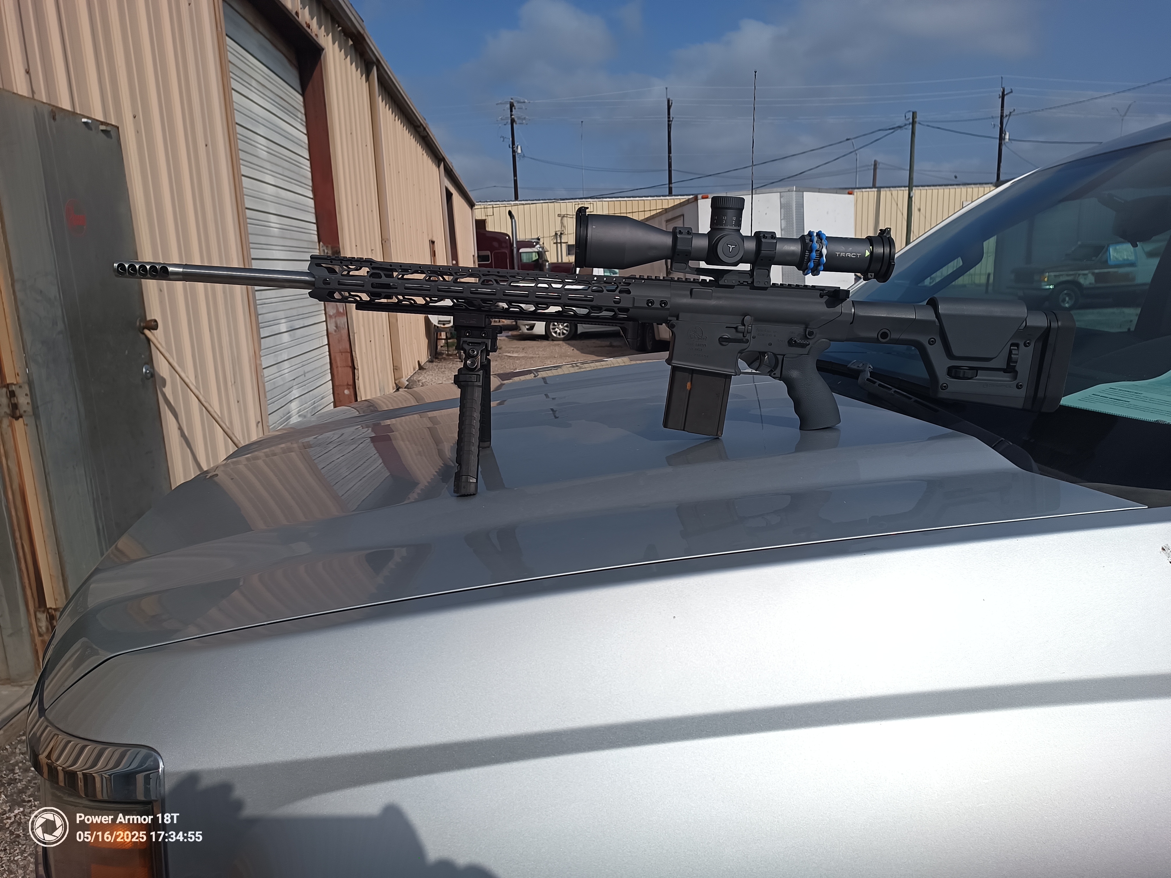

Just thought I would share my recent project that I've been working on.

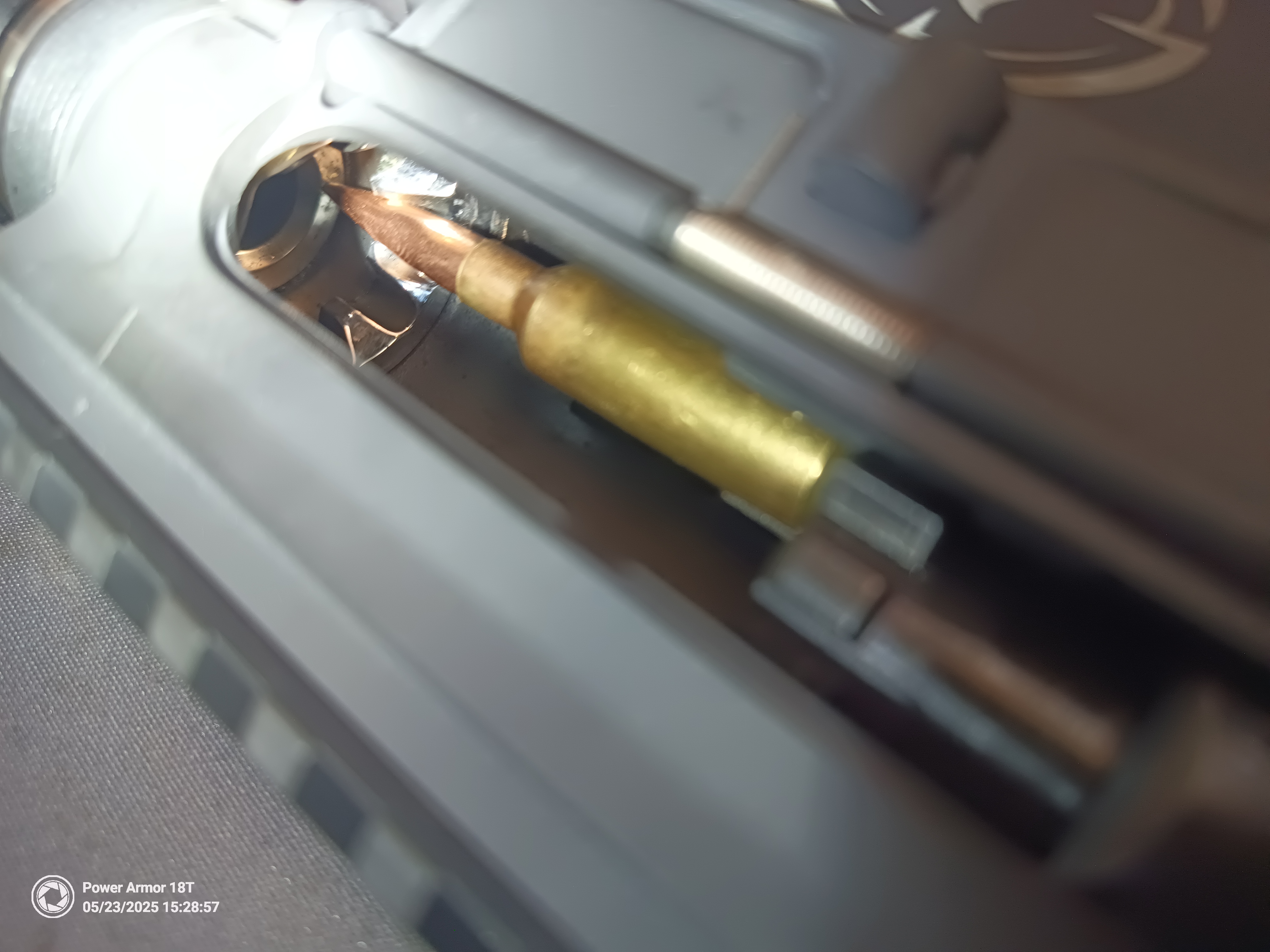

I've had this rifle for quite some time now and when the barrel finally gave up I felt like I wanted to do something different. I've recently started competing in some PRS matches and thought it might be fun to see what I could do with my gas gun, so I decided to go with 6GT for my cartridge choice.

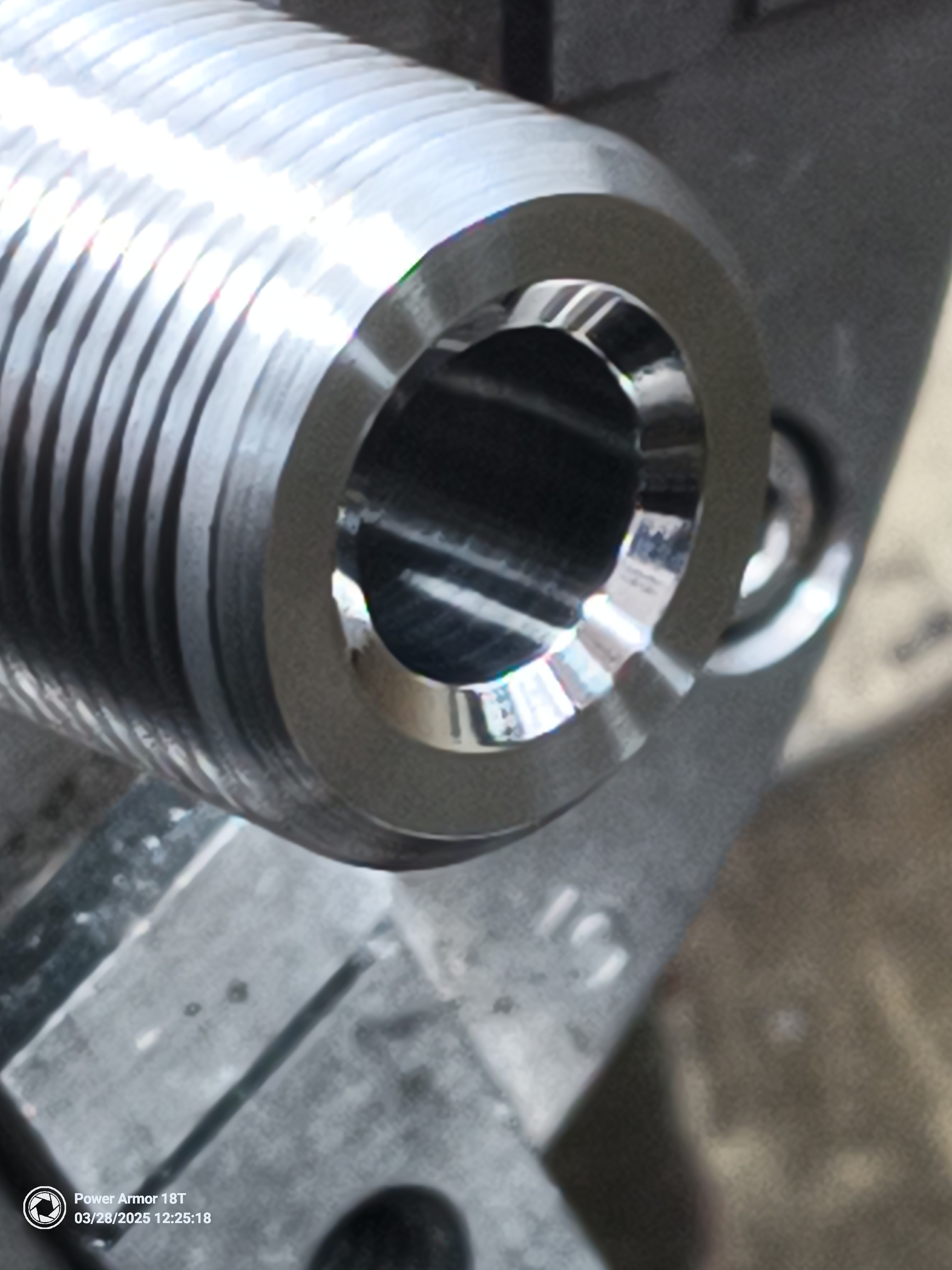

The rifle started life as an Armalite AR-10T with a 24" kreiger barrel. And no matter how hard I tried I just couldn't get the performance out of it that I felt like it was capable of. And for that reason I've been on this mission to make this thing shoot the way I think it should. So starting with the barrel, I ordered a Bartlein blank and a Lija barrel extension. I took the time to smooth and polish the extension and then took everything to my well trusted friend and gunsmith (as I don't have my own lathe yet) to get cut and chambered. We had decided to go with a 24" length and turned the shoulder for the gas block to rifle+1. I was beyond happy with the job. But, one thing we found along the way that wasn't until about 100 rounds went through was that with the eld-m's I had no problem chambering and cycling, but when my big lot of bergers came in they would refuse to feed.
The culprit turned out to be the bevel around the back of the chamber. It was a standard bevel nothing really wrong except what would happen is the red tips of the eld's would deflect just enough to help it kick itself into the chamber. Once I started loading the solid tipped bergers they would stop dead in their tracks straight into the back of the barrel just below the bevel. We took it back off and reprofiled the bevel and problem solved.

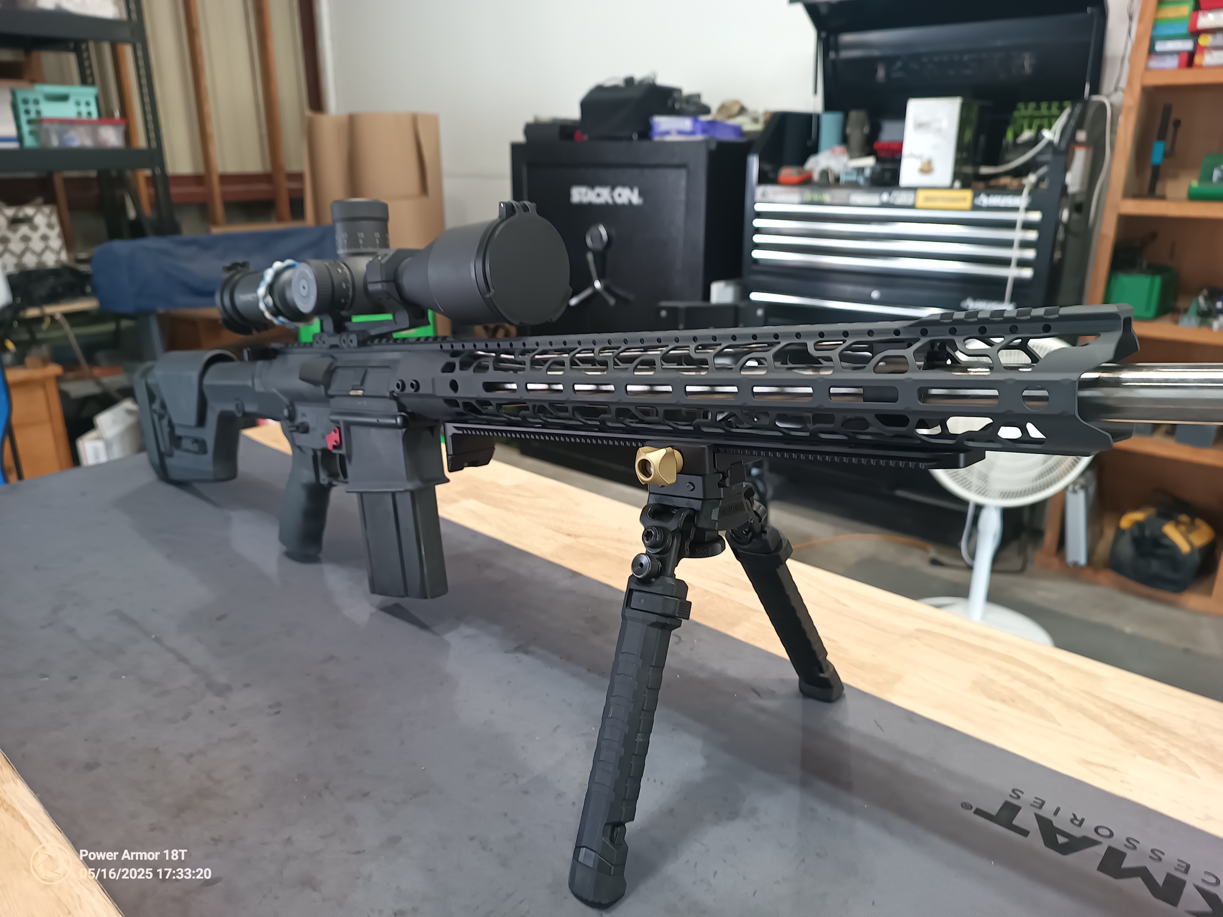

As much as I love my Armalite, it is painful to try and find compatible parts at times. But I did manage to find a barrel nut and handguard that I liked and would work from Odin Works. I also ordered an Area 419 arca rail for the bottom of the handguard which I have been very happy with.
Other upgrades on the list are:
SJC Titan muzzle brake
Odin Works adjustable gas block
Odin Works adjustable buffer
Ambidextrous safety
Radian raptor charging handle
Magpul PRS gen 3 stock
Ergo vertical super grip
And a tract toric scope and mount
I'm currently still running the factory match trigger that I spent a fair amount of time smoothing and tuning, but I think it's going to be replaced soon with a TT diamond.
And then full Cerakote that we did in house
I'm currently working on load development with 109 bergers and varget, CCI 450, and I have alpha brass but I have not started using it yet.
I know I'm missing a bunch of things but I'll try to keep it updated if anyone is interested.

The way we re-beveled the chamber face we kept the case supported entirely just like it was originally. ill attach this photo to help explain. So if you look at the blue top cheesy diagram I quickly drew. We beveled the angle out instead of the green example which would have taken more out.

Doing what I've done so far and having built other gas guns in non-standard calibers, the most challenging hurdle that I feel like I've seen so far is the lack of options in the barrel extensions. I built an 8.6 Blackout for a customer last year and it had a very nice large center feed barrel extension on it that had zero chambering issues. Between that and this project and some of the other calibers I've done, it makes me think that there are other barrel extension designs that could be done and work substantially better with today's more modern cartridge designs. A lot of times I think a lot of the mentality in this industry is more of an if it ain't broke don't fix it mindset. Or a that's good enough mindset. And that really just doesn't work for me.
Reactions: LRRPF52
We tried sourcing blank extensions so we could grind our own feed ramp. No one will make them. They're all made by big OEMs and it's not worth their time.
People pick a lot of good areas to improve in gas guns. ICAR mags, mono uppers, but I think for an accurate long range gas gun it would be really beneficial if a platform could be designed that has a feed ramp for the case body. Starting the loaded round out of the magazine using the bullet tip to lever out of feed lips and guide the cartridge direction into the chamber is a limited design imo. A result of adapting the AR platform over and over again into configurations it was never really designed for.

Misery Custom Rifles has spend a lot of time playing with feeding vld style bullets in ar10’s. We now have a solution with custom barrel extensions that feed all the way down to 22 Creedmoor. The bullets ramp up into the chamber instead of the bandaid fix of cutting a bigger cone on the back of the barrel.
One of the big drives for getting the barrel extensions figured out was SOF guys getting issued the 6.5 Creed ammo with 140 Hybrids. Most production gas guns wouldn’t even begin to feed them. The trial guns would feed them but goes back to the bandaid fixes.
