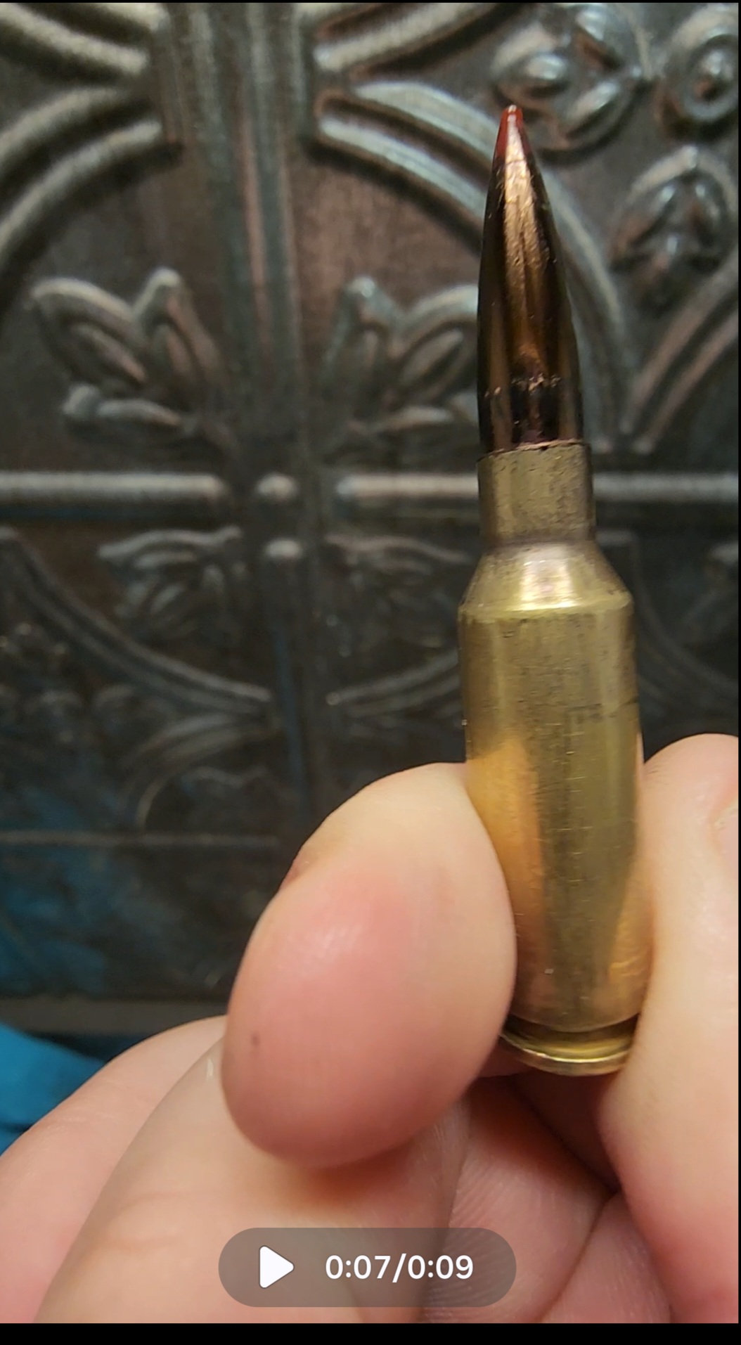

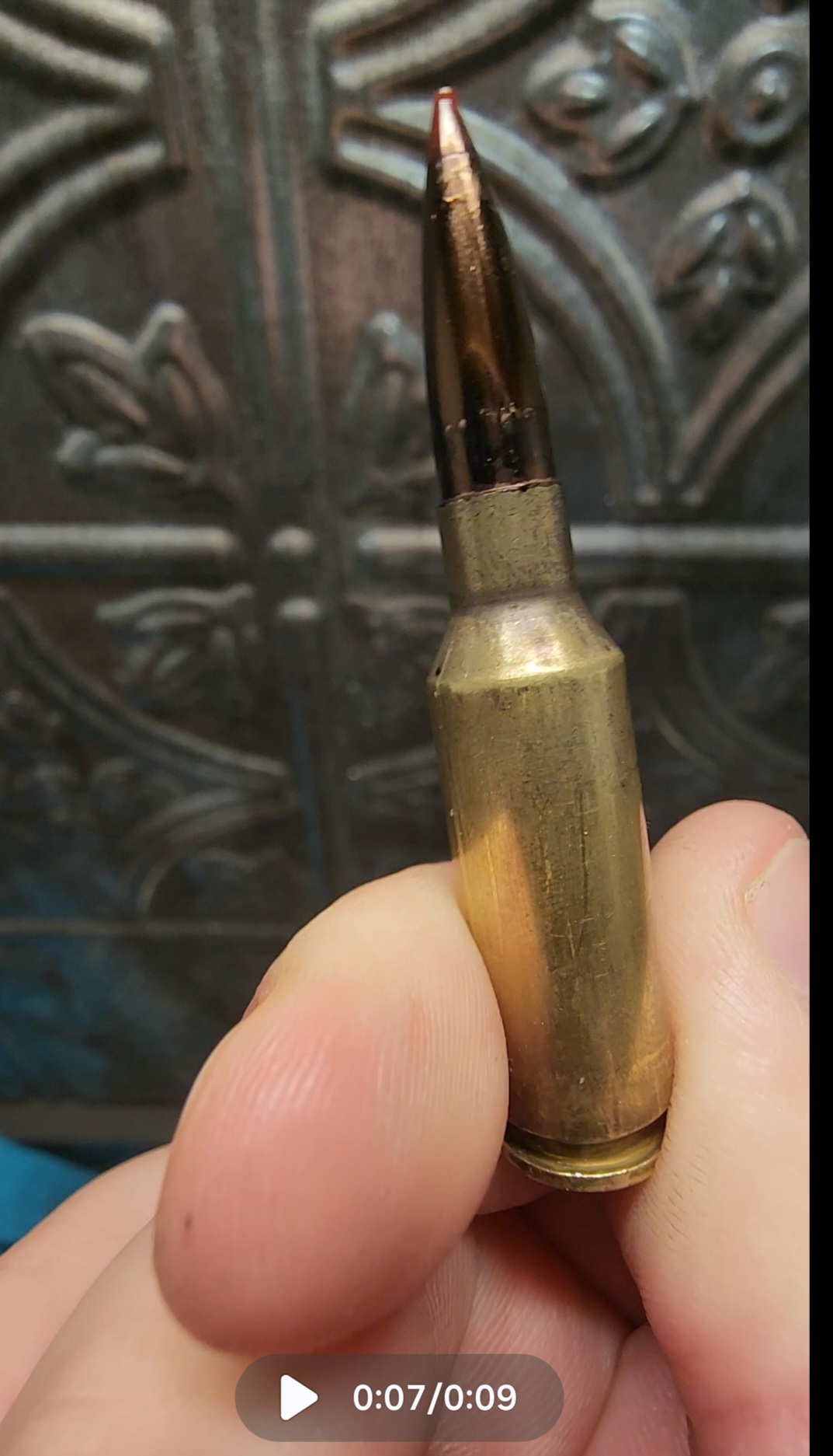

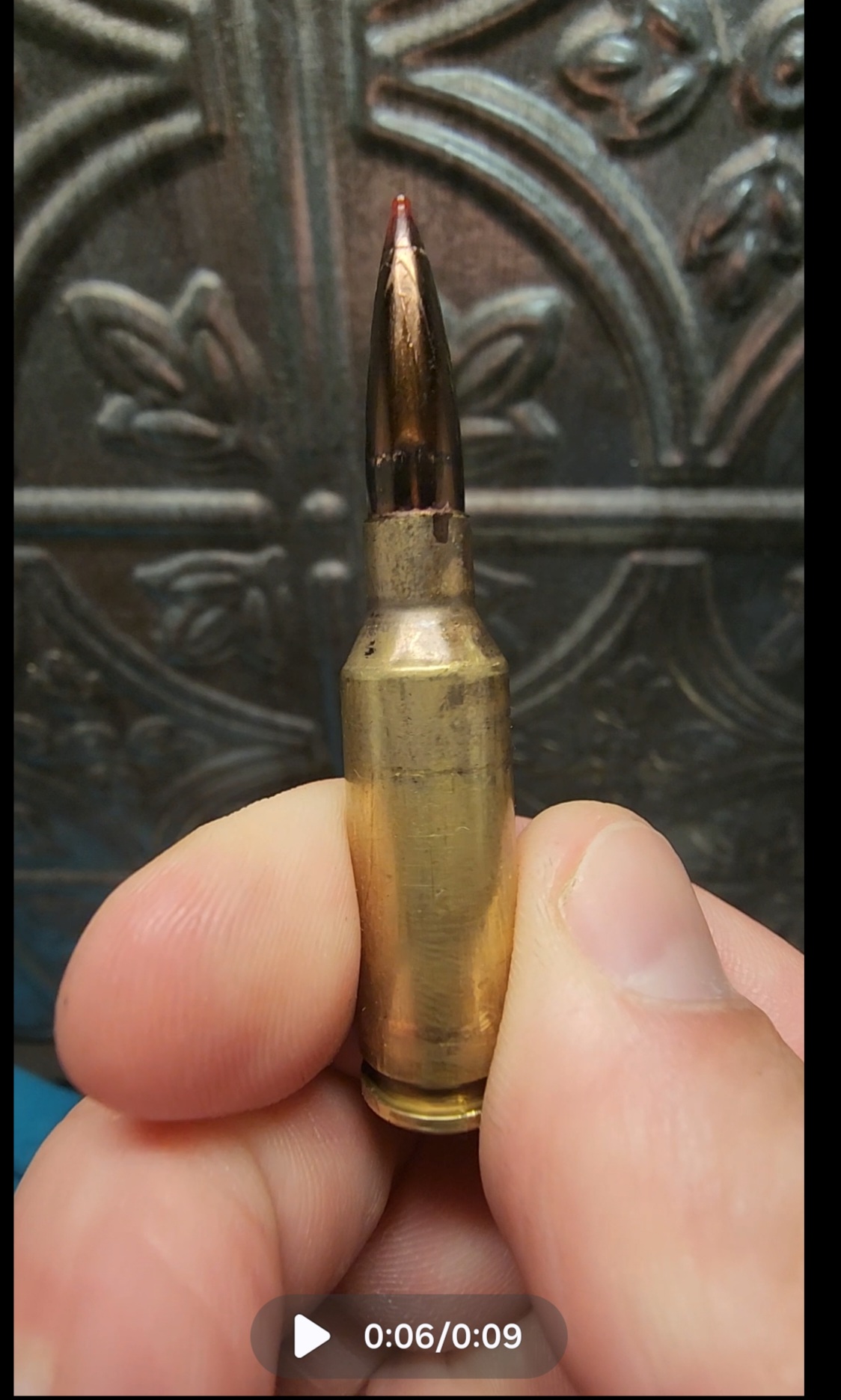

I just finished putting together a 6 ARC build and took it out for some initial testing. I’m running a RIFLESPEED gas block (set to 6) and shooting suppressed with an OCL Polonium.
I ran into a couple of issues right off the bat. First was a double feed—I'm pretty sure that one's on the mag.
The bigger issue came around the sixth round. When the range went cold, as I cleared the round in the chamber, the case separated and dumped powder all over the inside of the action, but the bullet stayed stuck in the barrel. Worth noting: I had just cleaned the barrel a few rounds before this happened.
I have some video and photos showing the chamber and the round, where you can see rifling marks indicating where the round is contacting the rifling. I’ll attach those for reference.
I’m trying to figure out if this is a gas issue or something else. Does the RIFLESPEED block only restrict gas, or does it also vent some off? I’m wondering if too much gas or pressure is being pushed back into the chamber and causing issues like this. I’m also looking into whether the throat on the barrel is too short—planning to contact the barrel manufacturer about that.

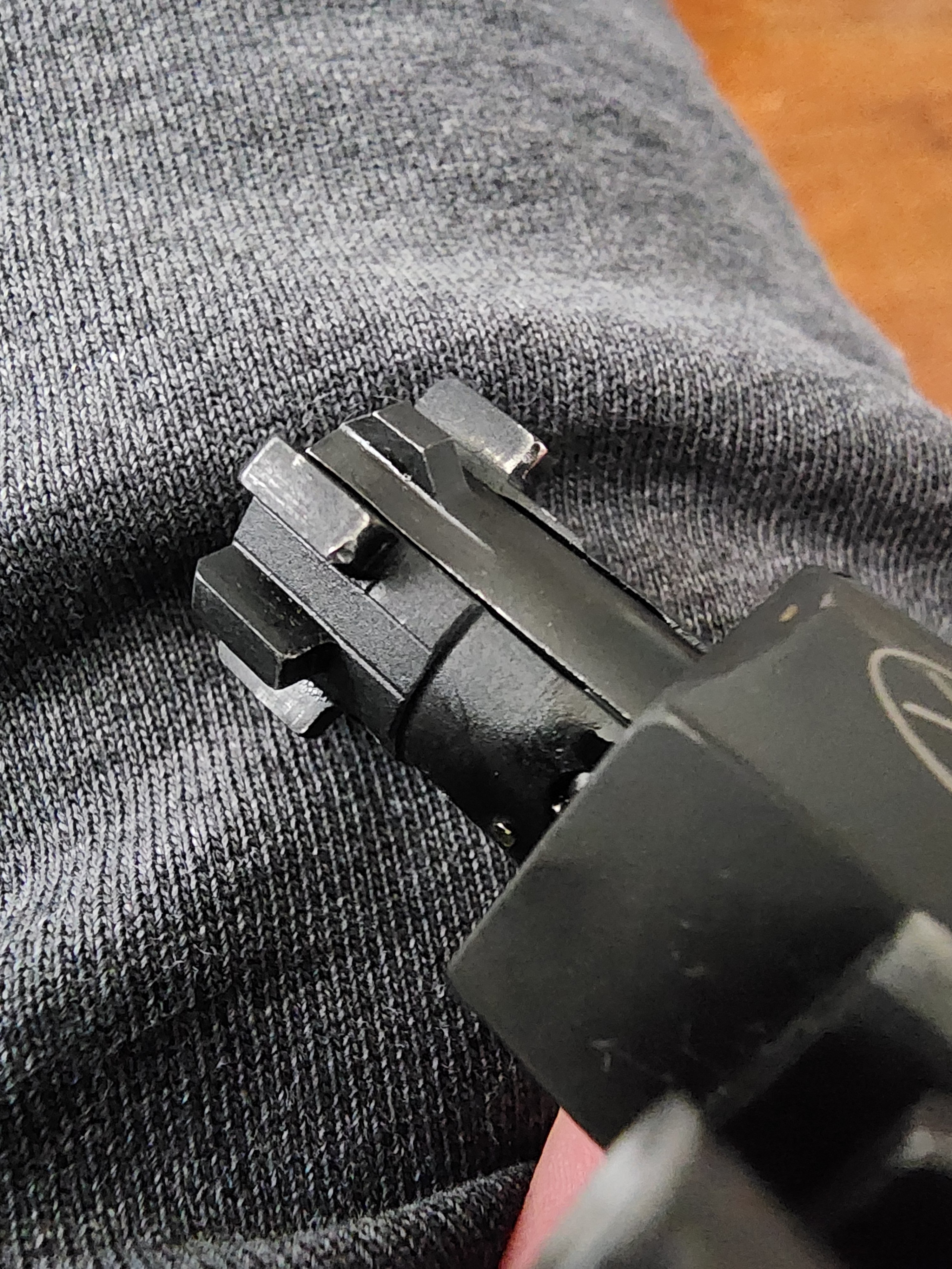

Ejection looked pretty normal—good pattern, not excessive—but when I tore it down afterward, I saw some noticeable wear on two bolt lugs (one above and one below the extractor). That wear has me thinking the timing might be off.
I've attached a couple pics of the bolt lugs as well.

Are you aware of the two different types of 6ARC/6.5Grendel bolts, are you using the type which is matched to your barrel's chamber, and/or have you checked headspace with gauges?
At the range, I removed the upper and had a cleaning rod ready in my range bag. I used it to carefully push the round out. I have a picture I’m trying to upload.
When I got home, I stripped the bolt, marked the round with a Sharpie, and gently placed it in the chamber. To avoid accidentally rubbing off the Sharpie, I carefully reinstalled the bolt, making sure everything stayed in place. Dropped the bolt back into position, then pulled the bolt back out and had to use the cleaning rod down the bore to push the round out.
All hornady 108's factory ammo

If you tried to eject a live round and the projectile stayed in the chamber, I seriously doubt that gassing is an issue, or at least, a part of this particular problem.
When you knocked the projectile out of the barrel, could you see engraving from the rifling on the bullet?

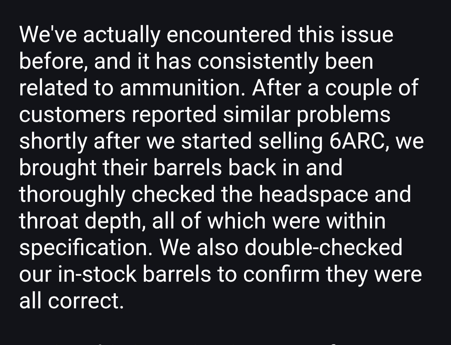

Someone mentioned that there are two types of bolts, so I did a bit of research during lunch today. The correct bolt appears to be a Type 2 with a bolt face depth of .136, while the other type is around .125. Since I'm not home to measure my bolt, I was wondering — wouldn’t using the wrong bolt cause headspacing issues? I could see how it might create a problem, even if it somehow passes a go gauge.
I also talked to the manufacturer, and they said they’ve encountered this issue before and suggested it might be related to the ammo. They mentioned Hornady has some problems with the ogive, which kind of makes sense. However, since the round seems to be making contact pretty close to the neck of the case, unless the round itself has a diameter issue, I don’t see how that would be the cause. I have about 30 boxes of both 108 and 105 grain ammo that I recently purchased, and the COAL is consistently around 2.25 inches, which is under the Hornady max of 2.260. I guess I’ll have to go home and bust out the calipers to do some measuring myself.

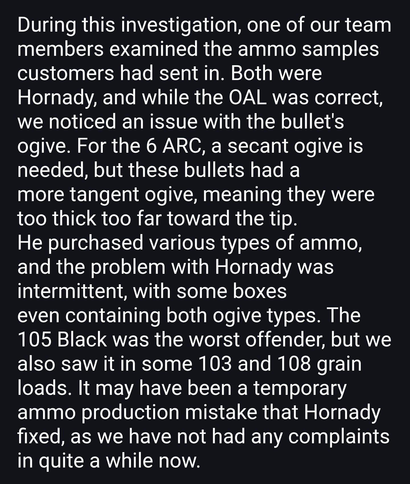

After talking with the manufacturer, they confirmed it's not an OAL issue. The problem is that Hornady is using a bullet with a tangent ogive, and even though the overall length is within spec, the bearing surface extends far enough forward to make contact with the rifling.

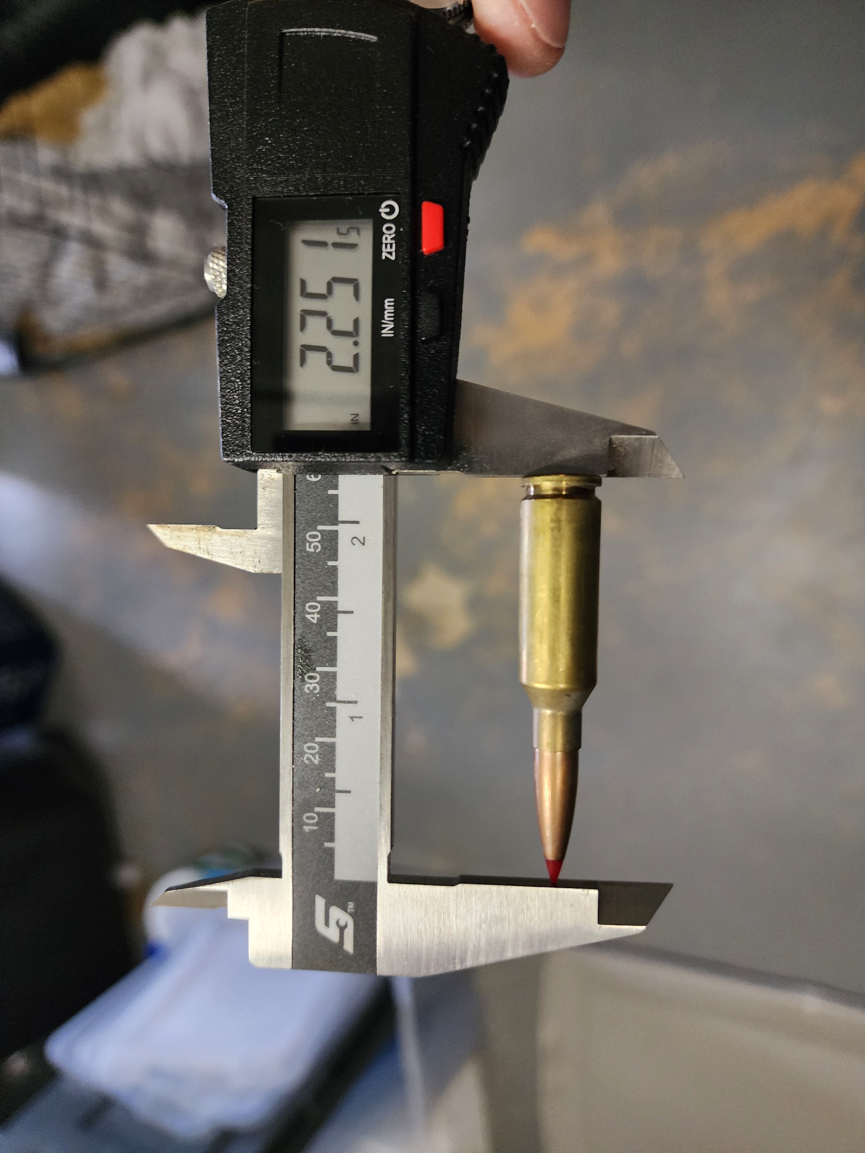

I went home and checked rounds from about 15 boxes, getting consistent measurements across the board. At the neck it's .243, and there's about .135" of bearing surface before the ogive starts to arc.

It really depends on the bullet but we're mostly contrained to 2.25 or 2.35 to stay in thr magazine. Some bullets of course woukd hit the lands at 2.25.
I don't see how this isn't a problem wi5h the barrel. Factory ammo should fit in a Sammi chamber. Who's 6 arc barrel is it? Ask them for a chamber print? Ask them who's reamer they're using? A lot of people are shooting 6 arc with Hornady ammo. I haven't seen a lot of complaing about this. That really makes me lean toward a problem with the barrel.

While I havnt slapped a set of calipers on each round of every box the few out of each box have been the same except for OAL between 105's and 108's. Now even with a shorter OAL on the 105's I would think I would have less bearing surface above the neck but I havnt messed with loading so im not sure.
They spec'd the wrong reamer and are trying to blame the single most common factory ammo on the market. Sounds like they knew almost immediately after beginning to sell 6ARC barrels and didn't want to recut chambers. Who's the barrel manufacturer?

Im just wondering if the bolt lug issue im having is a pressure issue when the round is seated or something idk
Chamber pressure spikes if the bullet is loaded into the rifling, and bolt lug damage can happen while unlocking under excessive residual chamber pressure.

So OP, you now should know this wasn’t a case head separation. That’s where the head (where the stamps are for the caliber/mfg) separates from the case body due to stretching of the case walls to a point of failure, which usually blows out your extractor at a minimum, but will often fragment an AR-15 upper, bow out the lower, blow the magazine out of the lower, and leave you with a catastrophic malfunction.
What you experienced was a jammed projectile separation in the rifling, resulting in powder dump and stuck bullet in the barrel. From further research, you saw that the ogive near the shank was jamming the lands. This is almost always a result of cutting a chamber with a reamer that is worn or sharpened to below SAAMI spec.

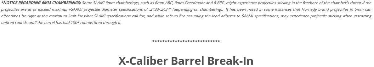

For gas guns, you generally want a sloppy chamber for reliability in feeding and extracting, so short or under-sized chambers tend to be manufacturers trying to squeeze out as much reamer life as possible in a run of barrels.
One thing I do with new barrels before allowing a live cartridge to go near them is a pre-installation checklist:
1. Overall visual inspection of barrel. (Does the barrel match the invoice and order specs, has the correct markings on it indicating Chambering, twist rate, and is profiled as I ordered?)
2. I use 3-4 dummy cartridges loaded with different types of projectiles, ranging from BTHPs, to tipped, monoliths, and bullets that have particularly-long ogives demanding the maximum allowable COL. If those cartridges don’t fully seat in the chamber and fall out with gravity, I coat the one(s) that didn’t and see if I’m getting significant rifling land engagement with the shank-to-ogive transition.
If there’s a problem there, I stop and seek a correction to that problem either with the manufacturer or do it myself if I have that particular reamer on-hand.
3. I then measure the gas block journal diameter, the gas port diameter, and check that the threads are clean and what I ordered (1/2x28, 9/16x24, 5/8x24, etc.). I also measure the OD of the barrel extension, and then go through my uppers to see which one will provide the tightest interference fit if possible.
You can also bore-scope your barrel easily these days, looking at the condition of the throat, rifling, and gas port.
Once I’m satisfied with my pre-installation checklist, I then move into de-edging, blending, and polishing the feed ramps for AR-15 and AR-10 barrel extensions if the manufacturer didn’t use a top-end extension that has been tumble-polished nicely.
Following these initial steps will eliminate chances of experiencing what you did, and set you up for reliable feeding and extraction.

It sounds like you now have a Hornady OAL gauge. It's a very useful tool to have along with a comparator set. The sharpie way is one way but when you use the OAL you know exactly how deep the throat is. I use it on a new barrel before I make a load for it.

I would be worried about that dinged up bolt lugs. That is not good. Something is out of time. And I would have just fire lapped that throat with about 15rds and it would be fine. I have done a bunch of revolvers with thread choke. It works. Even if it is nitrided. most all companies doing nitride coating are not getting them done right. They are only getting it done cheap enough to get the black coating as a finish and not doing it a second time to actually harden the surface. Hell I had a BA barrel that the coating was removed just from running a brush down the barrel getting that brown crap out of the bore because they are too cheap to clean and lap the bore after coating.
