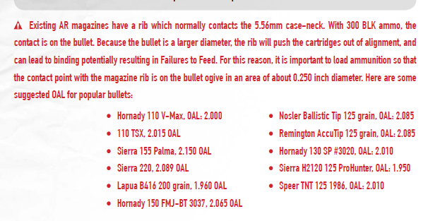

Aero M4E1 upper and lower with Ballistic Advantage 8" barrel. Originally ai was setting the VMAX at 2.10" and it jammed into the feed ramps with each round. Im now doing the Vmax 110 grain at 2.20 COAL. Every mag i still get several rounds that jam into the feed ramps and require tremendous force to extract. I thought perhaps it was an overgassing/undergassing issue, but it continued regardless of gas setting. Im using 19.8 grains of H110. I purchased a Criterion 8.5" and I'm going with a fixed gas block, but haven't shot it yet. Is it likely an issue with feed ramps that a better barrel would correct? Noth the barrel and upper have M4 feed ramps. I can't think of anything else? Im using Lancer mags. Gas block is properly placed. H2 buffer with Law Folder. I need 100% reliability from this rifle, so the Criterion makes me feel better anyway. Im using a Rise Armament 535 and a Lantac BCG. I cant see anything wrong with the feed ramps visually. I know BA barrels can be hit and miss so maybe I got a miss. Ideas? Anything else to try? Im going to the range on my next set of days off and I'd love to have a list of possibilities. Thanks all
Try seating to 2.050” OAL
The incidence of malfunctions dropped dramatically when I went from 2.10" to 2.20". You think going shorter might be the solution? It would be easy enough to seat a mags worth at 2.05" and see i guess. I was thinking full mag length at 2.25" might be the solution.
Edit: doing some searching on COAL shows quite a few issues like mine that were solved with a COAL of 2.04-2.05". Thank you. I really thought it was going to be a feed ramp issue.
...straight from AAC, the developer of the 300BLK cartridge...YMMV
