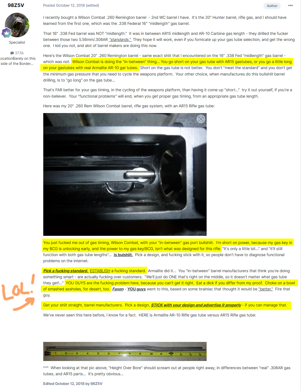

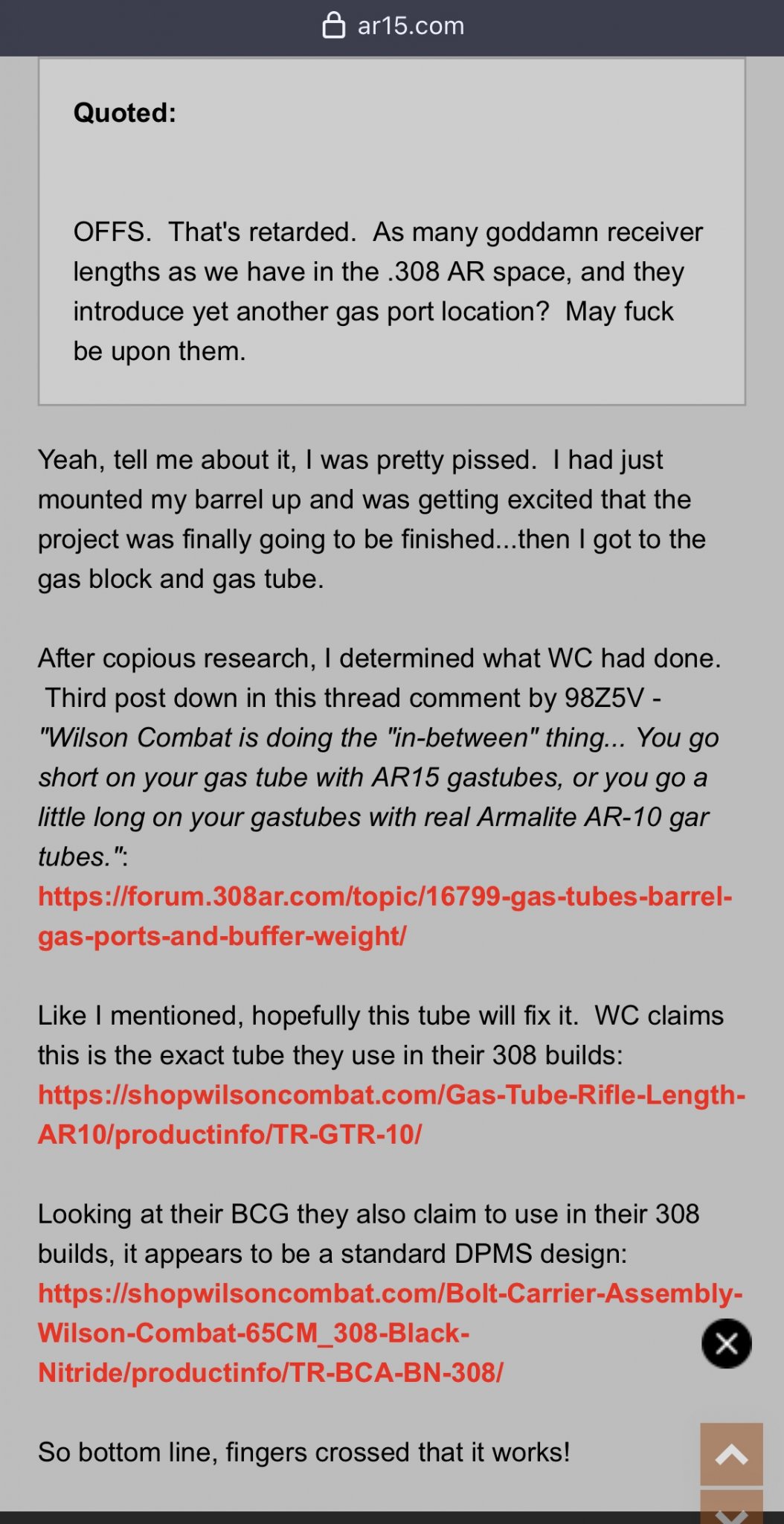

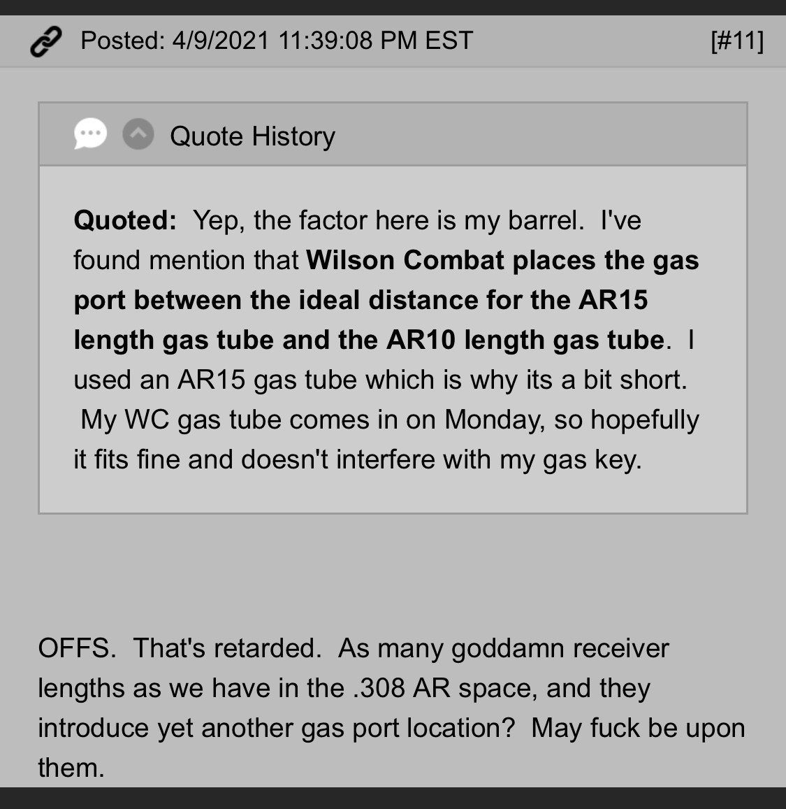

Some more discussion of this shit show from ar15.com back in 2021…

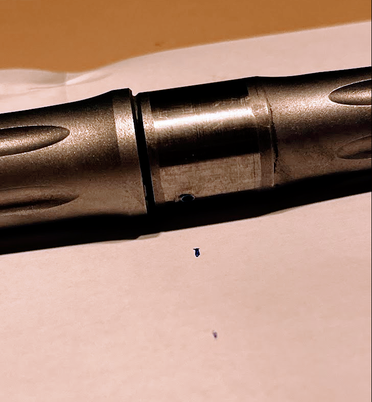

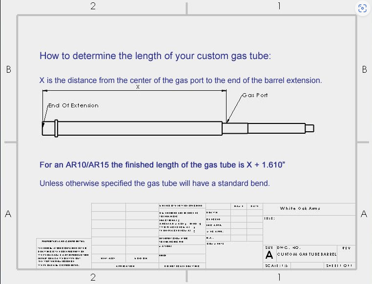

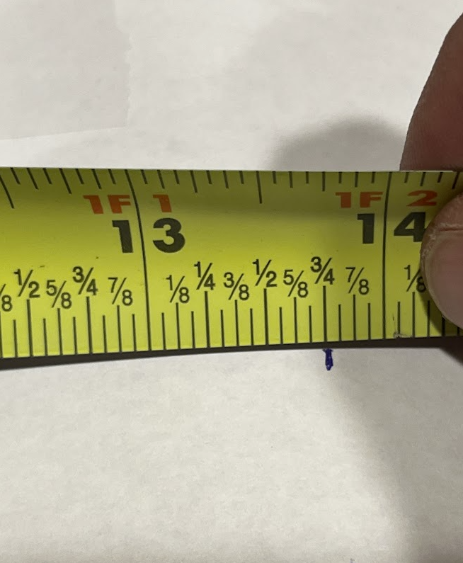

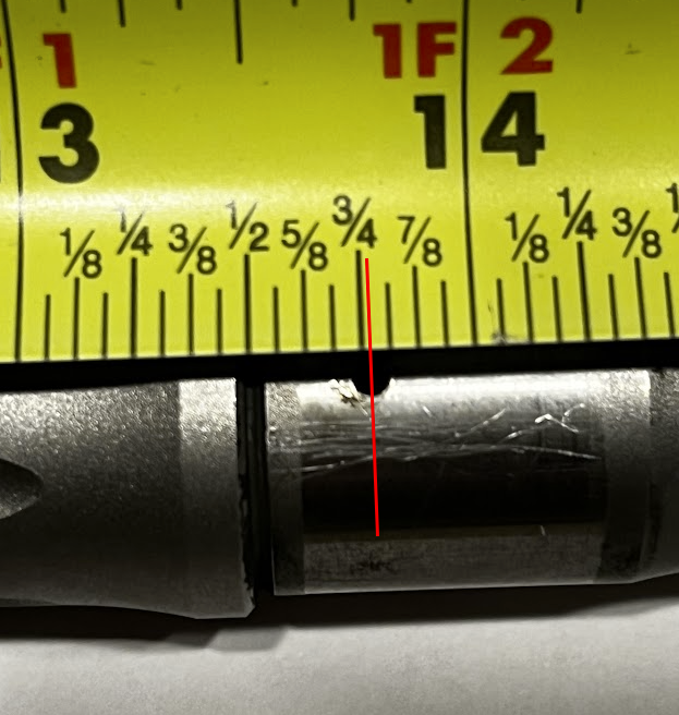

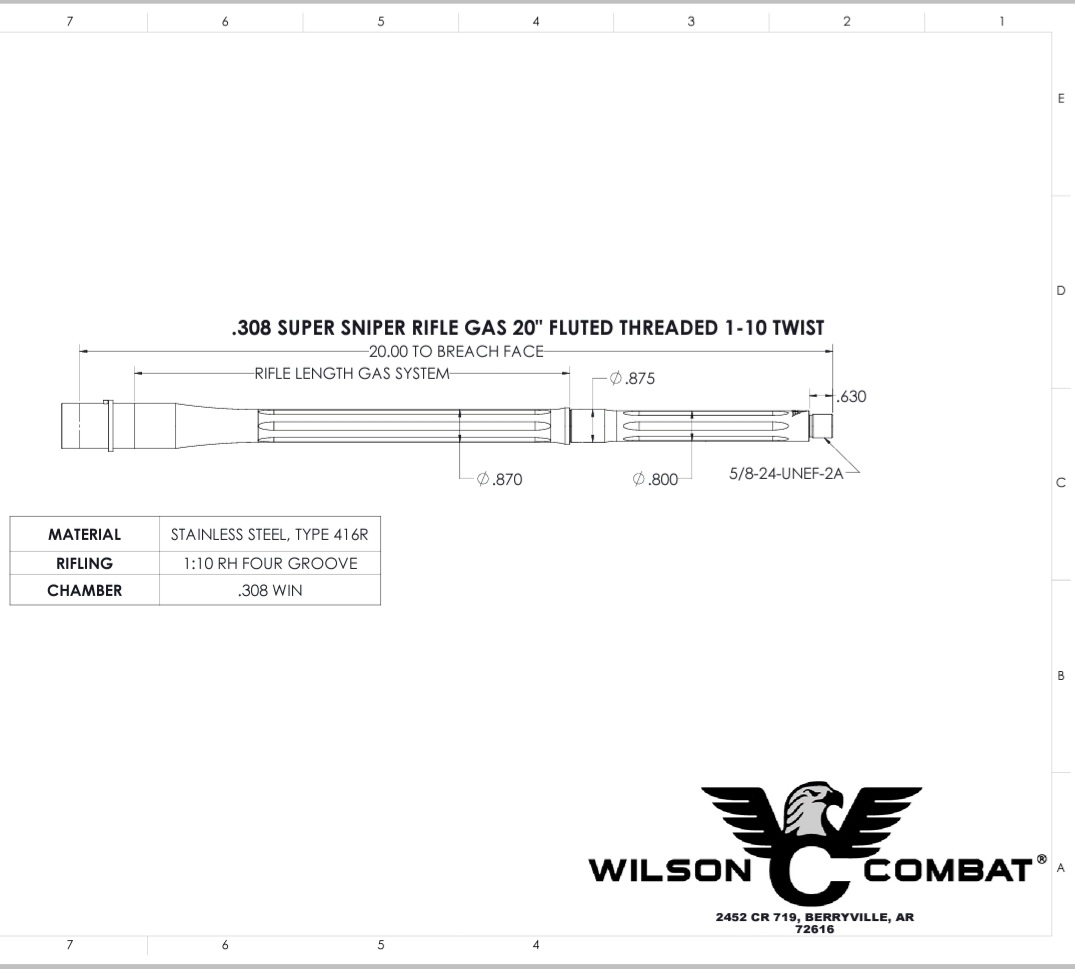

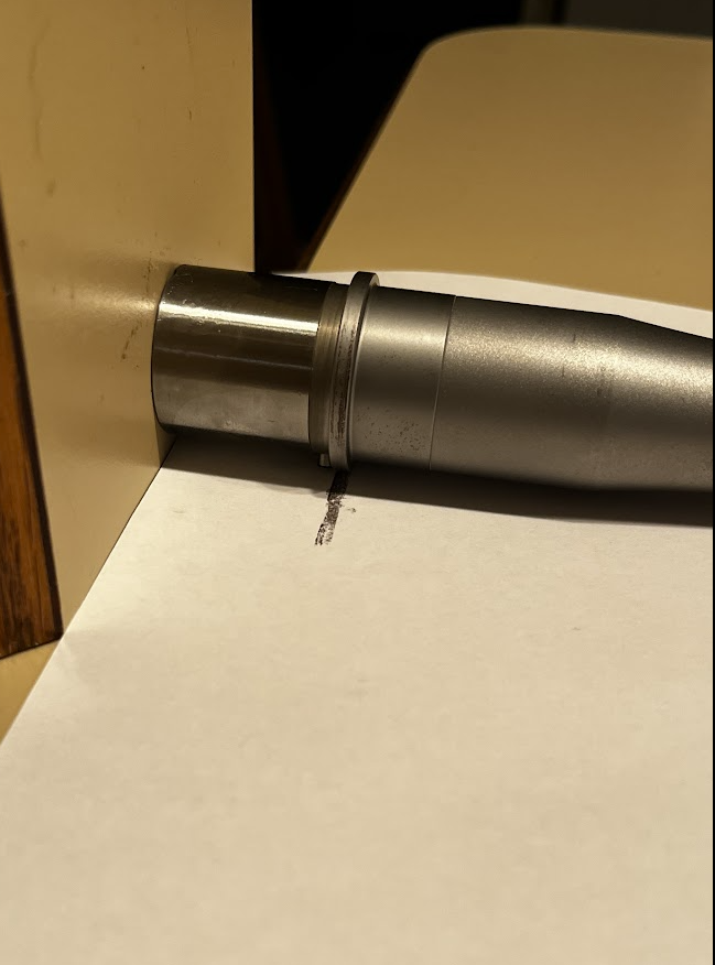

Ok... I took the barrel out of my build and came up with a measurement of right around 13.75"+ a hair for the gas port distance.
Working off the White Oak Armament custom gas tube diagram, I should add 1.610" to that measurement, which works out to 15.375" almost exactly. Doing the math in reverse, 15.375" minus 1.610" gives me 13.765" which I'm guessing is exactly what I have.
I'm going to go ahead and order a custom length 15-3/8" gas tube, but I'm going to call White Oak first and see if this is something they've run into in the past with GWC. That is, Goofy Wilson Combat.
Pics below...
Pics below...
That's like a +1 rifle length gas system. 12.7" vs 13.765"
Reactions: x248716x
The schematic says rifle length but no measurements. Lol It might be worth calling Wilson again and just speaking to someone else to get the gas tube
part was #TR-GTR-10
part was #TR-GTR-10
I think the number has changed slightly since they redesigned the website

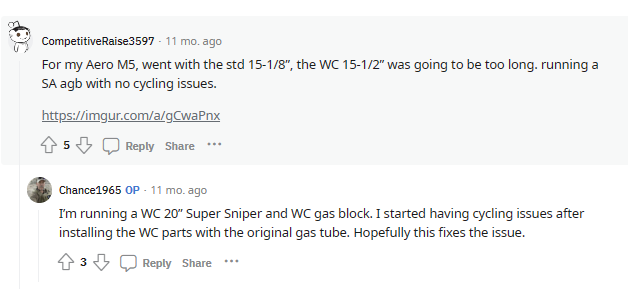

I found this discussion on Reddit late last night with an almost identical build as mine (WC SS 308 20" barrel, SA agb, Aero M5 upper)... gonna drop in the standard rifle length 15.125" tube and see what happens.

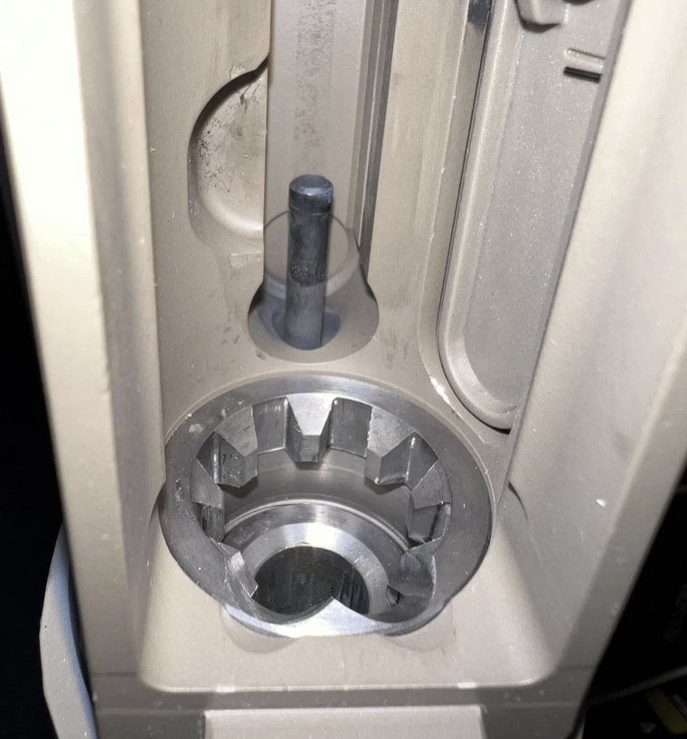

His pictures shows what is traditionally considered "too short" of a position for the tube-end in the cam-pin cutout, but if it worked for him I have to give it a try.
I had the TR-GTR-10, which is what's causing the overgassing problem due to the tube being too long creating too much gas key dwell.

I can understand the frustration, however, I'm not so sure all the WC vitriol is completely warranted. Especially when we all know there is no real AR10 standard that everyone follows. It is up to us to make the right component choices.
I had no issue getting my WC AR10 or other WC barrels to go together properly. However, on the AR10, I tried to use components from one source because I knew there could be issues and didn't want to deal with the frustration the OP is presently enduring. Plus I checked everything 5 times before ordering.
That barrel is a good barrel, I wouldn't be so quick to dump it. I have a couple of them and they shoot great with just a smidge of a tight chamber.
KAC and even the G-man make barrels with other than standard C - M - R length gas port locations for the AR15 platform.
.......and no, I don't work for WC.

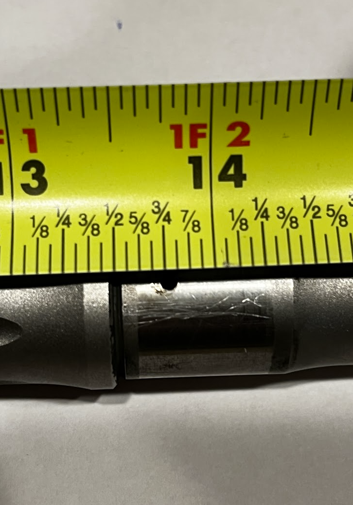

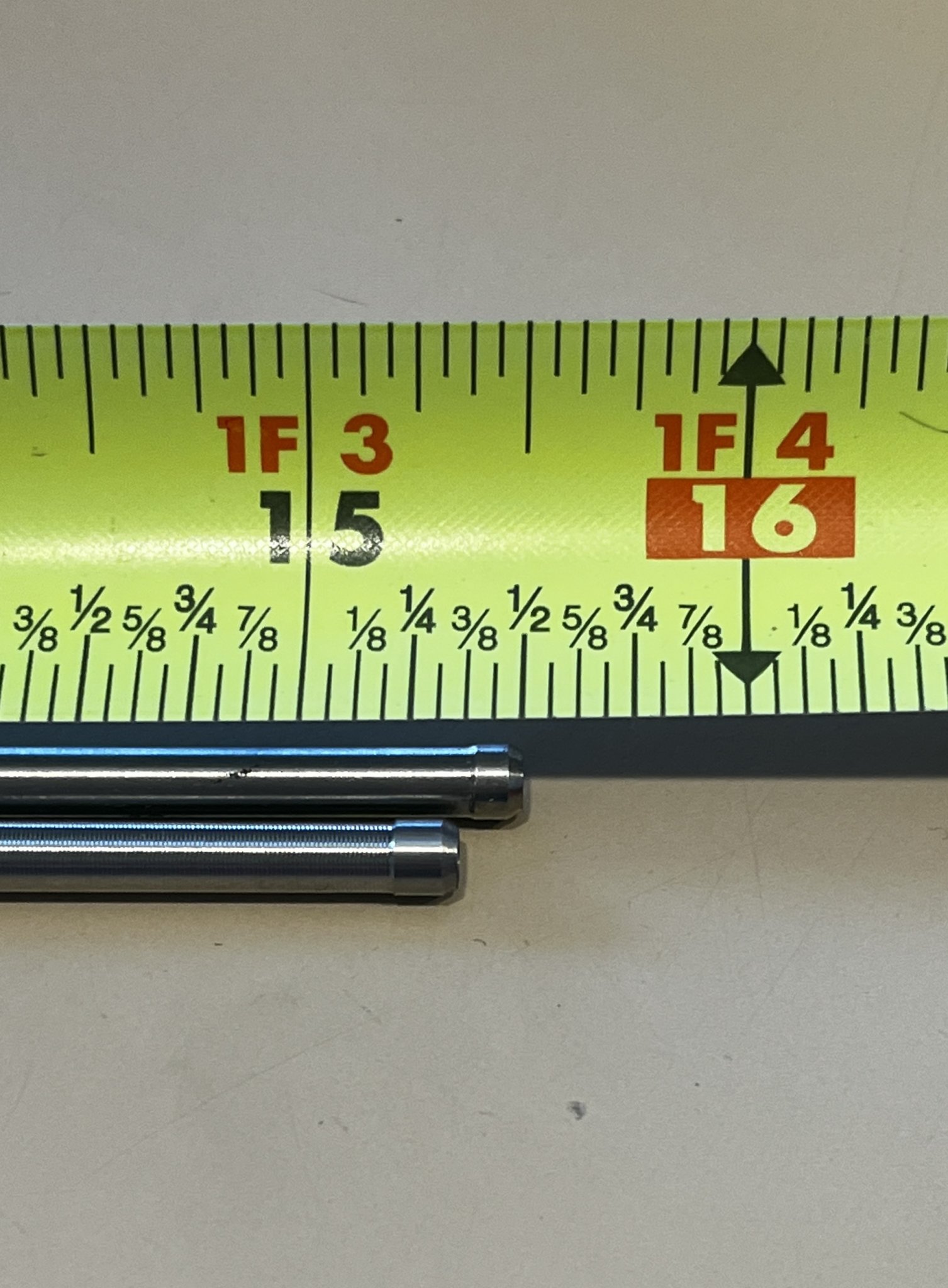

Is the 15.125" overall or to the port? I measured a dpms rifle length tube and it measures overall at your stated length. Length to the port is 14.5625" (14 9/16").
  • Overall length to port is 13.75" plus-a-hair. Less than half 1/16". I'm calling it 13.76"overall length to the port.
  • The 15.5" is the overall length of the WC "AR10 rifle length gas tube" which placed the tube in the back half of the cam-pin cutout and caused severe overgassing.
  • The 15.125" is the overall length of a standard rifle length tube. It will look "too short" in the cam-pin cutout, but appears to be an option that has worked with this WC 20" SS barrel and SA agb.
Reactions: Top O' Texas

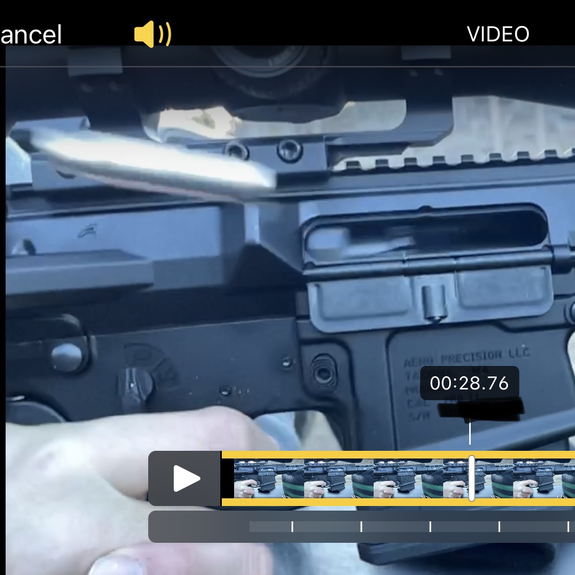

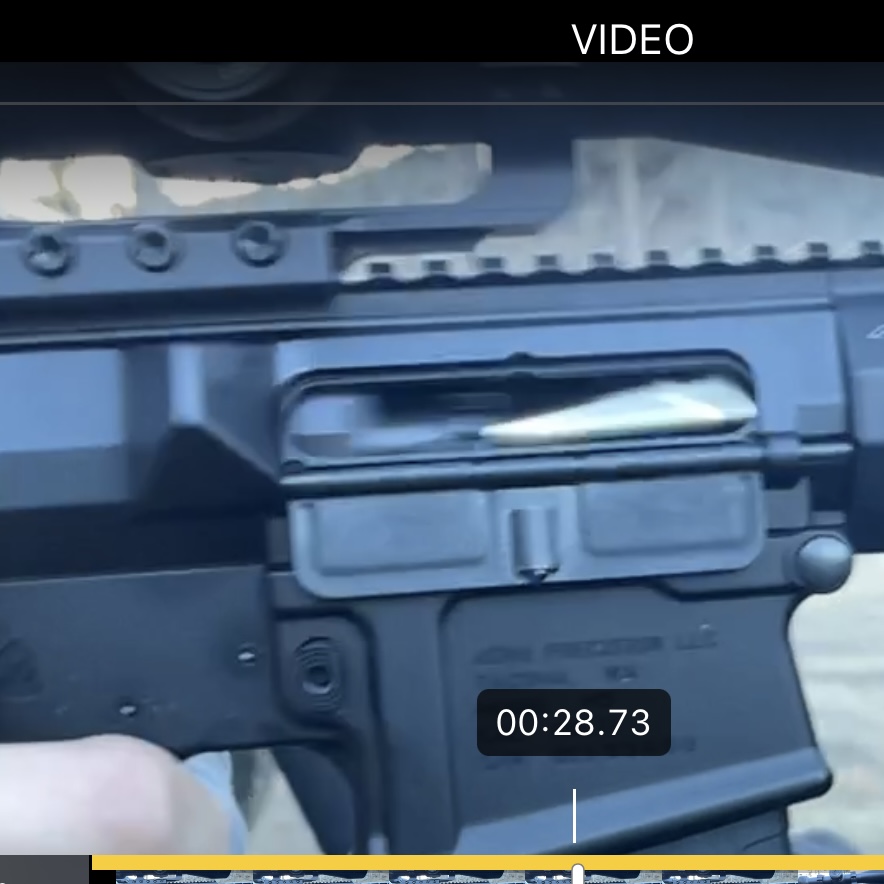

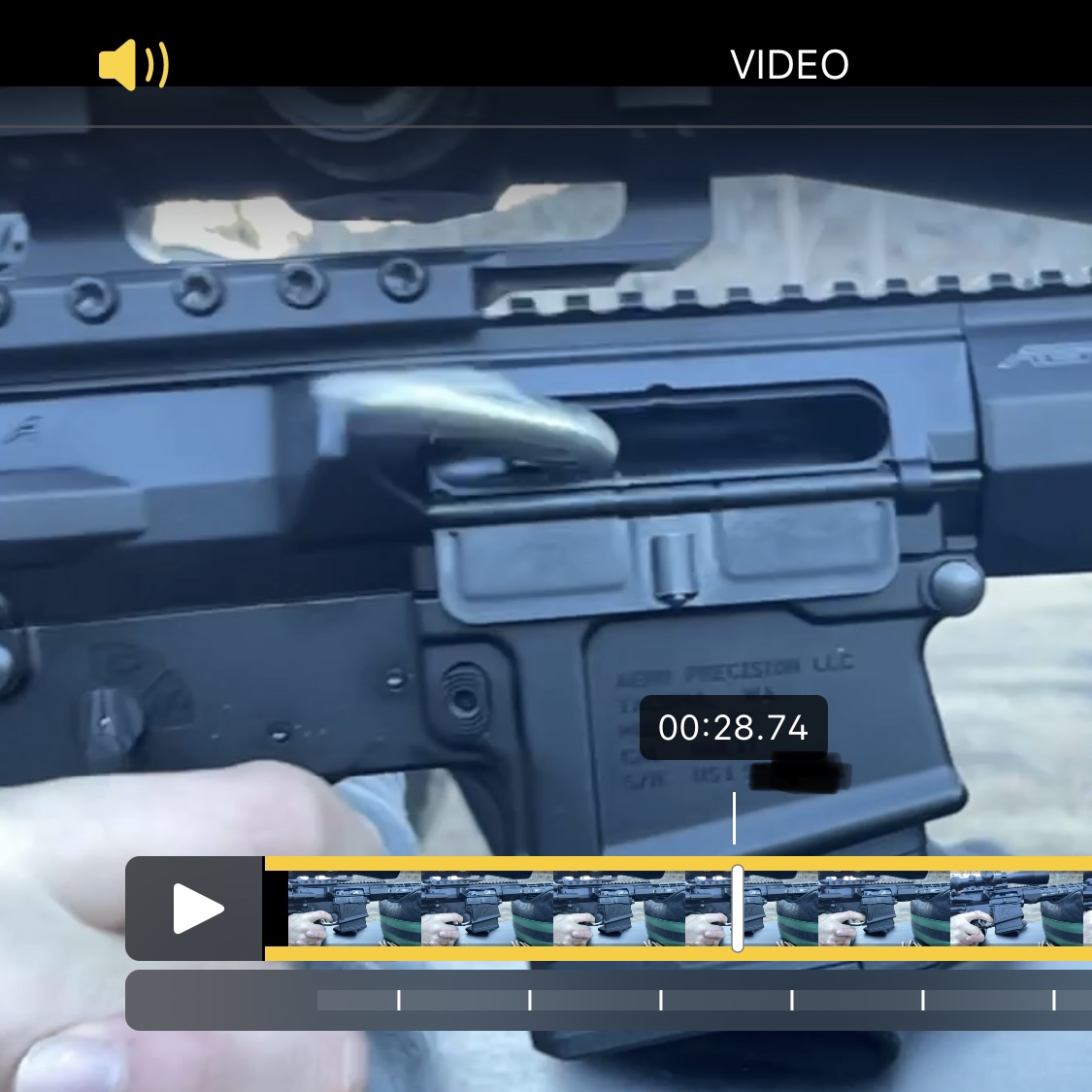

Tested the 15.125” gas tube today, and now she’s definitely undergassed. The casing gets ejected but a new round isn’t stripped off by the bolt… and in slow-mo I can see the bolt isn’t going all the way back.
Seems like it’s still a bit shy of cycling reliably, so I’m going to bite the bullet and buy the 15.375” custom gas tube from White Oak, because I want to keep the SA agb and also run my suppressor.
For those who have been following this thread, the severe recoil is gone, which makes me think my initial overgassed assessment was correct on the 15.5” tube.
I will follow up in a few weeks once the custom 15.375” tube comes in!
Definitely looks to be way undergassed based on the ejection position in the last image. Are you shooting with the SupArms AGB wide open or at the default 18 clicks?

I’ll try and quickly summarize, although I don’t have port distance from receiver (I’ll get that upon next, and hopefully final, teardown - when I install the custom tube).
Port distance from breech (end of barrel) is 13.75 plus a hair. Just guess-timating to make the math work out, I’m using a-quarter-of 1/16th inch for the “hair,” which equals .015625. See image below.
Using the White Oak guideline of adding 1.61” to the overall gas port distance we get:
13.75 + .015625 + 1.61 = 15-3/8” almost exactly
Since 15.125 is way too short, and 15.5 is way too long, I’m hoping this is the answer I’m looking for.
Just ordered the custom gas tube from White Oak.
After a lot of measuring, remeasuring, and consternation, I ultimately went with a 15.3" tube, which sort of splits the difference between the 15.5" and the 15.125".

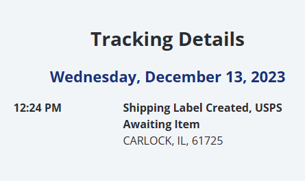

Well that was fast! Just got the shipping notice from White Oak Armament... the custom gas tube might be here as soon as this weekend!
After more reading and more measuring, I wasn't sure if 15.3125" or 15.375" was the correct length, so I split the difference and went with 15.35". Hopefully I can test as soon as Saturday.

I don't have any WC parts let alone a complete rifle from them. Is WC that bad on compatible parts where WC is extremely proprietary? m110/sr25 is compatible with dpms, but ar10 (armalite) isn't along with fal/rock river parts.

That was why I used a Wilson bcg with a Wilson barrel. Everything else that has to do with the gun actually running should be standard shit. But we are finding out the gas tube is not.

There's really no such thing as "mixing" AR10/LR308 parts when dealing with Wilson Combat... they use a proprietary gas port distance which throws a wrench into the works. It's a massive gray area, which is further complicated by their lack of disclosing these proprietary design decisions on their website or product pages. And there are guys out there who avoid WC entirely because of this issue.
Either stick with 100% WC parts (gas blocks and barrels), or figure out a custom gas-system solution when you step outside of their ecosystem by selecting a third-party gas block.
Reactions: v220221
I just said screw it and called white oak and told them to send me whatever length you just ordered. Lol I'm over wondering about if I can get it to run with the shorter tube or not. Just gonna put the longer tube in it and go from there.
