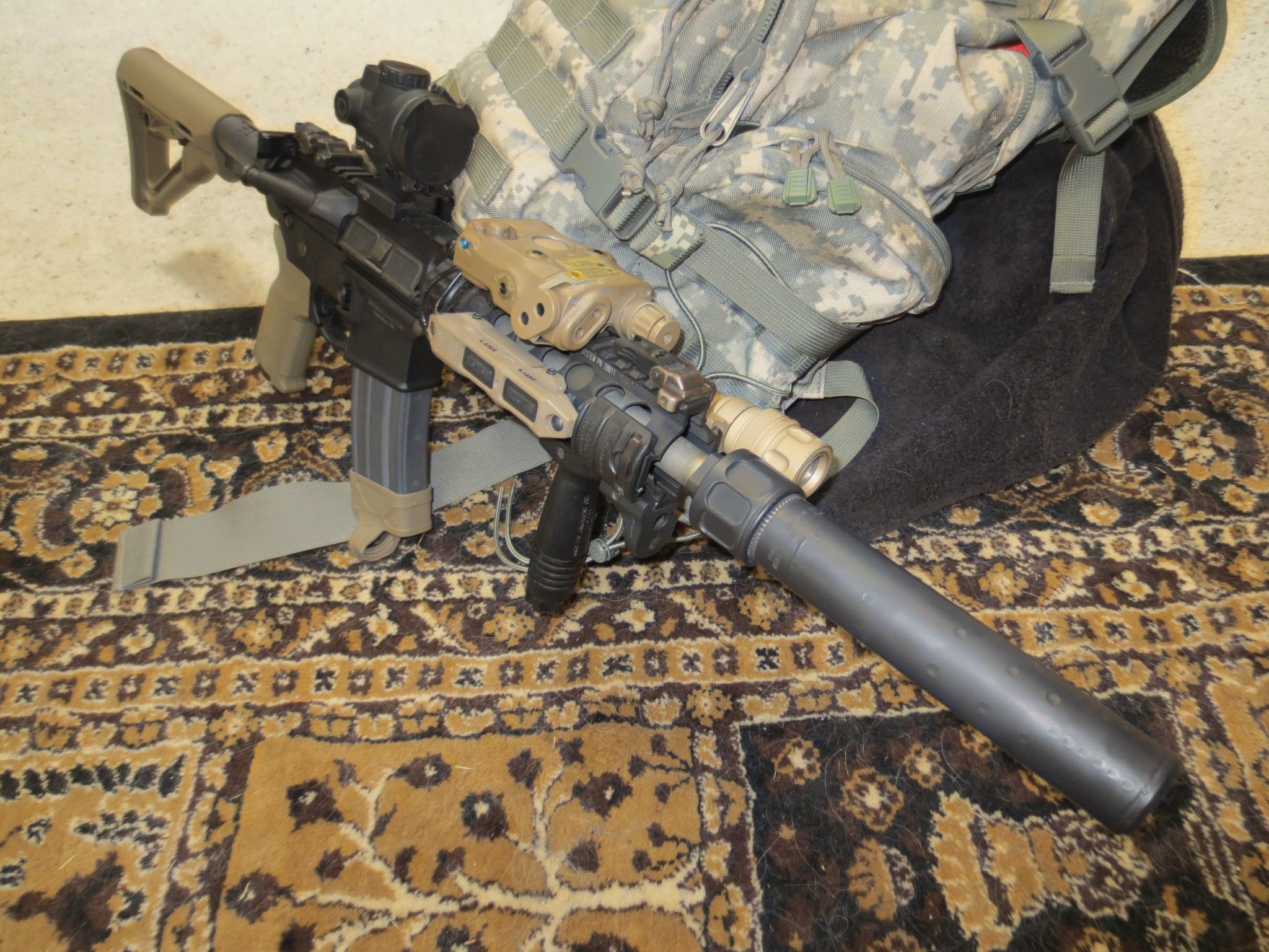

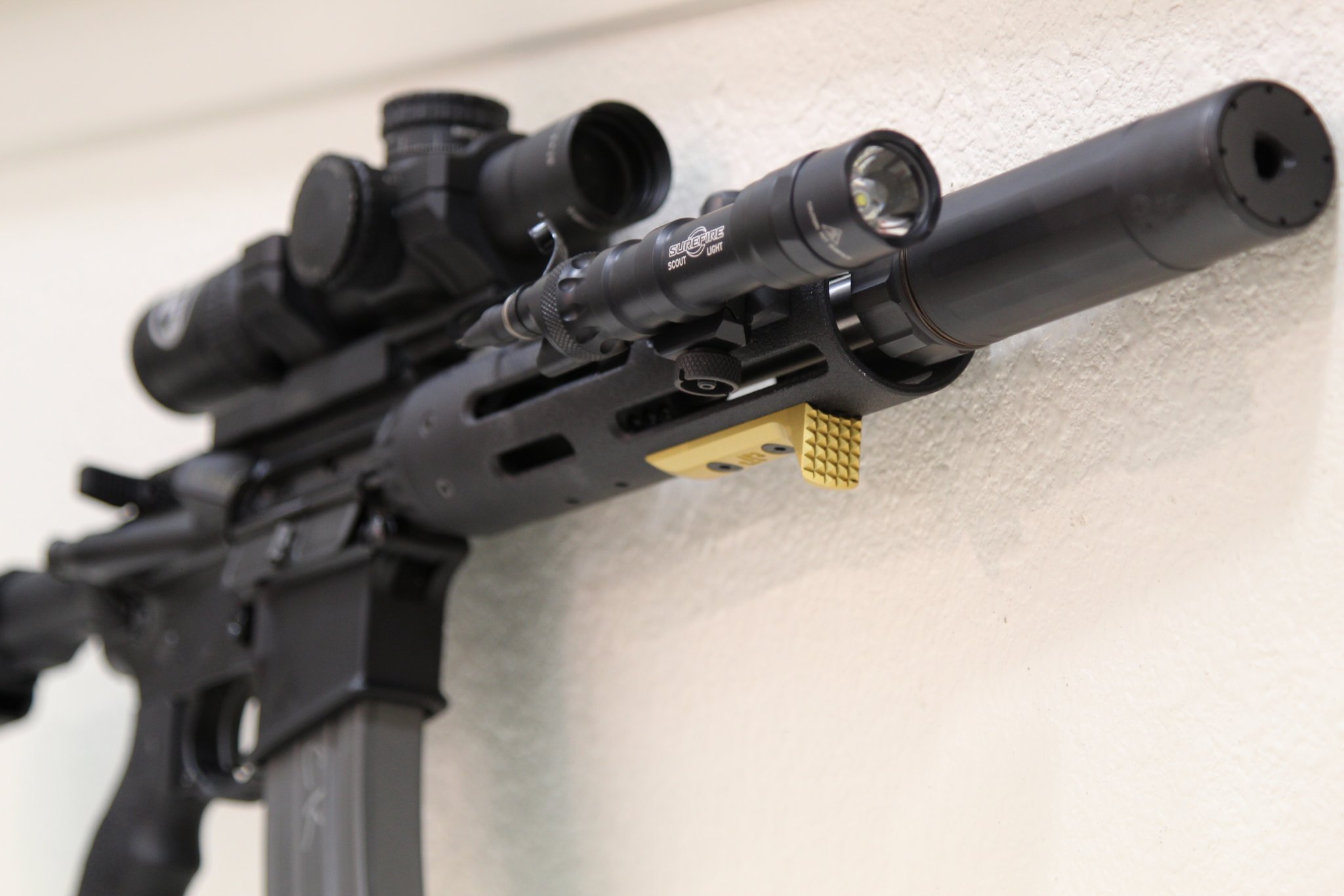

I own a few of these so BTDT. If you REALLY want a killer PDW, check out this build:
It's actually an SBR but same deal. Uses TBAC cans, usually the Ultra 5. This thing is smaller than most at ~20.x inches. Almost 21" I think. I've had grips, lights and optics on it but I have another SBR pimped out with all the sandbox gear and a CTR stock. This one got basic irons for fast acquisition and it's damn fast. What you want in a PDW. And I can always clip a Surefire grip light on that bottom rail if I want but I usually keep it covered with a KAC rail cover. The PRI triangular FF tubes, you almost never see 'em but they're very comfortable. This thing is accurate and it's very reliable. Not to mention fast with that 3G trigger. The straight grips Mapgul makes for short rifles are just great too IMO.
If you have the coin though, a Sig would be a better buy IMO with the folding stock and all. That or maybe a BT APC .300, I bet those will only go up in value too.

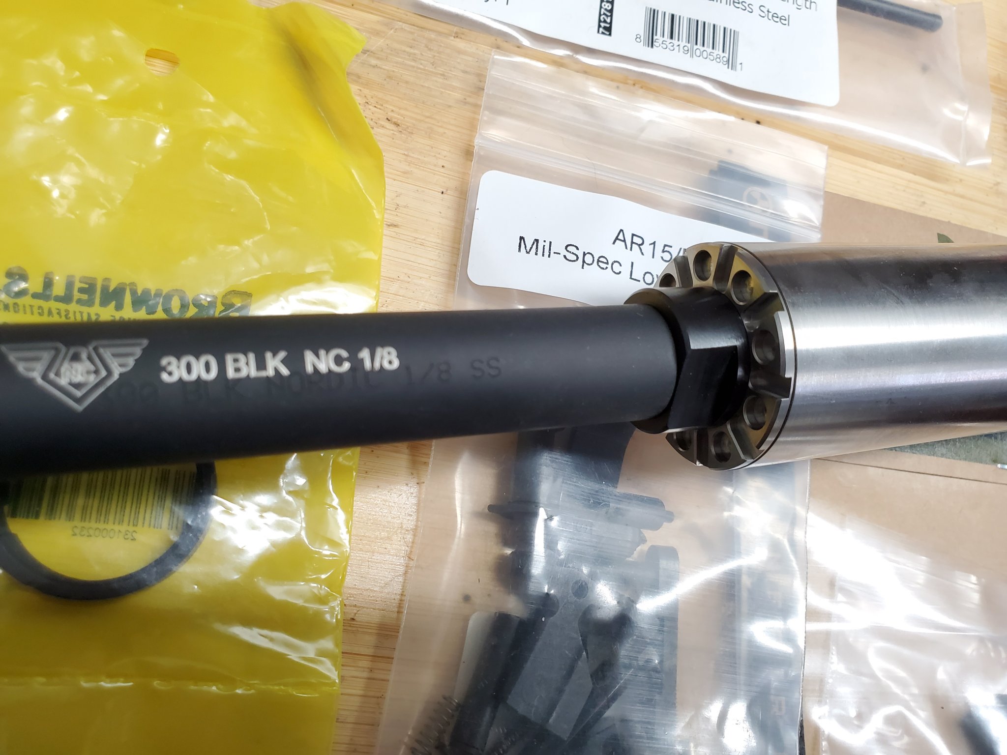

I have a 10.5 in Nordic Conmponents 1:8 barrel on my project I'm about to finish up. I will be running a form1 6 inch titanium can with mostly Ti baffles.
It may be a little bit but I'll follow this thread and post data from a magneetospeed.
Pic .......just because.....project still in the works

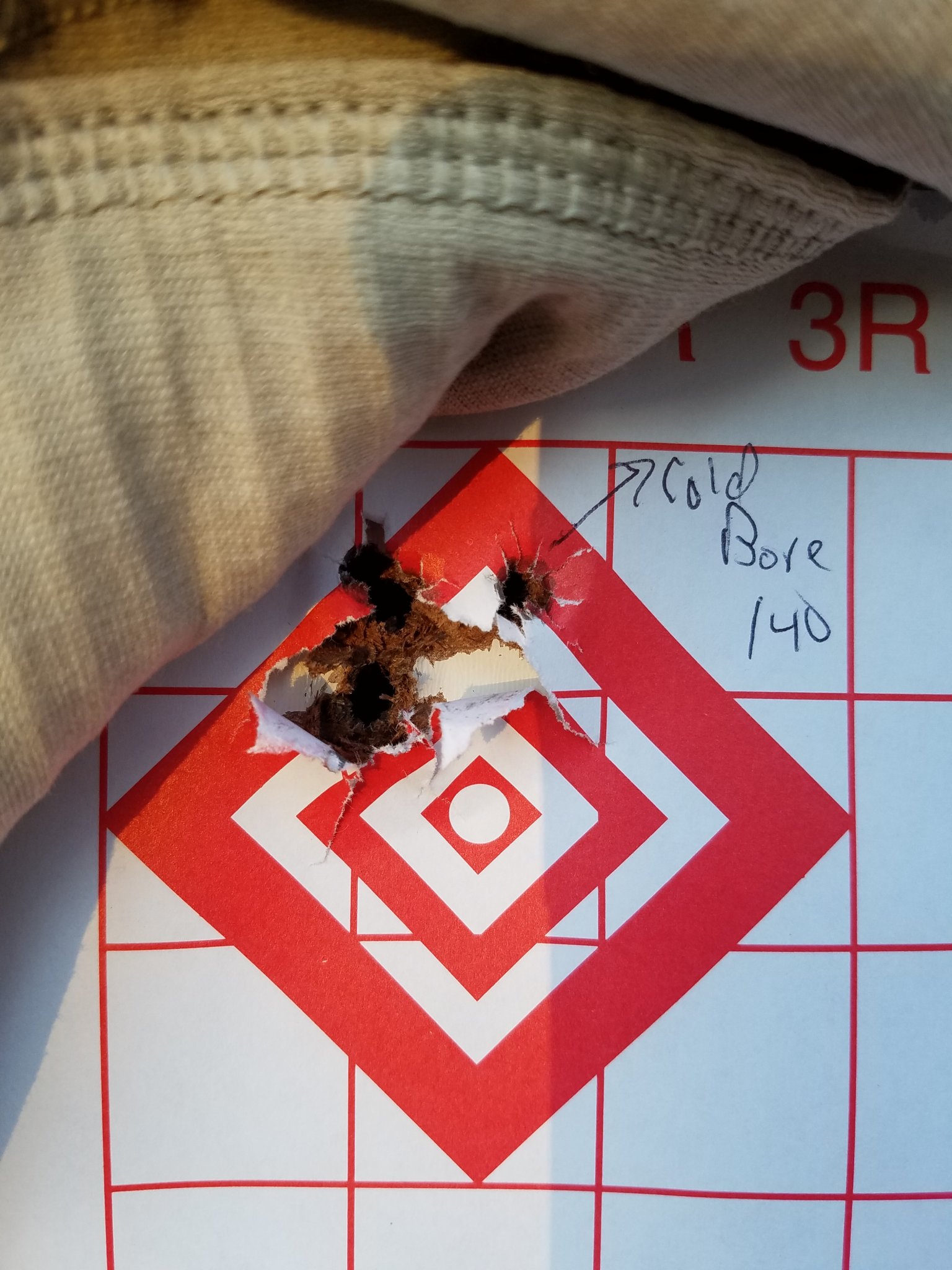

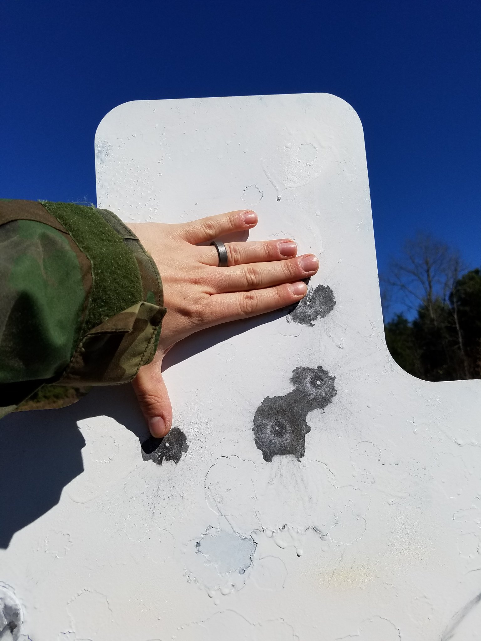

Here's last 4 rounds I had in my magazine fall 2017 one day when I decided to shoot a group at 1100 yards after having fun 600-850 and just watching rounds fall nearly on top of each other.
Another pic to show why tracking cold bore shift matters

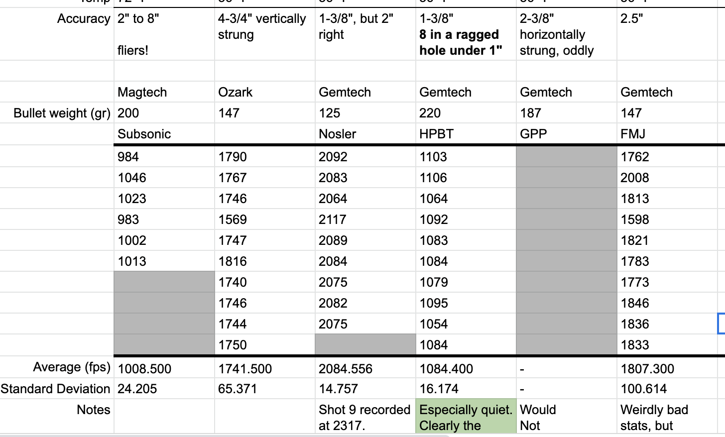

I only have the .300 to run subsonic and suppressed. 10.5" on my SBR lower.
FWIW, here's the ammo I have shot so far, not all of which are subs. Got another half dozen loads I am slowly gathering (I don't reload for reasons), sometime will get to a big range day, then pick one to buy by the case and just /shoot/ the thing finally. I have too many projects :)

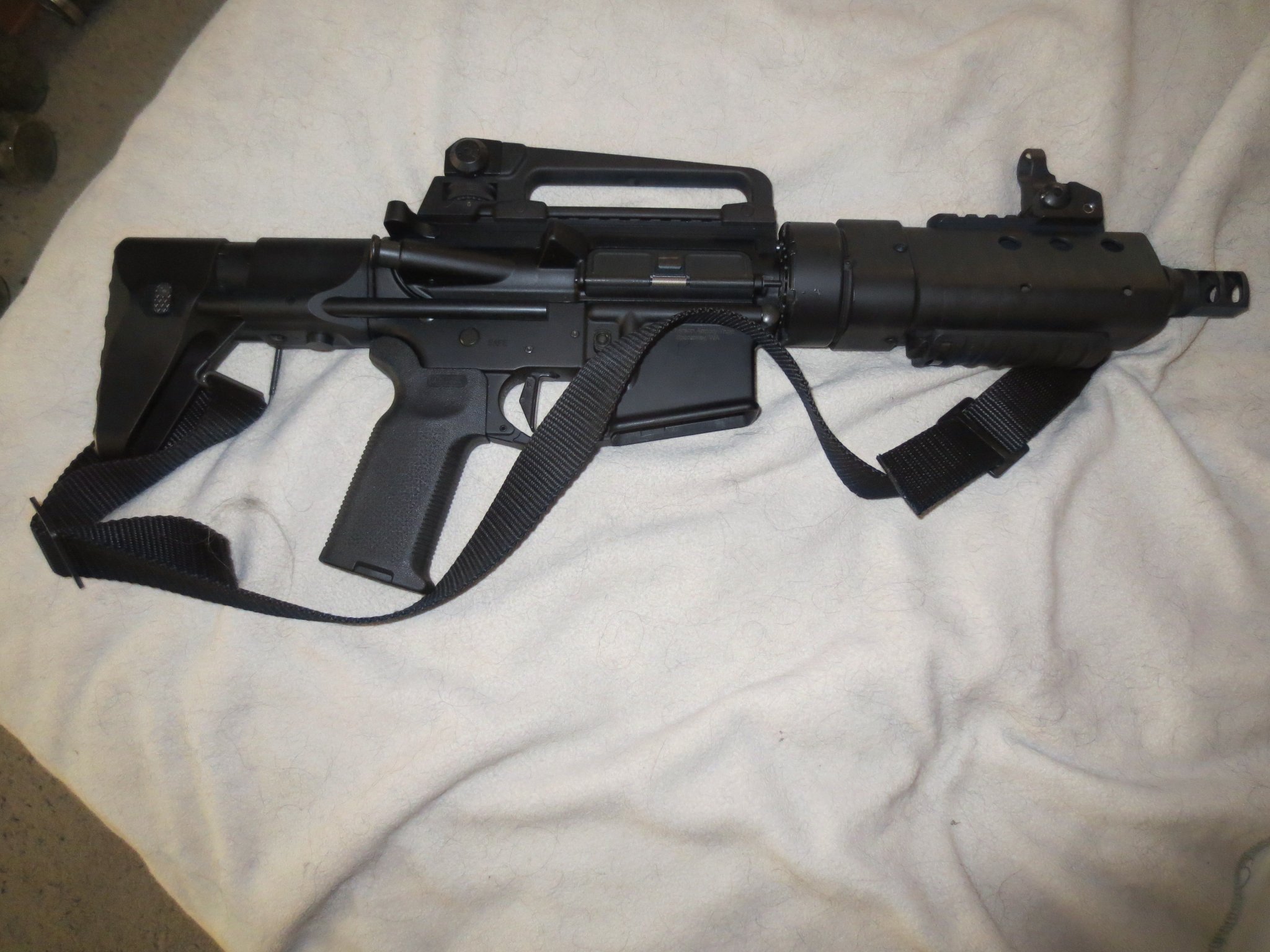

Here's another Noveske 8.5" bbl. No problem cycling supers or subs, they got their shit together on these barrels. ~1MOA depending, but that's the norm with their SBR barrels. The other thing is it'll ring a 12" plate at 200 as fast as I can pull the trigger, supers or subs. It's a bad bitch.

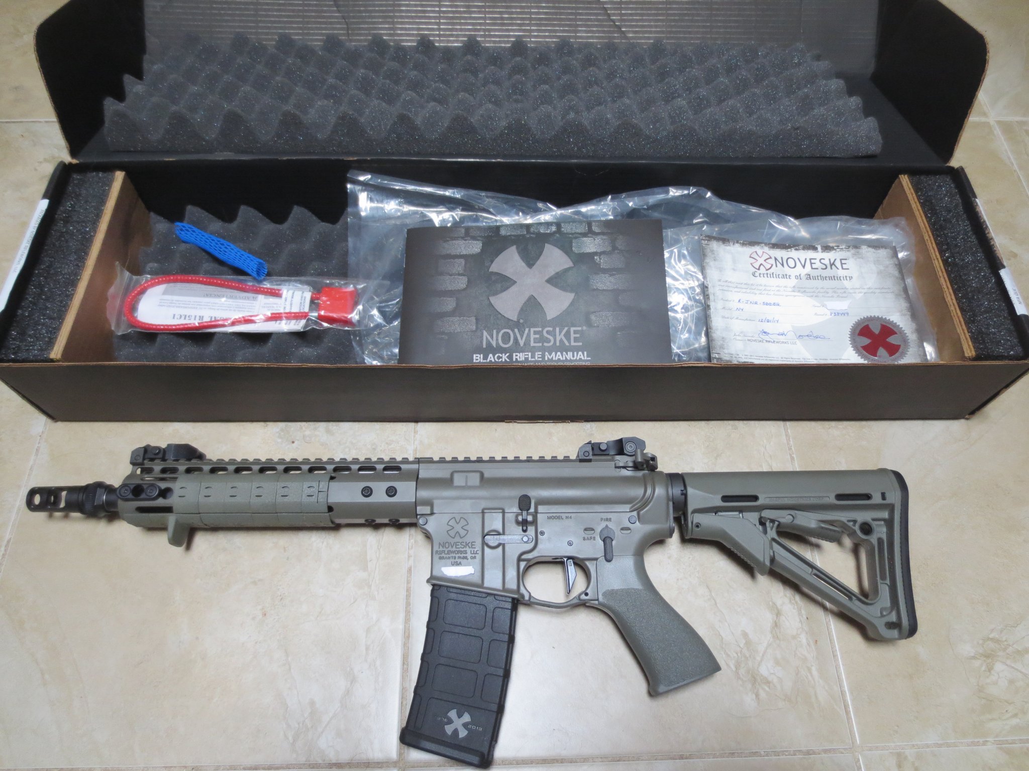

This one is a 10.5 that I've honestly never fired but it's the lightest and most svelte rifle I have. It was the ex's rifle and a factory Noveske build. I bet it's damn nice, maybe one day I'll shoot it. #75 Johnny Rifle:
TBAC 30CB9 works great, but I really like the Ultra 5 with these. It takes enough bite out of the bark to make it manageable and it keeps it short. However, the SDN6 was designed for this round and despite having a shitty mount it's actually a good can (well, it is if you have a good method of unfucking the mount situation, mine is to buy ten, fine the best one and send the rest back --much easier than polishing or refacing the bevel surface). Saker is a better 7.62 QD can though and since prices came down it's hard to beat. Omega 9k is another good buy, it works on 9mm too and is short like the Ultra 5 but steel so it can handle more abuse. The KAC can is the titties but it's too damn costly unless you already have an SR25, then it's not a bad deal.
I have a 16" rifle too but it's no more or less accurate than these and it only has slightly more velocity with the supers and I've clocked 'em myself. It makes a nice addition to the M4 family though and the ACOG is mapped to that barrel so that's a plus.

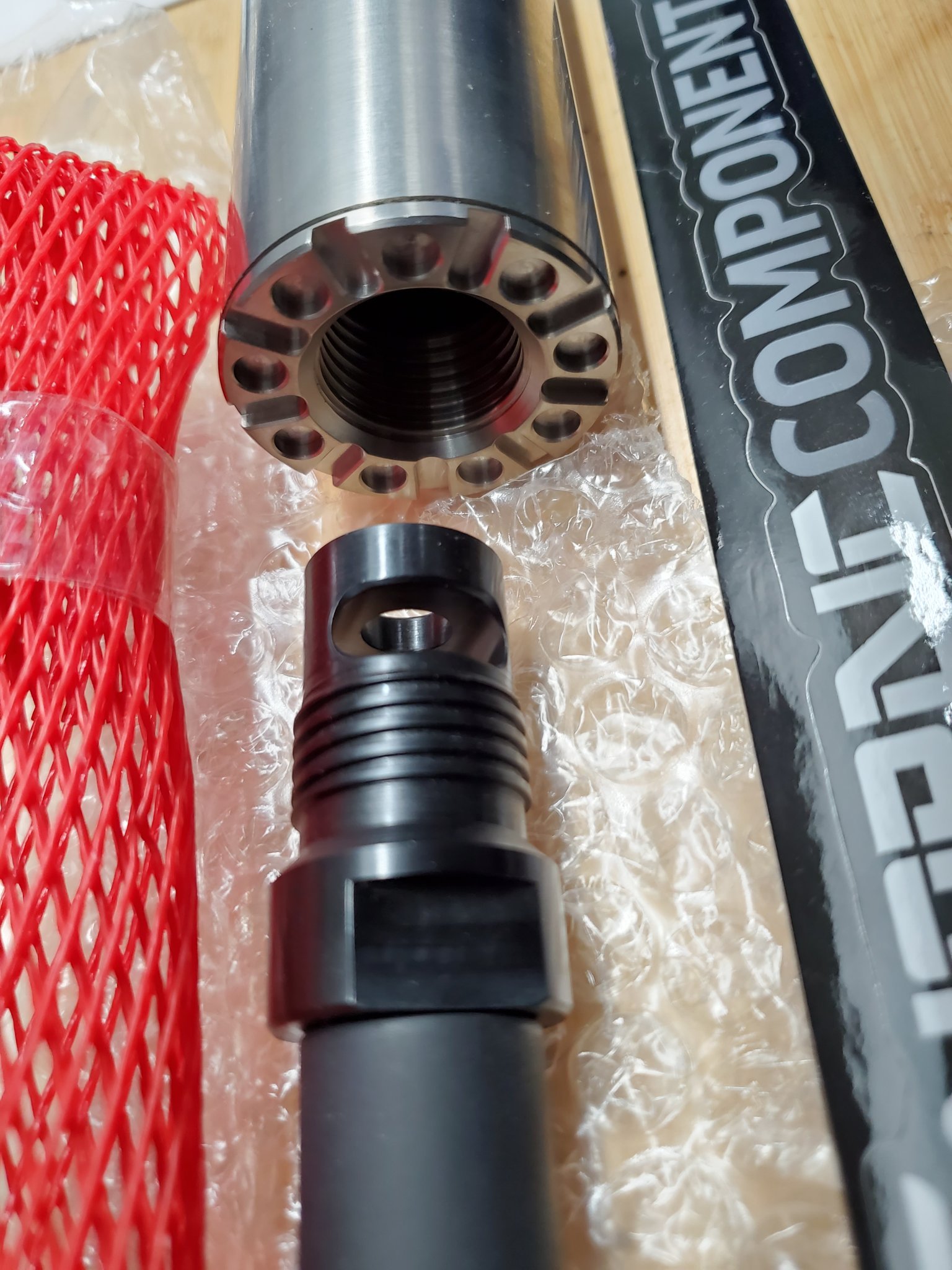

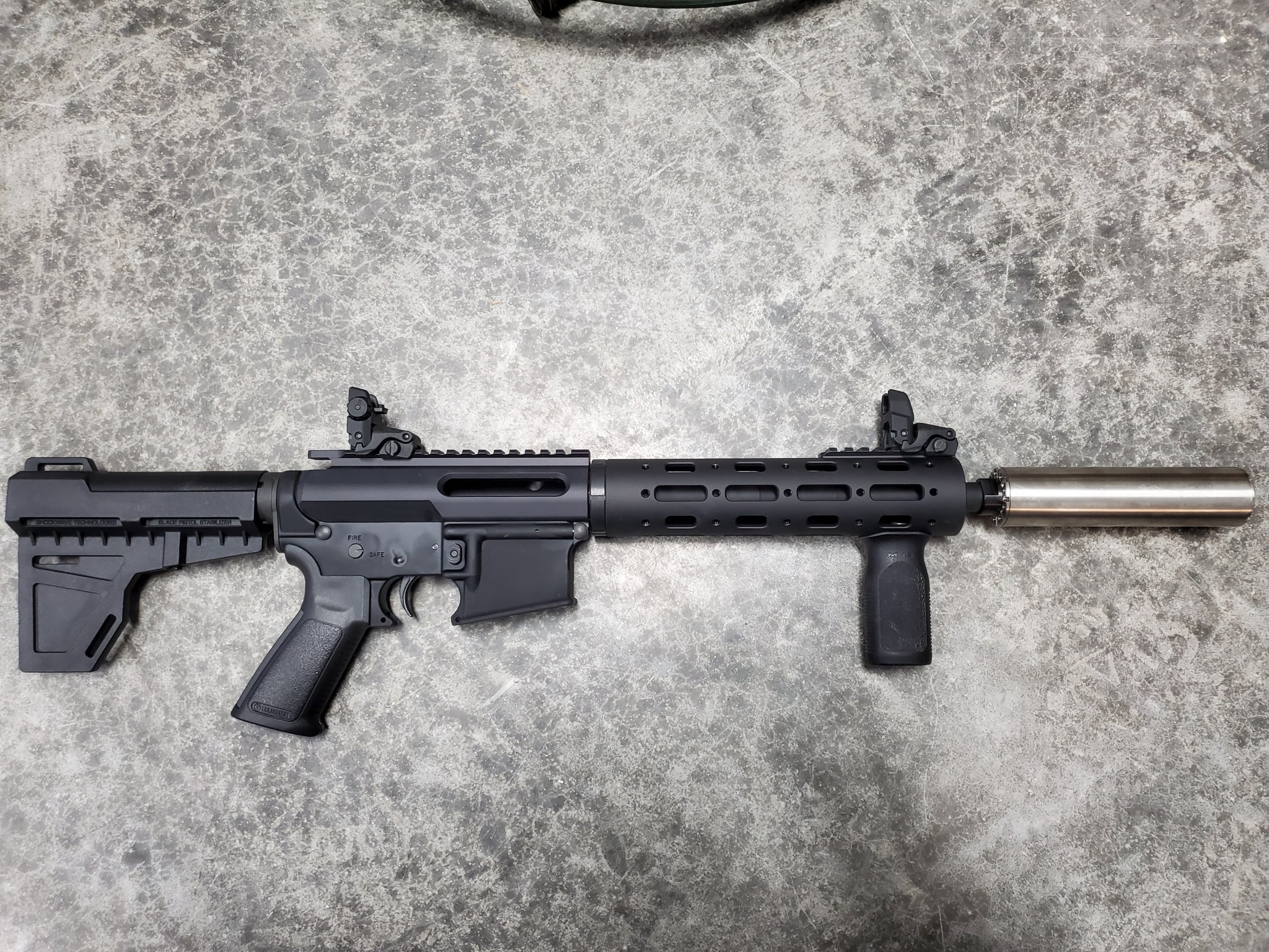

More form 1 pics
Brake and other components are from SD Tactical
