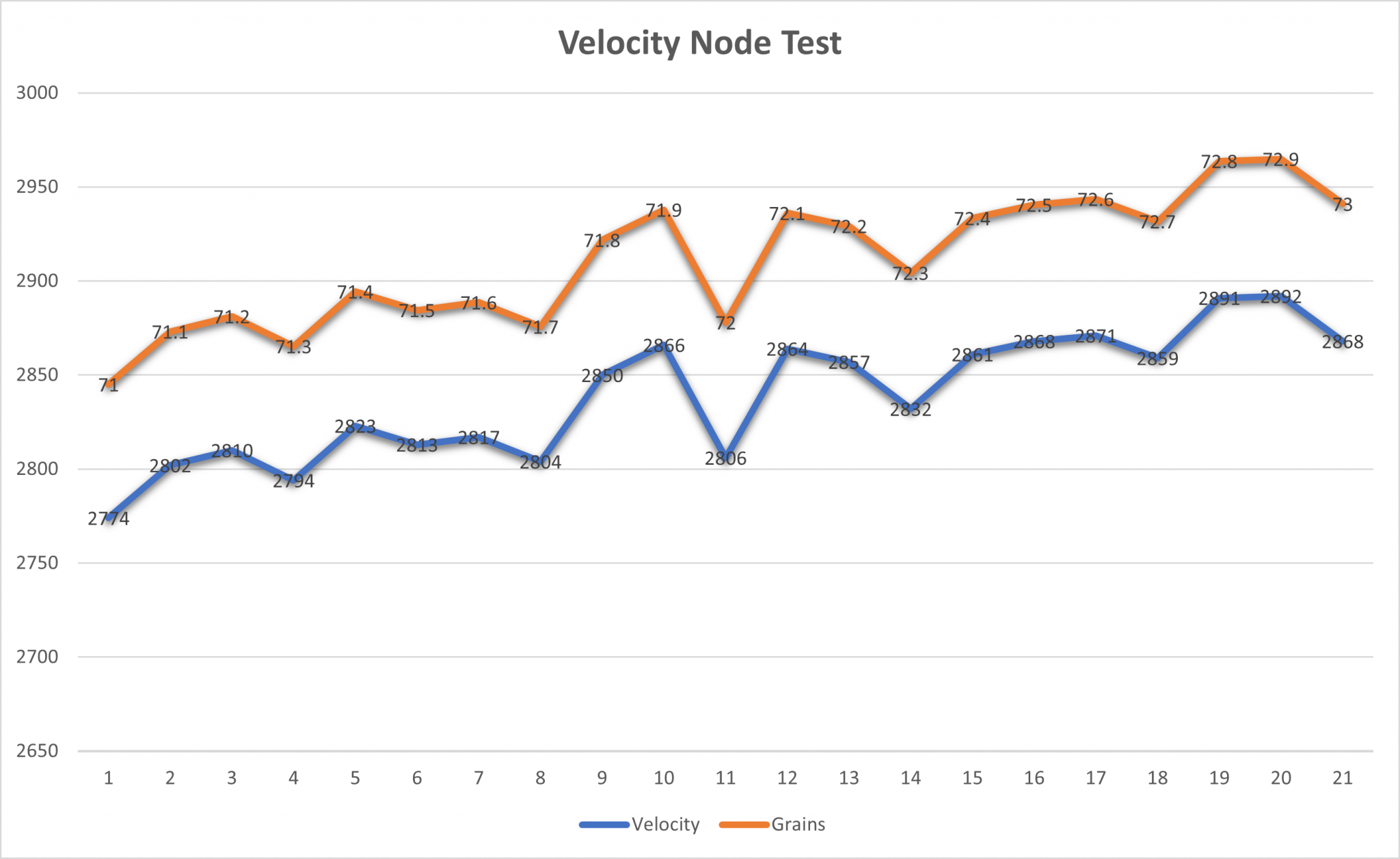

I am Looking for some help lowering my SD/ES on my 300 Win Mag. My Current Load is preforming with a consistent, unimpressive ES of 80 FPS and a double digit SD.
210 Berger Hunting VLD, .005 off the Lands
71.9 Grains of H4831SC, Charged and Weighed with FX120I
Sig Fireformed cases (weight sorted), AMP Annealed (Every Firing), shoulder bumped .002, Neck tension .001 using Redding bushing die. Giraud trimmed. Cleaned with SS Tumbling media.
Federal 215M Primers
I am testing the loads in 10 round batches.
Barrel is a 1/10 24" Bartline Heavy Palma
I have tried a variety of different powders and charge weights in this rifle , including N165, H-1000, and Retumbo. As well as different bullet combinations and seating depths (212, ELDX, Berger 208, Berger 230, 220SMK) all with almost the identical results over a magneetospeed V3 Chrono.
I have had success with other calibers, .338LM, .308, .260, and 6.5 achieving a sub 10 SD but after a year of chasing my tail with this 300 Win mag any help would be appreciated.
Thanks
@Rocketmandb Over 3 grains 70-73 of powder I selected the the charge weight with the best ES, followed by the smallest group. After some research this evening I suspect I may need to find a wider velocity node that is more forgiving.

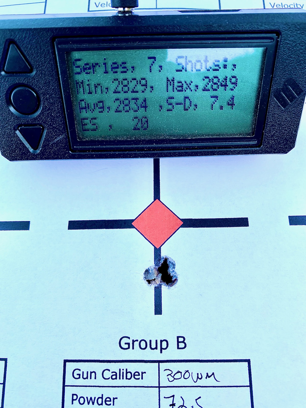

Went .003 Neck tension W/ mandrel, graphite lubed, changed powder charge from 71.9 to 72.5, backed the seating depth to .010 off the lands. shot a 6 round string at a 7.4 SD and another 4 round string at 7.6, both near 1/4 MOA.
I will confirm with a larger test lot tomorrow, but the numbers are defiantly manageable now. Lapua Brass Next.
