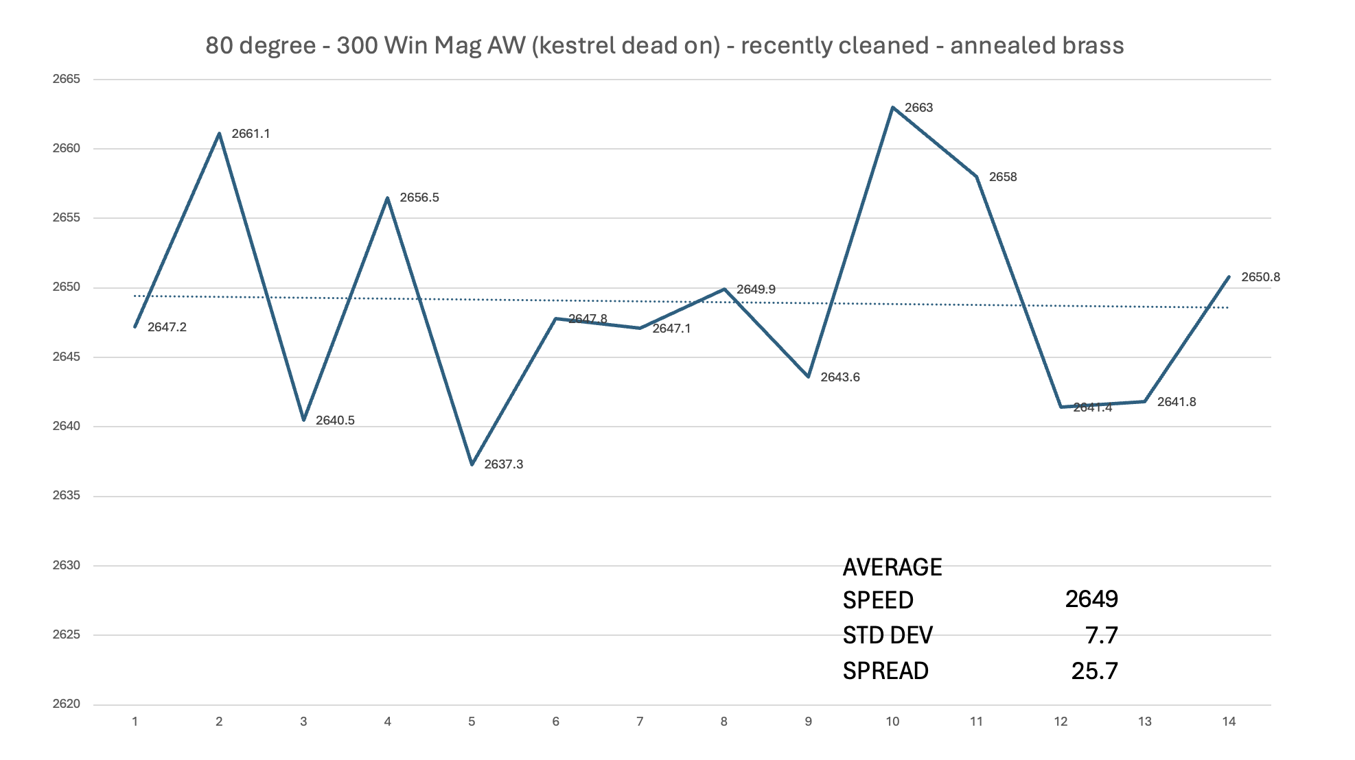

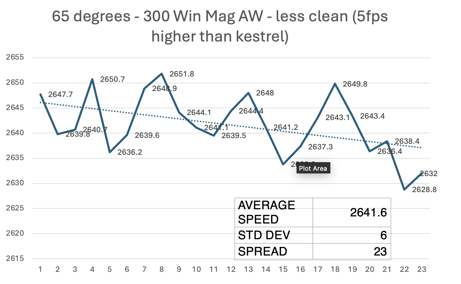

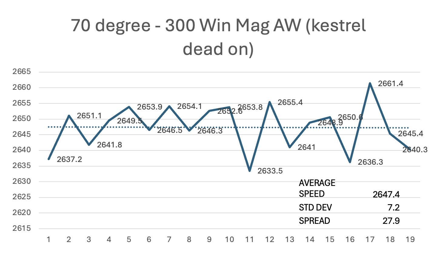

    The garmin has made tracking speed so much easier that I find myself using it way more than I ever did my Labradar. This has really improved my temp tables and made my cleaning regimen more precise.
    I created a few charts from my last 3 trips out here in Florida and thought you guys might find them interesting, too. I was expecting to see a more flat slope from shot to shot, with the beginning or end (heat) showing more deviation, but I see a pretty consistent up and down (despite the low SD and ES).
    The last group is flame annealed, which I normally don't do but want to test how it changes my SD/ ES (this is a small sample so I'm not drawing conclusions from it yet)
    The rifle is a 20" 300 Win mag with a straight-proof barrel and Dead Air Nomad. Shoting Lapua, h4350, berger 215 hybrid and 215m.
