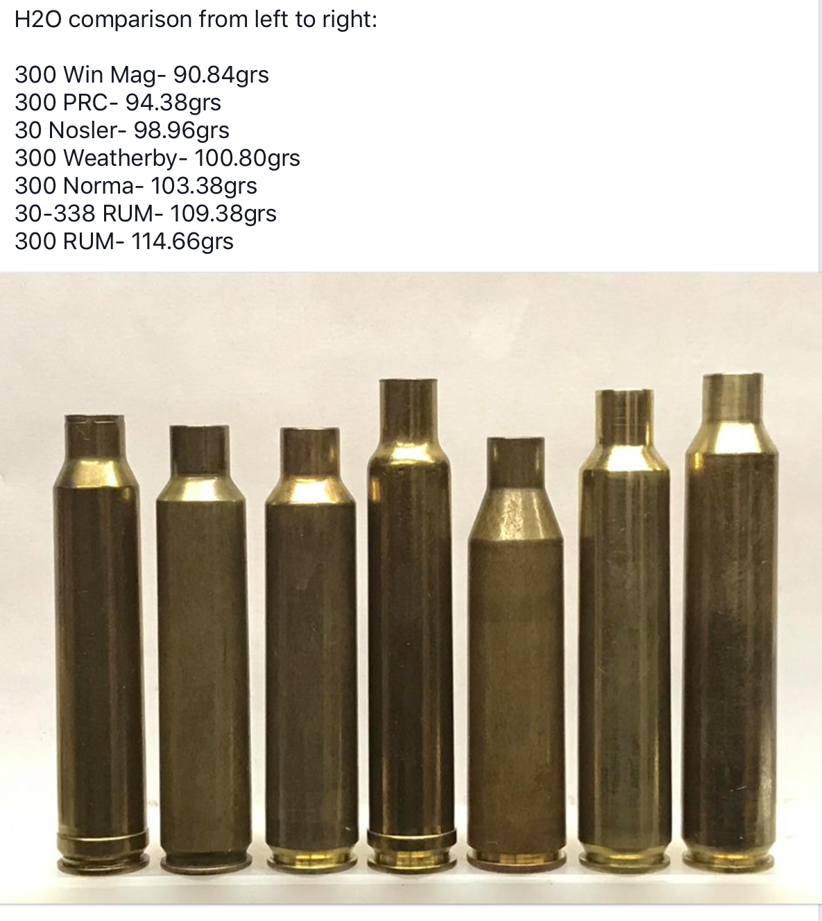

Like what was said above, if your starting from scratch, I would go 300 PRC. In no time we will see quality brass. Redding is already spitting out custom dies. But you will need CIP mags and a chassis, action, etc that accepts it.
If you need heavy .30 pills going as fast as you can, the Norma is the better solution. But brass is 2+ bucks a piece. And your using upwards of 10gr of powder more per round. And you need an XL action.

I wish Peterson Brass would make brass in 300 PRC, I just emailed them asking if they would in the future but they told me that they have a hard enough time keeping up with their current line so that don’t have plans on making any.

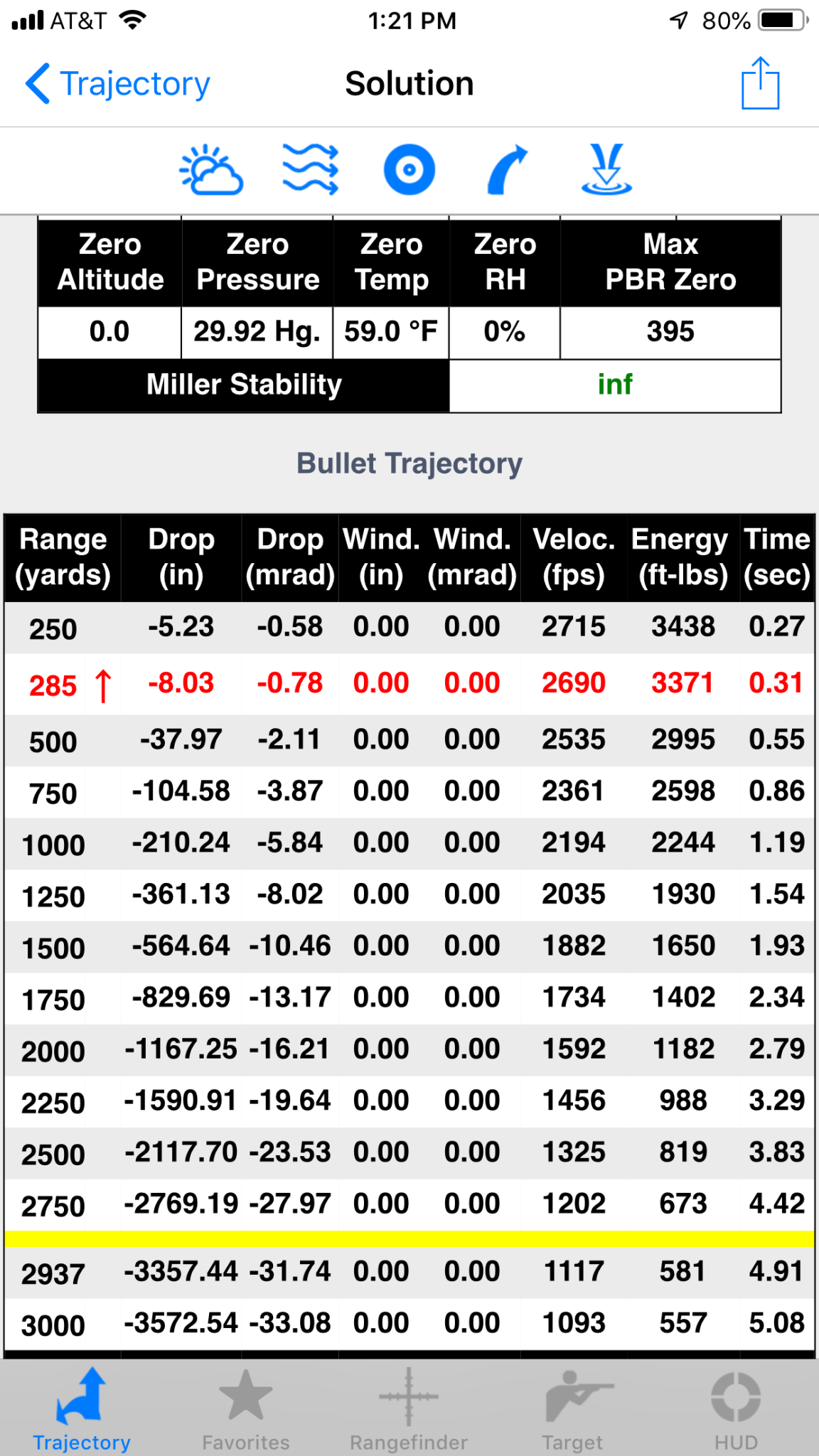

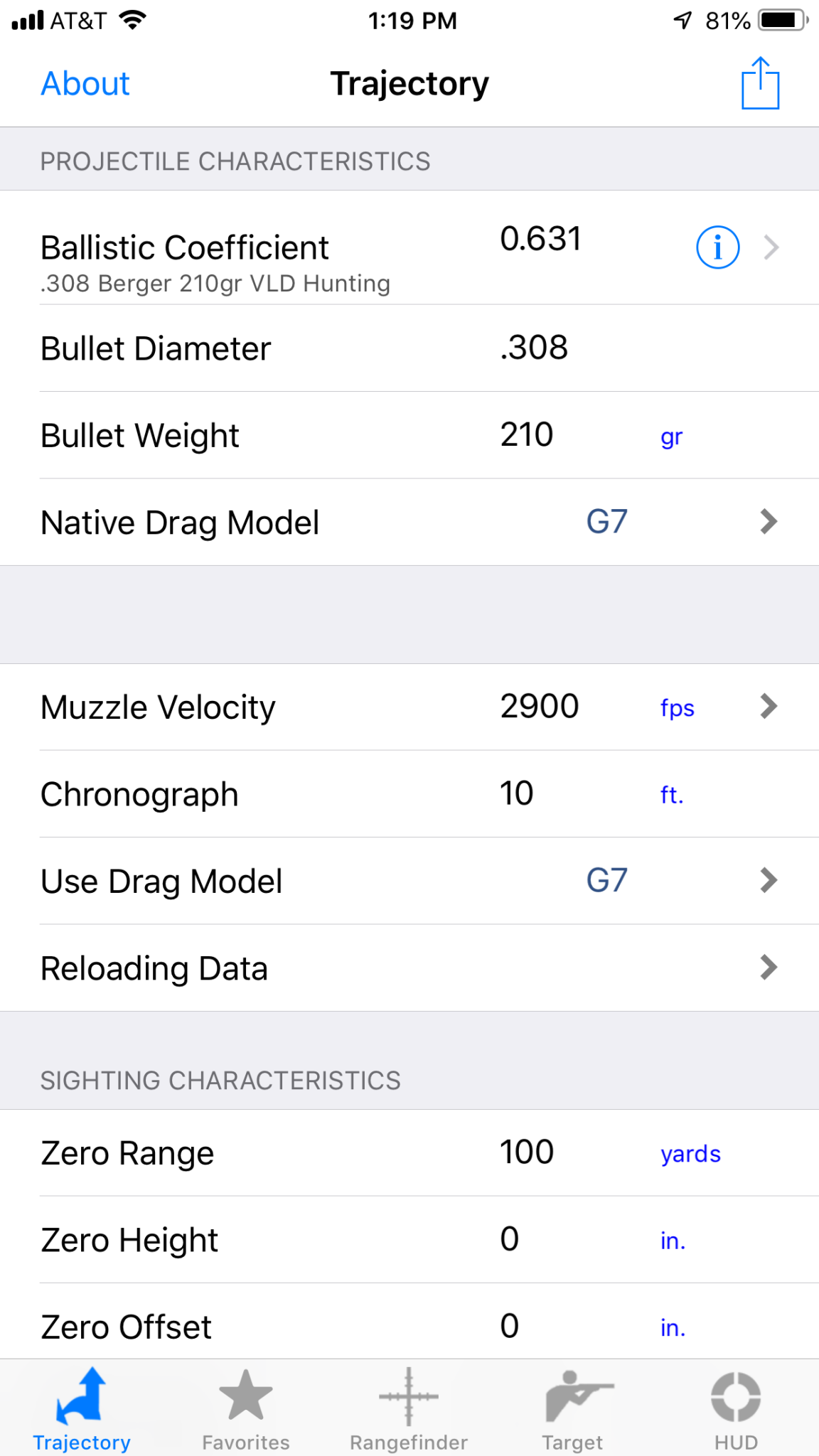

What 30 call bullet with a bc of .631 are you shooting and how fast to stay super out to 2900? My freaking 338 lapua smashing primers can't get fast enough with a bc of .8 to stay super that far???

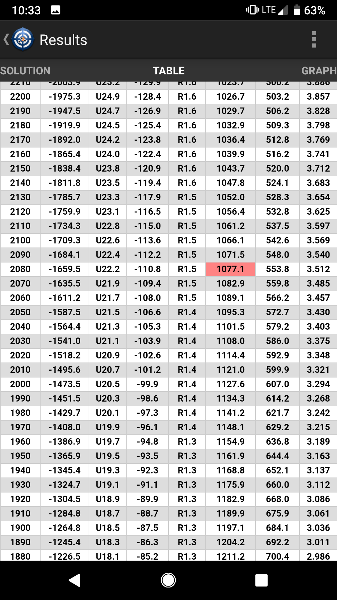

At 2950 fps in one of my 300 wins with 215 Berger's is super til 2k. Not sure about the other guys data or conditions.

I'm not saying a 300 win can't go 2k yards I agree I have done it myself not arguing your data in fact I'm not arguing at all...I just wanna know how fast and what bullet with a bc of worse than a normal 300gr 338LM is staying super to 2900 yards?.... That is almost 30% more super Sonic range.
Btw I shoot at 4500-5000 feet.
I'm curious also. Wasn't my statement... So the other guy will have to answer that. Probably a typo. I'm curious too!
I was able to get the Hornady calculator to show this, supersonic at 2900 yards. Of course that was with a 225 gr bullet with .777 BC, starting at 4500 fps. Hmm.
Edit: I think he was saying it was starting at 2900 fps and stayed supersonic to 2000 yards, not to 2900 yards. This seems closer to being possible although not with a .631 BC.

I’d have to look at my actual dope, because g7 seems consistently optimistic for me, but .300WM and .338LM aren’t THAT different balistically. The LM just gets there with a lot more ass.
Hence I run out of turret elevation long before it goes transonic.
Fig... Dude.....Common a g7 of .6??? Rerun your calculations using the g7 bc for a 210 vld. You ran them using the g1. Should be like .318 for a g7.......
You’re right. It’s not switching when I switch models...
It's all good we all make mistakes. Most 300wm loads go sub right around 1700 yards Imo. Not an bad round by any means just other big 30ies that play the elr game a bit better if that's your primary purpose.

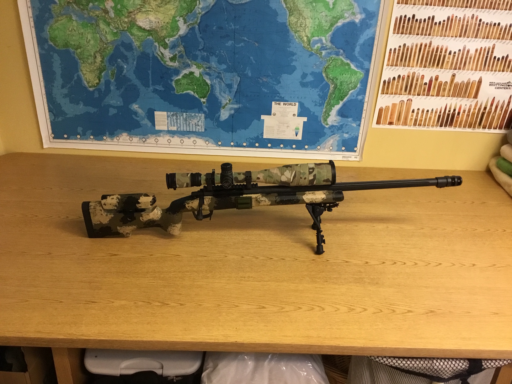

Now i have a MRAD with a S&B scope on it lol In 300WM!
