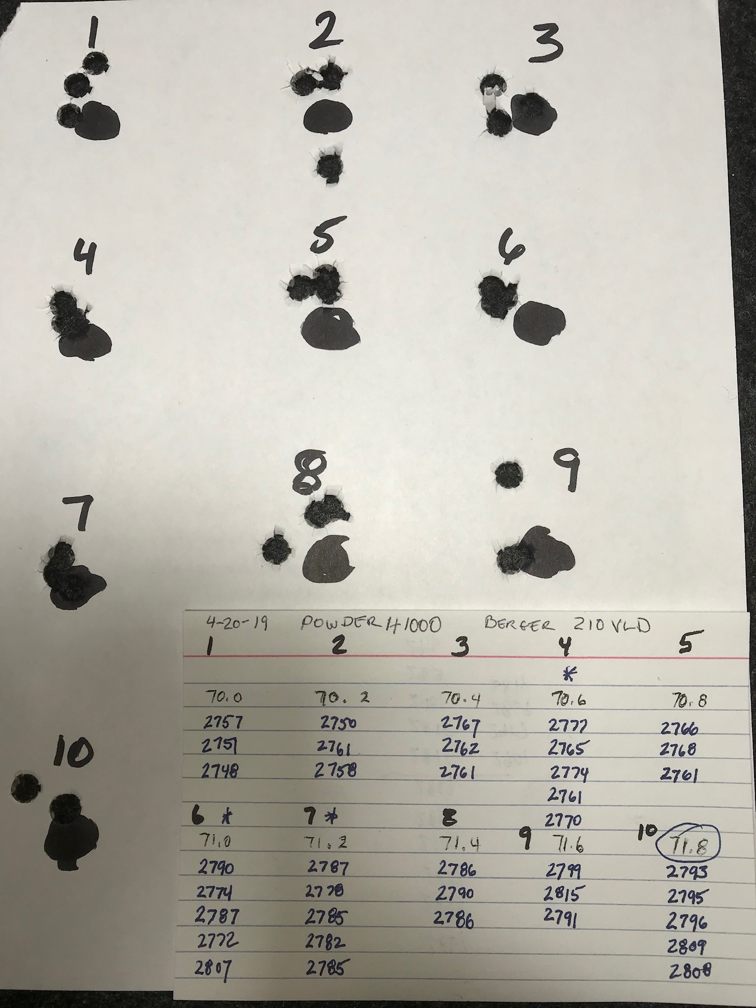

Took the 300 win mag out today and did a quick ladder loads with the berger 210 VLD’s.
The wind was from the left at 10 mph, here is my results from today.
I am not pushing them, hoping to get longer life out of my brass.
my other load today which I did not record was with retumbo and my speeds where 210’s going 3050 fps.
Lol with how many grains of retumbo?
