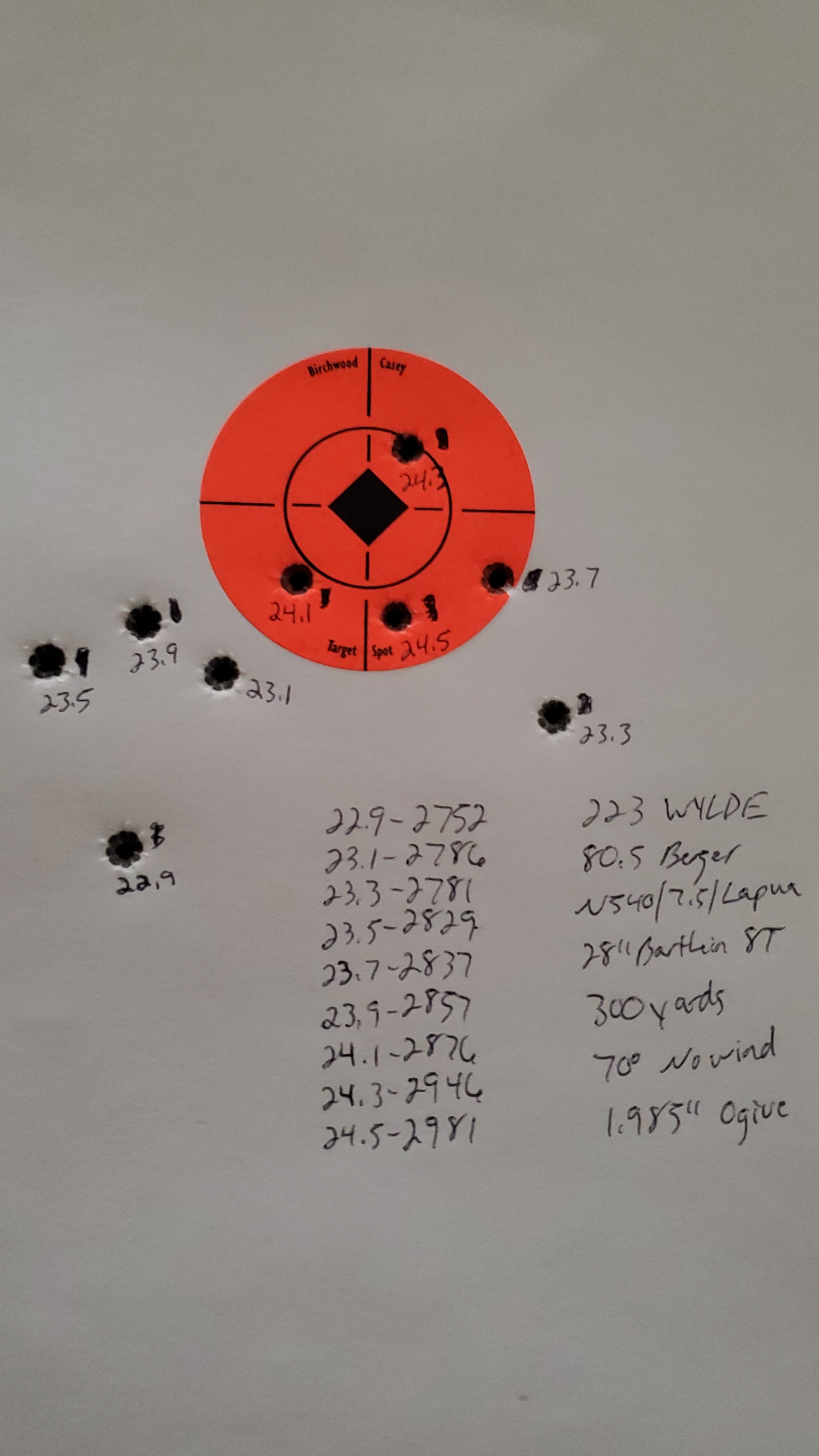

Took my R700 223 Wylde with Bartlein HV 28" 8T and .080" FB out this morning and did a quick 9 shot ladder at 300 yards. Get an idea of pressure/velocity and find the upper node.
80.5g Bergers, approx .020 off, COAL 2.485", N540, Rem 7.5 and 2x fired Lapua brass. Shoulders bumped .002" and neck tension also .002"
It left me with more questions than answers, and didn't really show anything definitive in my opinion. The overall group wasn't bad, about 1 MOA for all 9 shots, but no real correlation to velocity/impacts either. Also, the jump in velocity of 70fps from 24.1 (2876) to 24.3 (2946) had me thinking I was around max, but there were no obvious signs of pressure anywhere. The jump from 24.3 to 24.5 was pretty normal again at 35fps. Not sure if I should creep up in .1g increments to find max with the velocity I'm already at, but I have a feeling there might be a node at that 24.5 (2980) area.
I also had something super odd happen and I can't explain it or figure it out. While trying to get my seating depths figured out, I had 3 extra rounds all loaded at 23.5 Only difference was 1 was really short at 2.4" and the other 2 were pretty dang close to where they were suppose to be at around 2.480". I figured I'd use the shortest one for a cold bore and see where it impacted at 300 and get a good zero to go off. Velocity read 2811fps. Ok no problems there. So I shoot the 9 shot ladder and the 23.5 charge showed 2829fps. OK still doing fine. Finished up the ladder and still had those extra 2 cartridges loaded at I decided to use them up on the 500 yard gong and get some more numbers from the garmin. I was shocked when the 1st read 3063fps. No hard bolt lift, cases look fine, primer looked fine, so I shot the last one and it was 3053fps. Again, no obvious signs of pressure. But my main concern and question here is how on earth was there a 225fps discrepancy in velocity with those 2 shots at 23.5 from the previous 2 at 23.5? I individually weighed each charge on a balance beam and I'm certain the Garmin is ok.
I was shooting for 2950fps with no pressure, as that seems about right for an 80g bullet and 28" barrel. I'm thinking 3050fps is definitely over pressure, even though I'm not seeing the tall tale signs. And I'm not even totally sure what to think of those 2 rounds that hit 3050fps at that low charge weight anyway.
Anyway I'd love to hear your guys thoughts and where you would go from here? Still better than a good day at work, but still a little frustrated also...

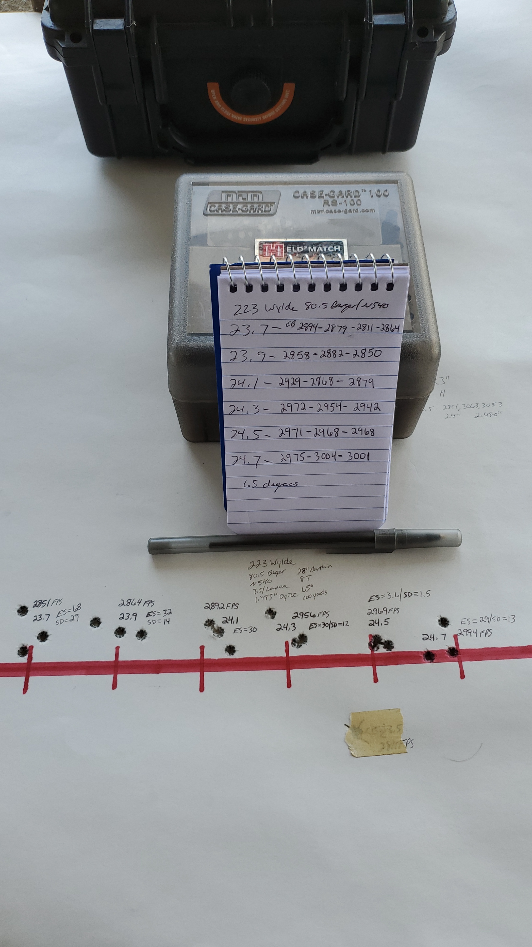

That's true. I think I'll load 3 each from 23.8-24.8 in .2g increments and shoot them on a horizontal line at 100 yards and go from there.
Don't want to go lower than 2850 as this is a 1K trainer rifle. Tough to beat the 75 ELDMs at 3000, but figured I'd give the 80.5 Bergers a shot. I would expect them to shoot better and be less fussy.

.223 is probably one of the more difficult cartridges to get tight ES/SD on (which still seems to defy logic). With a sample size of (1) and no idea what your ES/SD are going to be... it is going to be really difficult to accurately explain your velocity phenomenon for the first nine shots.
People are going to argue the merits of the ladder tests for the rest of time. If I were forced to do one - for any reason other than to find pressure limits - I'd probably do it at 600 yards, where the environmental factors really begin to come into play... and you'll really start to see the effects of velocity spreads in your vertical on target.
At this point, I'd probably suggest just picking a velocity that you're comfortable with (no pressure), and messing with seating depth until the accuracy occurs that you're after.
The vertical component of the middle seven steps is normal, but that horizontal for 300 yards is a problem.
Your test distance was way too close for this style of test yet the horizontal spread is not lining up with the vertical performance.
For example, if we assume a perfect trajectory the vertical difference from a shot at your slowest speed of 2752 to your fastest at 2981, would only be a difference of 2.66" at 300 yards.
Your results match that pretty well, but the point is that if we shot that test at 600 yards, the spread would be 16.27" and much easier to see if there was any evidence of positive compensation worth investigating.
At this point, we would say that anything in the middle of that ladder test is acceptable based on the vertical. The real question is what went wrong with the horizontal?
It all points at needing to answer the questions with more shots but if you were the cause of the horizontal then you have to do better.
It has been said, but I will still say it again.... when you shoot an Audette Ladder test, it has to be far enough away to allow the shot-fall to spread out vertically such that you could detect any evidence of positive compensation. If you cannot shoot enough distance, then one of the other test methods would be better. Good Luck and in for the range resports.

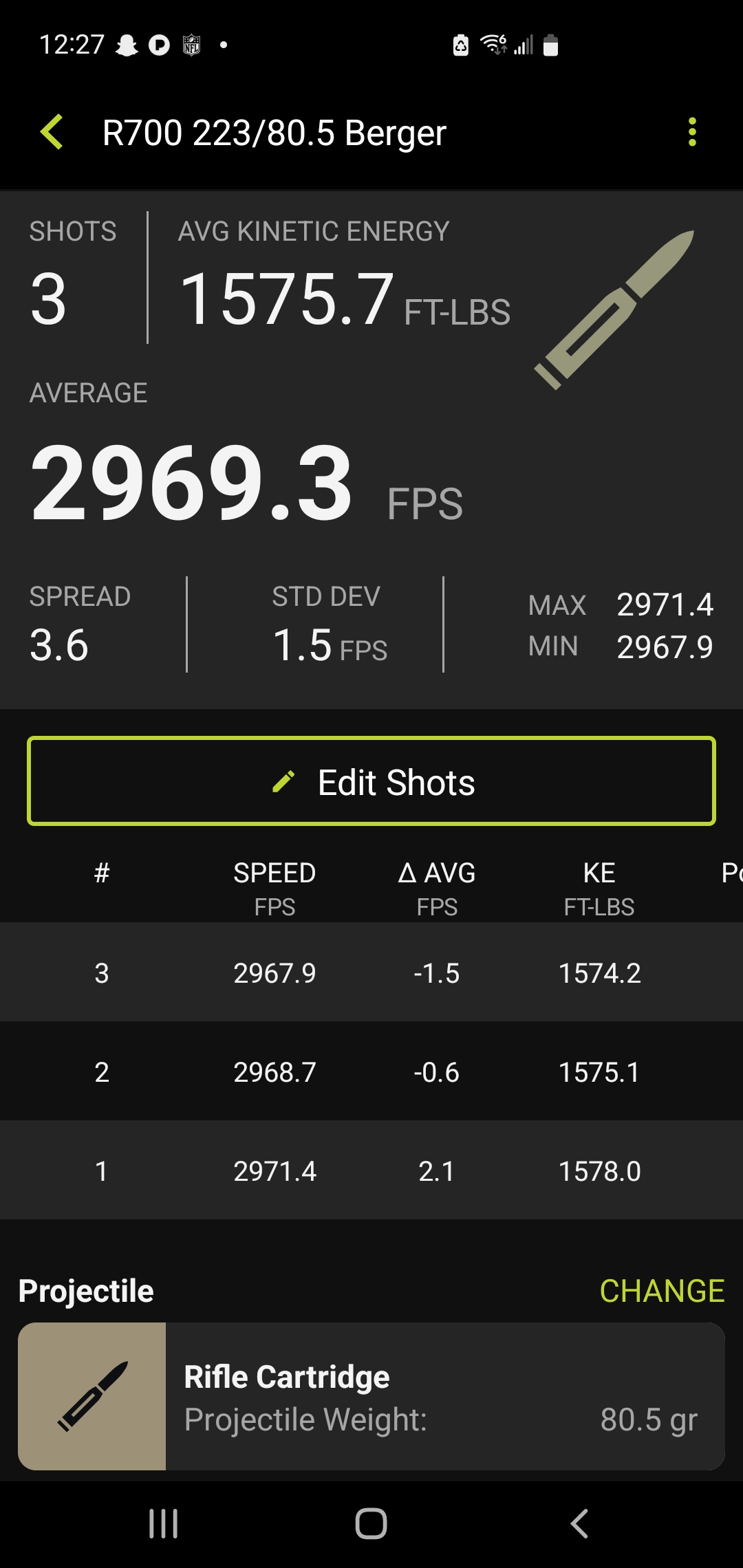

Was able to hit the range this morning and shoot a few 3 shot groups from 23.7-24.7 in .2g increments. 24.5g is looking very promising. Guess I'll load up another 20 rounds at 24.5g, and see what a 10 shot group looks like at 100 and 300, and also get a little more crono data. If it keeps that up, I'll be quite pleased.

Man, I hope it holds together for you in further testing. The velocity looks great initially too on the same group that produced the best accuracy.
From my (unfortunate) experience, the small windows of great accuracy in the middle of "meh" with smaller samples, have a tendency to either not replicate too well - or even worse - randomly disappear when you least want them to. That isn't gospel though, and I hope that it doesn't happen to you.

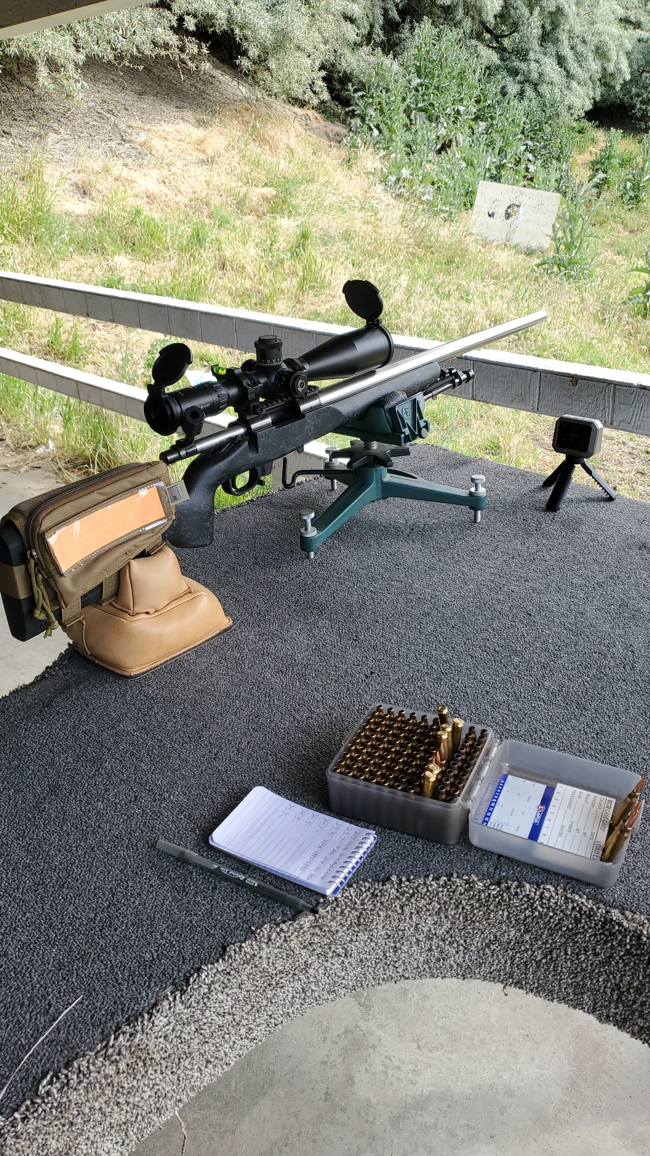

Still playing with XBR and 80.5's to see if I can find a load and seating depth that works well.

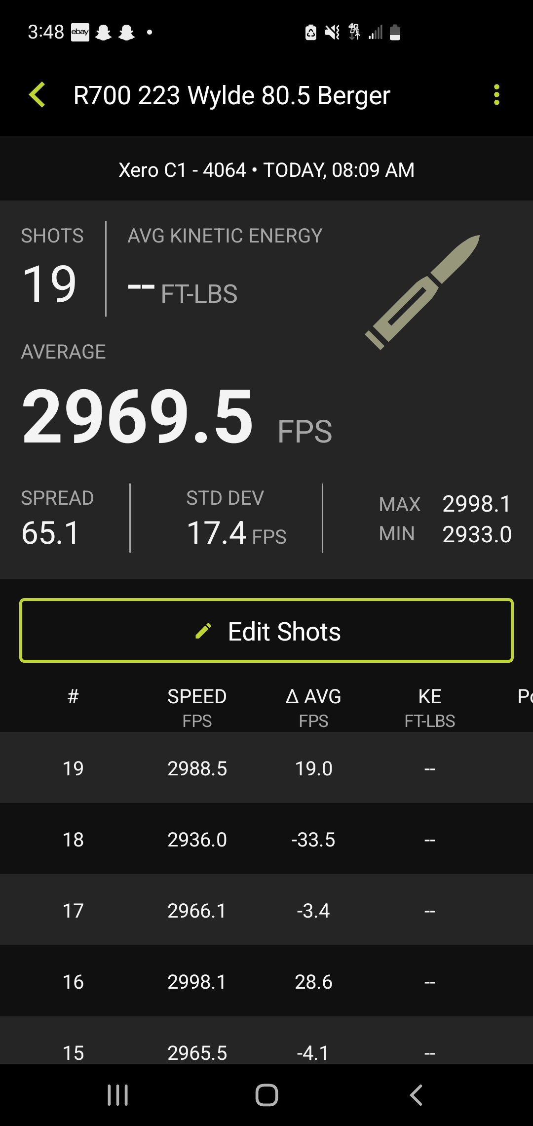

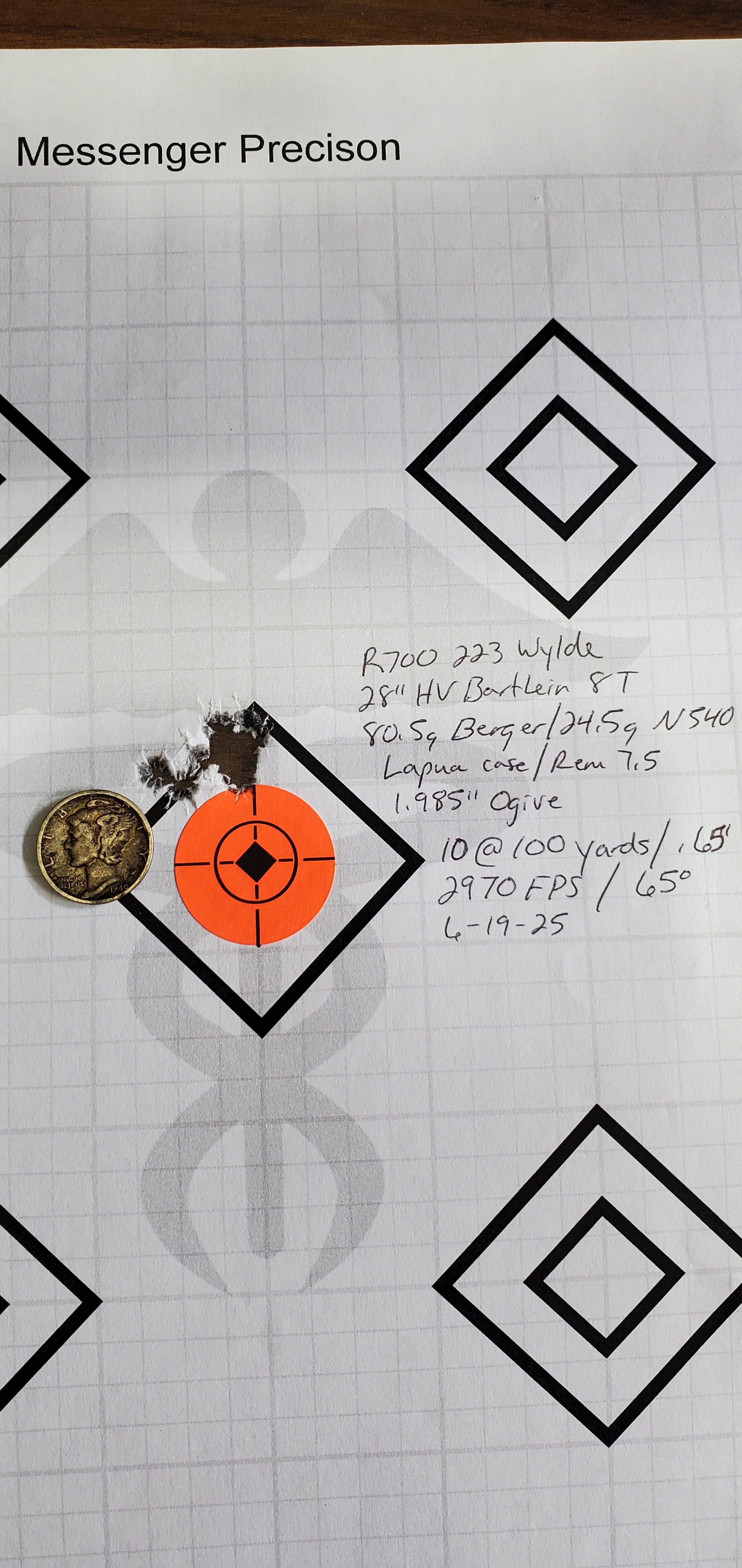

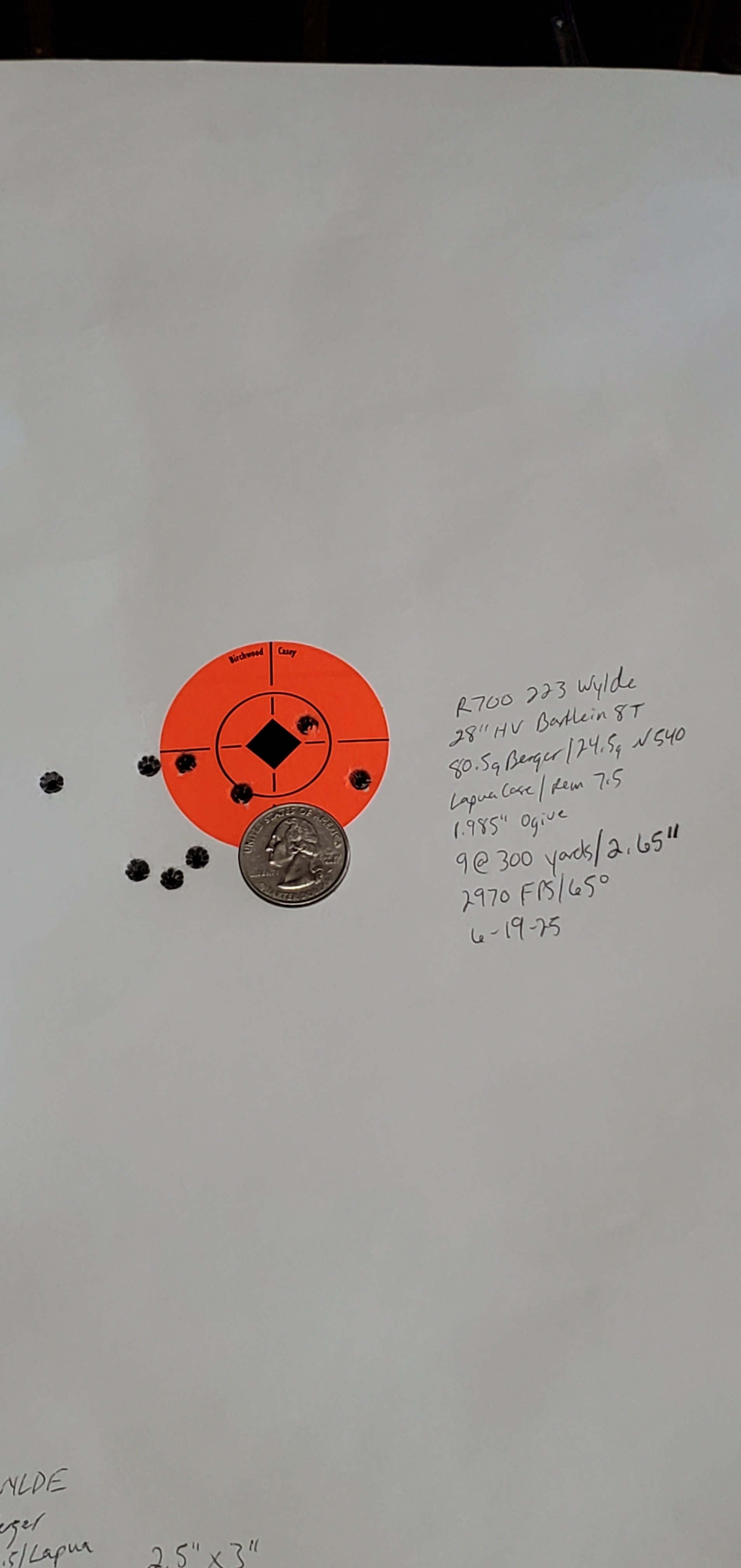

Made it to the range this morning with the R700 223 Wylde. Loaded up 19 more rounds with the 80.5 Berger/24.5g N540 and did a 10 shot group at 100 and a 9 shot group at 300. By the time I got to 300, the last 4 or 5 shots the wind had picked up a bit and so did the mirage. The far left shot and the 2 far shots to the right were definitely from the wind. I have not yet ran a seating depth test on these bullets, just powder charge. Started at about 20 off and went with it. Could probably do a little better with a seating depth test and less wind/mirage. The ES/SD again isn't great, gotta love the 223 for that right?! Individually weighed to the kernel on the RCBS balance beam. I'm liking the velocity N540 is producing from the 28" Bartlein. I now have 2 decent loads from this rifle with N540, the 75g ELDM at 3000 and 80.5g Berger at 2970. 5 shot groups are typically 3/8-1/2 MOA from 100-500 yards. Now comes the real fun in shooting steel from 500-1200 and getting some good dope. Comment's or criticism is always welcome!
