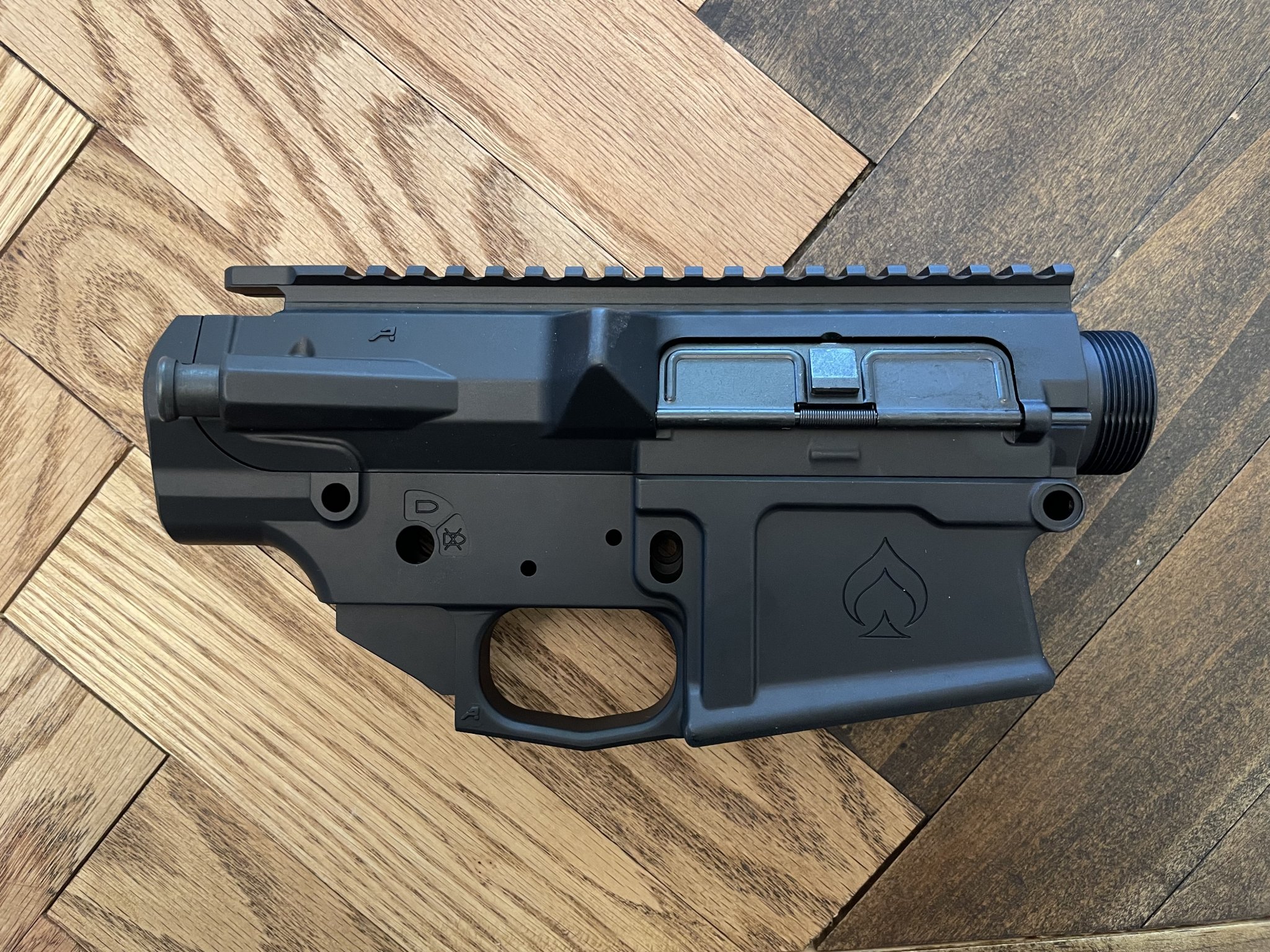

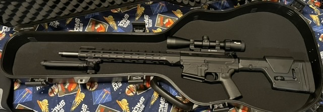

First AR10 build. Aero upper/lower/hand guard. BA 20” 1:10 .308. USO TS 5-25x50 in a GG&G QD mount. Geissele two stage trigger. Shoots .75 MOA with my 168gr BTHP hand loads.

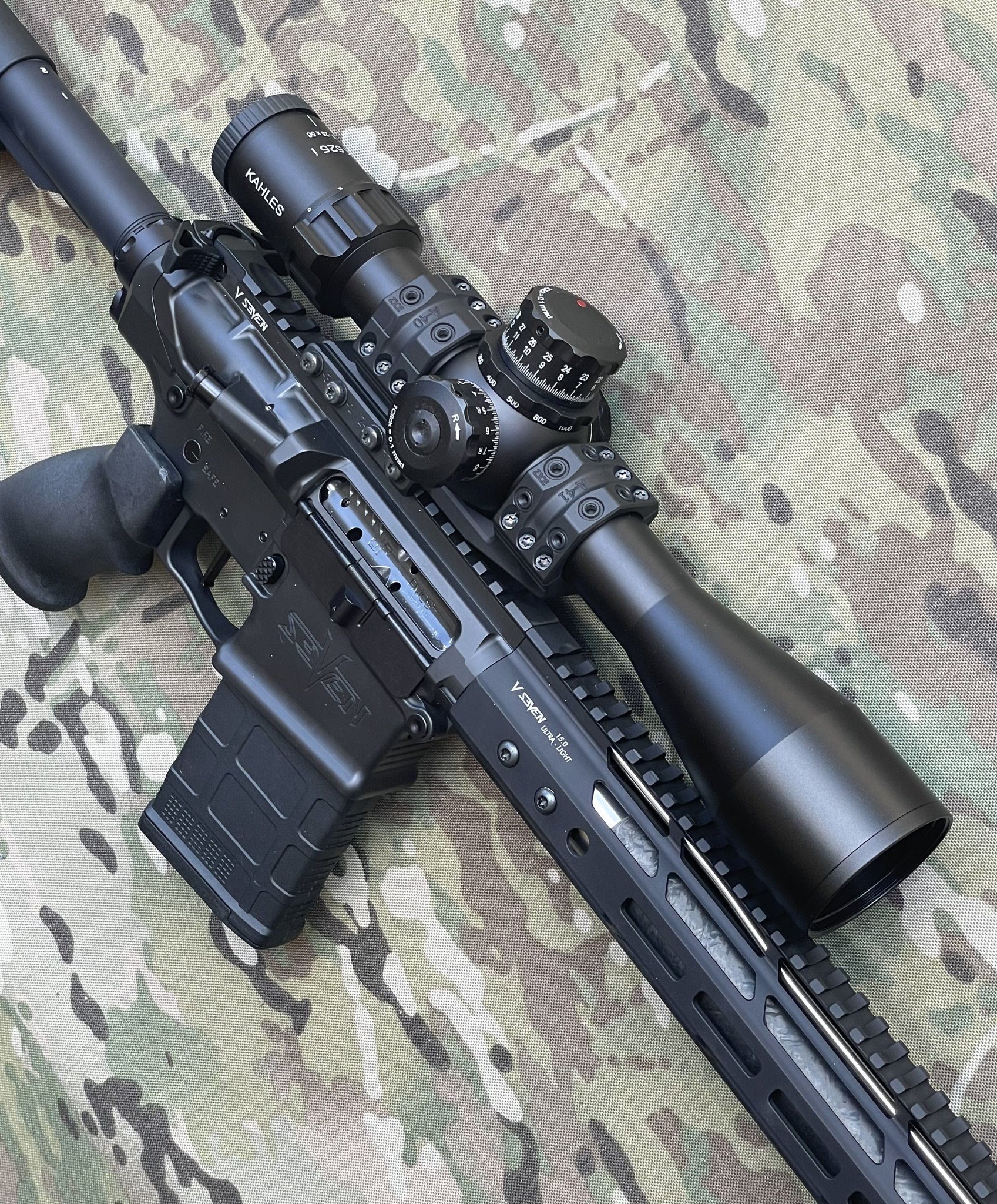

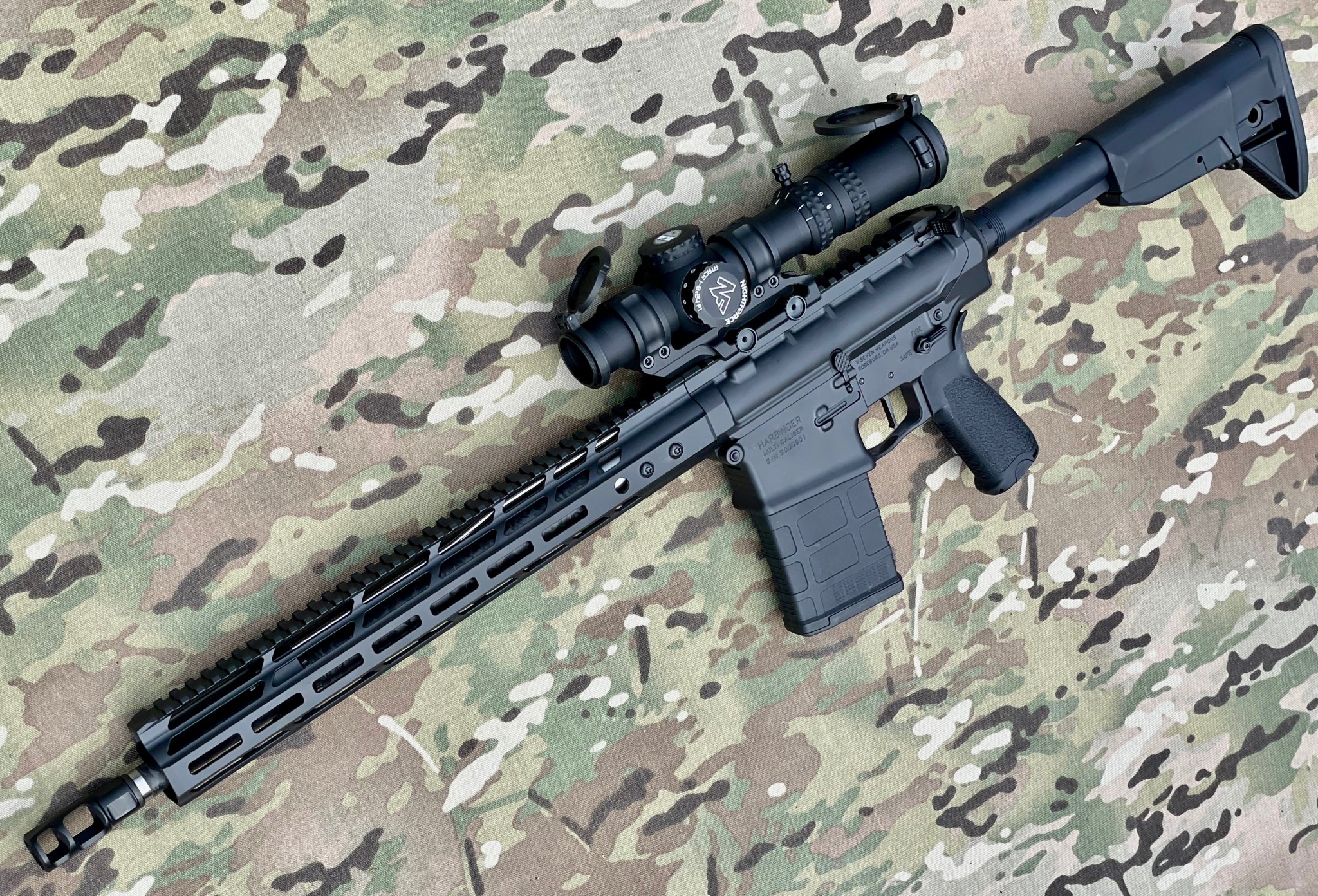

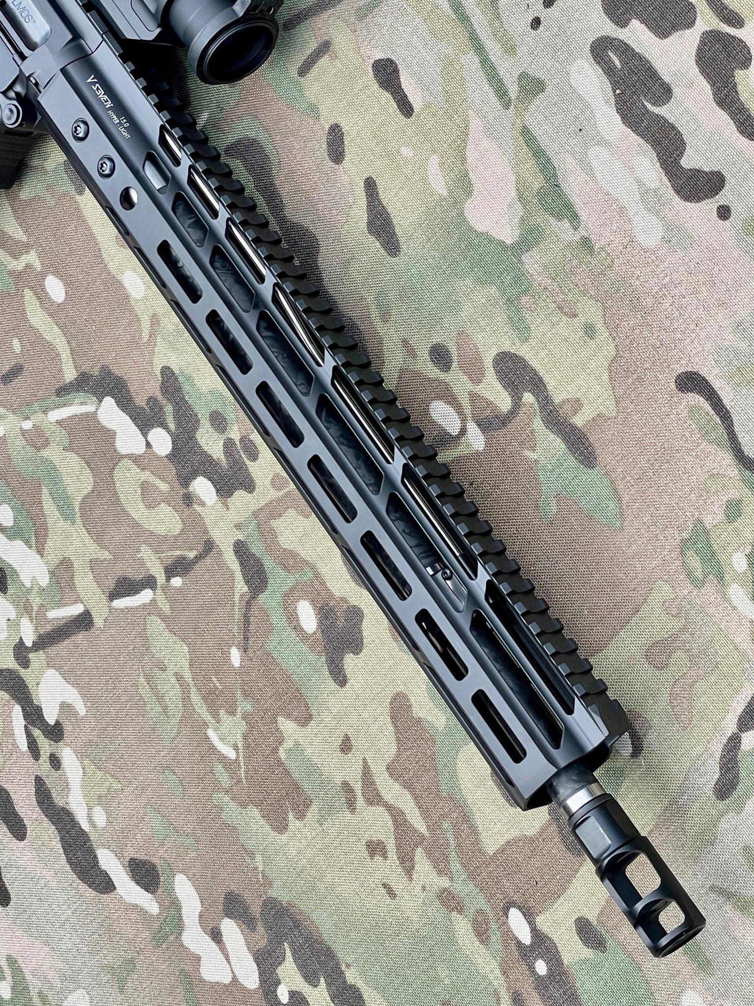

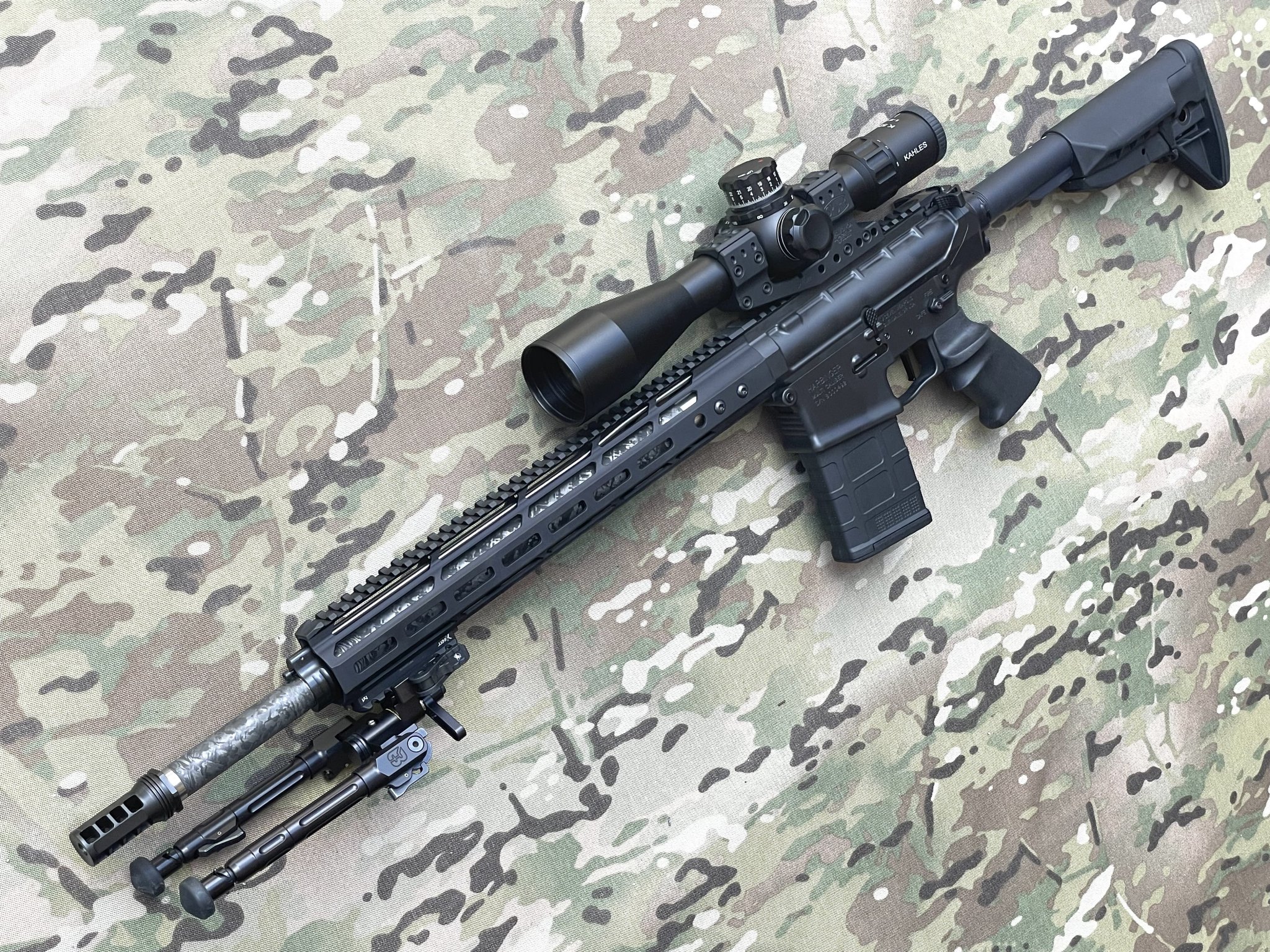

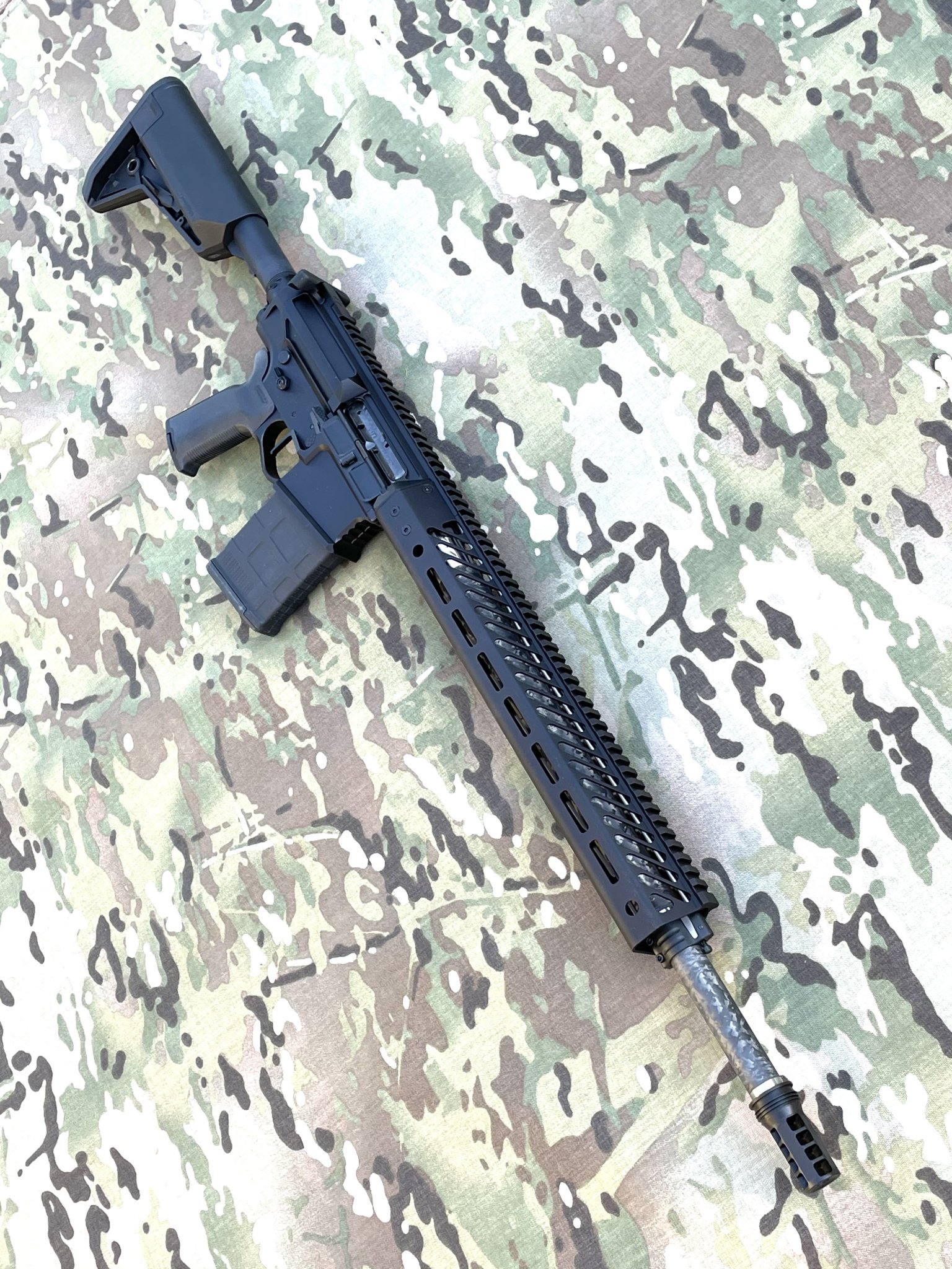

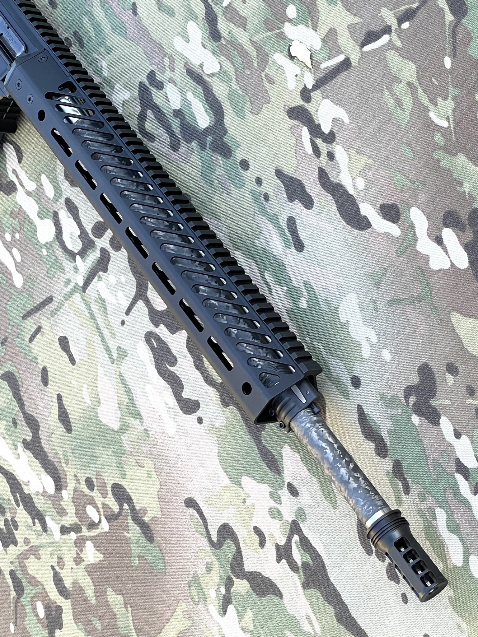

8.5 LB 6.5 Creedmoor with 20" Proof carbon fiber barrel. V7 billet receiver set and 15" rail. JP Full Mass BCG - Needed for this high pressure cartridge! SLR adjustable gas block - Just dial in your optimum gas setting. OSS muzzle brake for customer's excellent OSS 762 HX-QD TI suppressor. Trigger Tech Adaptable trigger set at 2.5 LB. Geissele SCH charging handle. All the small parts are from V7. Kahles K525i with stunning clarity up top in a Spuhr mount. Now, I want one just like it.

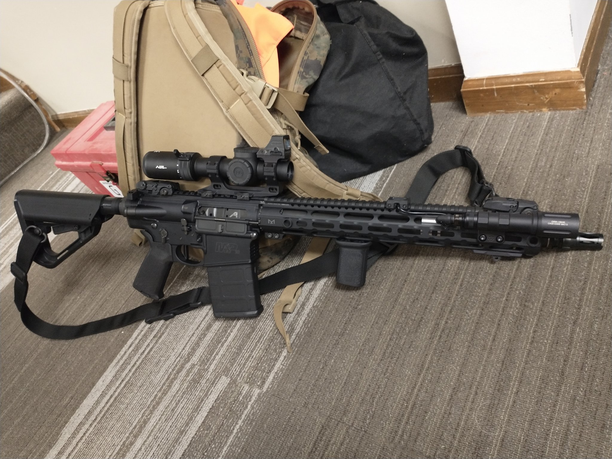

Think this one is finally done. Haven't shot it yet in this configuration but I'm really excited about it.
-S&W M&P 10 receiver set. (Ambi)
-MW Industries 15" rail
-MBT2S flat shoe
-Criterion 16" mid length with Wojtek AGB
-New PA PLXc 1-8x24 in 1.54" Reptilia mount with HE508T in the ROF90 mount
-FCD 6310KM that'll be able to mount my Hybrid 46 to when it's out of jail.
-Modlite with Modbutton Lite.

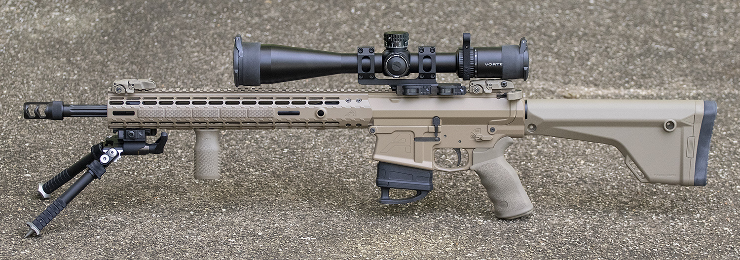

Standard M5 Aero enhanced, Rainier UM, usual suspects.
Was waiting for scope mount when this pis was taken...Warne in FDE been on the rifle for a while now.
Also has different trigger, a GG&G bipod, some other stuff.
Eh, it runs, it shoots.
What's more to say ?

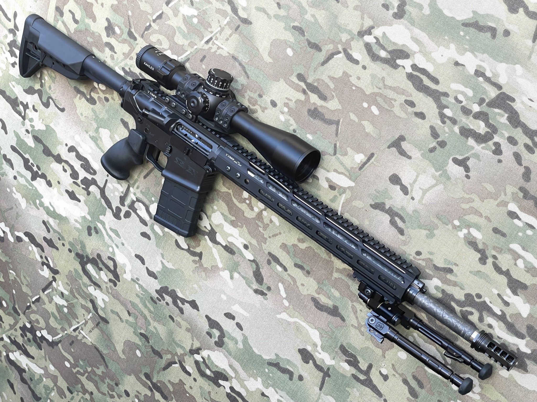

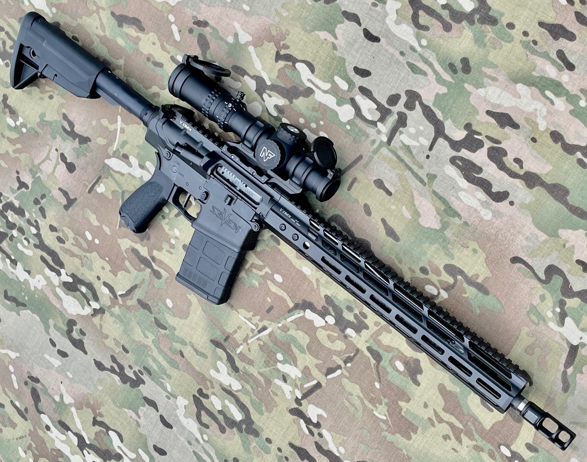

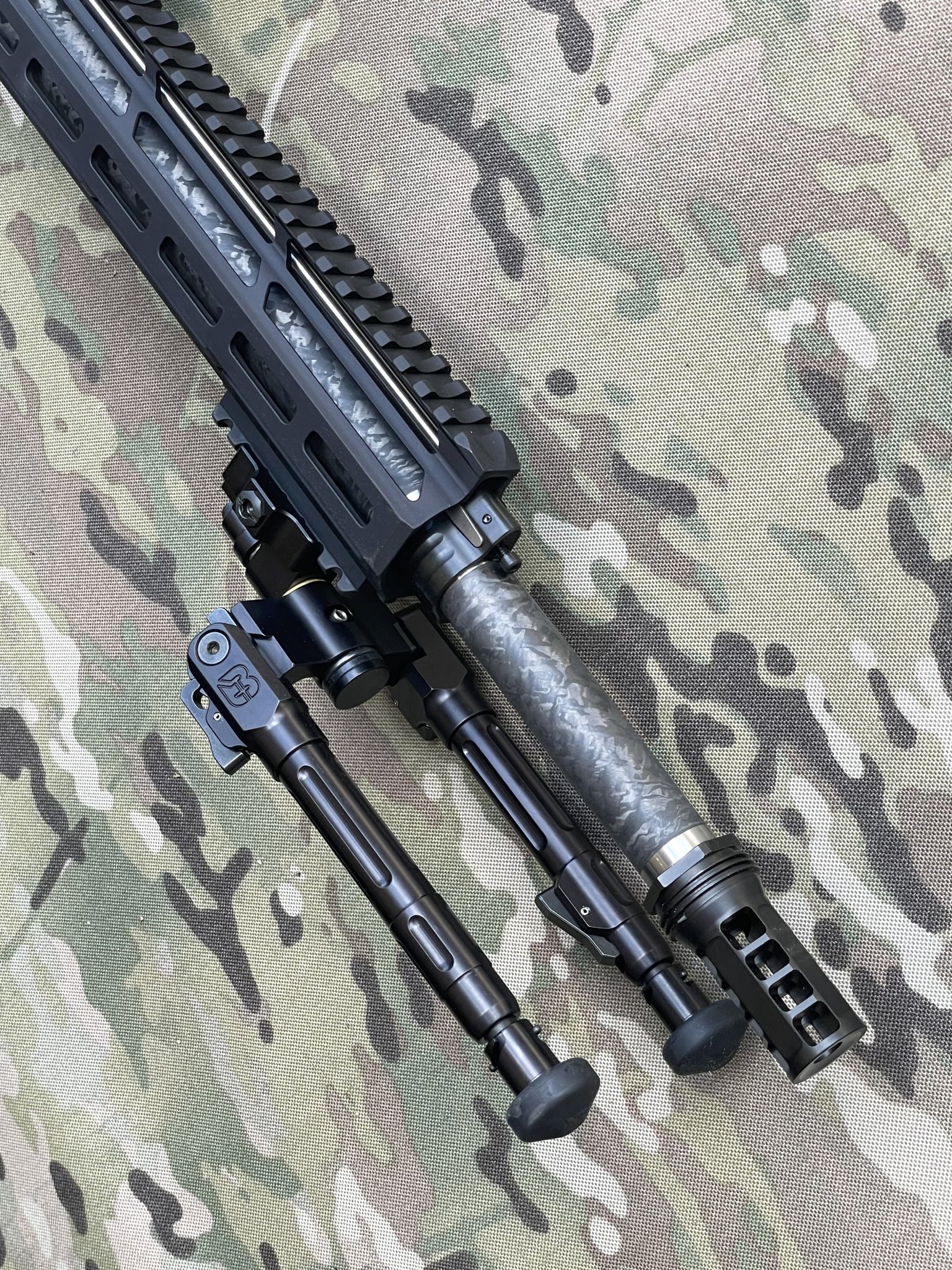

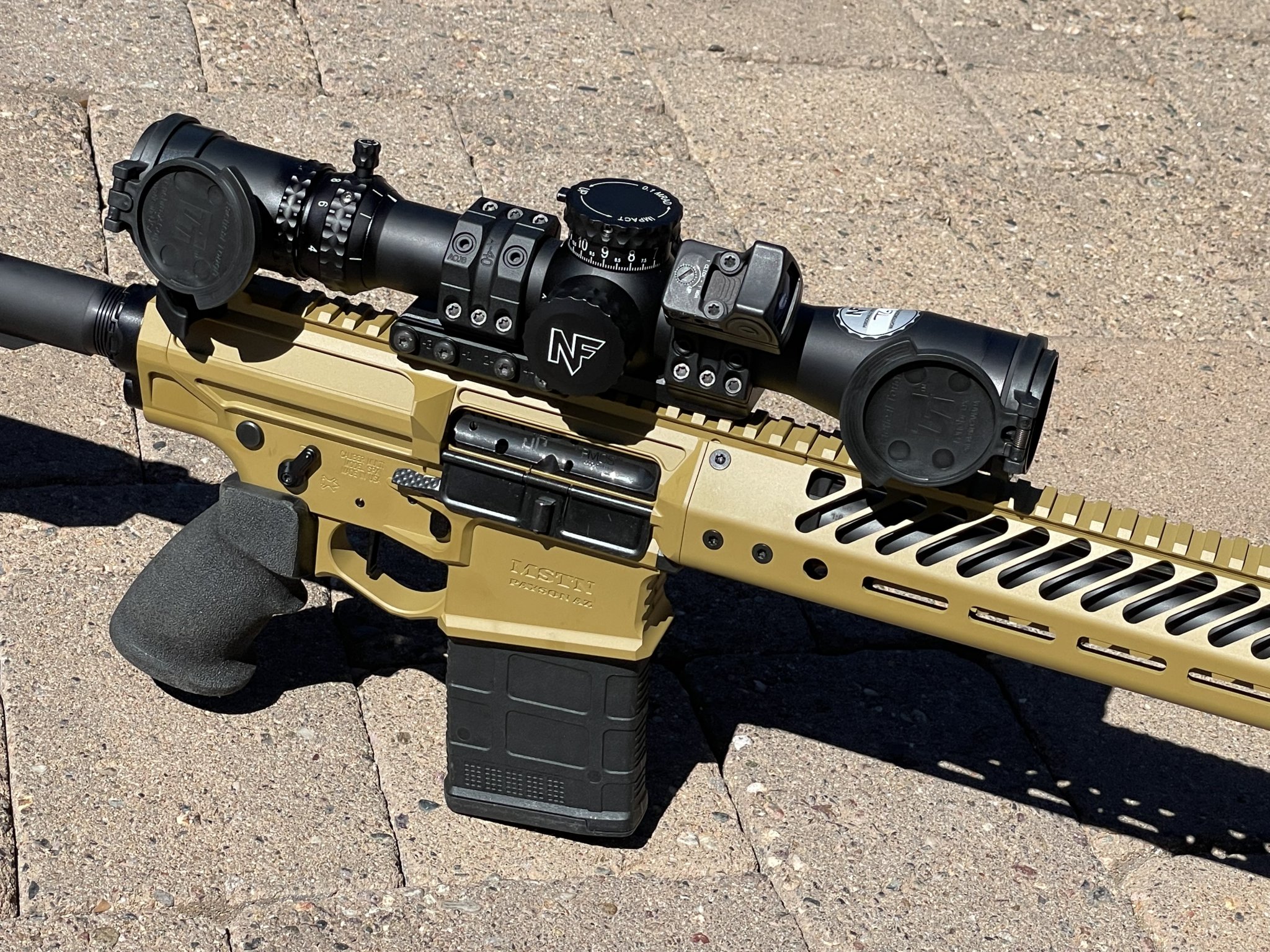

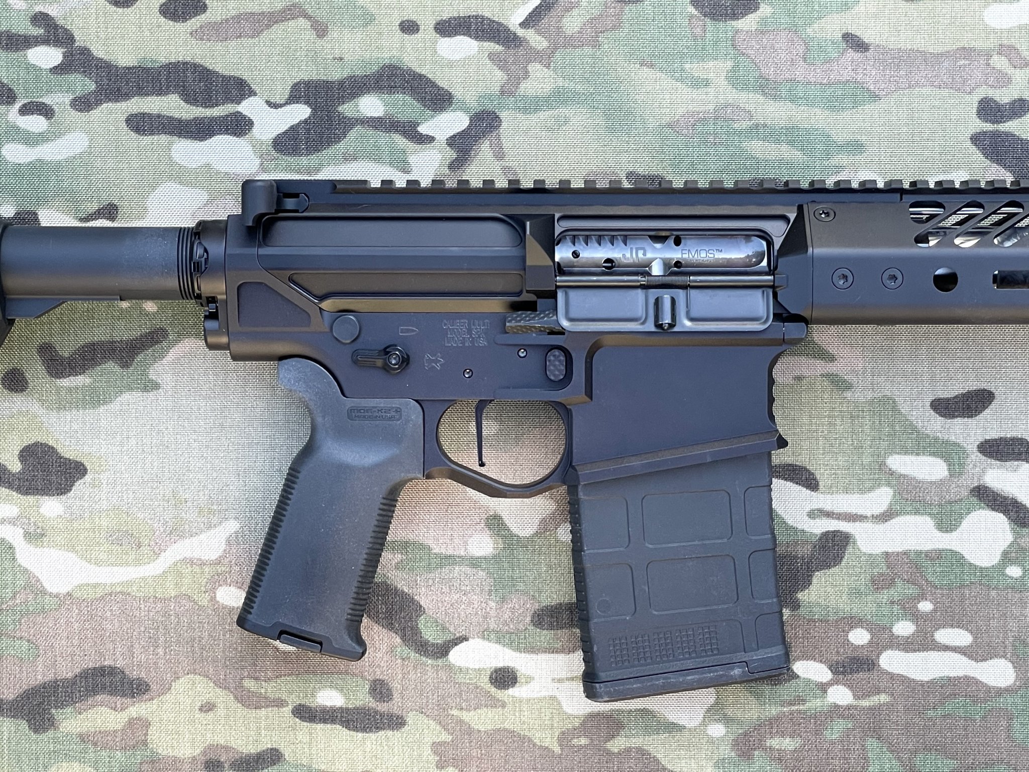

Another big block 6.5 Creedmoor built on a Seekins SP10 Builder's Kit. This one has a 20" Proof Research carbon fiber wrapped barrel with rifle +2 gas system, JP Full Mass Bolt Carrier Group, TriggerTech Adaptable trigger dialed down to 2.5 LB, SLR adjustable gas block, etc. It's set up with an OSS 7.62 brake for future inclusion of an OSS HX-QD 762 TI suppressor. Check out the incredible Tangent Theta 5-25x56 in Spuhr mount that ended up on top of it.
View attachment 7659336View attachment 7659337View attachment 7659338View attachment 7659339View attachment 7659340
@MSTN how does the SP10 compare to the ZEV large frame uppers/lowers?
The ZEV upper/lower/forend kit is of conventional design. Great quality stuff and very racy looking.
The Seekins SP10 Builder's Kit - also of top quality construction - is a significant departure from the conventional. While heavier, the upper-to-barrel junction puts that extra mass to extremely good use. The wide, flat bottomed forend design is also quite handy when shooting off a variety of surfaces.
I'm not going to make accuracy claims for the SP10 that provide a target for naysayers. I will state that when I build my next precision big block gas gun, I'll most definitely be using an SP10 Builders Kit as the foundation. And I have to pay full boat retail to get them.

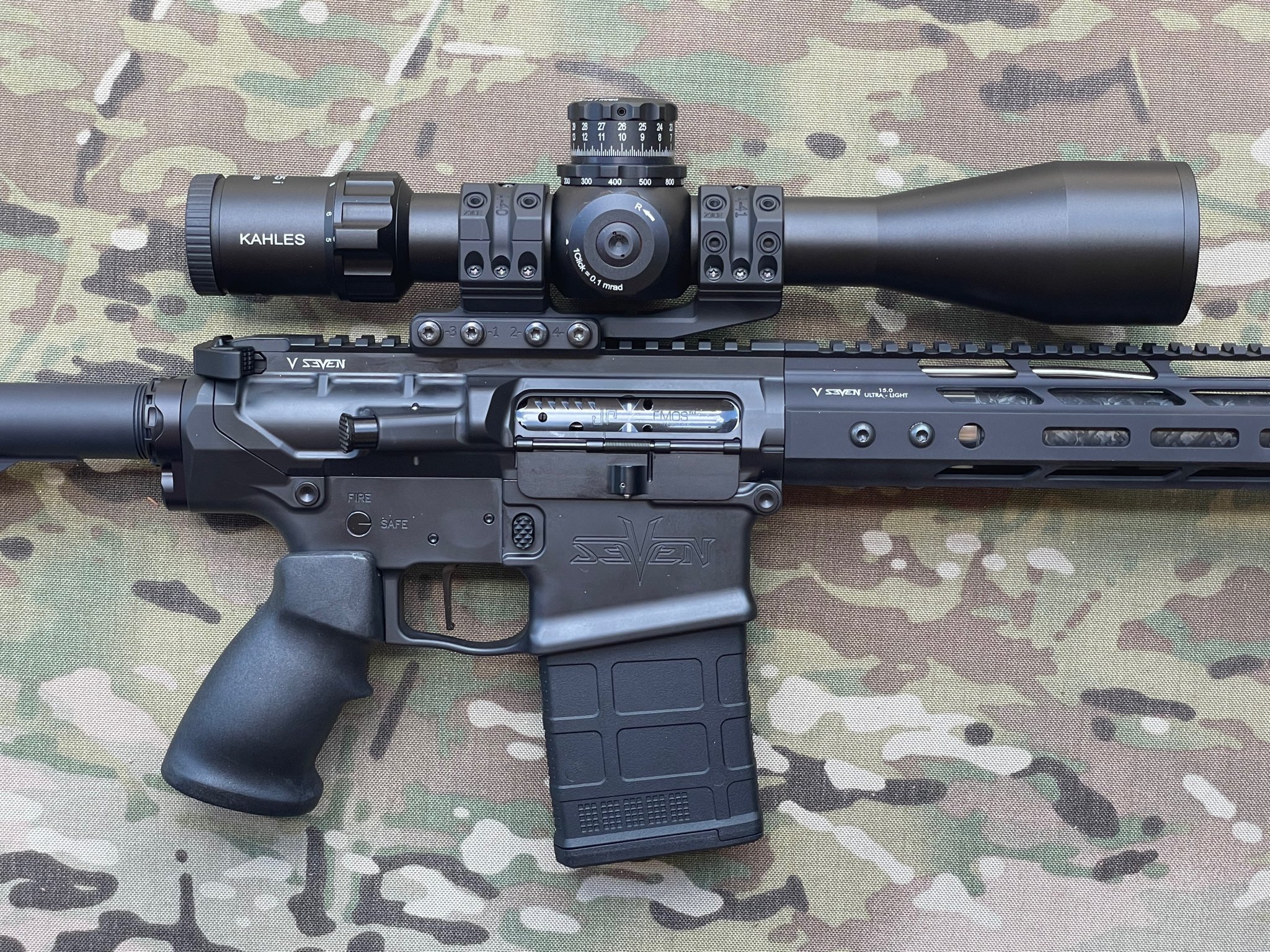

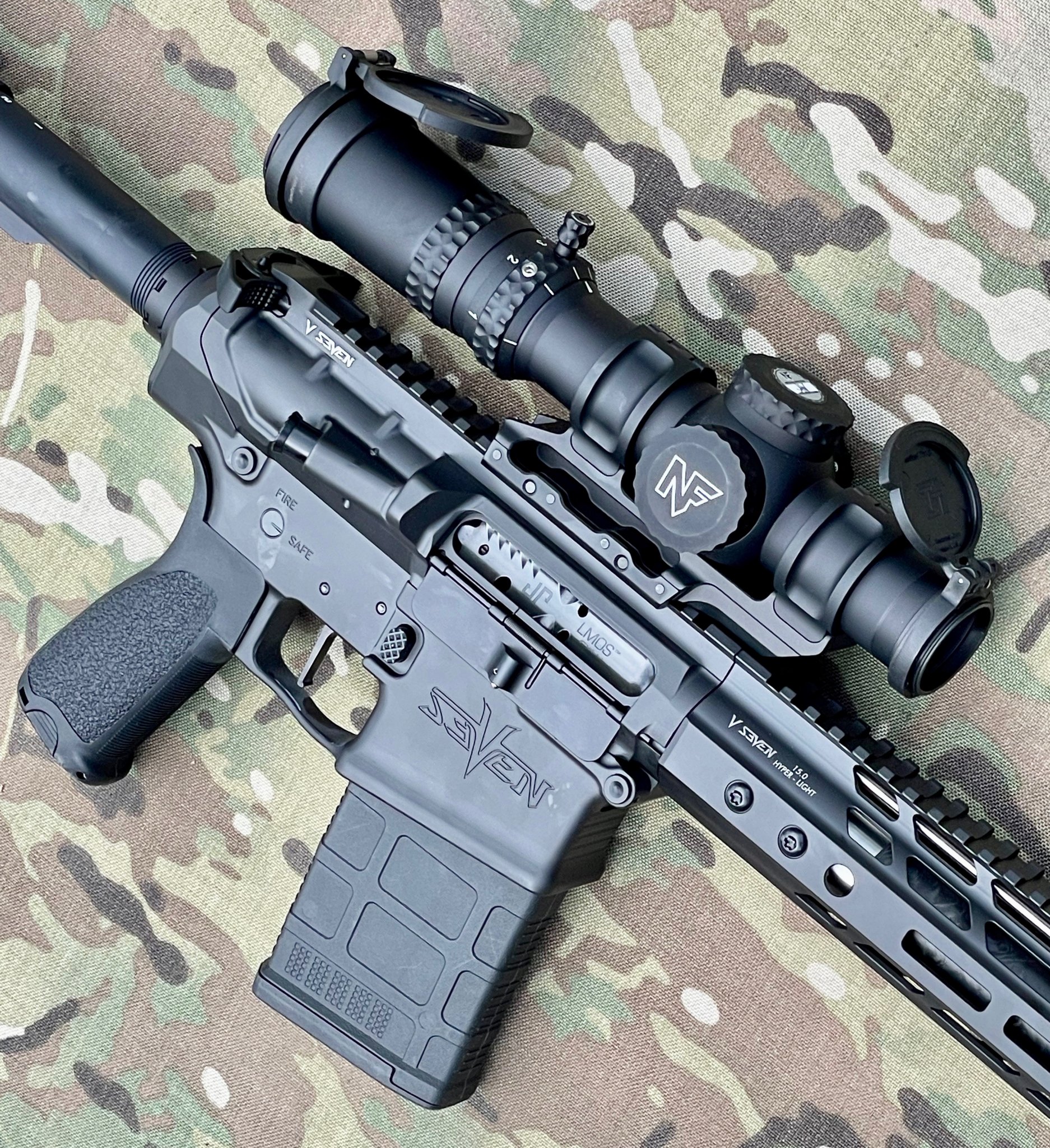

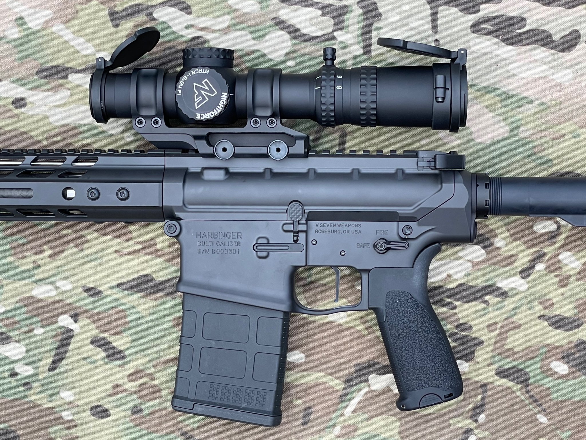

The easy way to build a lightweight yet highly accurate .308 gas gun: Start with the V Seven Harbinger 7075 T6 big block billet receiver set and HyperLight Magnesium 15" forend. Add a Proof carbon fiber 16" .308 barrel with the correct intermediate length gas system and 1x10" twist. Contour and polish the feed ramps. Check out the perfect headspace that always results with a JP Enhanced High Pressure bolt that rides in a JP Low Mass Operating System (LMOS) bolt carrier. The SLR adjustable gas block is another key component in the overall equation. V Seven lightweight components include the titanium Furion muzzle brake, safety selector, push pins, fire control pins, receiver end plate and castle nut, grip screw, and buffer stop. Aluminum parts from V Seven are the diamond pattern forward assist and ejection port door and pivot rod. Lastly, there is the S7 tool steel bolt stop from V Seven. I'm a fan of the TriggerTech Competition trigger that breaks at an amazingly crisp 3.5 LB. There's a Geissele Super Charging Handle inside the upper receiver. An H2 buffer rides on a Heavy Buffer .308 carbine recoil spring inside of a Vltor lower receiver extension. BCM furniture and a Magpul Pmag round out the 6 LB 14 OZ weapon. You would not believe how the combination of the right components and a bit of simple tuning can produce a .308 that exhibits so little recoil and sub-MOA accuracy. On top of the weapon, you'll notice the superb Nightforce ATACR 1-8x24 F1 mounted in a Scalarworks LEAP/07 mount.

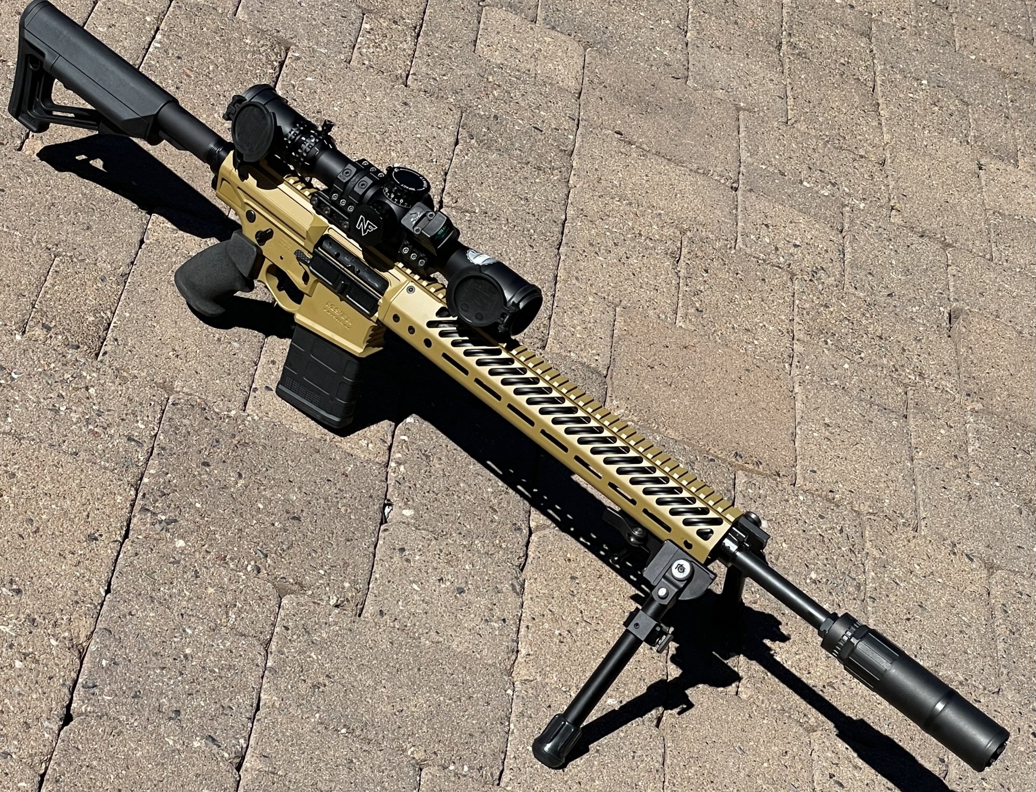

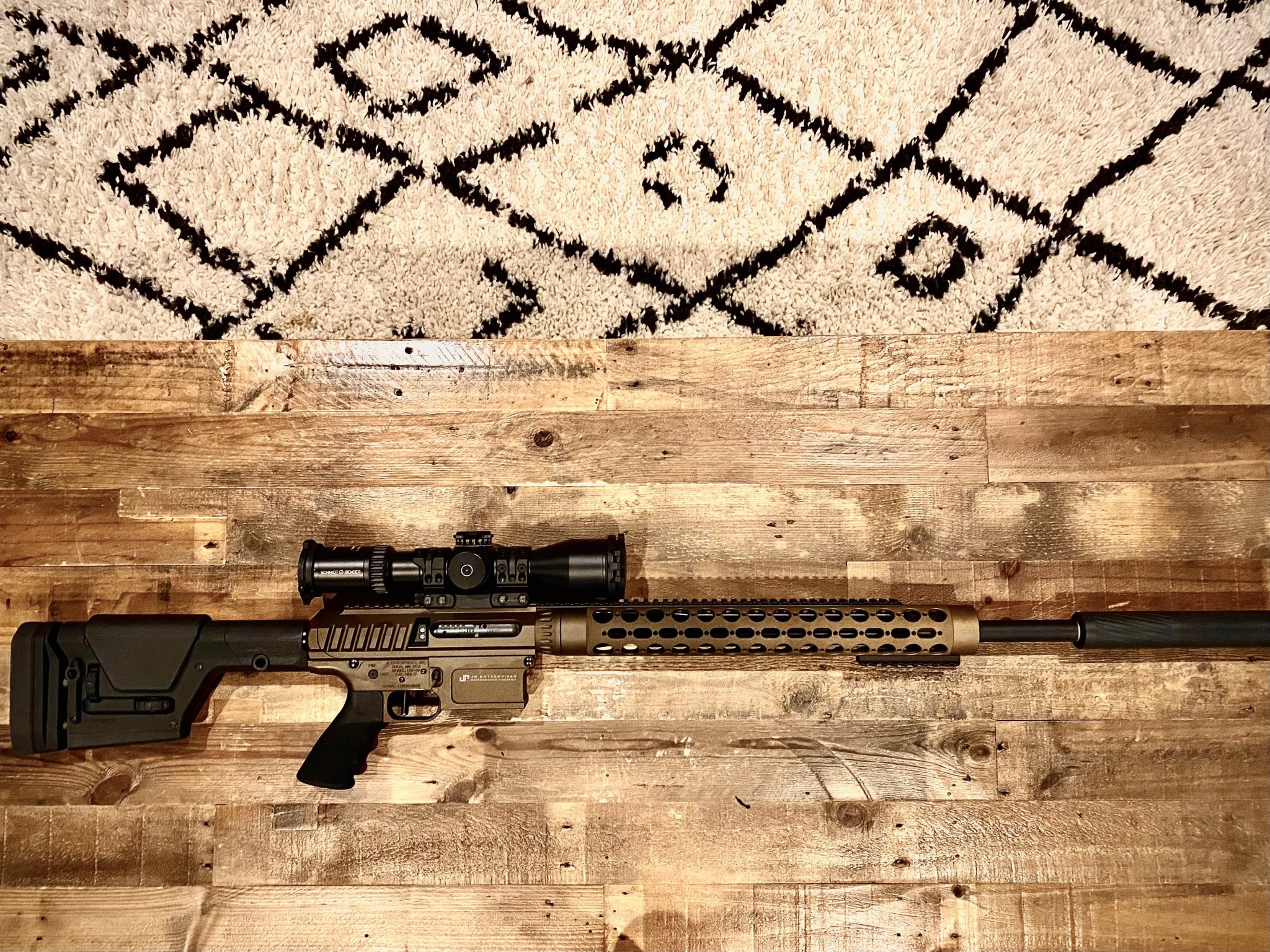

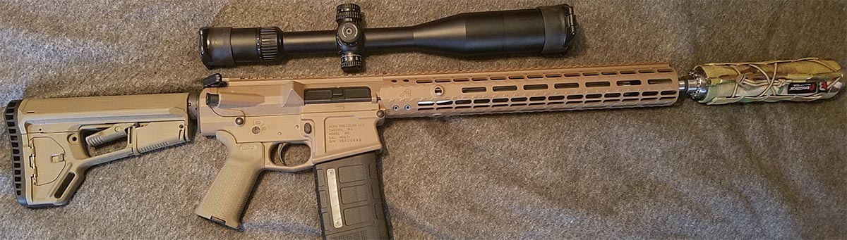

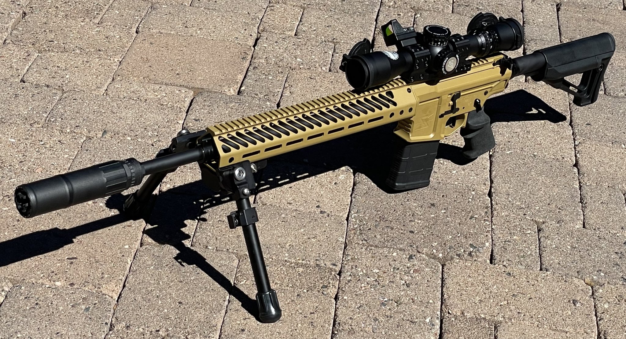

Slight update on my .308; new Dead Air Keymo muzzle, device and new to me Spuhr mount that I finally got around to getting Cerakoted:
Not to nit pick or anything, just something immediately obvious to me.
That scope is wayyyyyyyyy-yyyyy too far back bro.
Usually the eyepiece (is that ocular?) is about even with the charging handle.
Look at just about any other pic, should see what I mean.
Are you Lowlight height (short) or have shorter arms ?
Move that scope about 3-4 inches forward and it's gonna be a lot more comfortable.

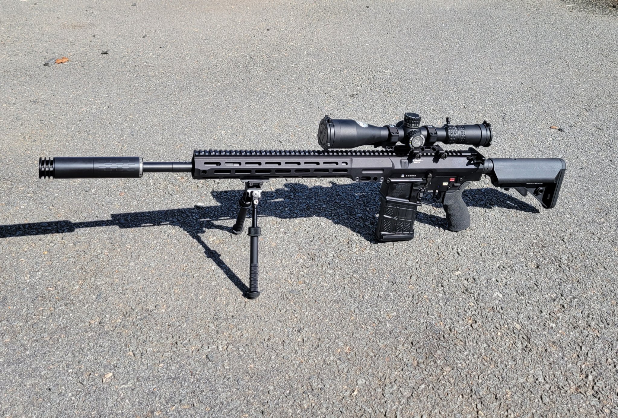

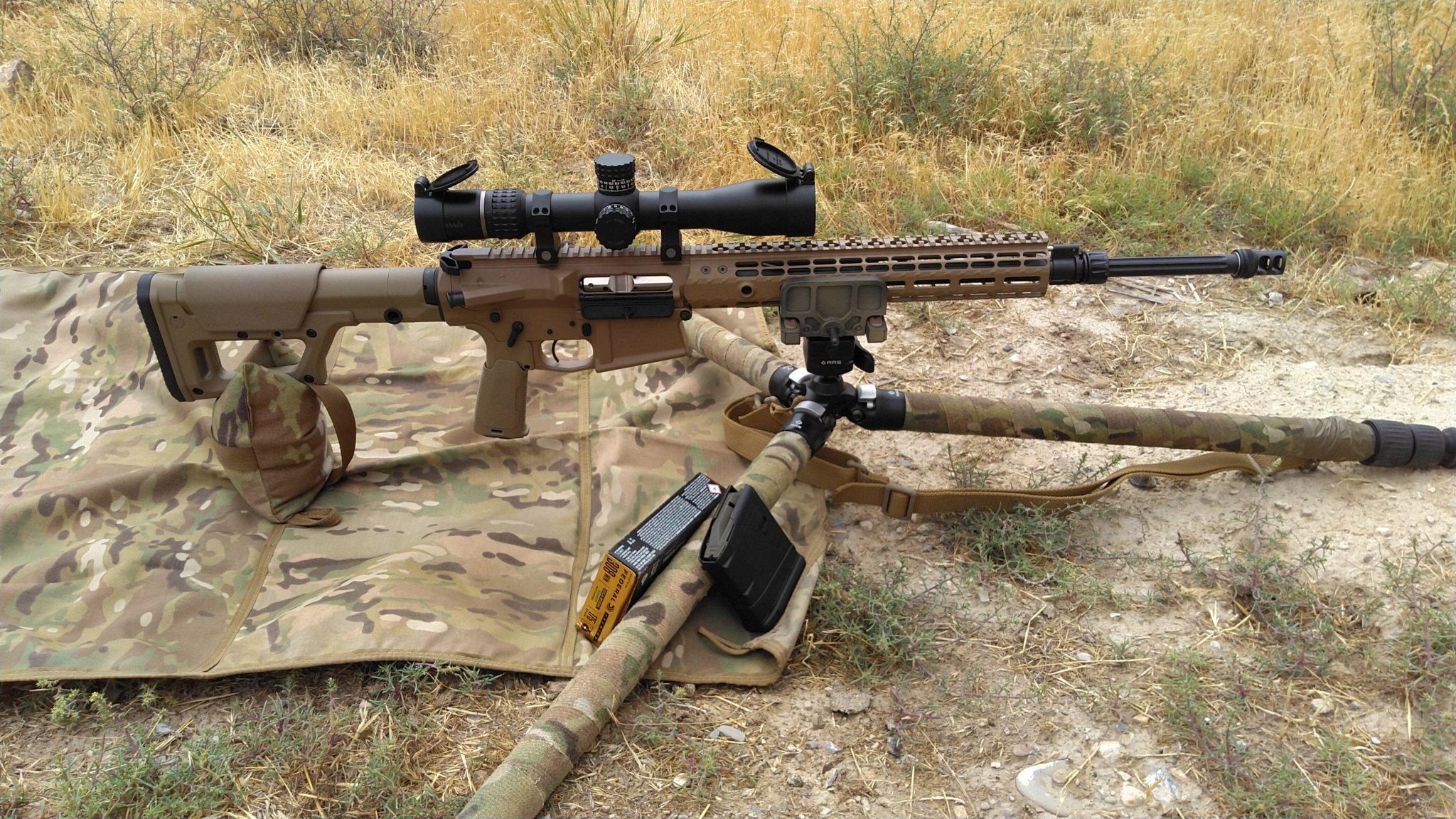

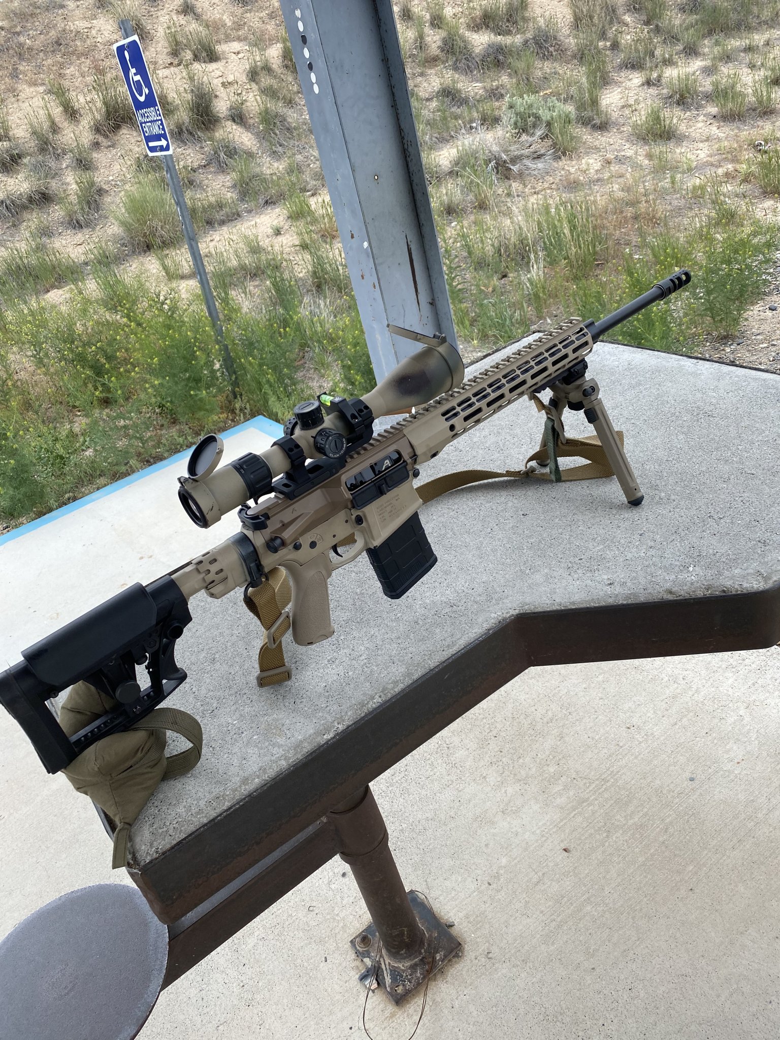

Helped a new shooter build and zero his first long range gun the other day. It's looking very promising. Shoots smooth and the brass is pristine.
Mostly aero parts
Faxon 1-10" 20" fluted match .308 barrel
Riflespeed finger adjustable gas block (which is awesome and I'd never seen before this)
Trigger tech trigger
Thunderbeast arms brake
Magpul prs lite
Nightforce 1.375" ultralite rings
Now he just needs to get his own scope and bipod 🤣
Fed it a box of fgmm 175 to zero and get the shooter sorted out.
This is the last three groups right to left 3 shots each with NO scope adjustment. We didn't settle on an official zero but
the last group measured a legit 1/2". He'll get some solid fundamentals learning on this gun!
Which can is that and how wells it run?
SiCo Omega 300, runs well but still a little too much gas, so I ordered a BRT EZ Tune gas tube to dial it down a bit. I have yet to shoot this without the suppressor, but with PMC XTAC Match168gr, I got less than 1 MOA at 200 yds. I'm hoping to get .5 out of it one day (when I'm a better shooter)

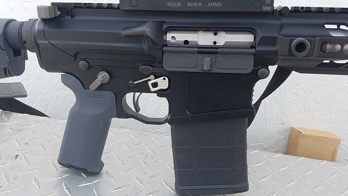

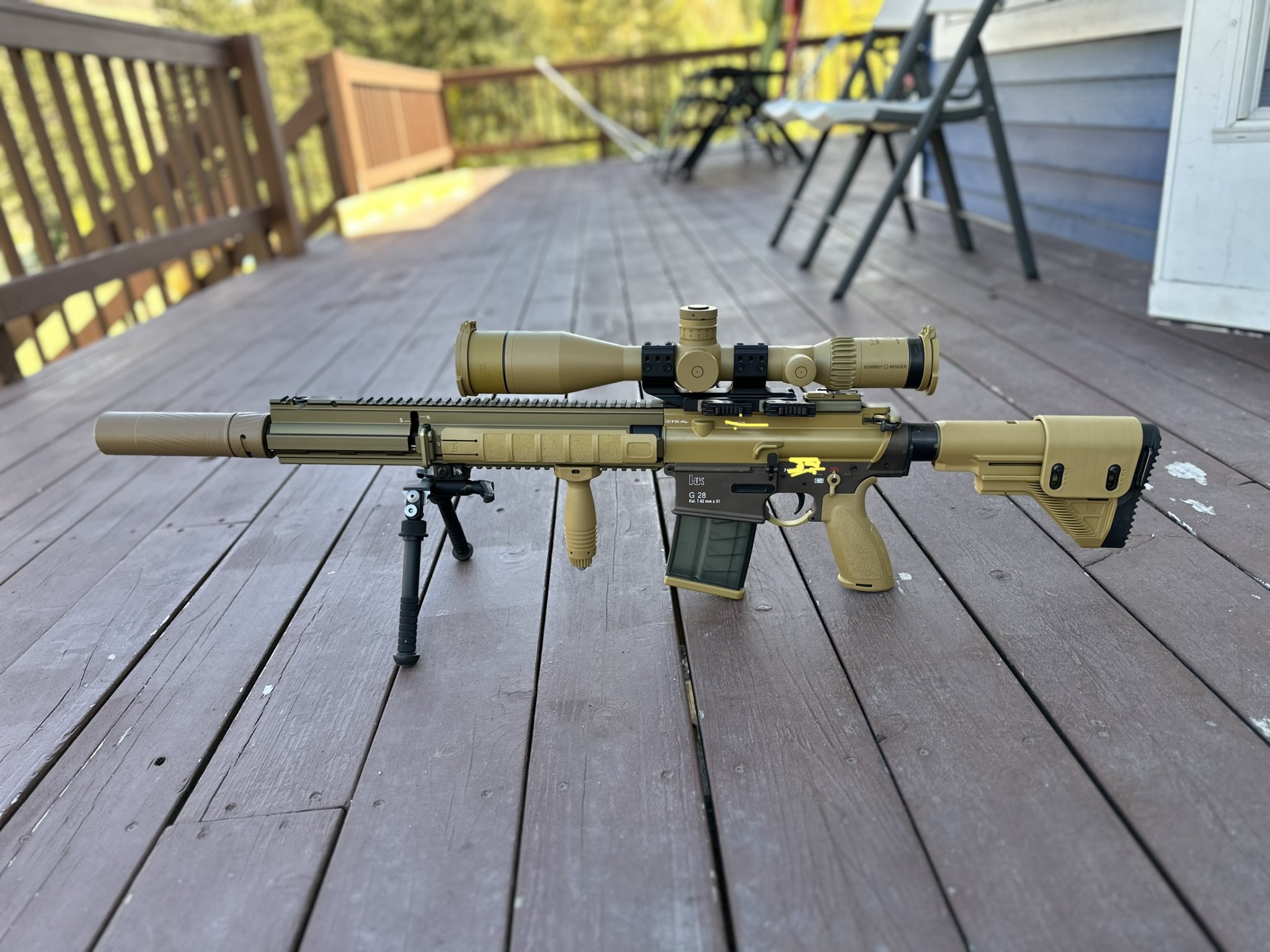

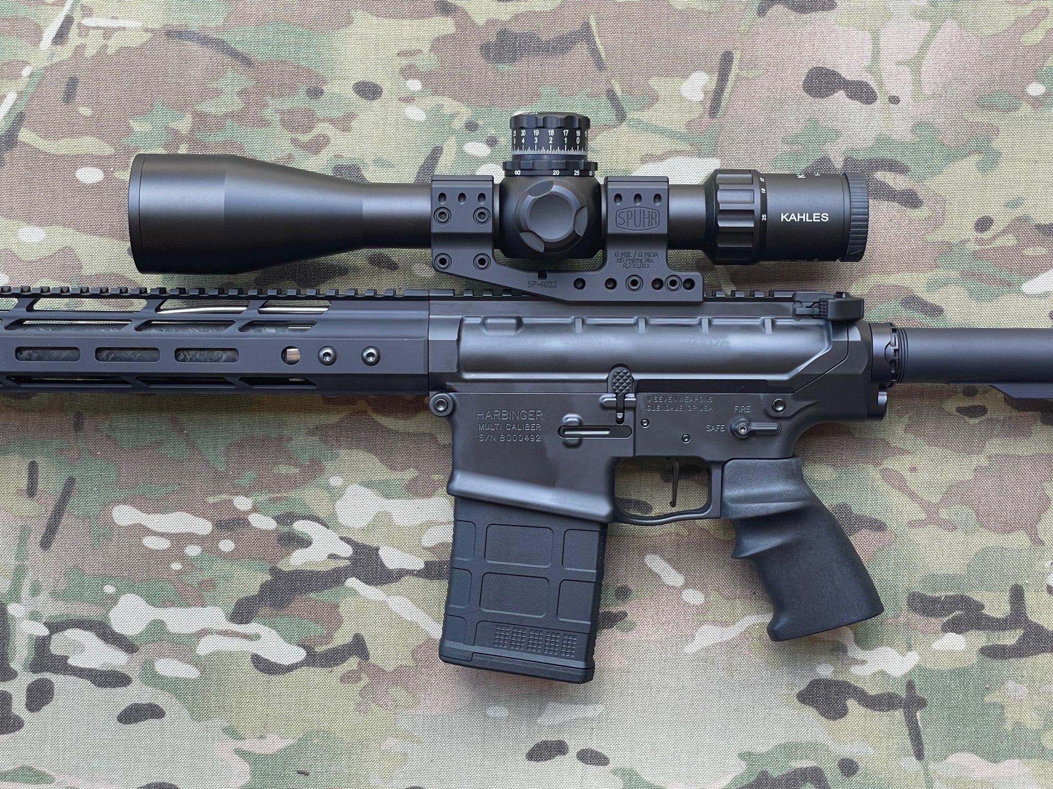

Good morning! Looking for some insight here. I’m trying to build a SASS/M110 clone. I know people take the ECR and convert it. I can’t afford to buy a SASS but want a piece to go with my true M4/M9 to have an a memorial piece of my time in! Any input or build ideas to get the ball rolling? Thanks guys!

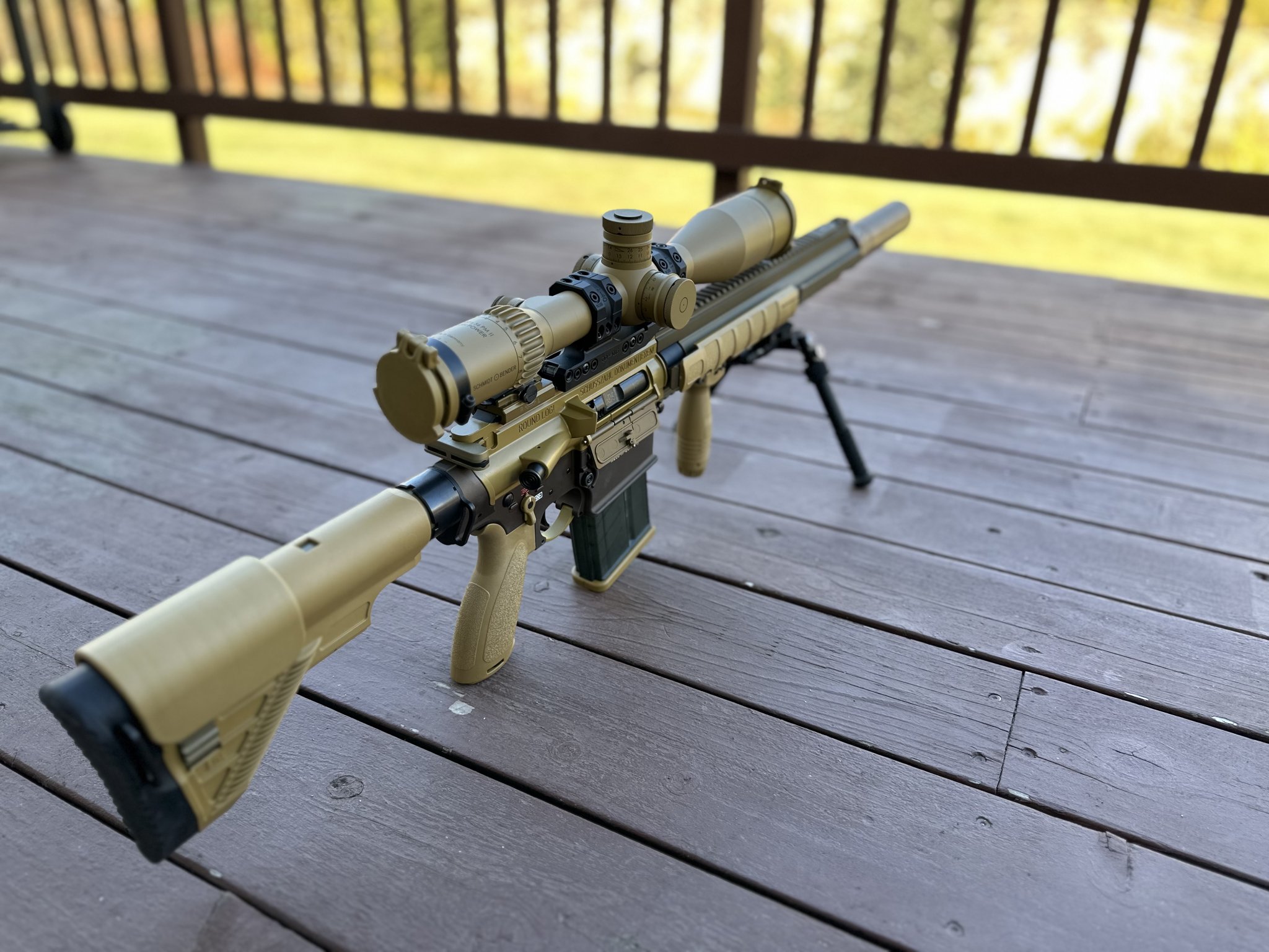

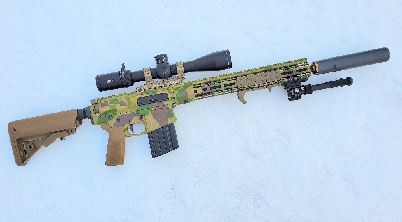

I recently had a Seekins SP10 Builder's Kit done in RAL8000 by Ronin Arms. Flawless execution. Cerakote RAL8000 is an official HK color, the only one they offer besides Black. So, it's bound to be cool, right?!? This rifle has a 20" Proof SS 6.5 CM barrel with a CGS Helios QD TI (a mere 11.5 ounces!!!) out front. Other notable components include an SLR adjustable gas block, FP Full Mass Operating System BCG, TriggerTech Adaptable trigger, Nightforce ATACR 4-16x42 F1 with TreMOR3 reticle in Spuhr mount with an RMR at the right 1:30 position. The gun just wants to please: 100% reliability, sub-MOA performance, and under 9.5 LB for the basic rifle. Even as it sits for the photos decked out with optic, suppressor, etc., it's only 12.5 LB. I'm keeping this one.

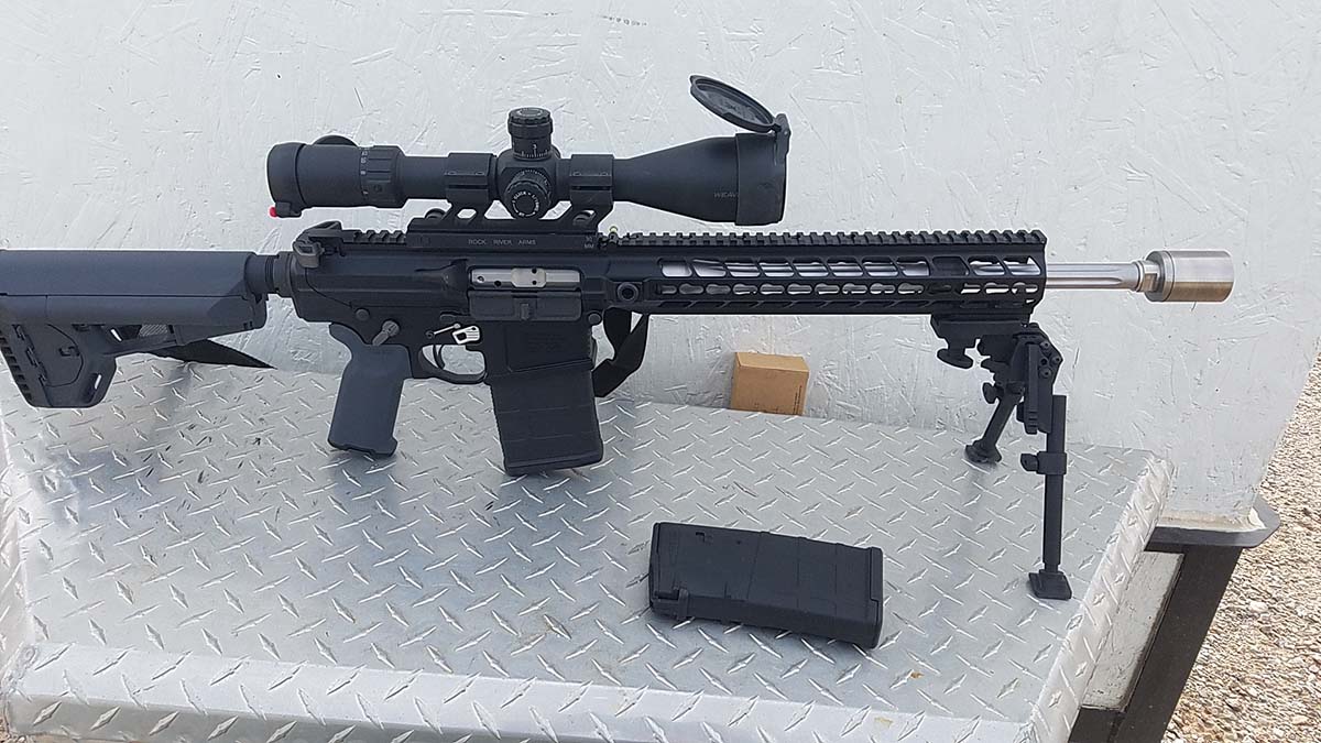

Hi. Longtime lurker, first time poster. I'll contribute. These are my big block beauties. Laverne and Shirley. Both in 308. My idea was to assemble a medium length rifle that's short enough to be a good bush gun, but long enough to land hits out to 1000yds (full disclosure, I've only shot them out to about 930). I only meant to build one. But, I might have gotten a bit carried away stacking parts. And…. I kind of accidentally built two. Schlemiel Schlimazel.
On the left is Laverne. A UUK from LaRue on a matching lower. I pretty much kept this one stock after assembling it. 18” rifle-gassed barrel. 15.5” handguard. MBT trigger. RAT stock. APEG grip. The only non LaRue parts on it are: PRI gas buster charging handle (not LaRue but included in the kit). Sprinco Orange buffer spring (also included in kit). CMMG ambi-safety. Troy back ups. Vltor VC-302 flash hider. BattleArms handstop. Arisaka 5 slot rail. Magpul QD socket. Leupold VX-6 2-12X42 (non HD) in a LaRue LT204 mount. Total weight is about 13lbs. The break-in was kind of a bitch (approx 300rds before frequent stoppages finally tapered off), now she's a good performer. Sub moa all day if my caffeine intake is in check and I'm shooting the right ammo.
On the right is Shirley. Stag receivers. 18” Criterion 1:10 nitrided midlength barrel. Superlative Arms adjustable gas block. JP Enterprises FMOS bolt/bcg. SLR Ion Lite 14.8" handguard. BCM mod 1 comp. Geissele SSA trigger. Vltor long-latch charging handle. Both the ambi-safety and mag release button are from Seekins Precision. Luth 'Paddle' oversized bolt catch. Ergo grip (the tactical fat one). Magpul SR-25 ten position RE. Magpul QD end plate. Tubb flatware spring. Brownells H3 buffer. Vltor EMOD stock. LMT flip up sights. BattleArms handstop. 5 slot rail, QD socket, and offset scout mount are from Arisaka. Surefire m300 scout at the 1'o'clock. Leupold VX-6HD 2-12x42 VTAC in a LaRue LT-104 mount. Total weight is about 12lbs.
Both are rattle canned in khaki, tan, and olive. The padded slings I made myself on my Juki.
The Stag/Criterion is hands down my favorite. Zero issues once I settled on a standard load (168's over 42.5 TAC) and properly tuned the gas block. The Tubb spring is smooooth and an absolute must on any build imo.
The LaRue started out as a finicky c**t. Constant feeding issues. Once the Sprinco Orange buffer spring finally broke itself in, it's been fine. Charges and cycles smoothly. I want to replace the older VX-6 with something that has more than 19 minutes of elevation. With my 168's flying at 2750 I'm typically out of dial at about 7-750 yds. At 12 and 13lbs, they’re definitely a pair of fat chicks. I figure if I just do an extra pushup every morning I’ll be ok.
