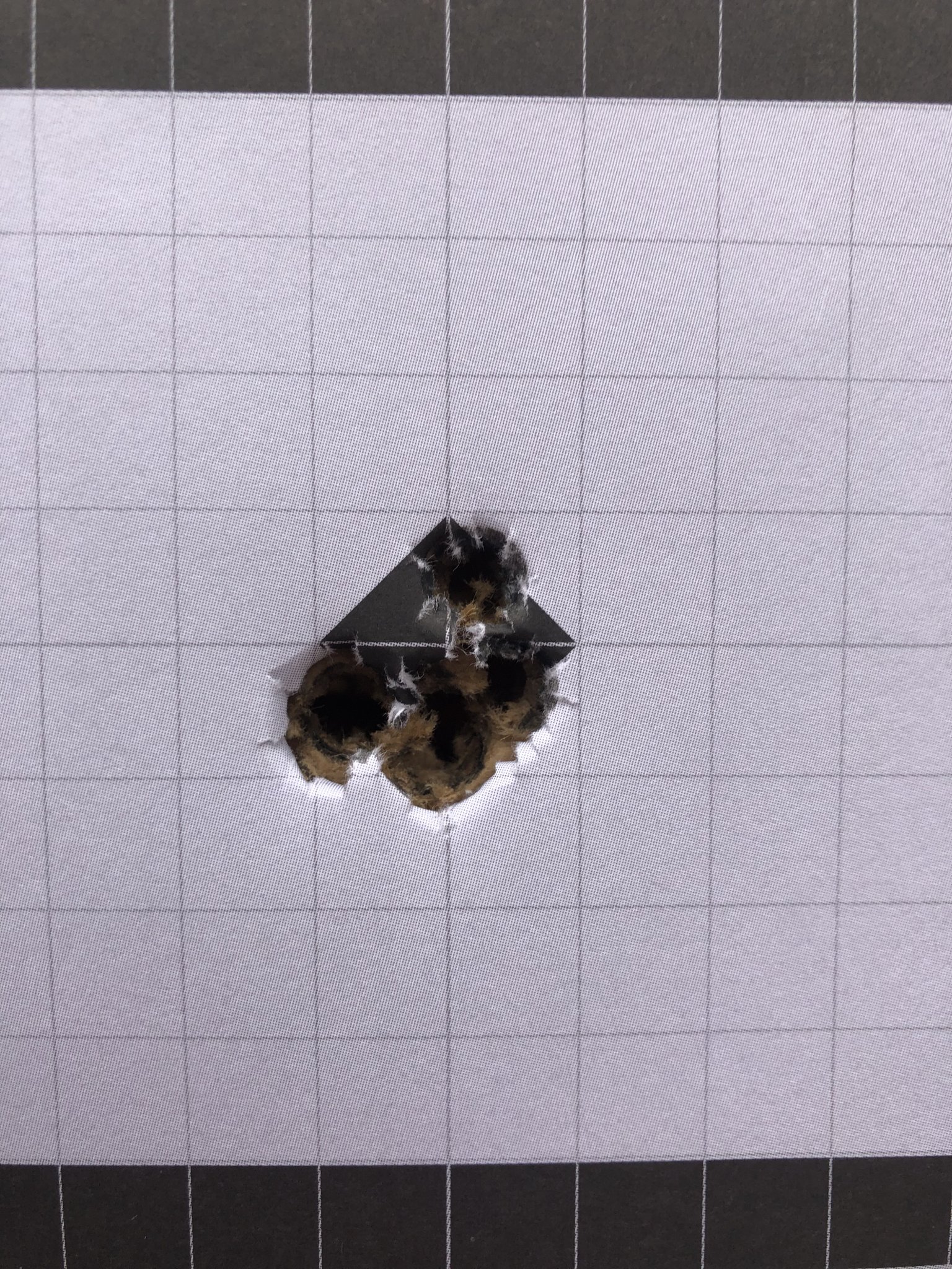

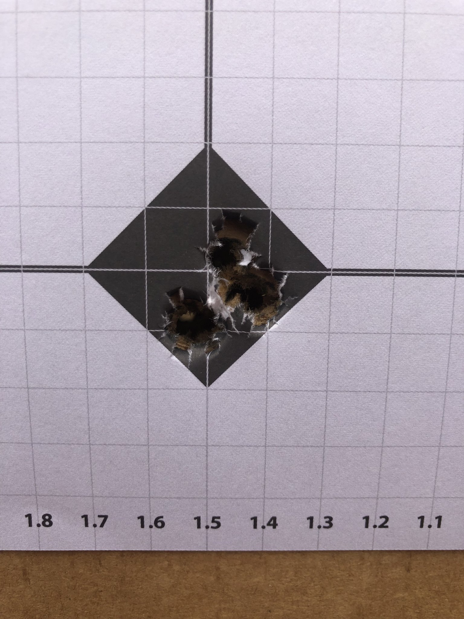

9.5 gain twist to 8.75, left hand.
I think I’m up to 130 rounds or so. It should kick in after 200.

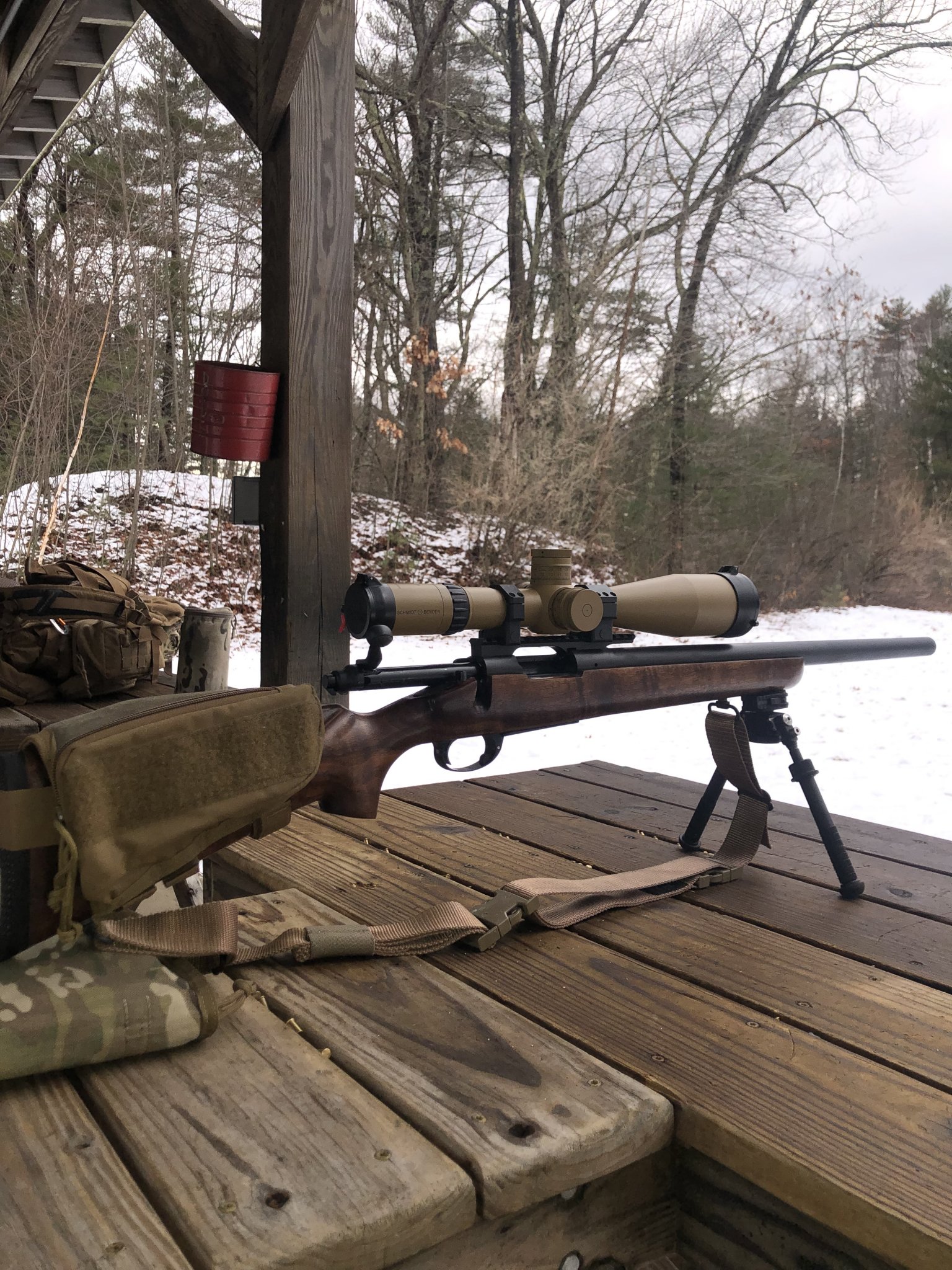

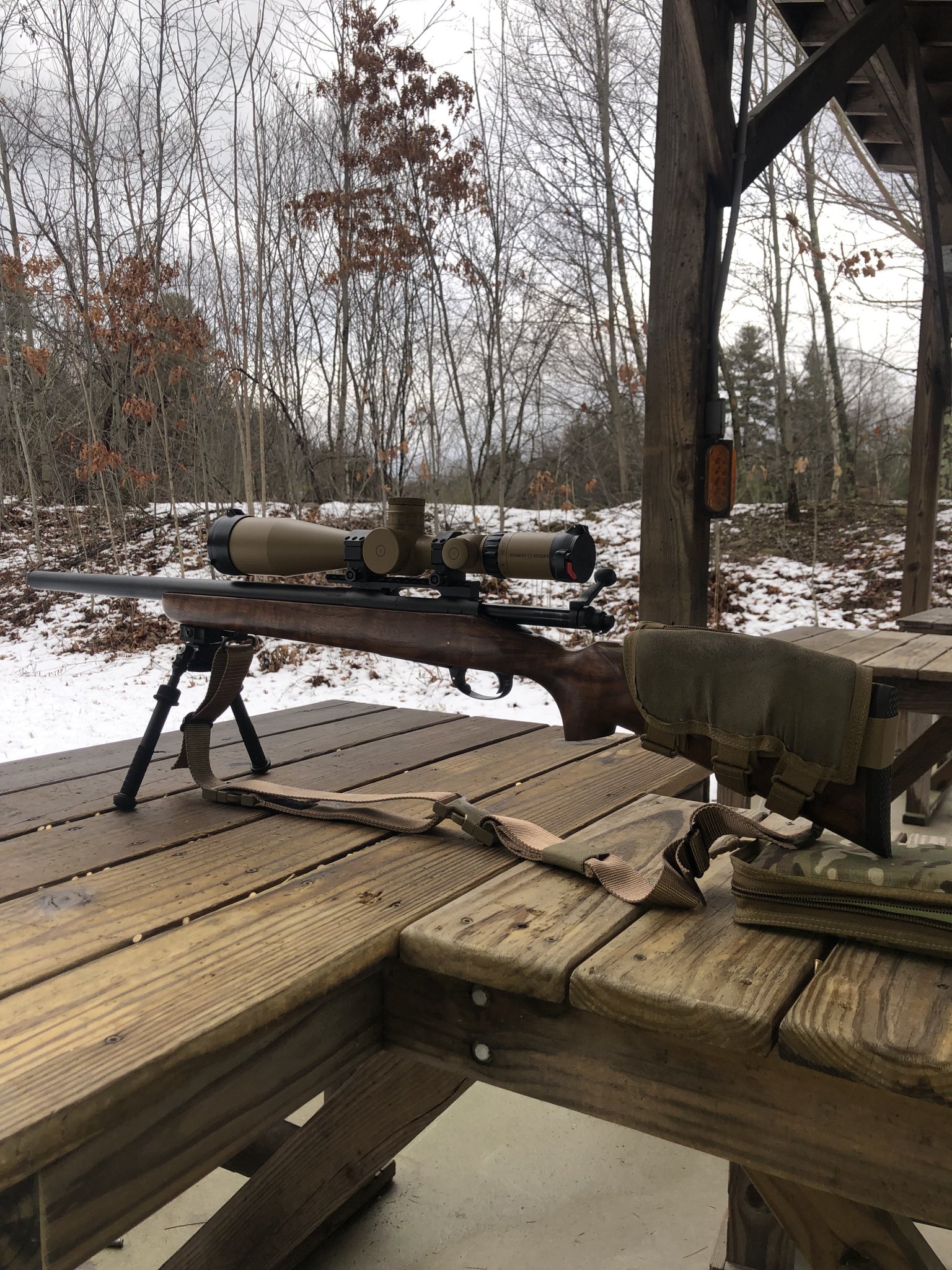

I like my guns to be pretty.
If it was about performance I’d buy something in a chassis and beat it like a red headed stepchild.
Fortunately all my pretty rifles shoot pretty good and I think that’s a factor of good builder and quality parts.
