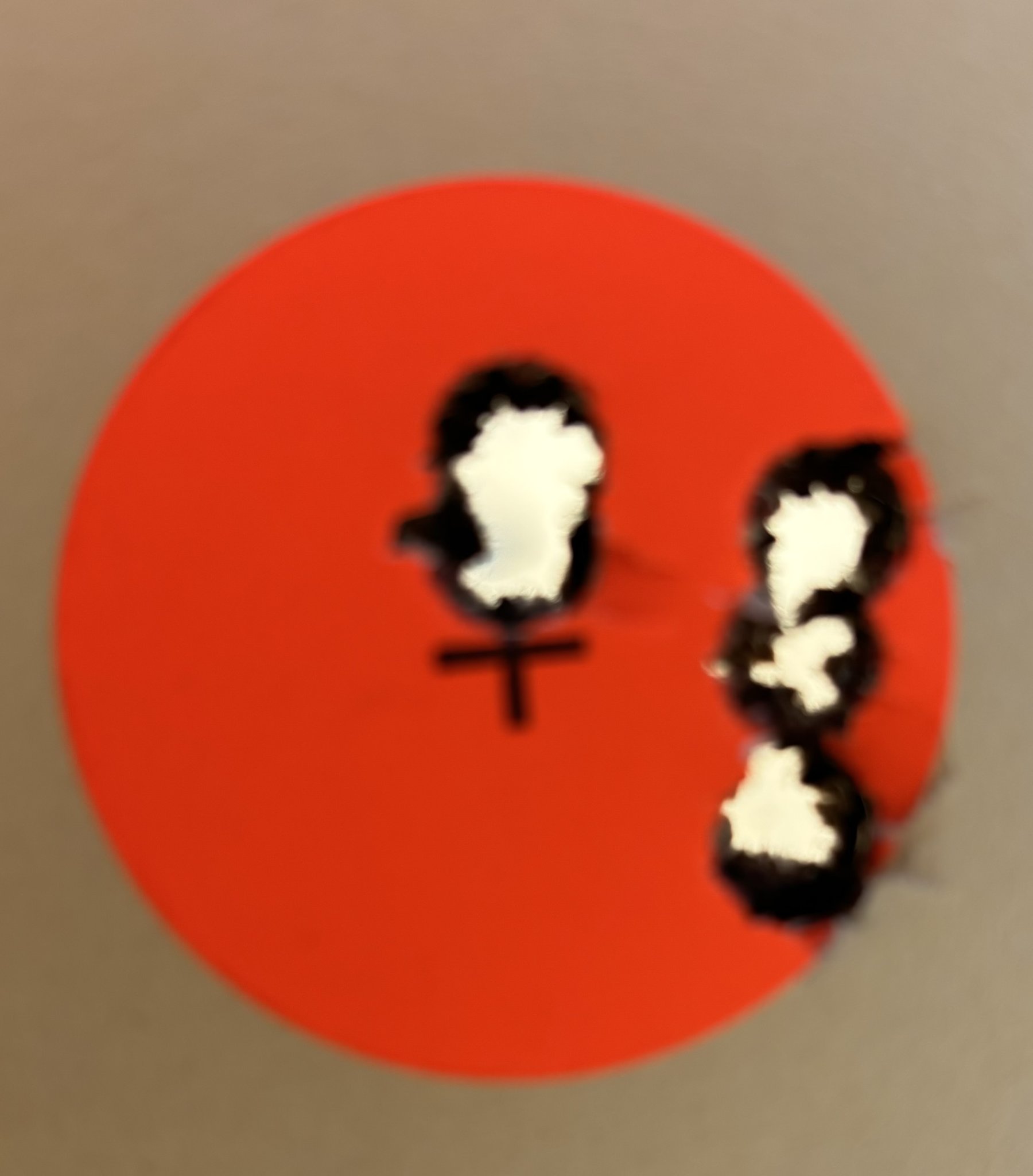

I went to the range this morning and it was cooooold. I decided to start with 4 loads, same powder charge but different coals. I started with 2.937” cuz that’s what the zero on the micrometer inline seater produced. That was just shy of mag length. I loaded 2 rounds and shot them at 100 yards and they touched. Then I loaded a couple more but seated them deeper to 2.915” but they landed about an inch apart. Then I tried a couple at 2.900” and again they touched. Two more at 2.875” landed an inch apart.
So then I want back to 2.937” and loaded five.

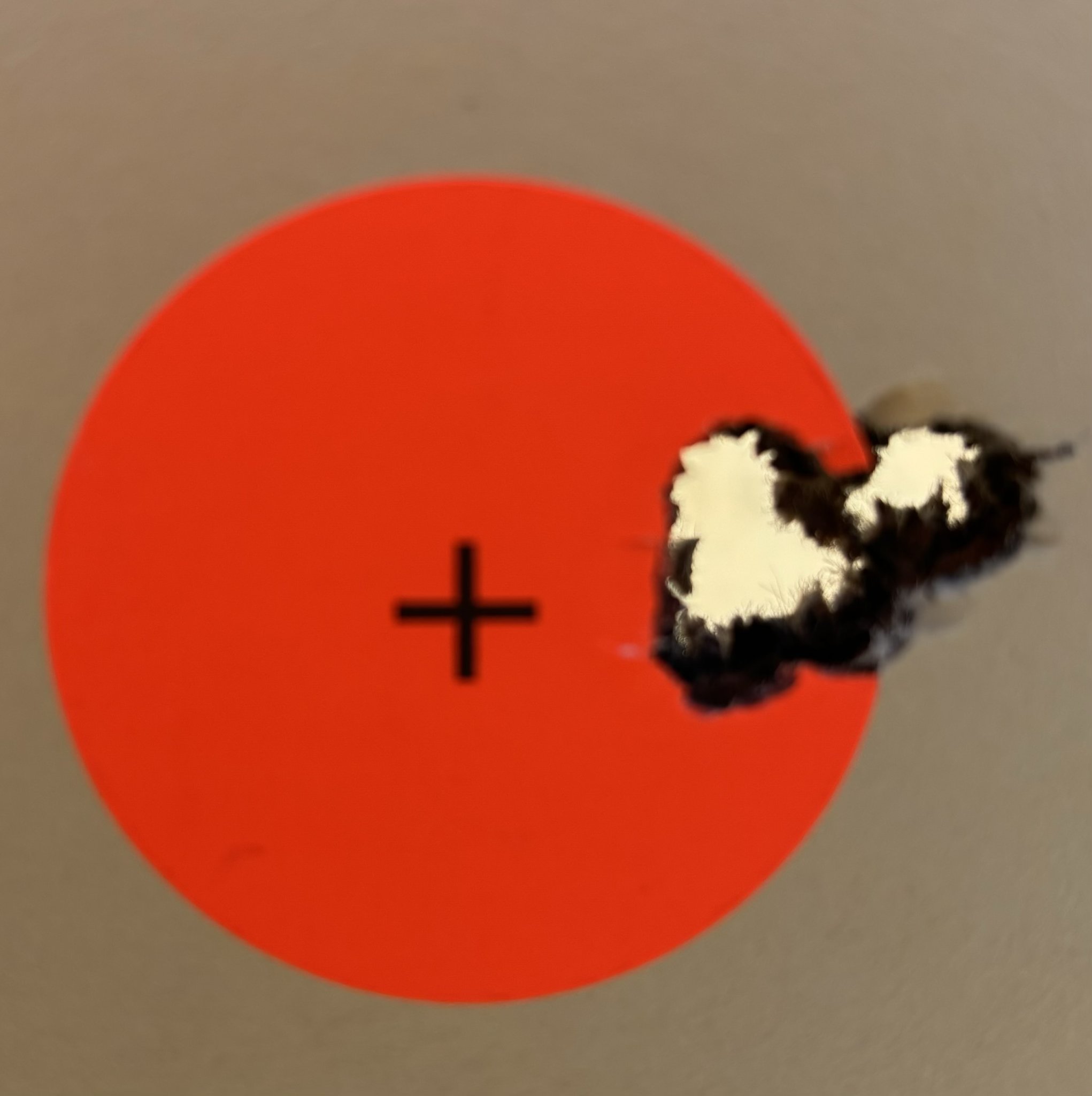

I also loaded and fired 5 of the 2.900” ones:

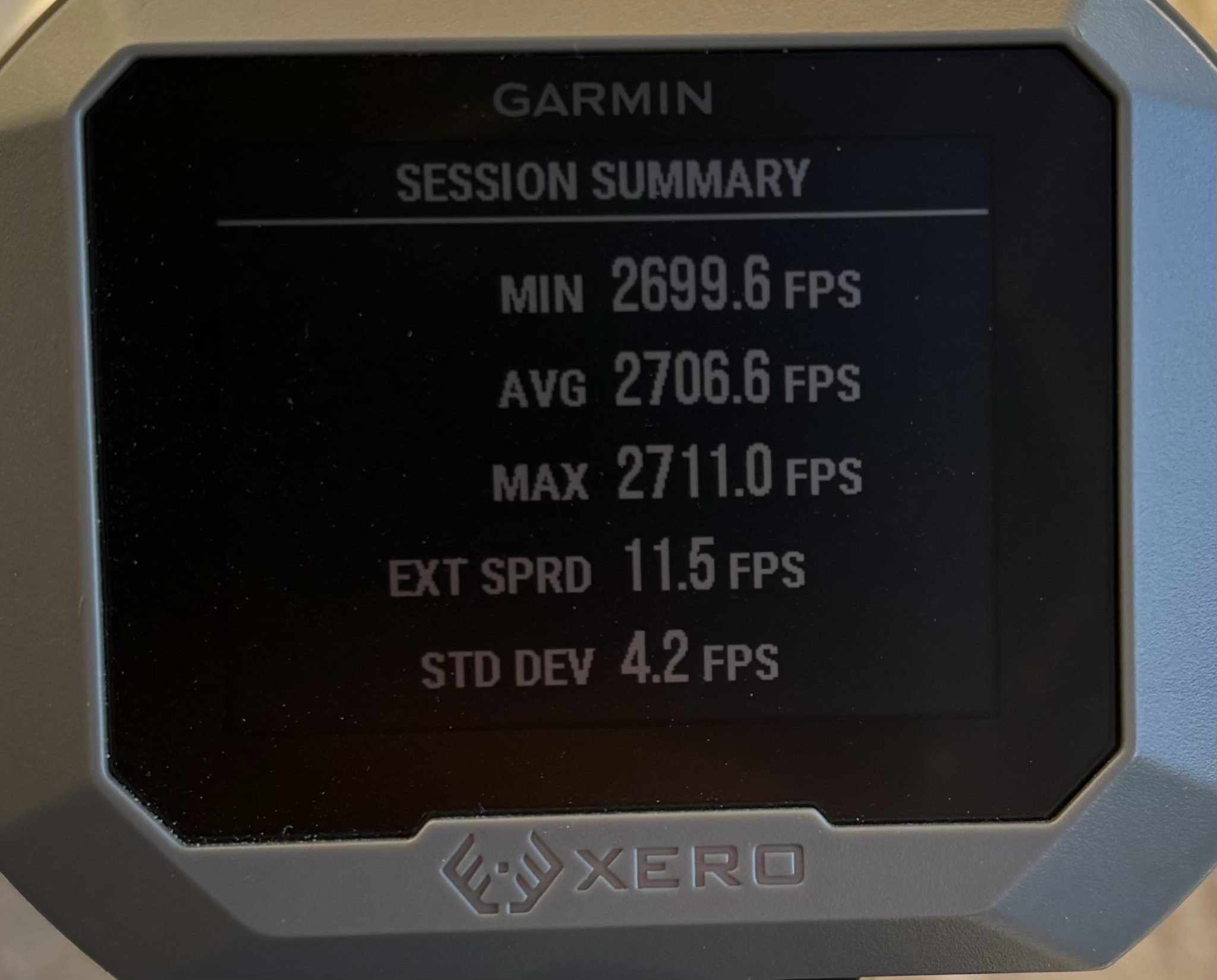

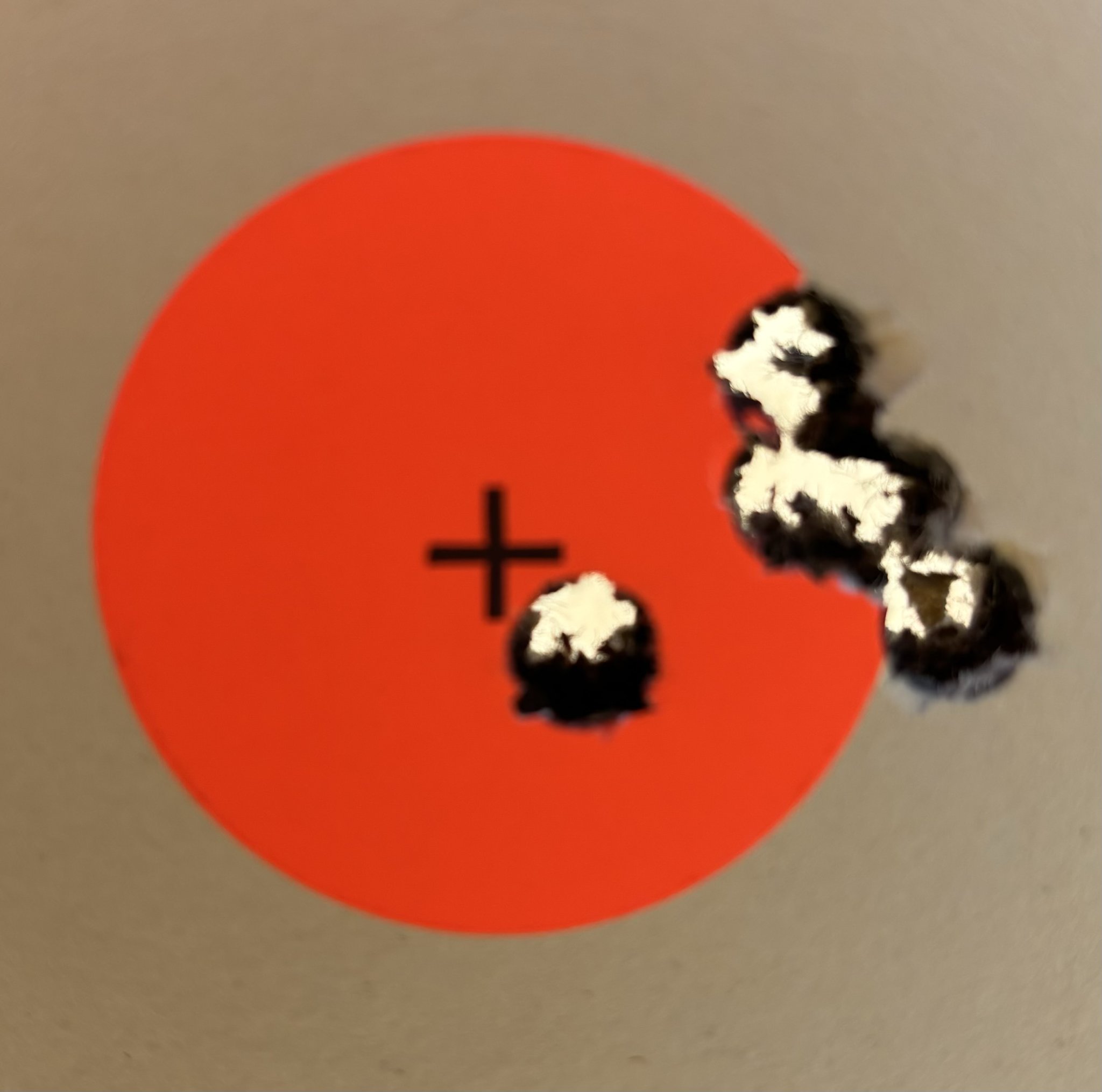

I didn’t like either so I went back and shortened the 2.937” ones by .005” using the micrometer dial of the seating die:
26” Bartlein 308
40.7grs AR Comp
210M primer
New Starline brass (173grs)
