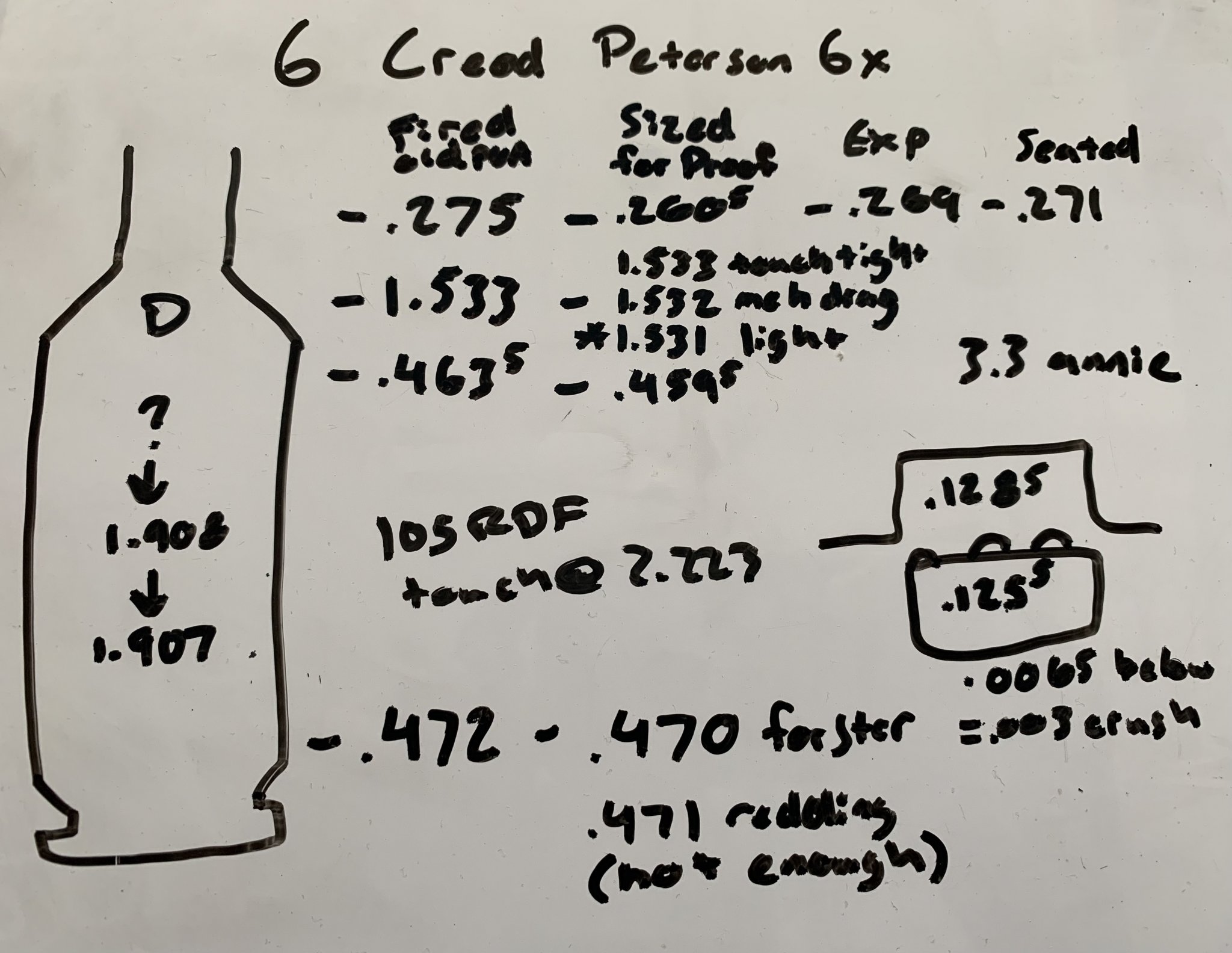

How to diagnose a problem? Measure and compare.
Here I have measurements showing old brass from one barrel being sized to fit in a new one. Notice the shoulder lengths vary on fitment and I can vary that feel by screwing the die in more or less. BUT the base as well and the base is where my major issues were located. I needed a different die to size the base down that extra .001” to get it to chamber.

A forster but I don’t shoot 308
A small base will fix it for sure but be harder sizing since it is doing more

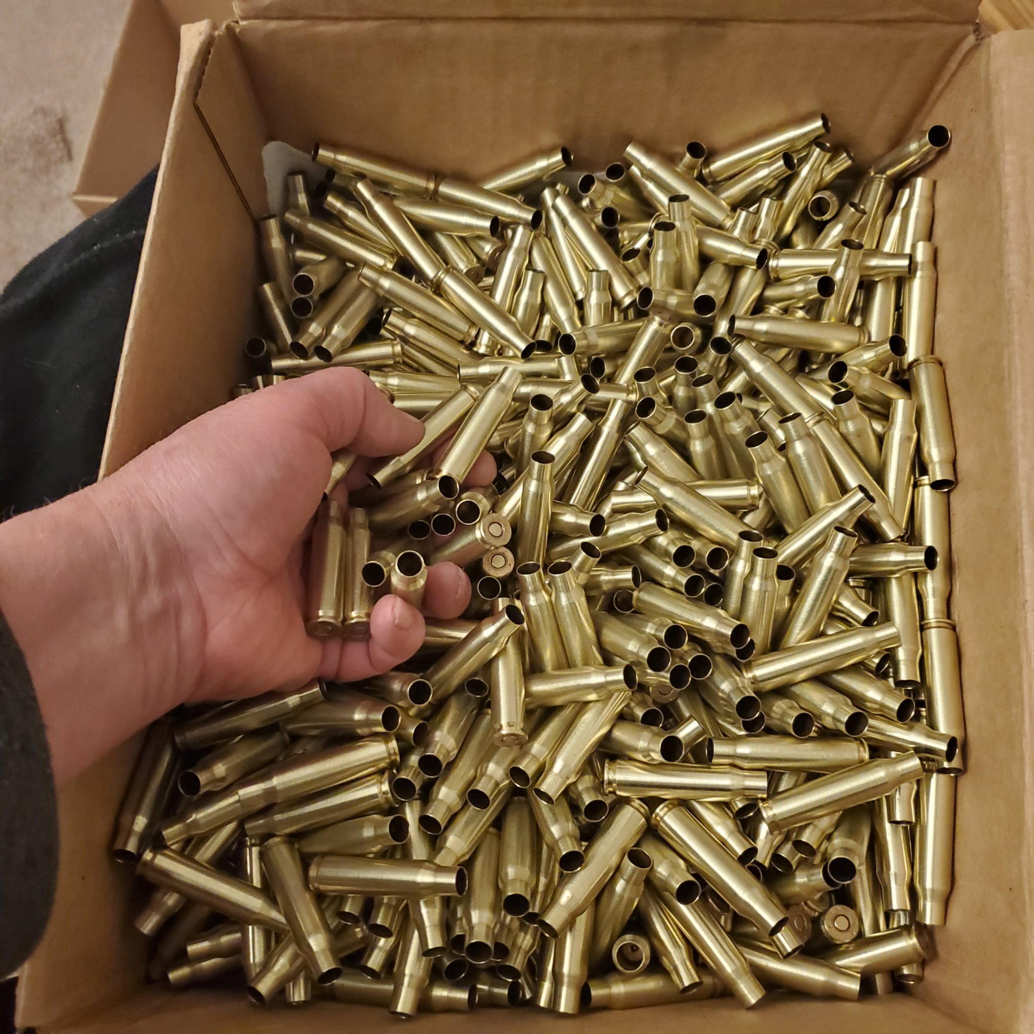

Here is a box of 1000 sized & primed 308 cases ready to load in one of many rifles, 16, 18, 20, 22, 24, 26, 27, & 30 inch barrels ARs and bolts, twists of 12, 11.25, 10, 9, & 8.
The box is now empty, most of the 1000 cases have been loaded & fired.
These cases fit every 308 auto or bolt I own, about 8 different rifles...just add powder and bullet of choice...100 gr to 250 Atip.
