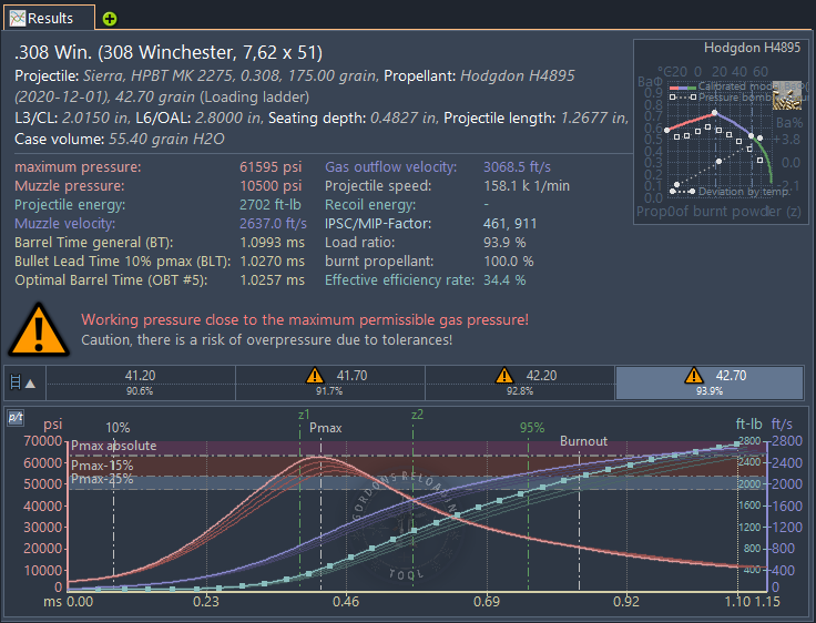

For what its worth, this is what GRT puts out for the load being debated. Puts him at 64,000psi, while spicy and technically over charged. Its not gunna blow up the gun and with strong primers should only show flattened primers as a pressure sigh. I know im comfortable running my 308 up to 65,000psi before my butt starts to pucker(proof load for 308 is 75,275psi). So I'd say this load is plausible, albeit deffinatly qualifying under the +p Category. Lets try and keep it civil here talk with the data.
