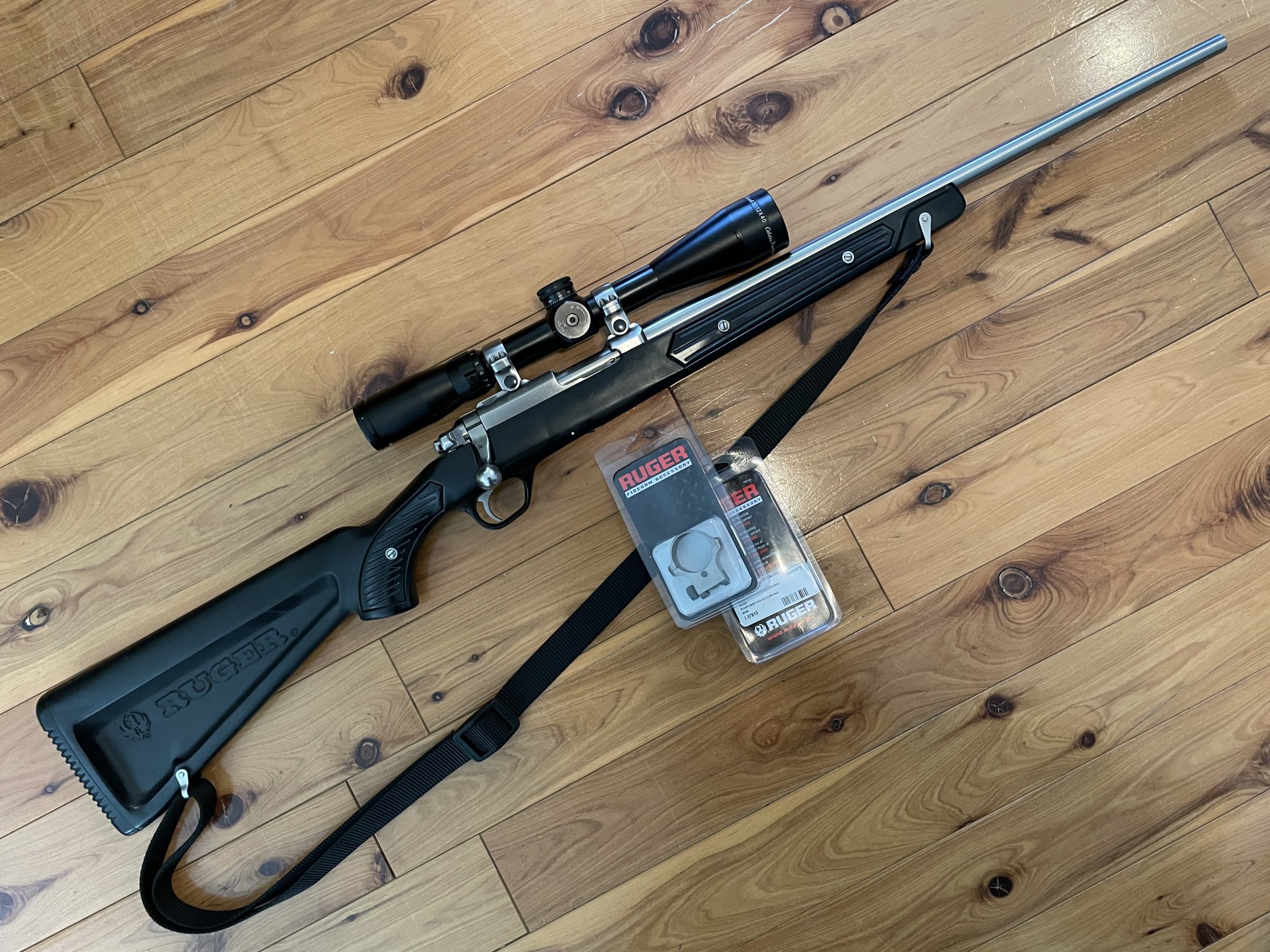

Need suggestions for a 30mm tube scope for long range rimfire.
Must have:
First Focal Plane reticle
Christmas Tree style reticle
Prefer MOA
Side parallax and exposed turrets.
Maximum amount of vertical adjustment range.
Don’t care about zero stop or illuminated reticle.
Budget to be determined, but prefer <$1K
Edited to add:
I don’t wish to add picatinny adapters, to restock, to add strap on cheekpieces, or to further make this gun anything other than what it is, an exceptionally accurate rain rifle for hunting in conditions I don’t wish to take a carriage grade walnut and blue steel heirloom piece. I’ve not seen stainless steel 34mm rings available for this rifle, nor do I wish to raise the scope higher than these 30mm rings do.
Thus far the Vortex option mentioned may serve the purpose as I’m very familiar with the reticle.
I have an Athlon
4.5-27x50 APLR4 FFP IR MOA​
on a Ruger 10/22 Custom shop.
Works well but my Zeiss 636 on a Ruger Precision Rimfire is better but that’s 34mm and more than $1K.
Call Doug at CameraLand for a good price.
-Richard

That post you quoted was a little tongue in cheek humor but I was more concerned with tube diameter when needing maximum amount of elevation. You only have about 70 MOA in the PST where with a 34mm scope you can get over 100 MOA. MOA or Mil is just a number but amount available is important.
I WOULD suggest he take a look at the Arken SH4 or EP5, Strike Eagle 5-25x56, and the new Primary Arms SLx 5-25x56… BUT, they’re all 34mm tubes, and I wouldn’t want the OP to feel unlimited with his equipment… It might make him too powerful and accurate at the range, intimidating all the others around him.
Every time I see a new shooter show up and either doesn't have a zero stop or didn't set it up "to get more elevation" they inevitably get lost in the rotations and spend the next one or two stages trying to find it.
I have 2 of those exact same M77 MKII All-Weather rifles... One in 7mm RemMag, and one in 7mm-08 Rem. I just ordered 2 EGW picatinny rail bases for them. The receivers have to be drilled and tapped by a professional gunsmith to install them, but it's worth the money. I will probably be taking mine in the next couple of weeks to have them drilled & tapped. It allows you to use ANY standard 1913 picatinny rings and scope you desire once done. Spend the money on the EGW rail and paying a qualified smith to drill and tap the receiver. Buy once...Cry once. And you'll never be limited to those shitty factory Ruger rings every again.
Here's a 0MOA... https://www.egwguns.com/ruger-m77-short-action-picatinny-rail-must-drill-tap-receiver-0-moa
Here's a 20MOA... https://www.egwguns.com/ruger-m77-short-action-20-moa-must-drill-tap-receiver
Reactions: Rob01
I reach 400m in sub zero temperature with my 30mm Midas 6-24 and Burris bushing rings without having to hold over with my RimX. I have a full 25 mils of elevation available + 1 mil below zero.
