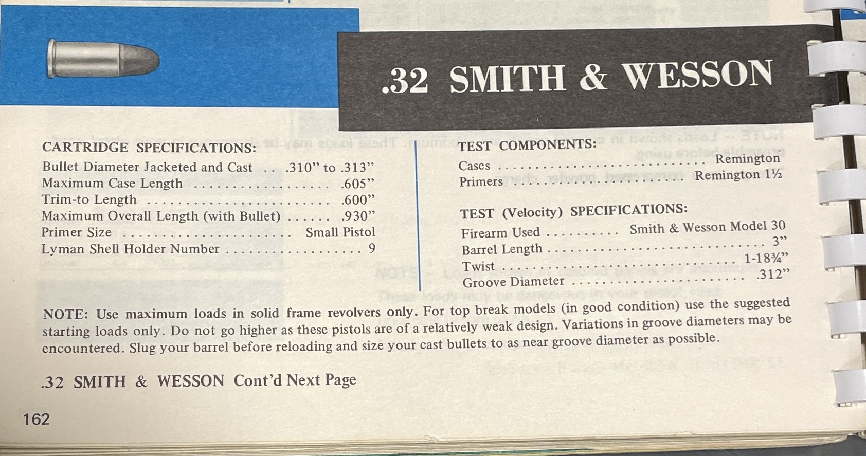

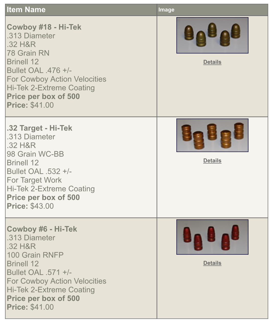

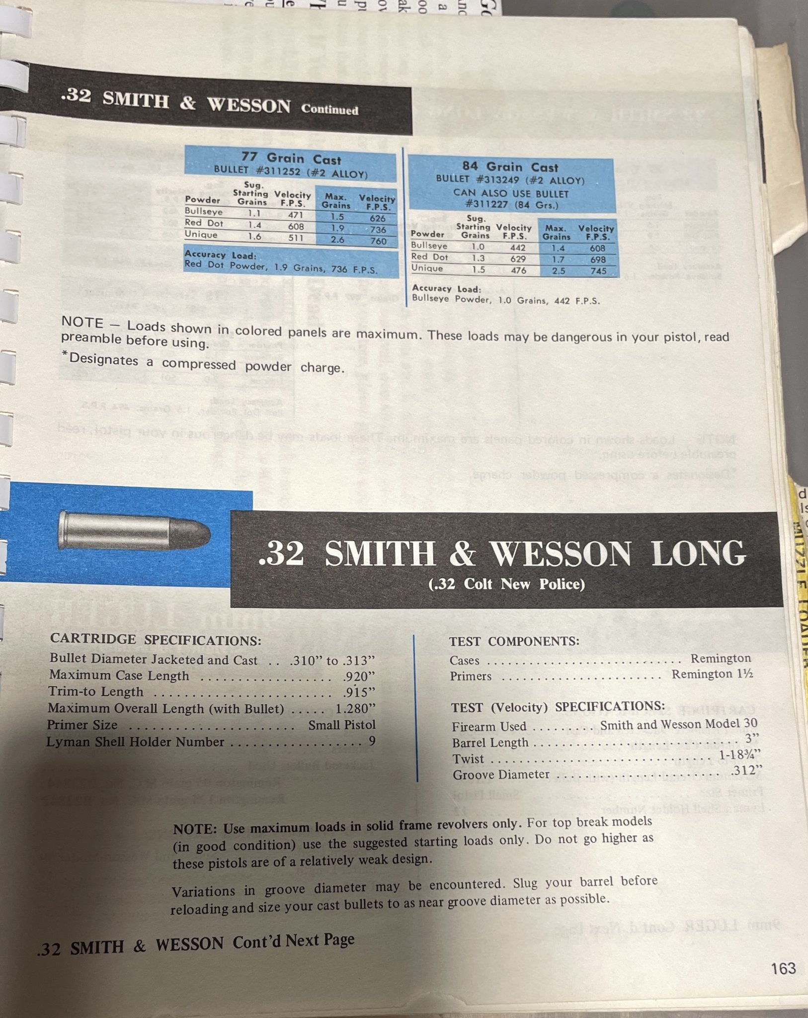

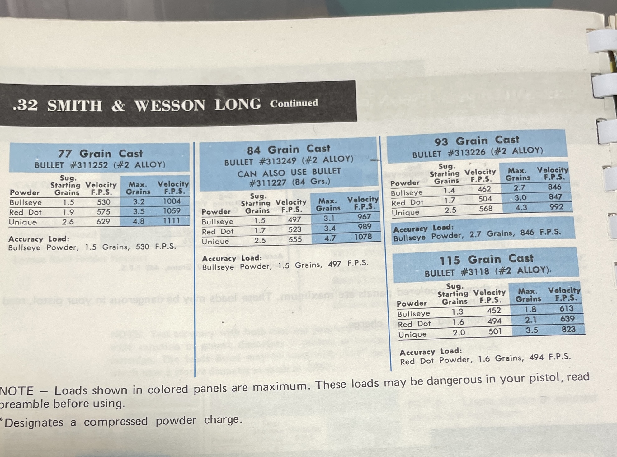

Hi. I bought an old H&R revolver in 32 S&W Long. I used 100 gr. cast with 3.0 gr. of Red Dot. Here’s some old load data and a source of bullets. Hope this helps
Edit: I use an old set of RCBS 32 S&W Long / 32 H&R Magnum dies.
