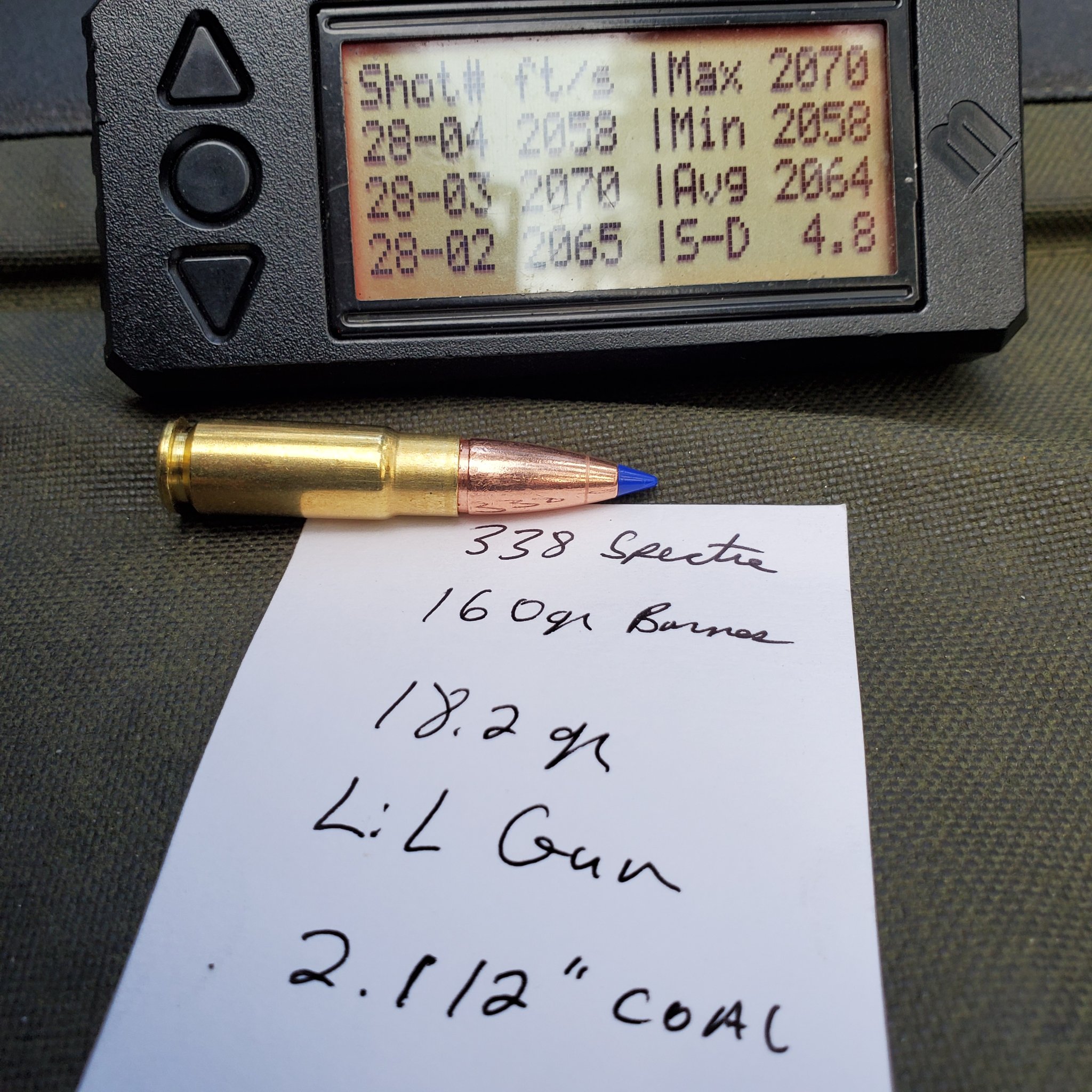

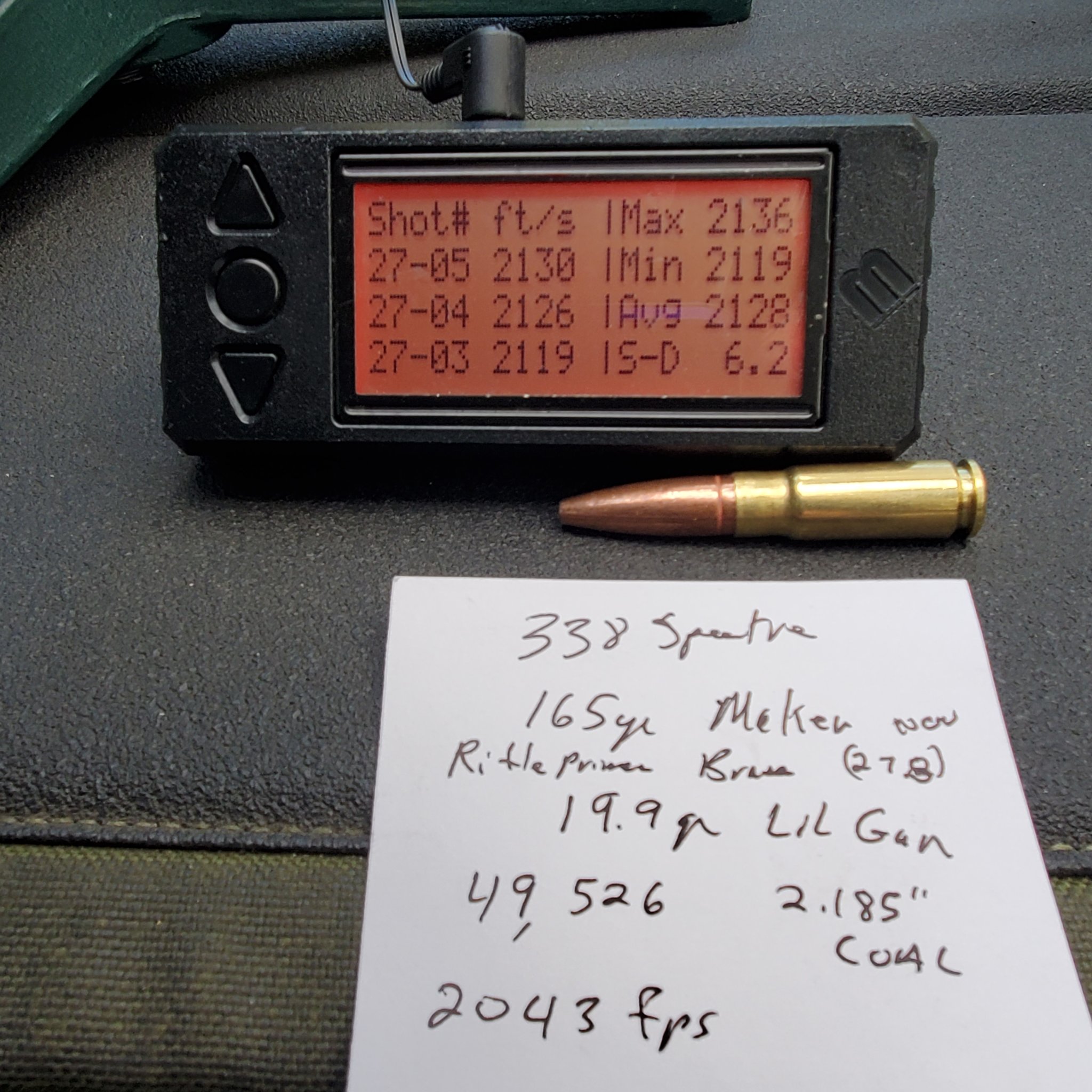

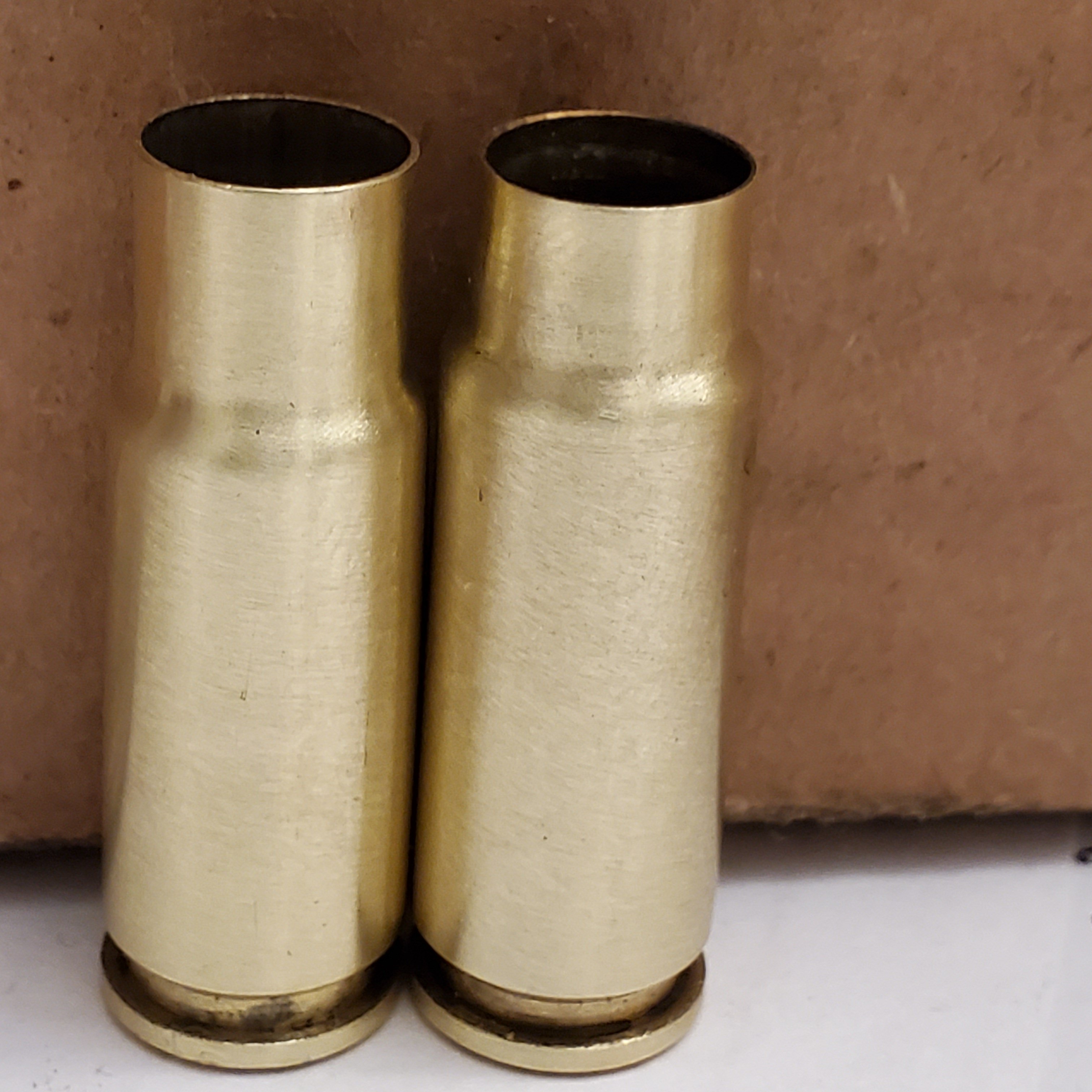

I've been shooting the 338 Spectre almost identical to the 338 ARC.
The slightly longer case on the right in the pic is the 338 ARC it appears to have a bit over a grain extra capacity, then tbe 338 Spectre case on the left.
So 338 Spectre load data would be very close to 338 ARC.
This is a 6.5 twist barrel 16" AR 15.
This is a very accurate AR 15 cartridge with low S/D in velocities with subs and supers.
I've fired most bullets from 160 gr Barnes to 350 gr Maker.
The two cartridges are almost twins with the new 338 ARC with a tiny bit more capacity, so this should get ya started... work up on super loads

LilGun is much better than 1680 for the 338 Slectre/ 338 ARC.
lilGun gets higher velocities with a hundred percent burn with supers.
And cleaner, with 100% burn with most subs with 16" and shorter barrels.
Giving excellent accuracy and very low S/Ds in autos.
AA 1680 will decrease in efficiency with subs down to 85% burned, and almost never reach 100% burnt, in these small cases.
LilGun, then H110, or W296 are where you'll likely find the most consistent loads, with every bullet weight from 160 gr to 350 gr. Making powder selection easy.

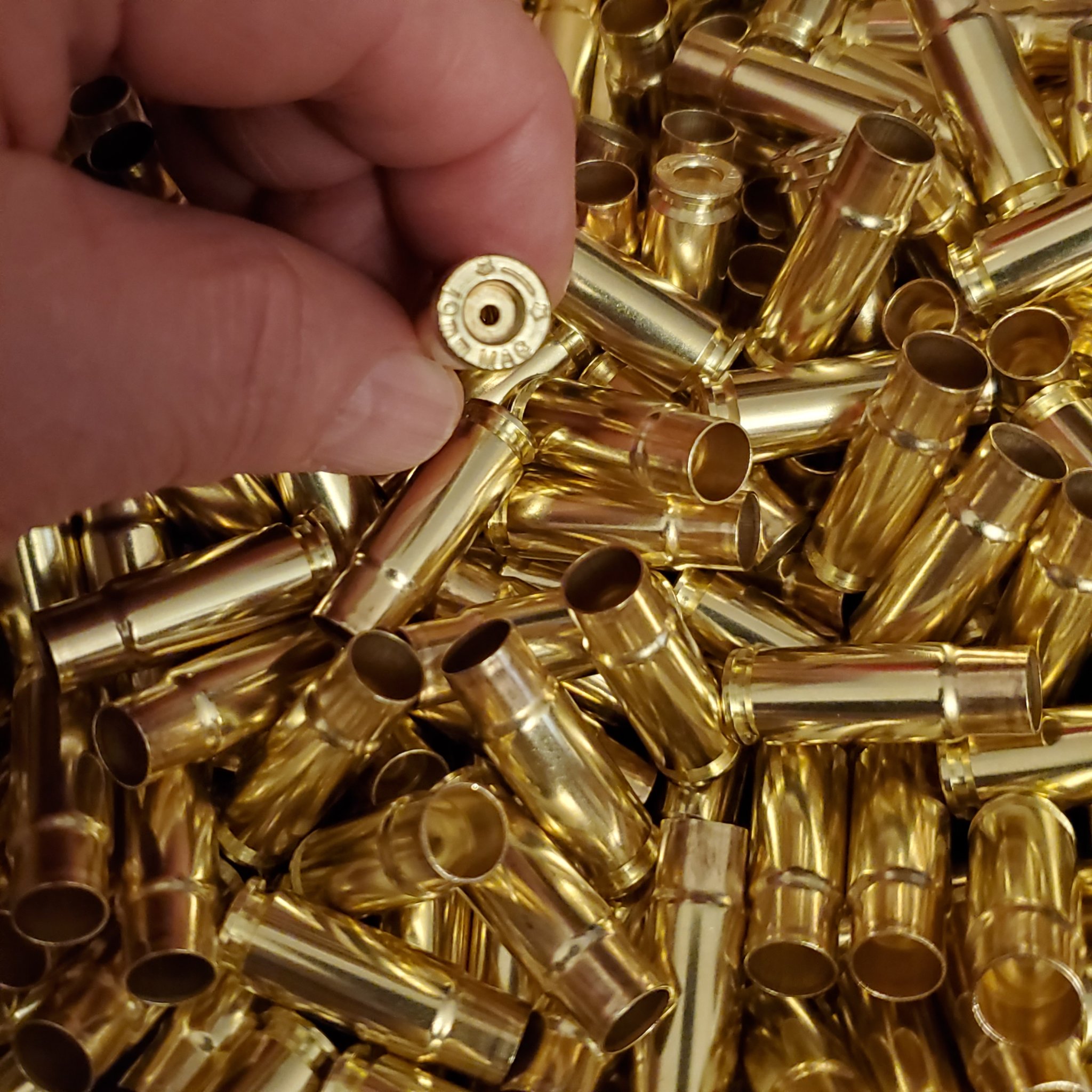

Does the 338 spectre suffer from split neck like the 338 razorback?
No, I resizesd 500 Starline 10 mag pistol cases very easily and cheap too but run 40,000 psi area...just spray and run through FL sizing die. No split necks.
They are good for subs and moderate loads. And are accurate with low velocity SDs.

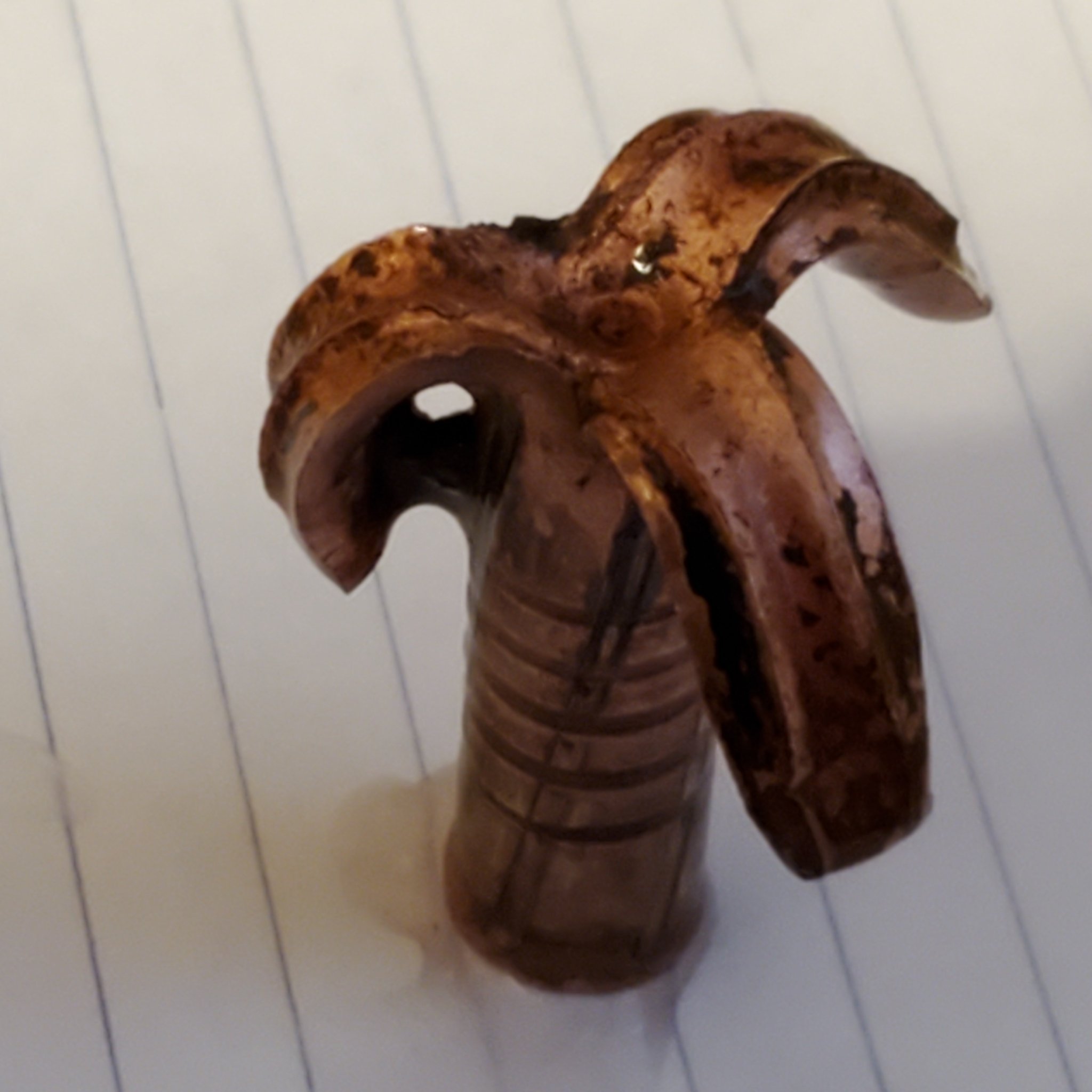

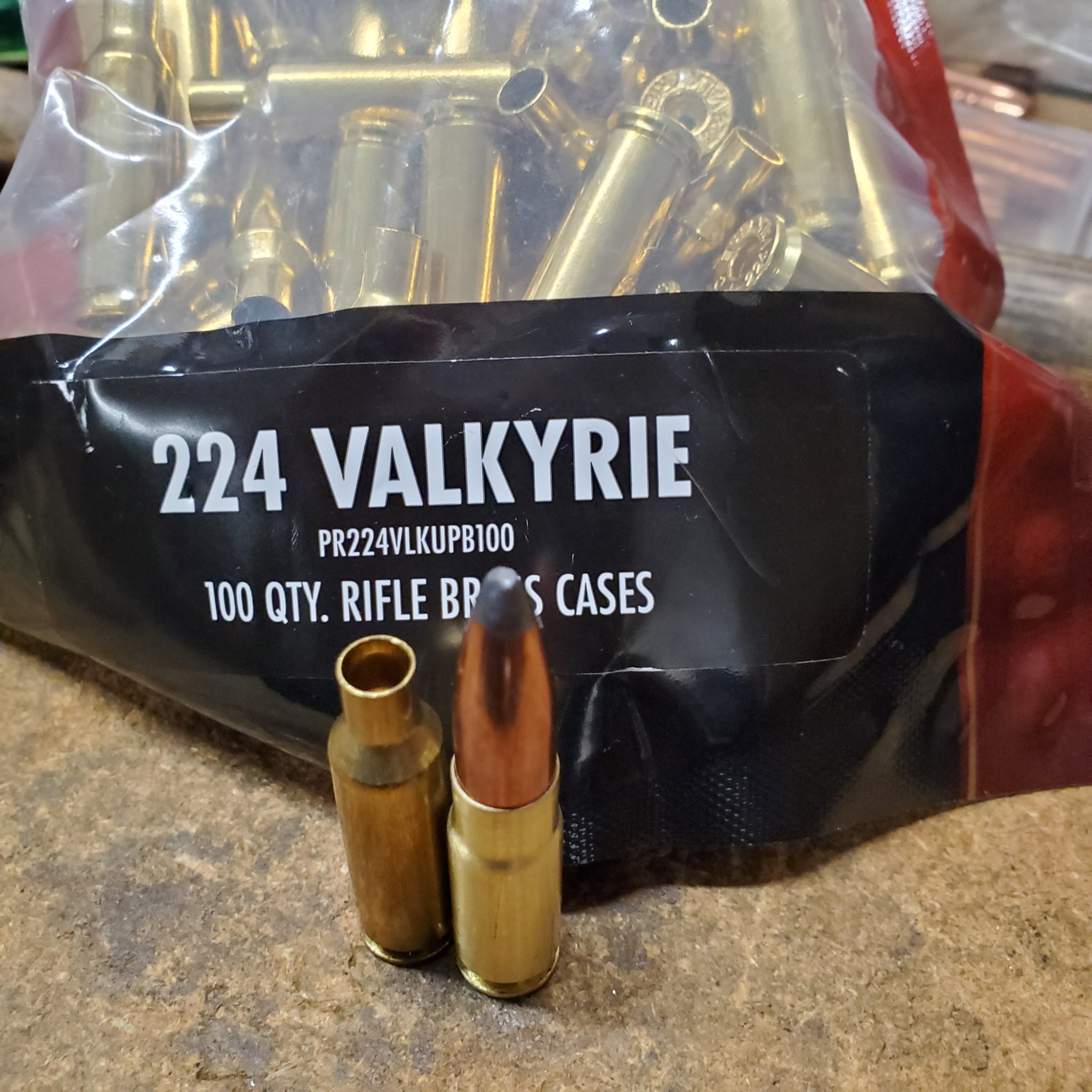

Want an extra 100 fps or so in supers go to the factory 338 Spectre SR cases $46 per hundred ...or cut and form 224 Valkyrie brass for the higher pressure loads of supers, in the 55,000 psi area, and run the 165 gr Maker Super especially made for the 338 Spectre and its 6.5 twist at over 2100 fps in a 16" AR accurately, which is its maximum muzzle velocity...you'll have to test it to see if it expands at 900 fps...that would give one a fair amount of range, on a super load.

What’s the process to make it out of 224 Valkyrie brass?
338 Spectre from 224 Valkyrie is trim it to length, run through a 338 Spectre FL die, I turn the necks, and probably should anneal for longevity and consistency.
Not much to it.
I use a Bridgeport mill to trim to length in one second....but any case trimmer works.
Picture shows pretty much cut off neck and most of shoulder.
Straight walled cases don’t get annealed, annealing the straight cases helps to prevent split necks when they are formed into shouldered cases. I have formed hundreds of Spectre cases from 10mm Mag and have yet to have one split on me, granted the 338S shoulder is a very mild transition in comparison to necking a 357 Max case down to .17 caliber.

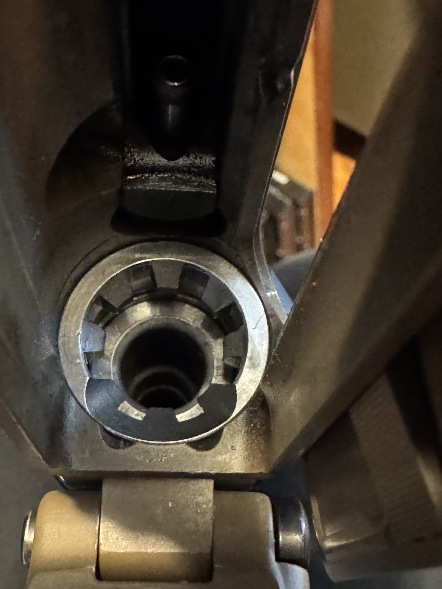

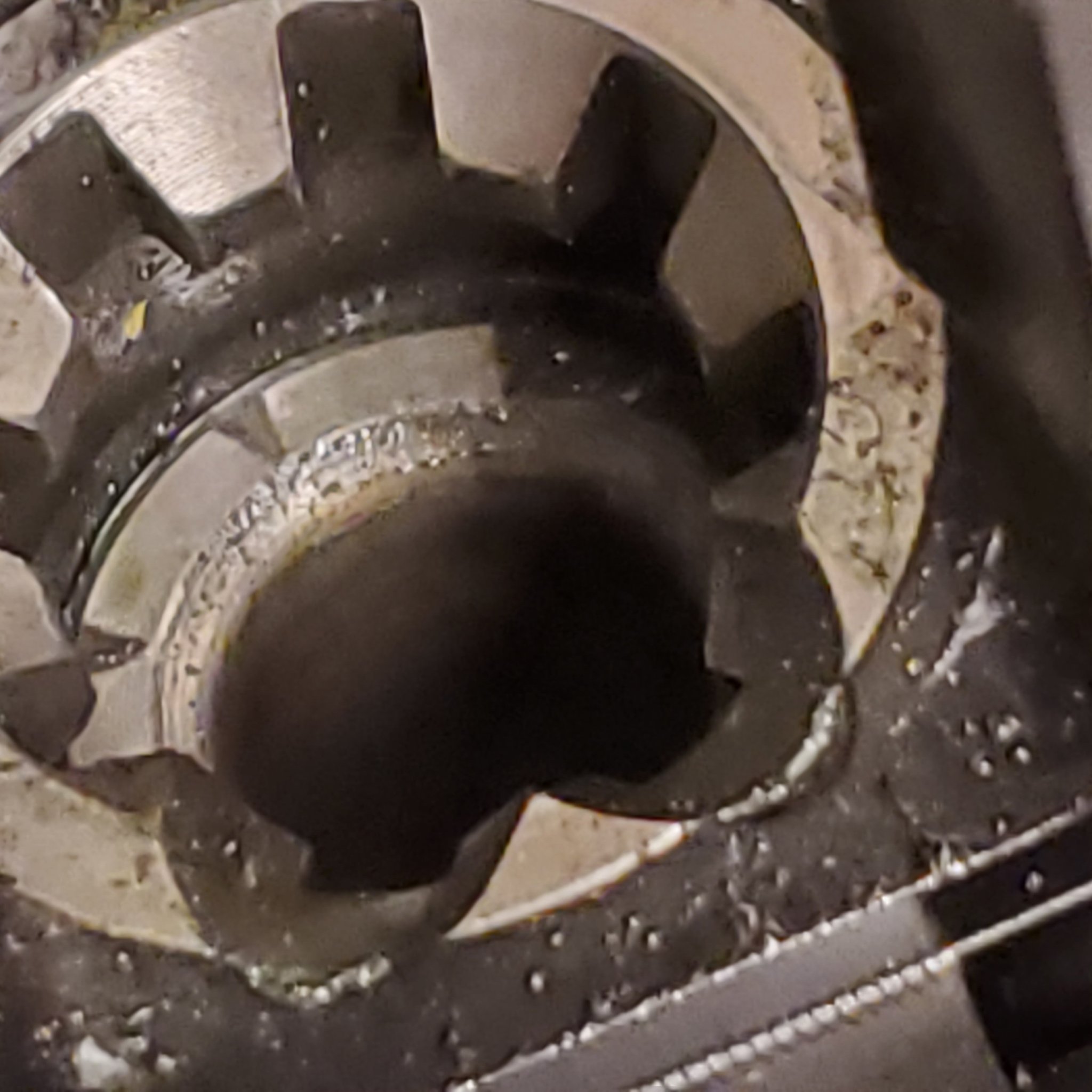

That looks like the 450 bushmaster big bore barrel extension.
These are for feeding blunt or round nose bullets...which describes the Hornady 307 gr for the 338 ARC.
The 338 Spectre which is almost identical to the 338 ARC has a more traditional 300 blackout type barrel extension for pointed bullets. This works 100% for all pointed or semi pointed bullets, from 160 gr Barnes to 300 gr SMK or 300 gr match.
Haven't tried a 250 gr rd nose to see how it would feed. Something I'd need to check into before buying a thousand round nose bullets.

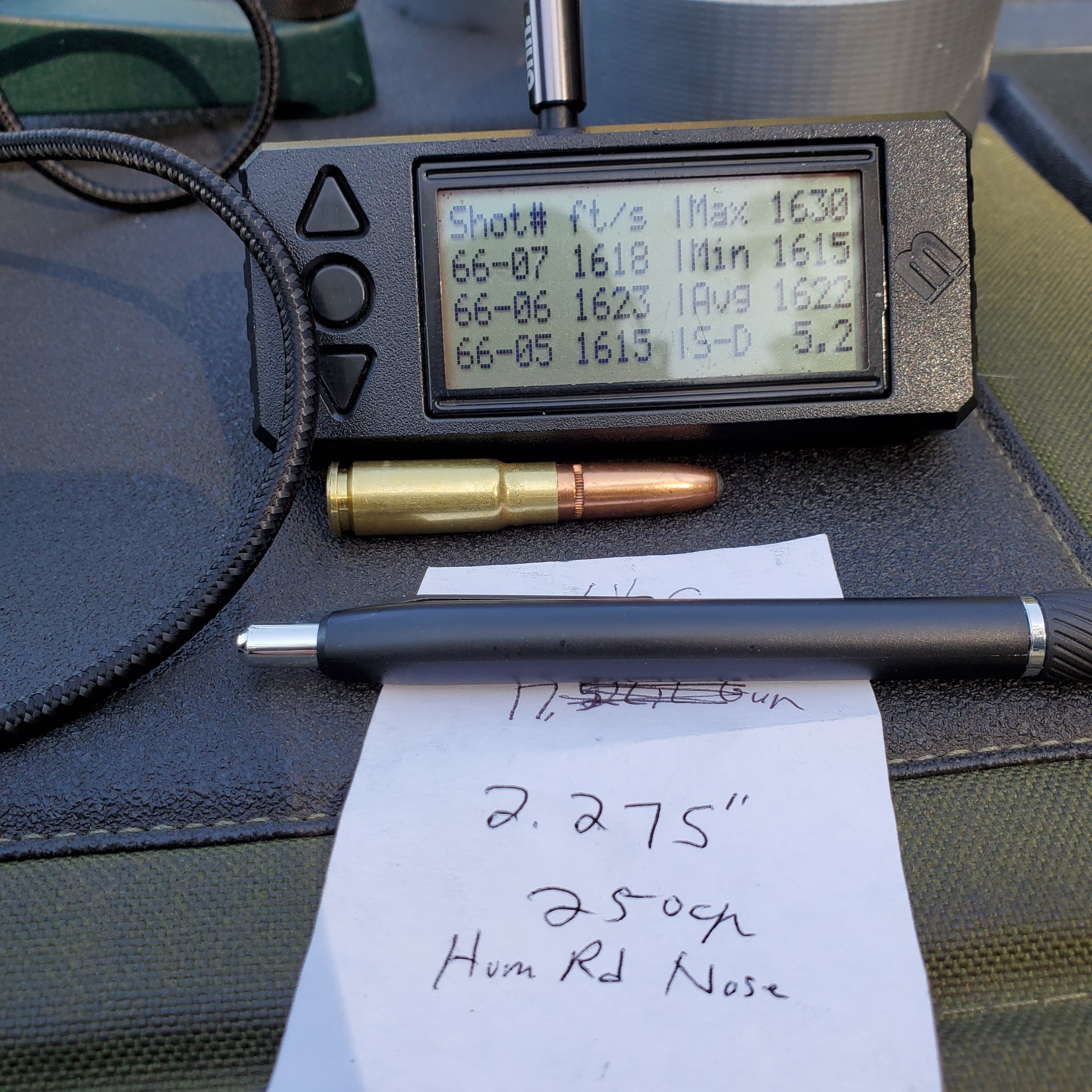

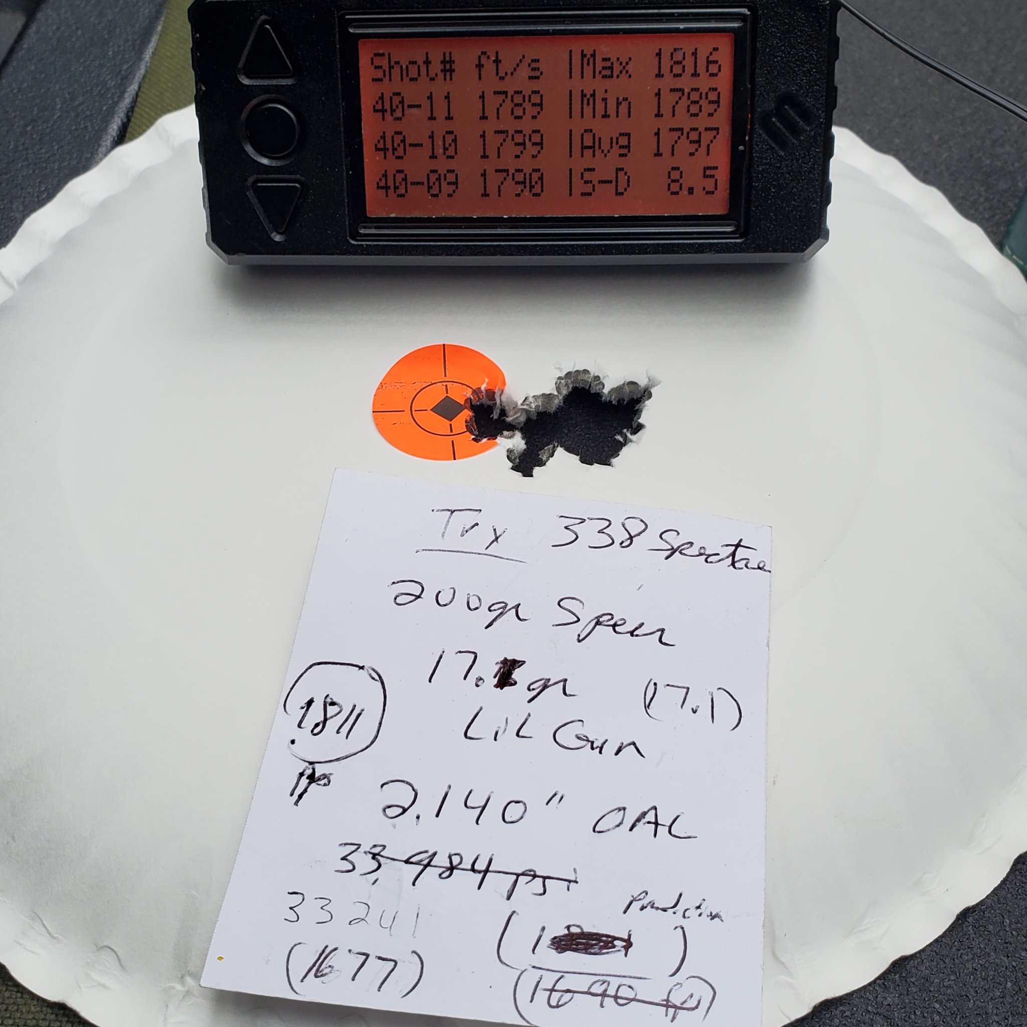

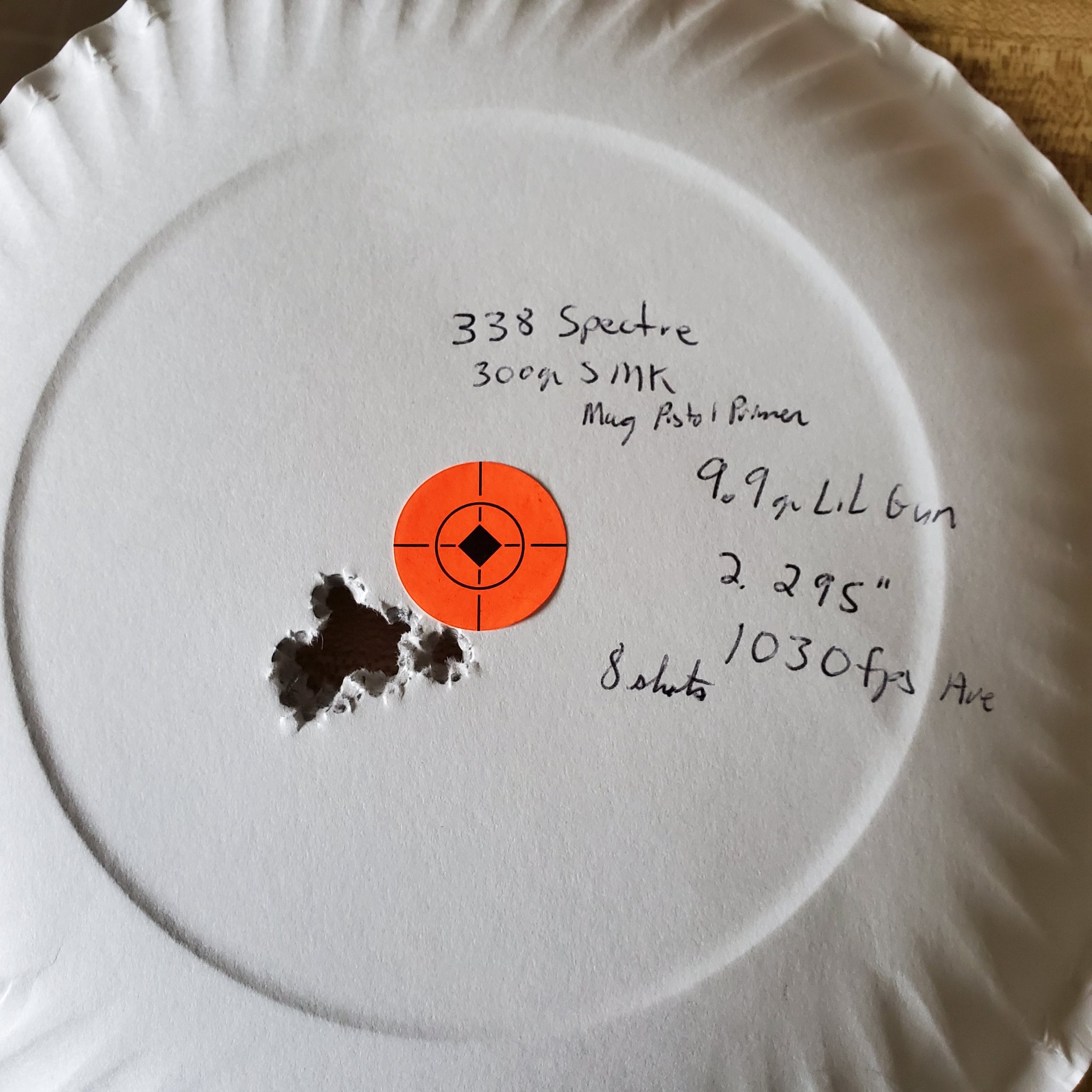

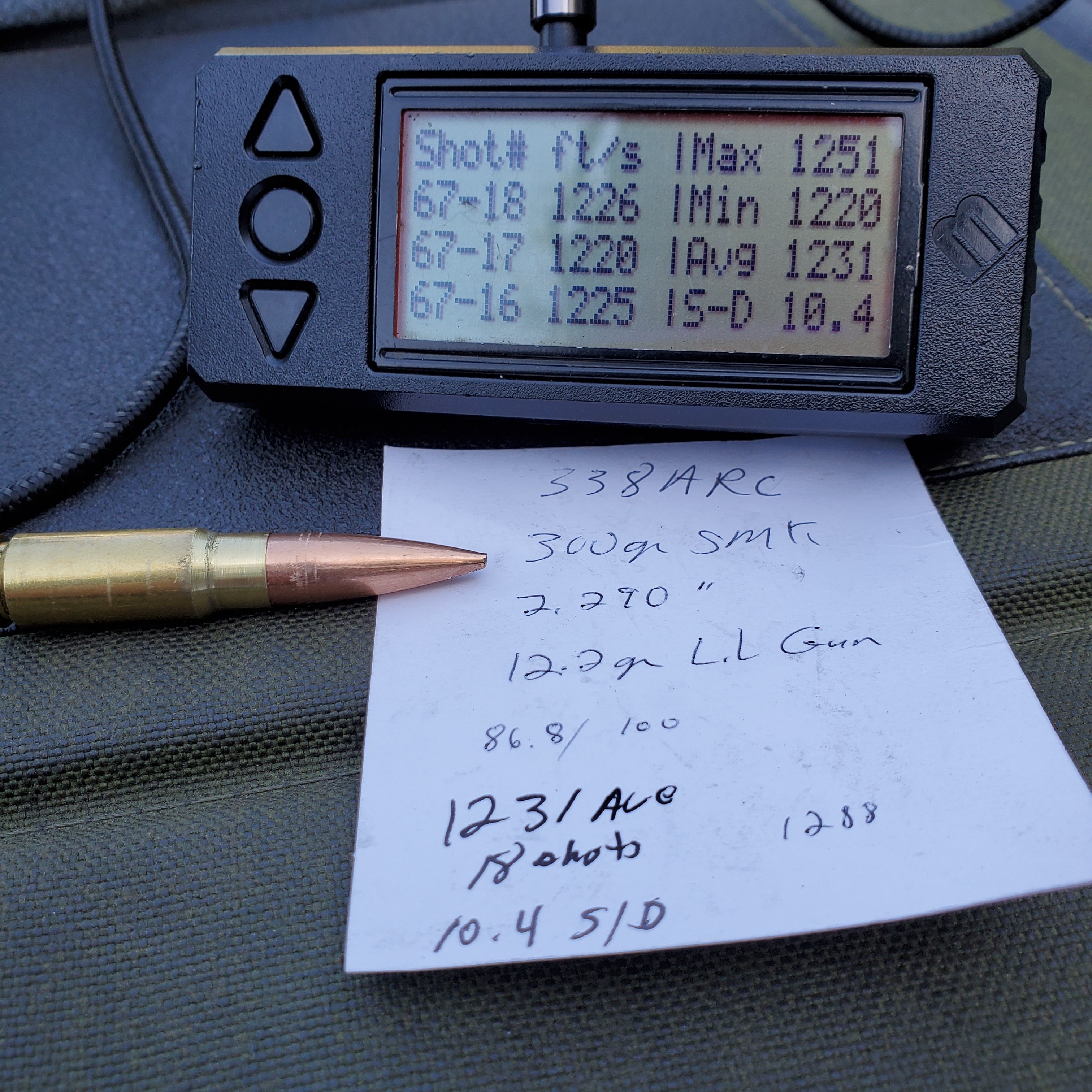

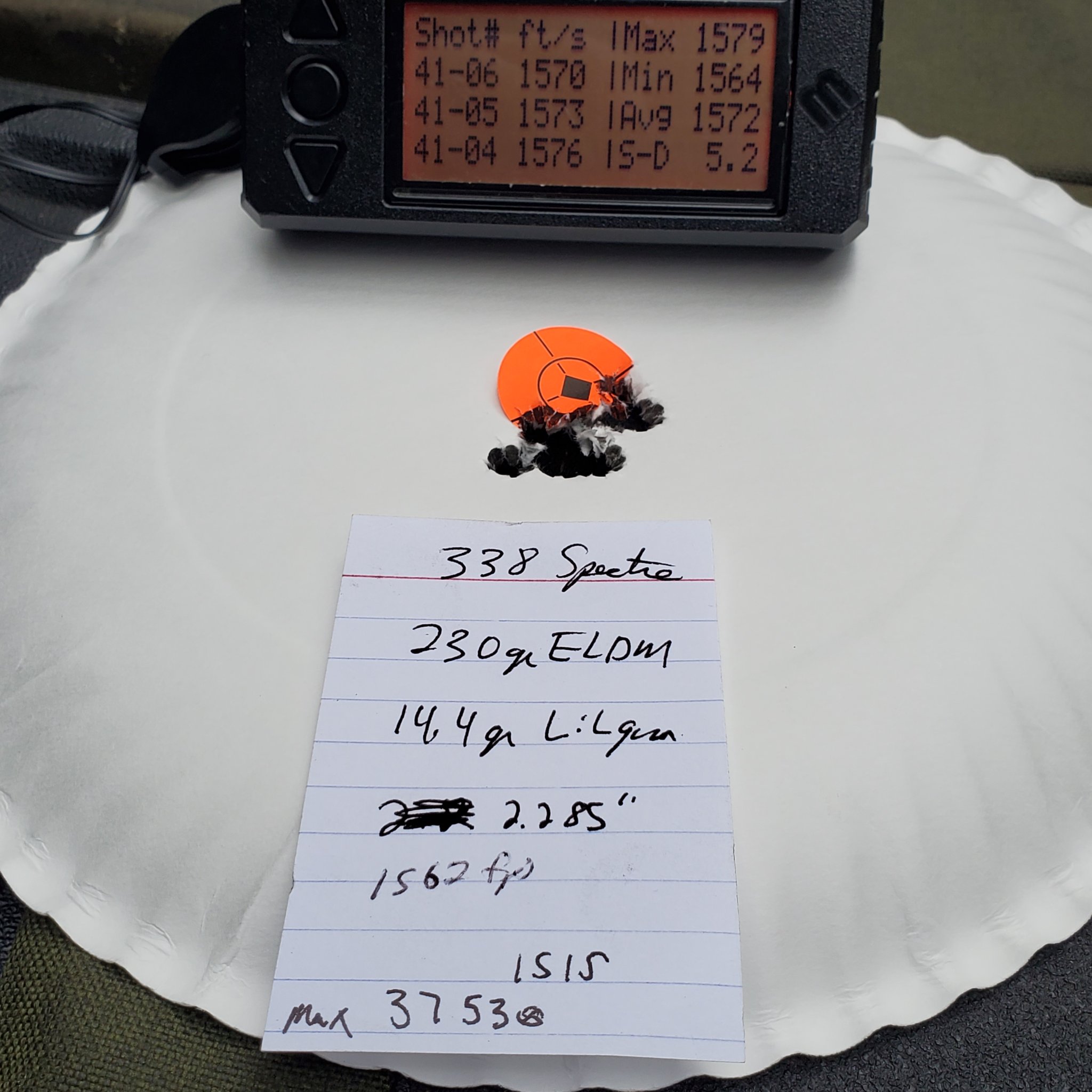

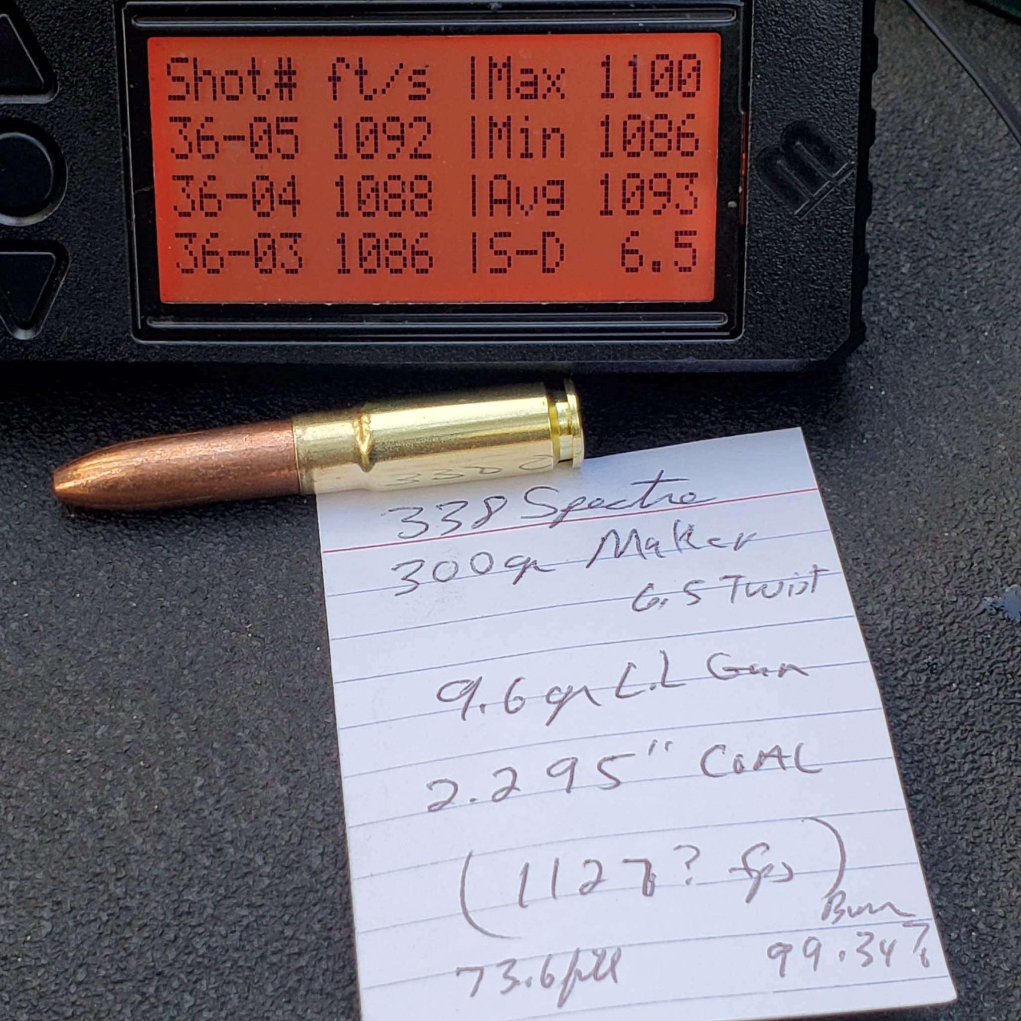

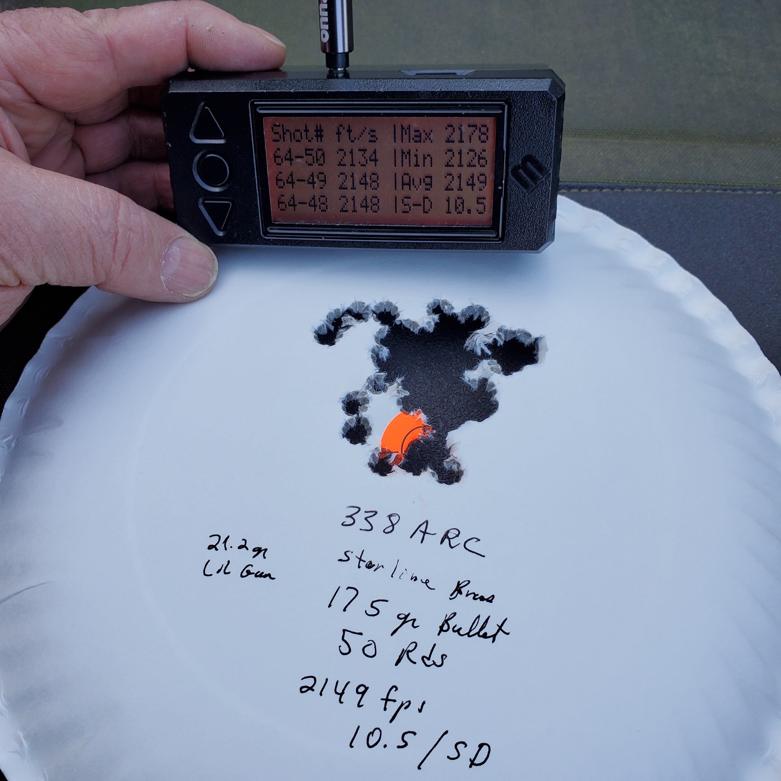

Did some testing on the 338 ARC. Or 338 ARC Plus... I changed the case a bit to get just a bit more powder into the case...notice the short neck. It will only slightly improve velocity of the light supers and do nothing for the 300 to 350 gr subs.
Also running a 16" 6.5 twist barrel.
This is a 50 shot group with 175 gr bullets first fireforming of the improved 338 ARC, notice only 10.5 S/D over 50 shots average 2149 fps in this group. Good for an AR 15. And velocity is quite a bit faster than factory 175 gr
The magazine that works... was the 338 ARC mag specifically made for it by CMMG...even an the 250 gr Hornaday rd nose bullets.
These loads may be a little stout for the light supers in regular brass...so work up...as I have about 4.8% more capacity, but with subs the bullet takes up all the case, so not much difference there.
I missed the 300 sub velocity with 1200 fps but S/ Ds are still good.
