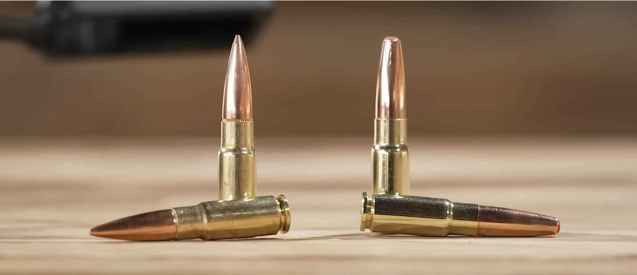

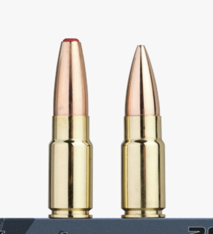

Here is the 300 Berger and 350 Maker. Note the bullet box is 338 Spectre 6.5 twist, both easily stablize in the 6.5 twist.
The 338 ARC and 338 Spectre are very similar as pictured with the longest bullet being a 350 gr Maker.
The 350 gr Maker modified to bore rider has no trouble stabilizing as shown here in the 6.5 twist 338 Spectre.

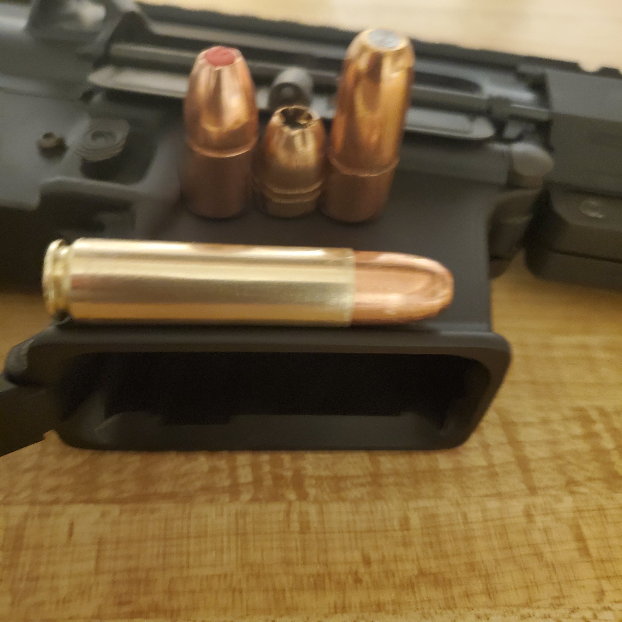

Do the 350gr Makers actually fit in a magazine (STANAG or ICAR pattern)?
This has all been discussed in other pages...

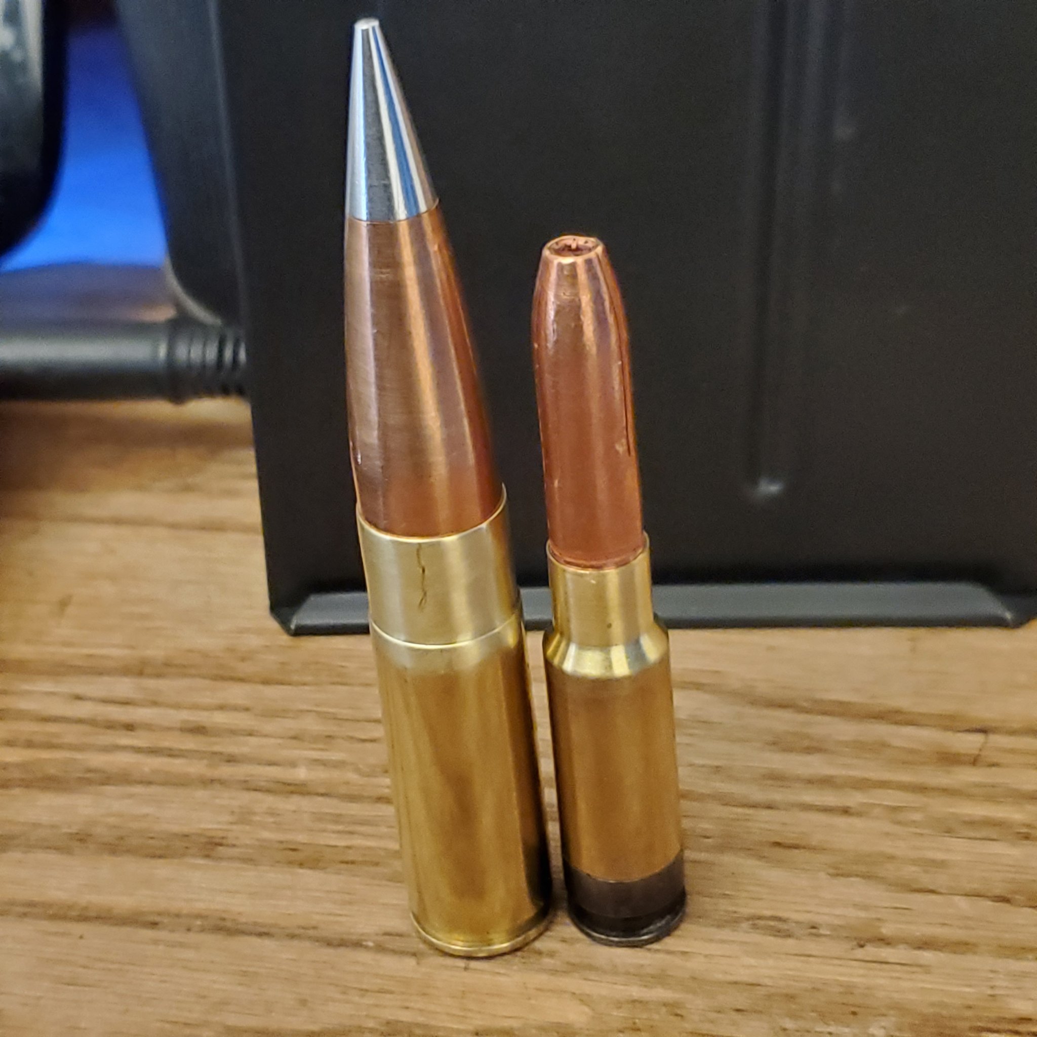

The 350 gr Maker is alot of bullet for the 338 Spectre and 338 ARC.
I have used cut out mags to get it to work but velocity was low in the 850 fps area, needed a different powder but it's a compressed load...but about 900 fps would seem the velocity limit with out further development, and experimentation.
I guy wanted a .416/ 338 Spectre developed, and was not concerned about AR 15 mag length as it was for a bolt gun.
So after machining bullets to 402 gr complete with holllow point. I fit it into a 338 Spectre case to decide how much powder space was needed to get it to 1100 fps. This was achieved with bore riders.
So I used the same concept on the 338 Spectre and machined different bullets. Then went to the 350 gr Maker to modify it to gain more powder space, and had 2 solutions, one being the long bore rider.
Easy to make in a precision lathe with collets.
But it was single load in an AR 15 but work great in a bolt gun.
That's alot of bullet, but its accurate and consistent to run right to the edge of subsonic/ supersonic flight, another .5 gr runs 1047 fps in the AR 15 single load these.

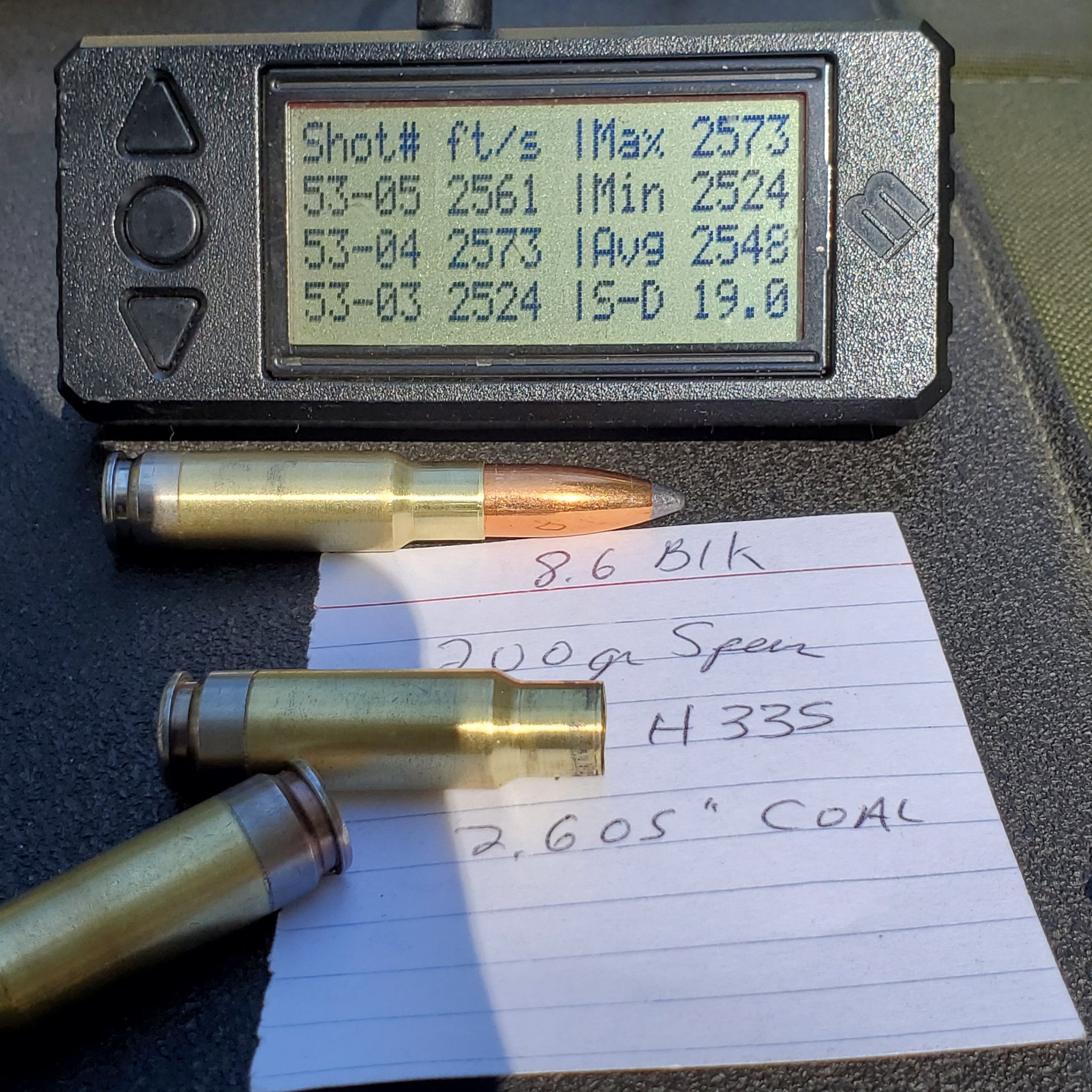

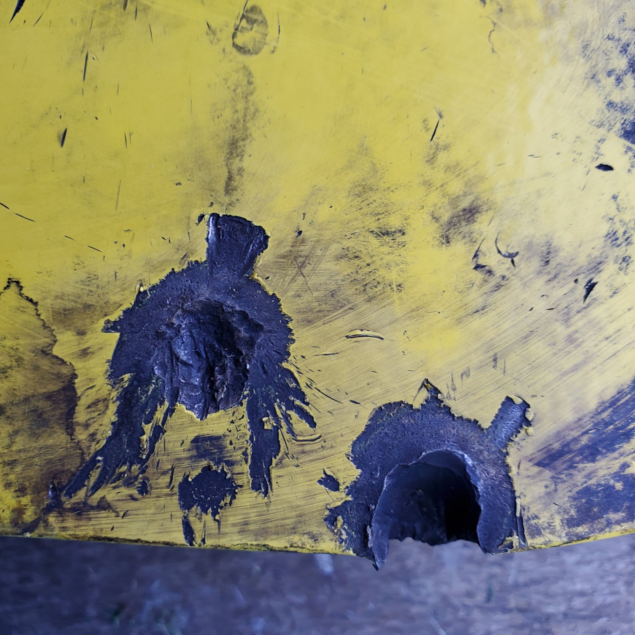

After owning and shooting the 338 Spectre, 8.6 blkout 3 twist and 6.5 twist.
The 8.6 3 twist is a dud, and dangerous, limited to low subs and expensive copper only bullets.
With the 6.5 twist, a bolt gun, and hybrid cases its basically a 338 Federal fir supers and better with subs.
No velocity limits of 1000 fps on 350 Makers. I ran them over 1800 fps in the 6.5 twist, no blow ups.
Might as well try the 338 ARC,...but not Hornadys version...something with a faster twist, and maybe just a bit more case capacity like the difference between a 6 Dasher and 6 BR for supers but subs remain about the same, cause the long bullets take up the extra case capacity.
So I did alot of testing with the 338 ARC improved with bullets 160 gr Barnes 2300 fps, 165 Maker 2275 fps, 175 HP 2202 fps, 200 gr Speer 2100 fps, 200 gr SST 2025 fps
250 gr RN 1760 fps, 272 fmj, 300 SMK, 300 ATIP, and 350 Maker, standad bullet 866 fps and 350 gr bore rider over 1200 fps in 6.5 twist 338 ARC improved...200 fps faster than a AR 10, 8.6 blakout with the 3 twist and its 1000 fps speed limit for this bullet.
So here one can shoot a 16" 338 ARC improved 6.5 twist using an AR 15 with no limits on bullet selection or makeup, and hang with the 12" AR 10, 3 twist in 8.6 blackout, ...and shoot jacketed lead much faster with no speed limits.

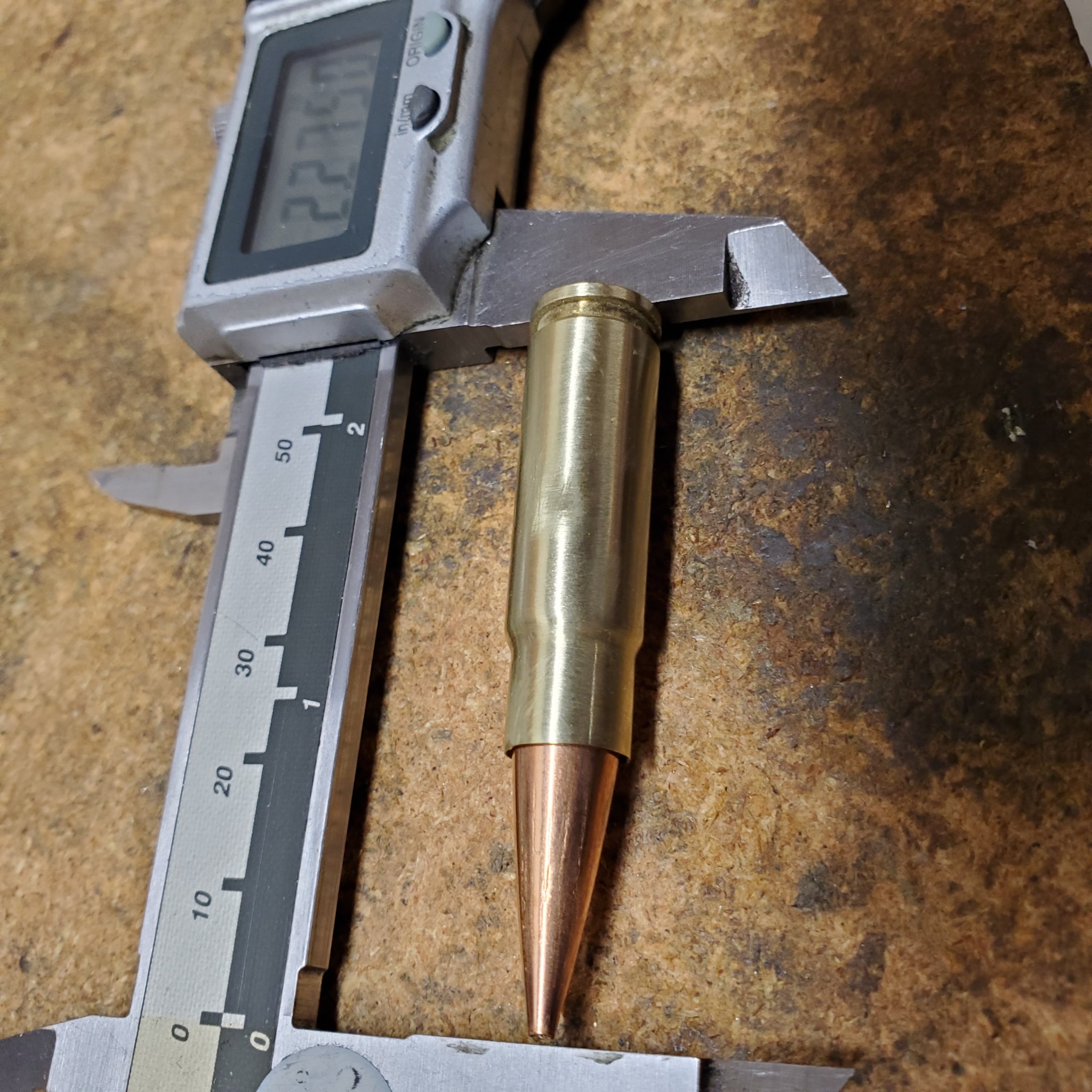

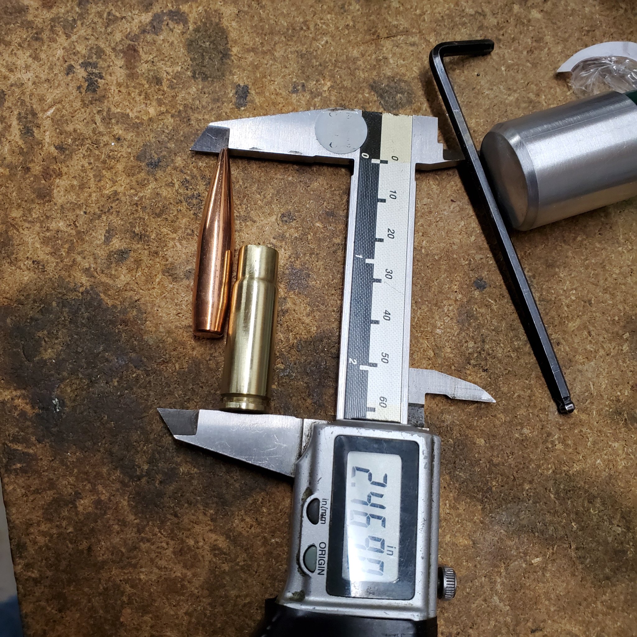

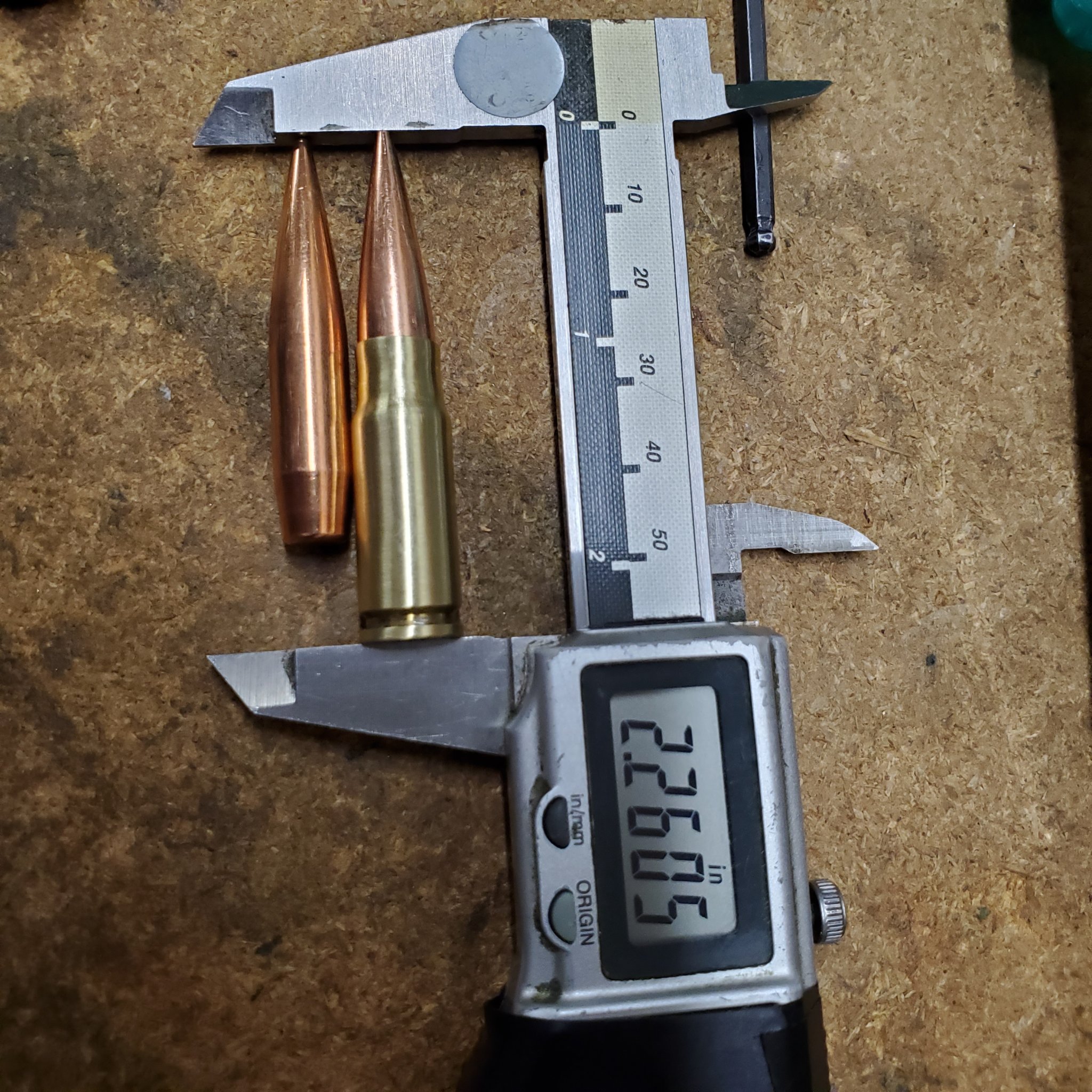

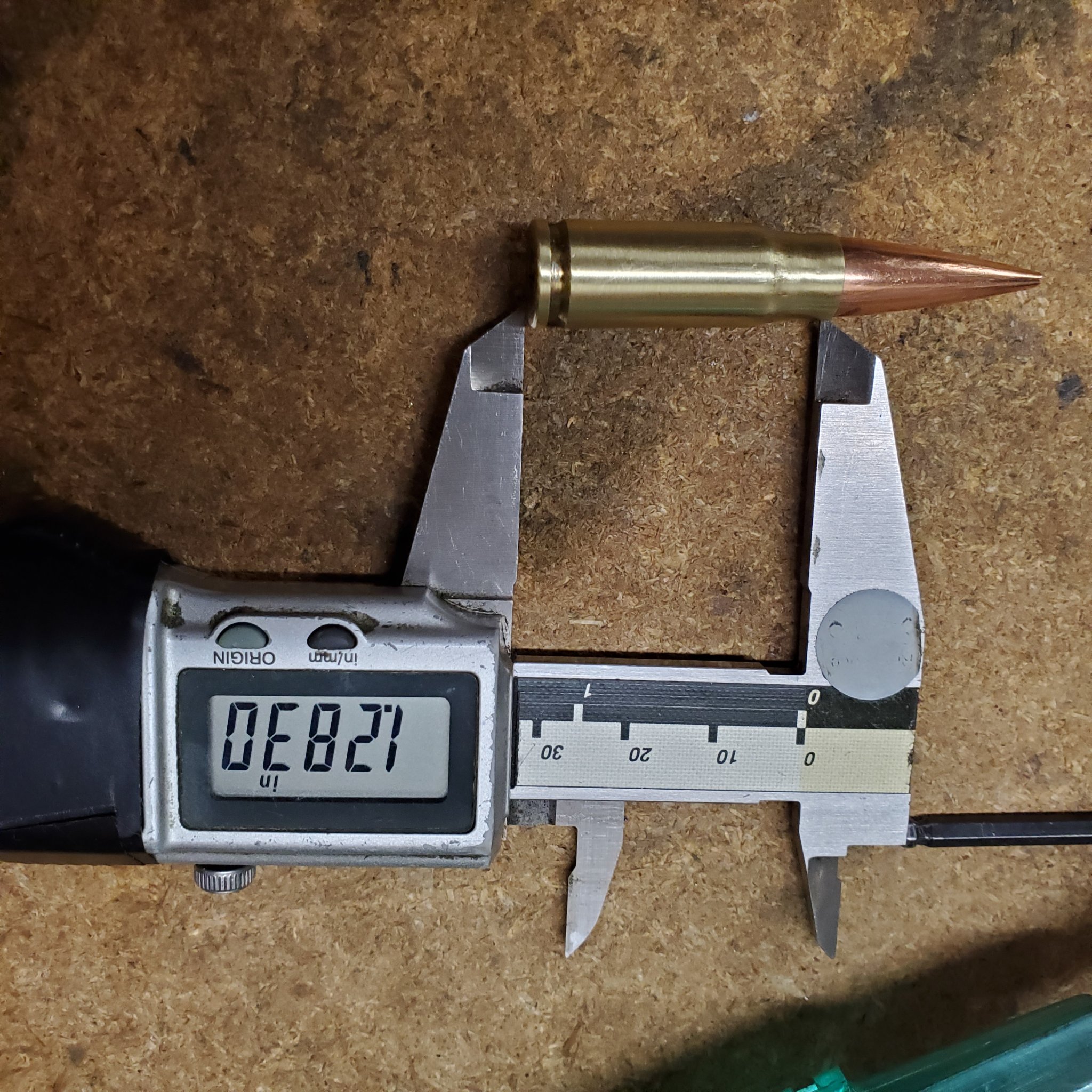

How does your 338 ARC Improved feed?

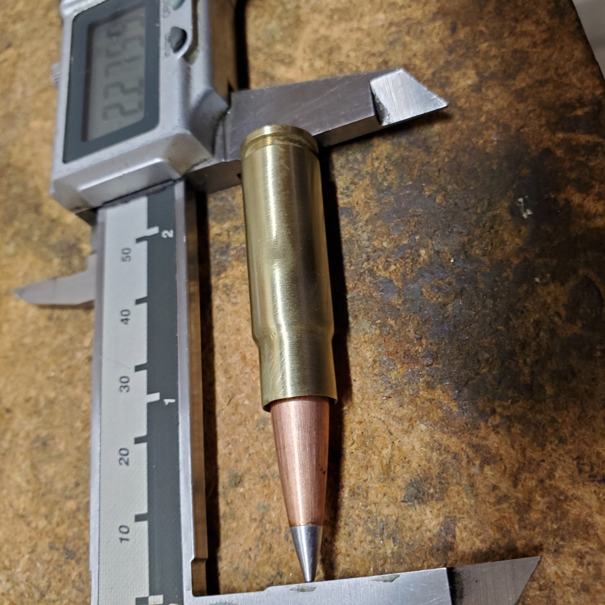

I took the 347 weighed 350 gr Maker and turned a few down to 1.870" and only took off 7 grs of copper, or 340 gr. To get more capacity over the 347 gr ran 3 over the chronograph, a 4 th was over 1000 fps at 330 grs.
This is a 6.5 twist in 338 ARC imp but the bullet takes up all the extra space...
It could be just a bit more like only 25 fps but you're basically at max with slightly modified 350 Maker at mag length.
The one modified to 330 gr had over 1000 fps.
So with the 338 ARC one may be limited to 340 gr and 300 gr. Or just stick with the factory 300 gr. The 6.5 twist rate seemed to stablize them, but will they open up at the lower velocity with out cut out mags and making the bullets bore riders.
I ran the shorter 1.295" ARC cases fireformed, they are shorter than the 1.370" ARC starline improved cases.
The velocity is down a bit, but faster than factory loads.

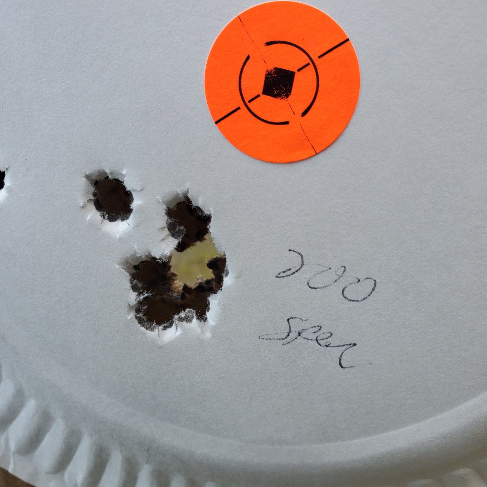

The velocites were consistent with the supers, 200 gr at 2050 fps &175 gr at close to 2200 fps.
The barrel likes the 175 gr which were 2nds and free shipping for 35 cents each...they are 2nds but shoot good.
Four went into one enlarged hole, and one off to the side.
Put up a new target and fired 30 rds.
A fun day out shooting, but it's starting to get hot.
