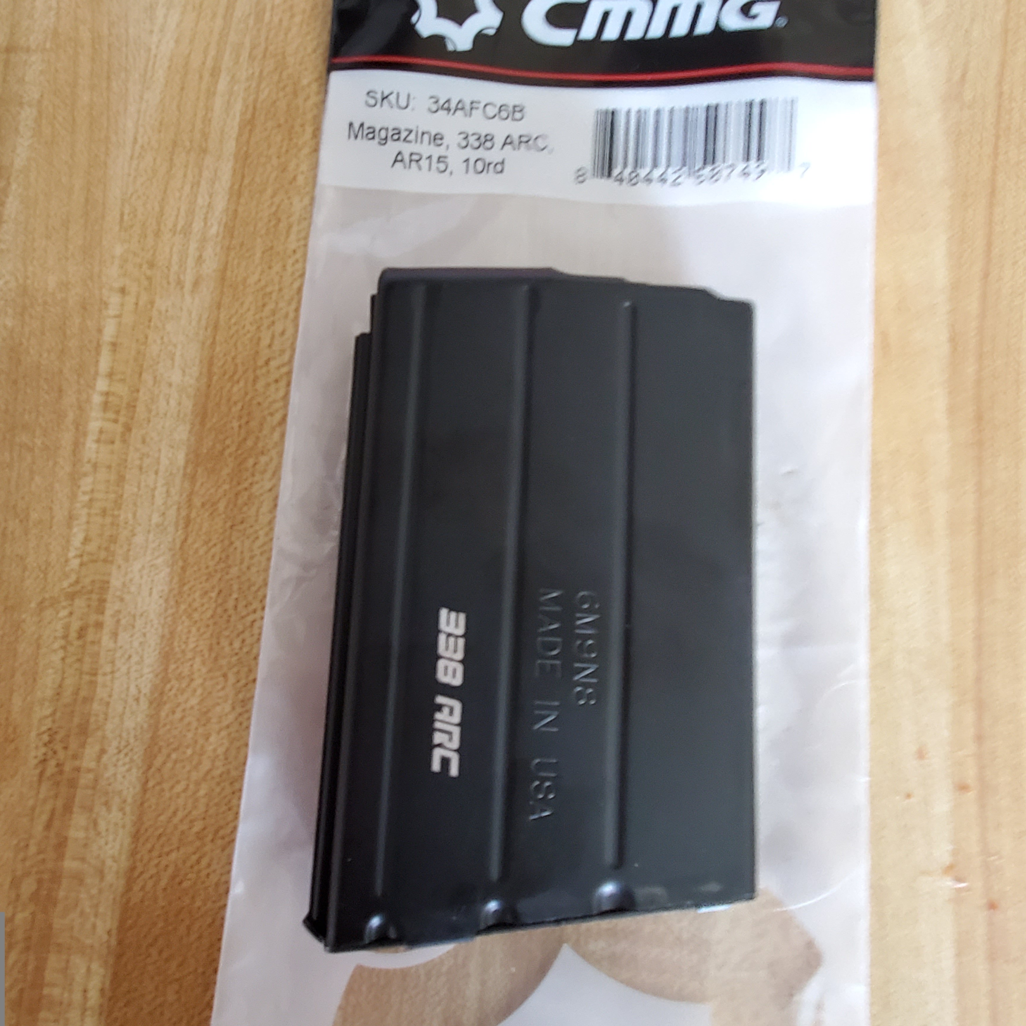

Well here are the 338 ARC mags. 2.3" internal capacity.
This is what it looks like maxed out with a 338 350 gr Maker...barley enough room.
The bullet guide lines up good on this huge bullet.

The CMMG 338 ARC mags work great in my gun.

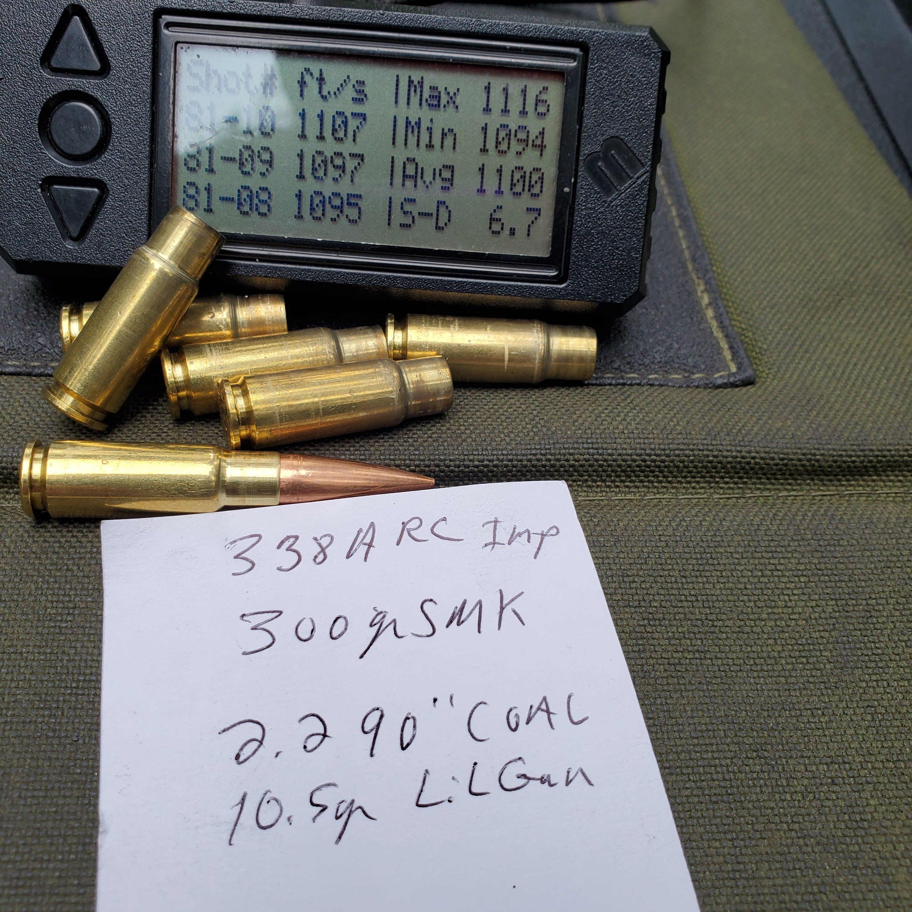

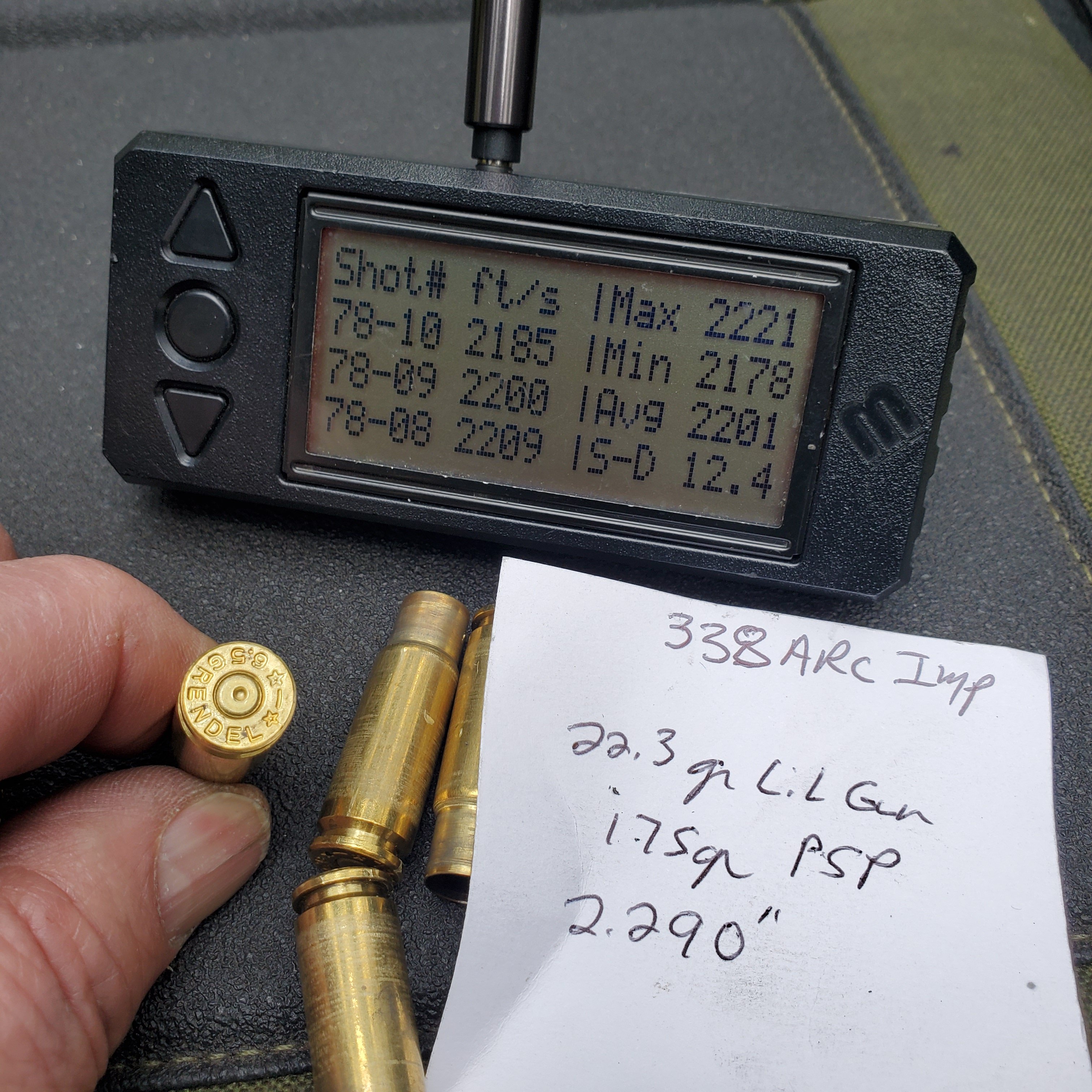

175 gr at 2200 fps
200 gr Speer at 2100 fps
250 gr Hornady RN 1770 fps
300 SMK at 1100 fps, right on the edge...
350 Maker slow at 660 fps did not lock the bolt carrier back but ejected the empty.
A good day at the range, most everything went as planned.

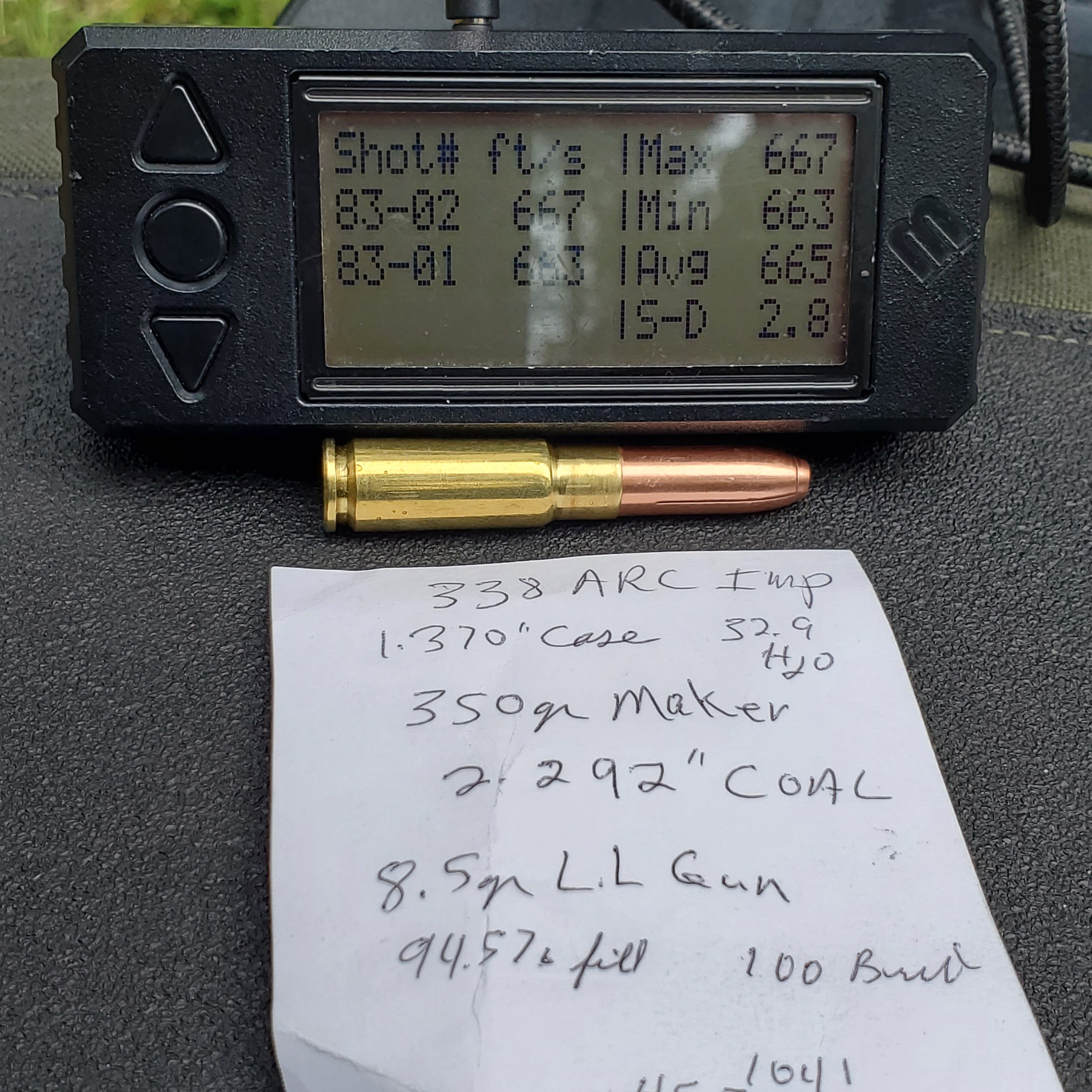

Those 350 Makers (cut to 340) are promising with a SD of less than 3. Yeah, 2 shots recorded, but promising.
Which primers is all that's missing from the shot build cards, that I can see.
Reactions: 45-90

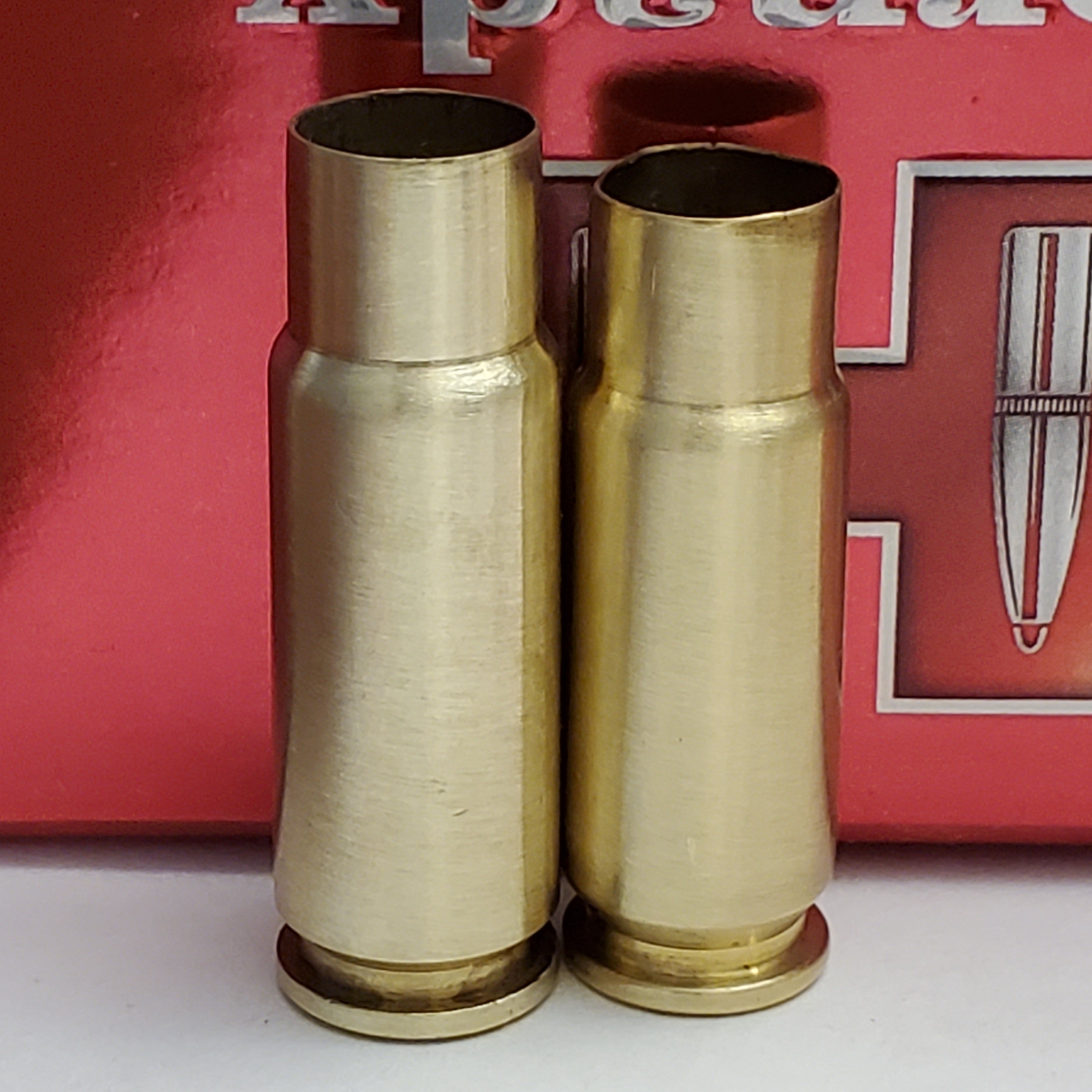

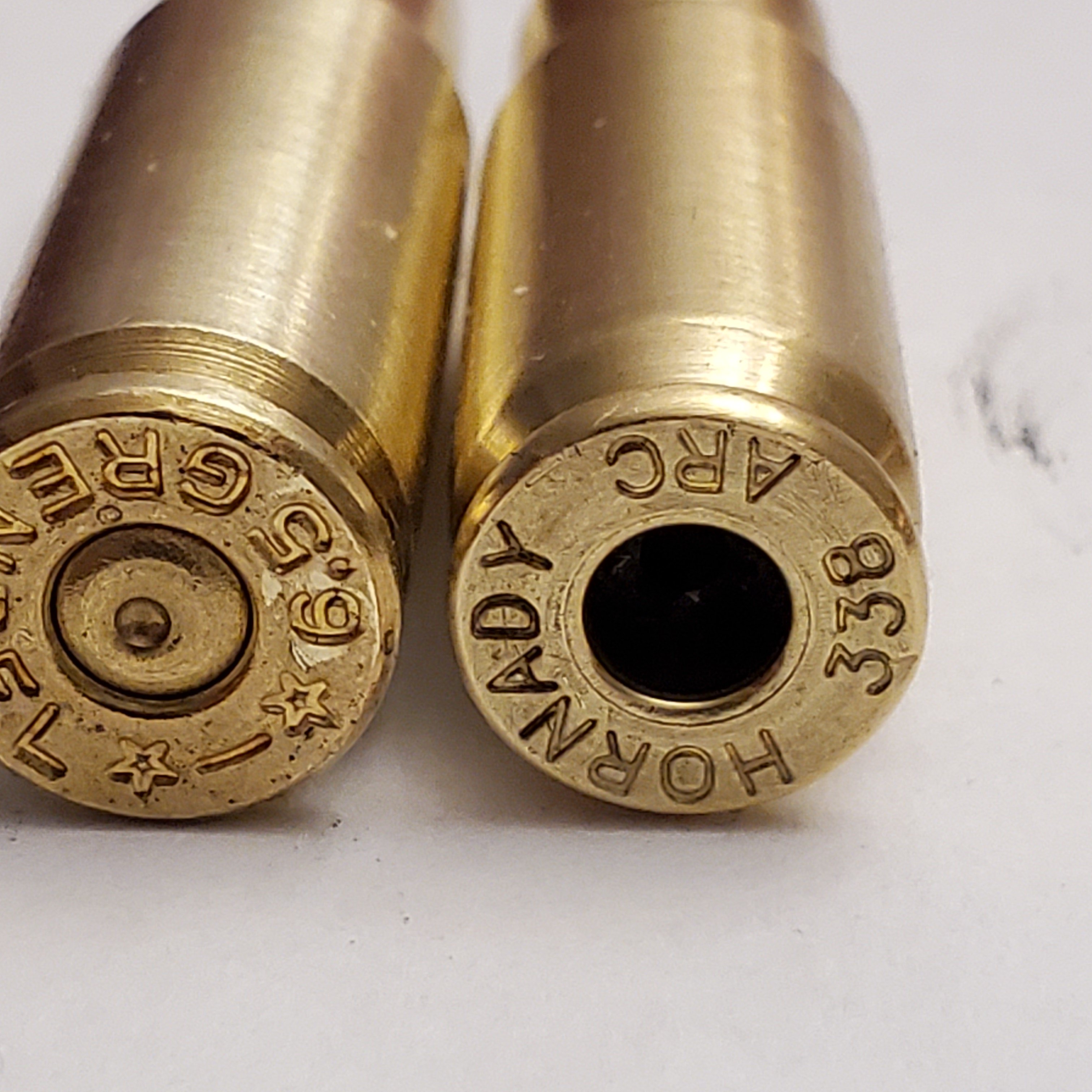

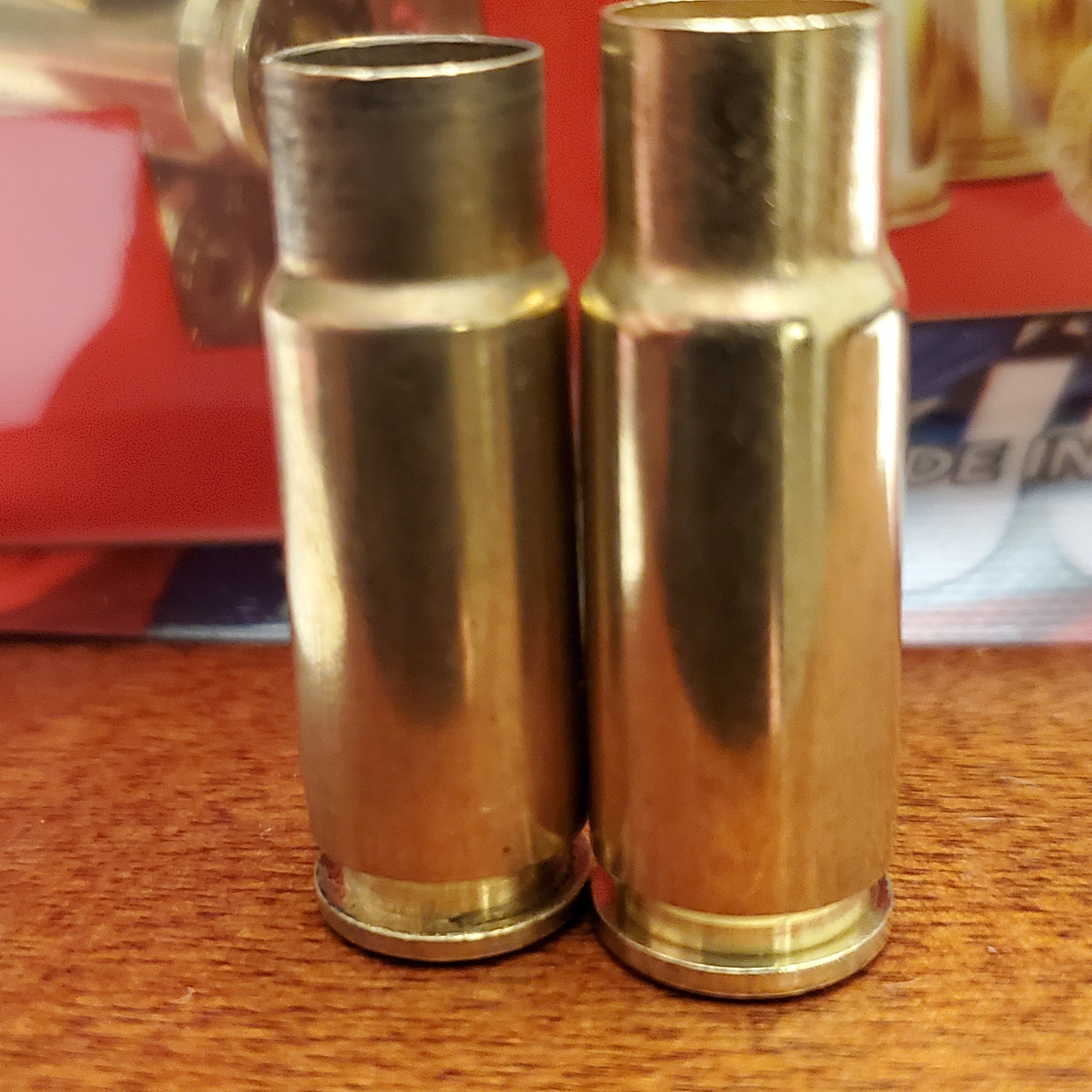

The Hornady 338 ARC vs My version 338 ARC improved....just to let people know it has a bit more capacity for supers and higher velocities....but little effect on subs, as the long bullets take up most of the powder capacity, which is a good thing giving nice velocity spreads.
So it's a compromise, can't make the case too long like full grendel length and fit a 350 gr bullet in the mag.
But I wanted to see if this small increase in powder volume would give me the extra velocity over the Hornady factory specs for the 175 gr bullet. Like the 6 br VS the 6 Dasher. So far I'm running the 175 gr at 2200 fps ave VS factory 2075 fps from a 16" factory test barrel.
I used Rem 7 1/2 primers for all loads.
The 350 Makers are factory untouched bullets that weigh 347 grs.

I considered improving the velocity of 660 fps which only has a little way to go with this powder...but they are quiet.
To increase velocities in limited space of case capacities and mag lengths, ya gotta use cutout mags, cutoff .060" or so of the hollow point only about 6 grs, or single load boreriders all machined in lathe collets and stops.
All that can be done...along with try a couple of other powders.
