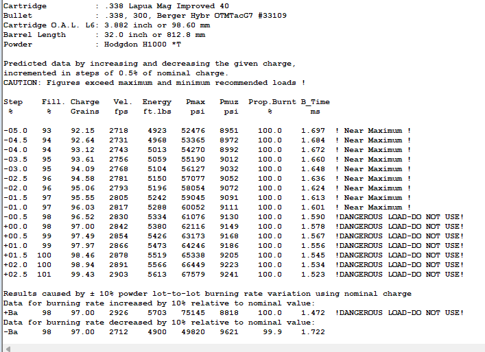

You may want to DOUBLE CHECK THE SCALE YOU'RE USING. Also get out the magnfying glass and go over your bushing imprintation; is it really 364? Also; do your reloads chamber easily? And maybe; are you using 107 gn RL33 to fireform cases?

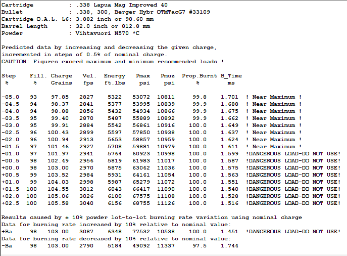

Vihtavuori n570 is just a bit slower burning than RL33; it's a double-based n170. Please communicate with the barrel manufacturer/gunsmith/source of this rifle. You're taking some unnecessary risks that could result in a most unpleasant manner--to you and/or someone else. Everyone responding to you means well, but sorry to say, none of the advice has solved the issues you're facing. I do wish you the best outcome...

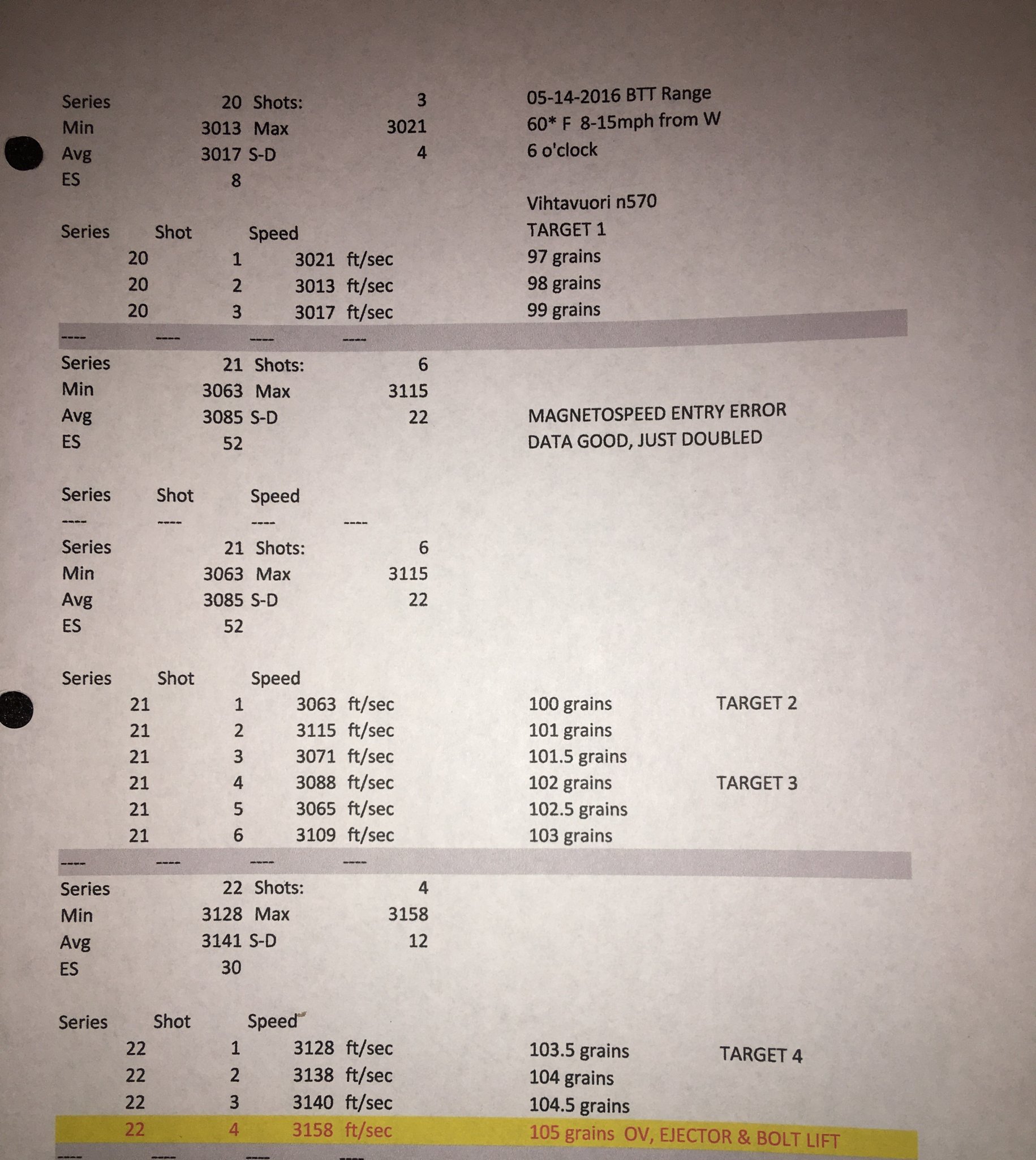

Neither have I--and I do have 7+# of it--but did use it in another improved variant of the Lapua with a 36* shoulder (338 Terminator). Search this and other forums as there are many shooters who have considerable experience with it. I used it with 300 gn OTM Bergers. Please see attached initial workup of n570 in the foregoing rifle. Hope
this helps.
Reactions: BCX

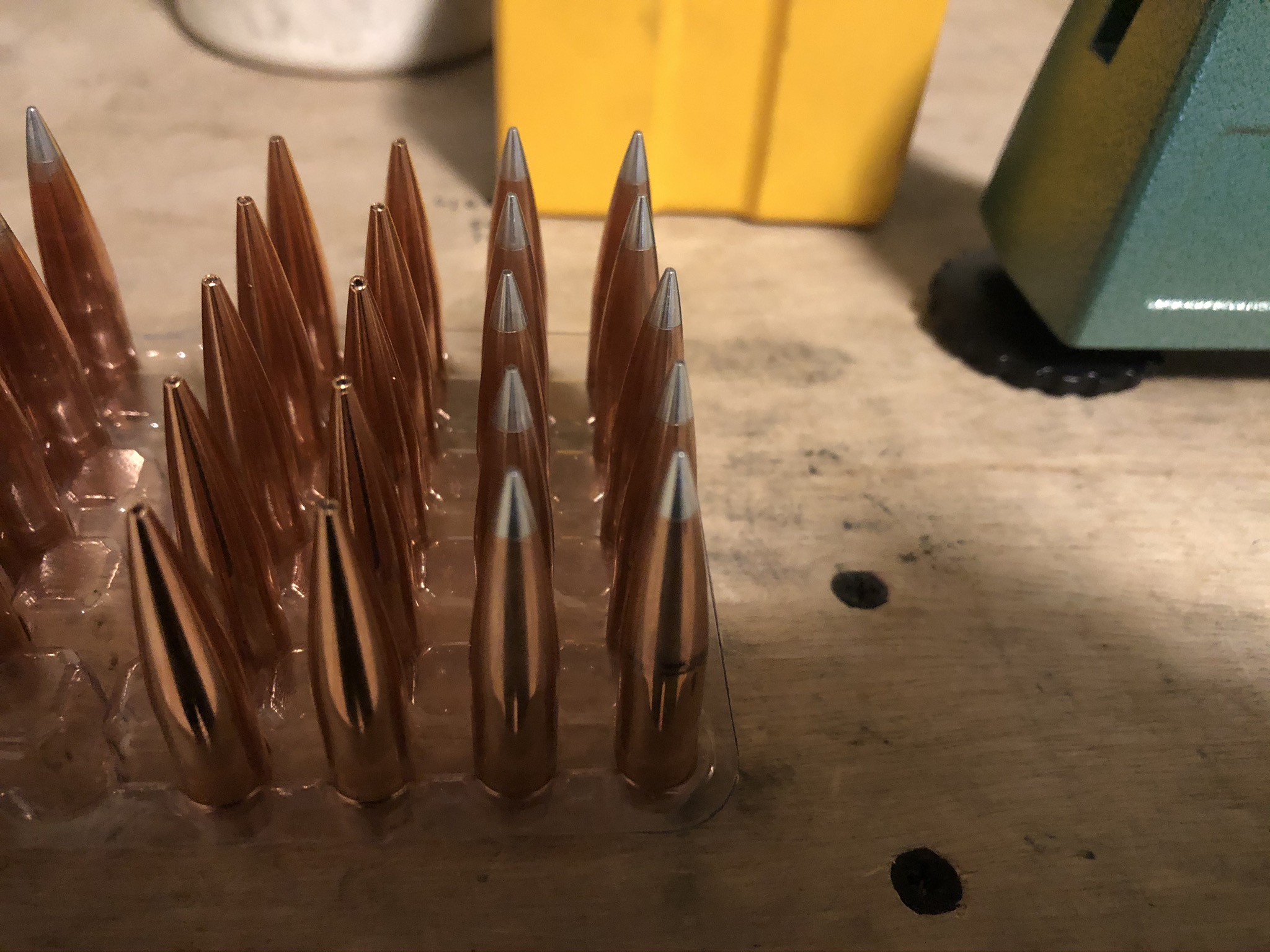

While doing some development for the AI this week I did a quick weight consistency comparison between the .338 300g A-Tips and the 300g Berger OTMs. I used both a RCBS Load master and a classic beam scale for backup. I weighed 10 random bullets from each group. In summary the A-Tips were all overweight from .2 to .6 grains for each bullet with a total of 2.5 grains over weight across 10 bullets. To be honest I wasn’t expecting this because about seven years ago I weighed Berger OTMs in the same caliber/weight and they fluctuated much more. Berger must have improved their pouring/casting system:
300g A-Tips:
300.2, 300.5, 300.2, 300.2, 300.2, 300.6, 300.4, 300.3, 300.5, 300.4
300g Berger OTM Hybrids:
300.1, 300, 300, 300, 300.1, 299.9, 299.9, 300.1, 300, 300
Best I've gotten with the A-tips is a 5.6 SD with 104g RL 33, at an AVG of 2848fps with only four shots, so not a large test group.
On to test the Berger's today.

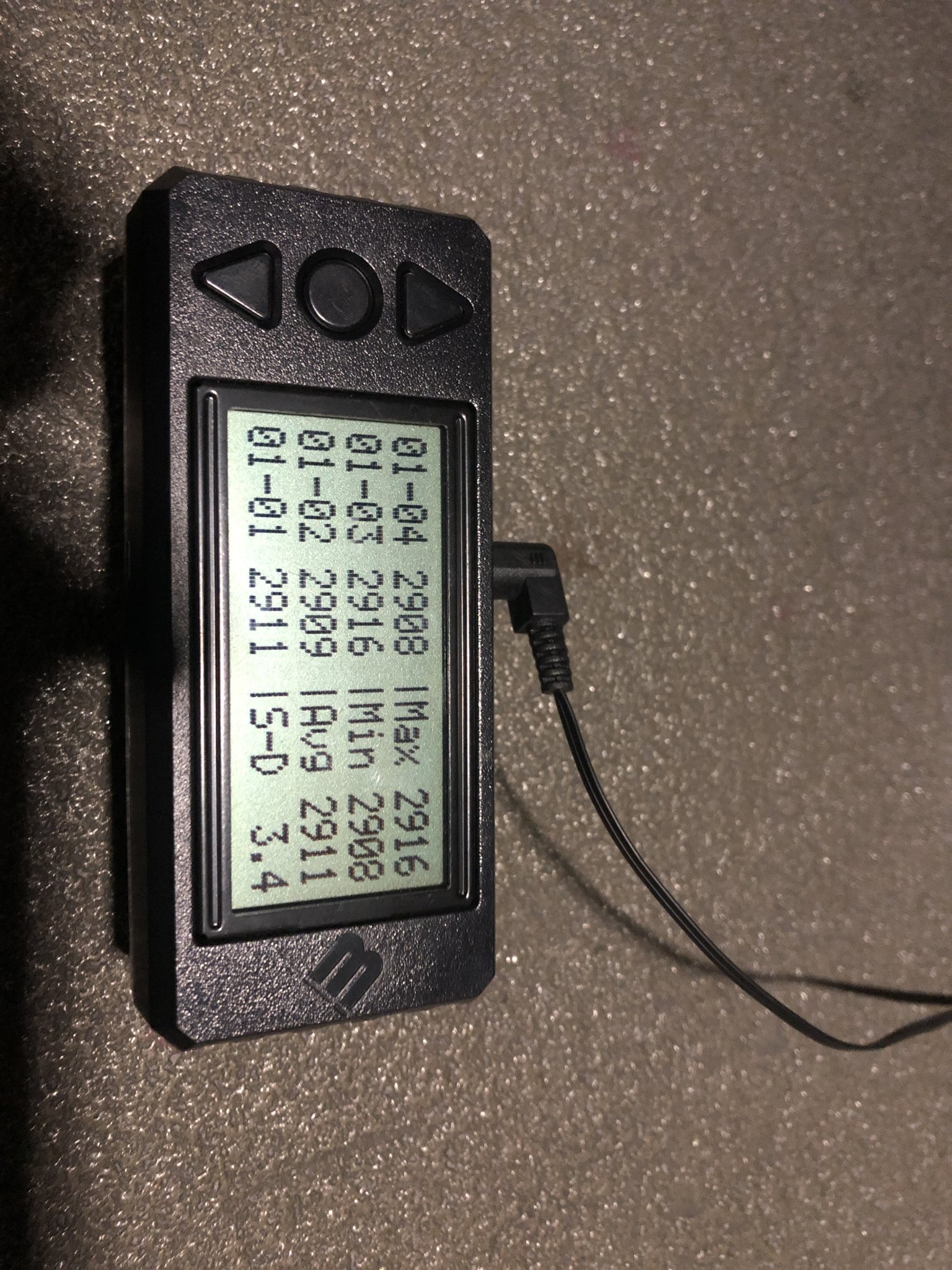

Just finished some load development. 300g Berger OTMs seem to be working a bit better than A-tips. Only a four shot group but there’s obviously a node.
105.5G RL33. 2911, 2909, 2916, 2908. Max 2916 Min 2909. AVG 2911 SD 3.4
